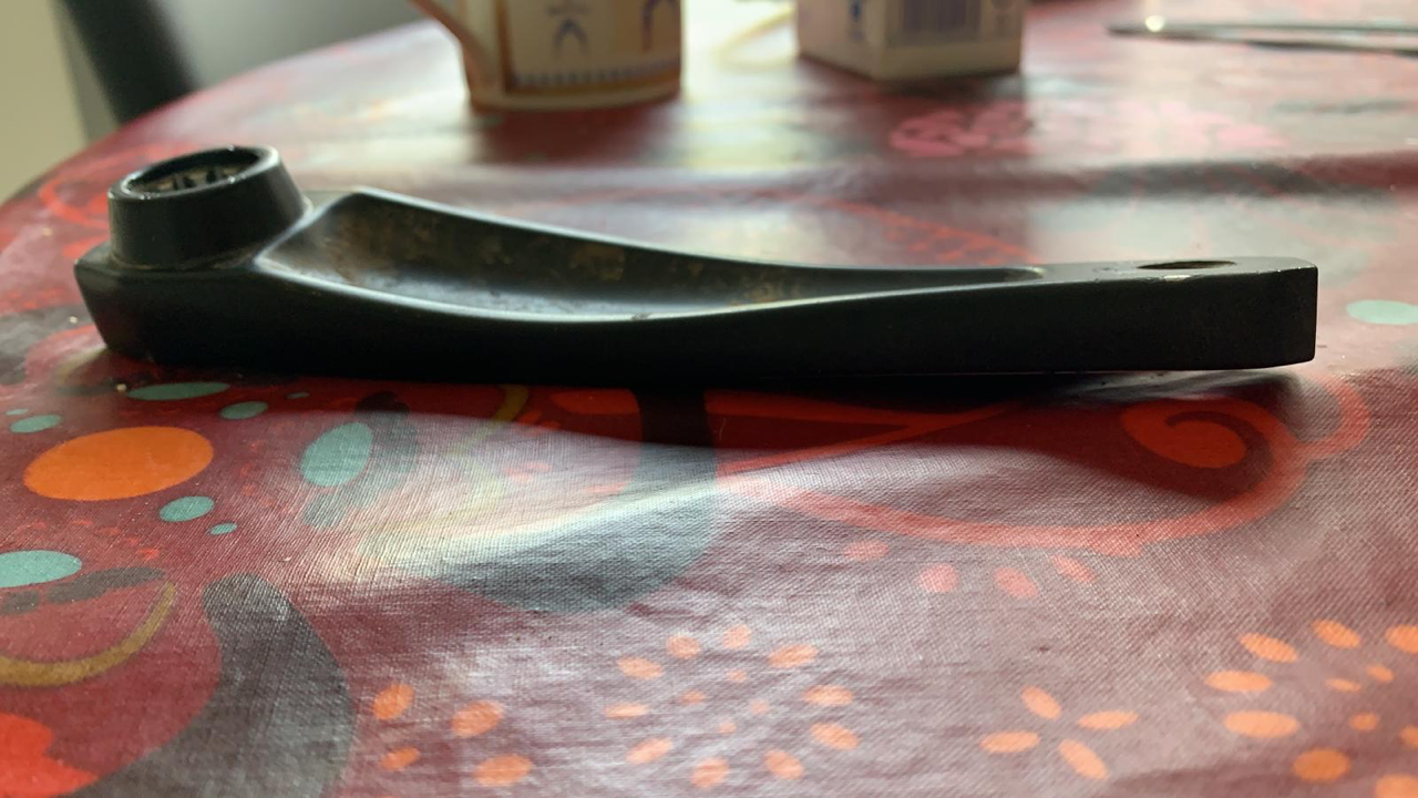

Last week bent the left crank arm when hitting some grass-hidden root... left the arm bent to the inside - to a degree that I could not spin the pedals round any longer. Wasn't even while shocks being compressed.
I'm starting to get really sick of this.... even after:
- changed regular crancks to 160mm
- filled the rear shock with spacers
- rear shock to max. allowed PSI (min. possible sag)
- front shock also to 10% sag, in hopes to keep bottom bracket higher...
- tires to 2 bar
- lost 10kg of weight
and still this happens several times on each ride.... never had this with a analog fully with normal-lenght cranck arms.
Together with the Tandem-like agility (Half a meter chainstays)....thinking of abandoning KTM...

Holy crap! You bent a crankarm just pedaling around. (LoL) What brand is that?
Miranda (KTM-branded). The most outwards point of the Flat Pedal hit a hidden root, just about when the cranckarm was perfectly aligned towards it, hence the bent.
