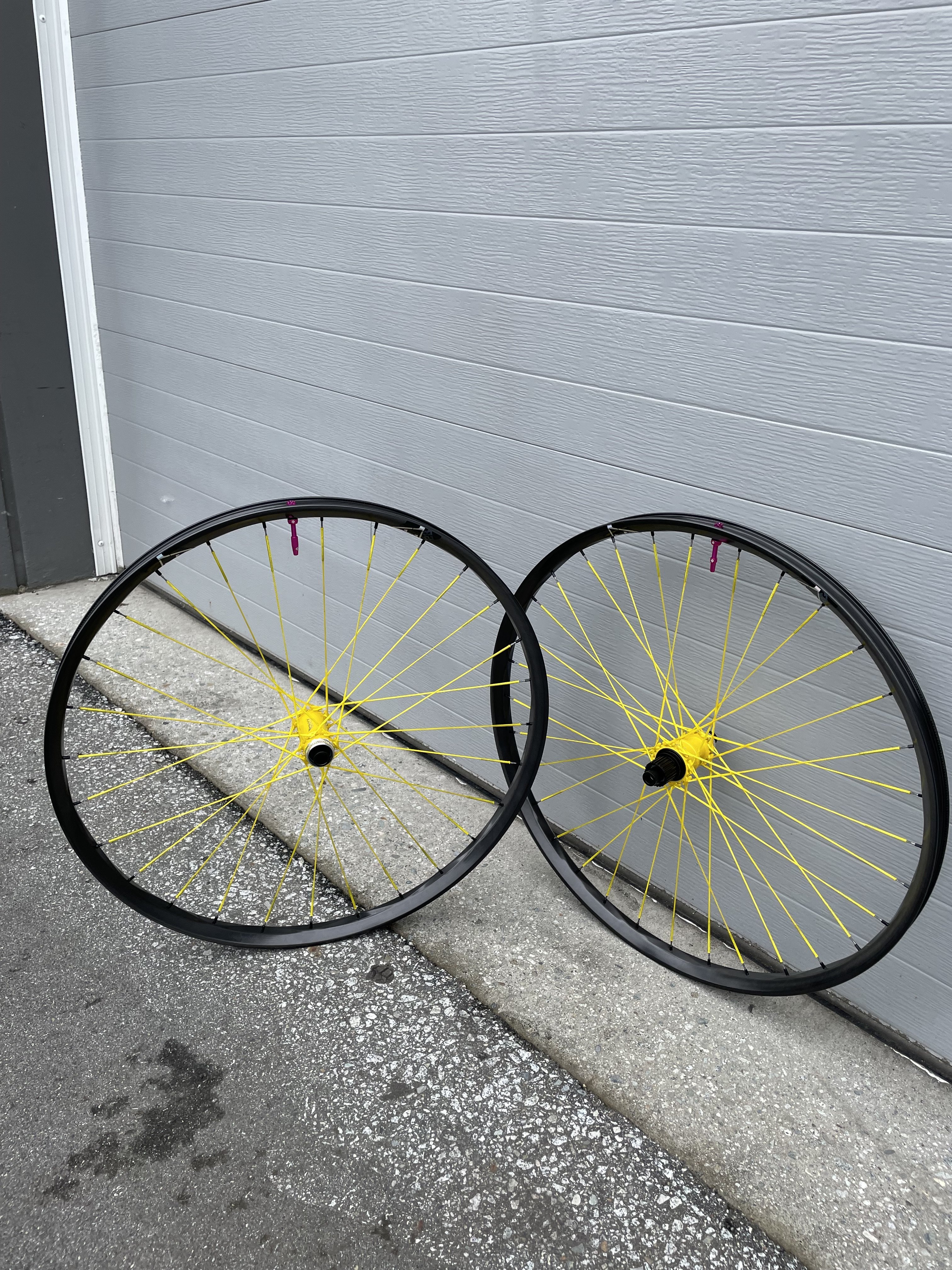

Oh those aren’t my wheels! The colour for the spokes are applied just before tensioning with a paint-pen. The liquid colour seeps into the Berd braids. I understand that the spokes need to rest for a few days before the final spoke tension.
I don’t know how the spokes could keep this colour (yellow) after a few rides. I would also have to avoid any 🥷 ninja ambushes.
Those wheels are for Dale Stone. (sponsored by IMBY) A YouTube sensation who rides here. I happened to be at the LBS when he arrived to pick them up. Those are friggen lite.…and expensive.

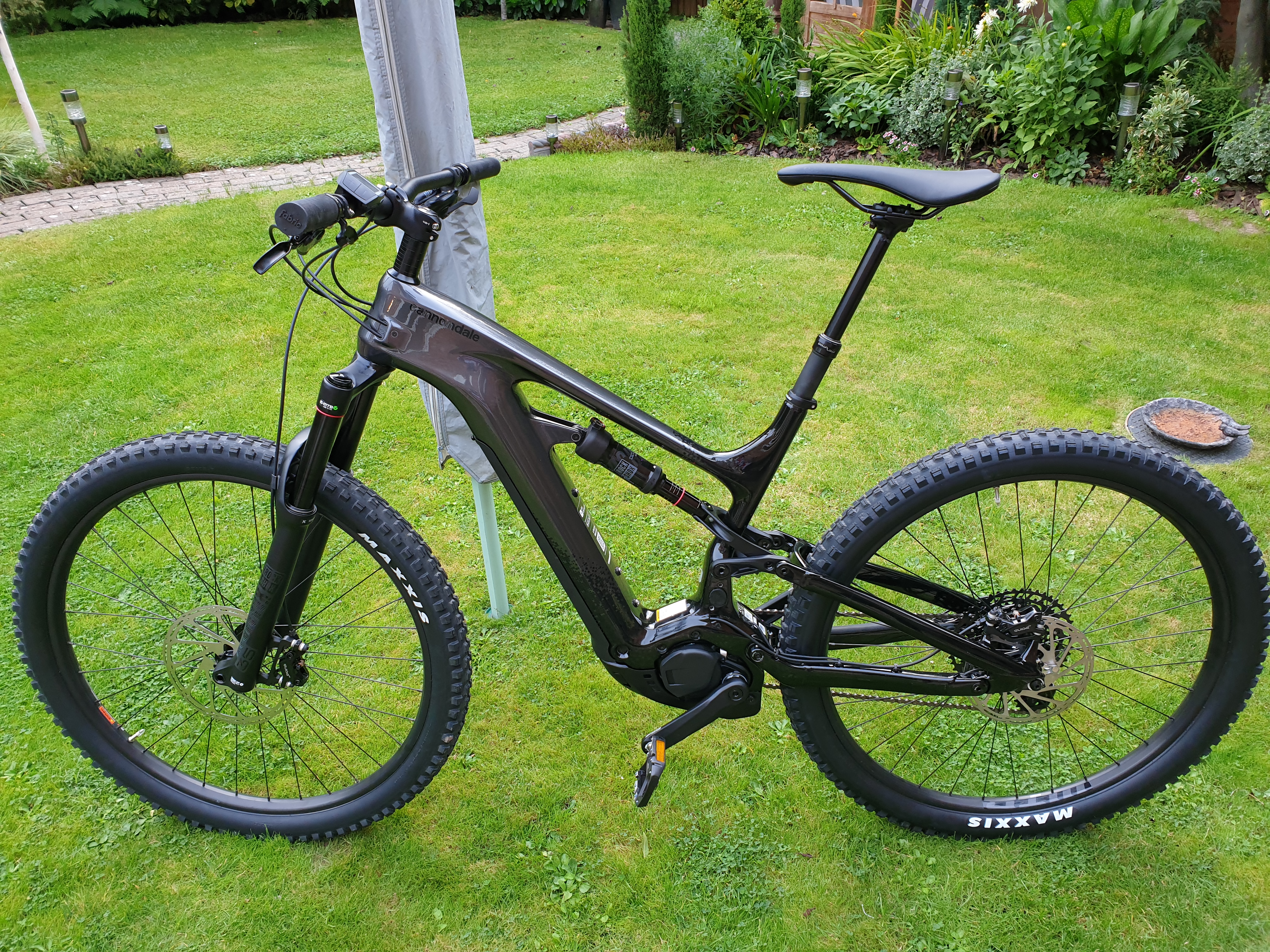

I bought a Giant Reign e+0 last year, came with carbon wheels as standard. Both wheels cracked within the first year. One from a fairly small off, don't even know what the wheel hit, (other then the floor)and the other cracked a few months later after coming down a local rough trail and what felt like a loose rock bouncing off the rim. I dont ride fast (too old for that!) and my tyre pressures are always checked. Will never trust carbon rims again. Too expensive to replace and Giant weren't interested in a warranty claim - said they must have been damaged in a big crash!! Bought a set of Hope wheels which have now had 10 x more abuse and are performing perfectly.

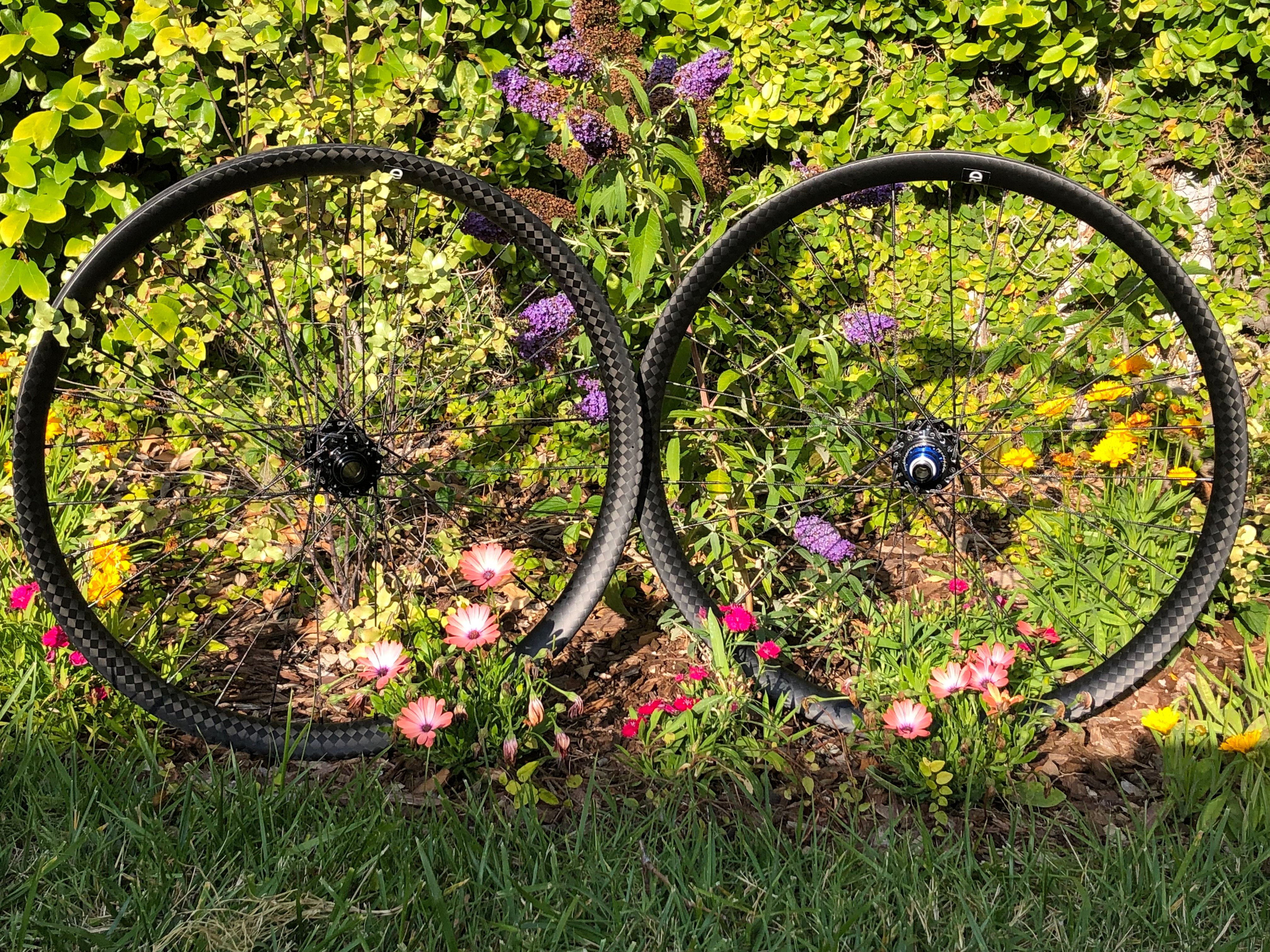

Berd spokes, carbon rims. 🤯
Me too! 1,520g for the set.

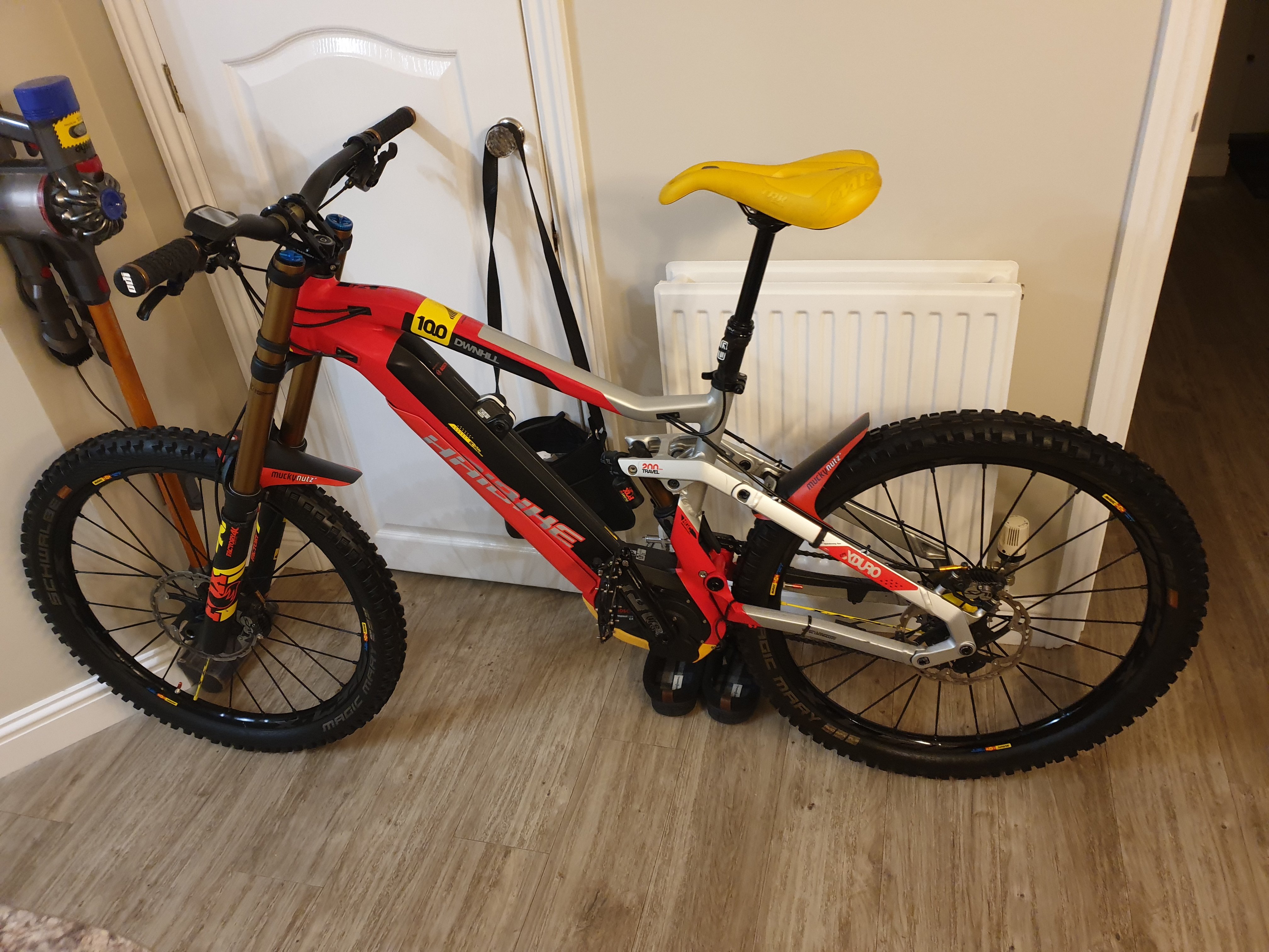

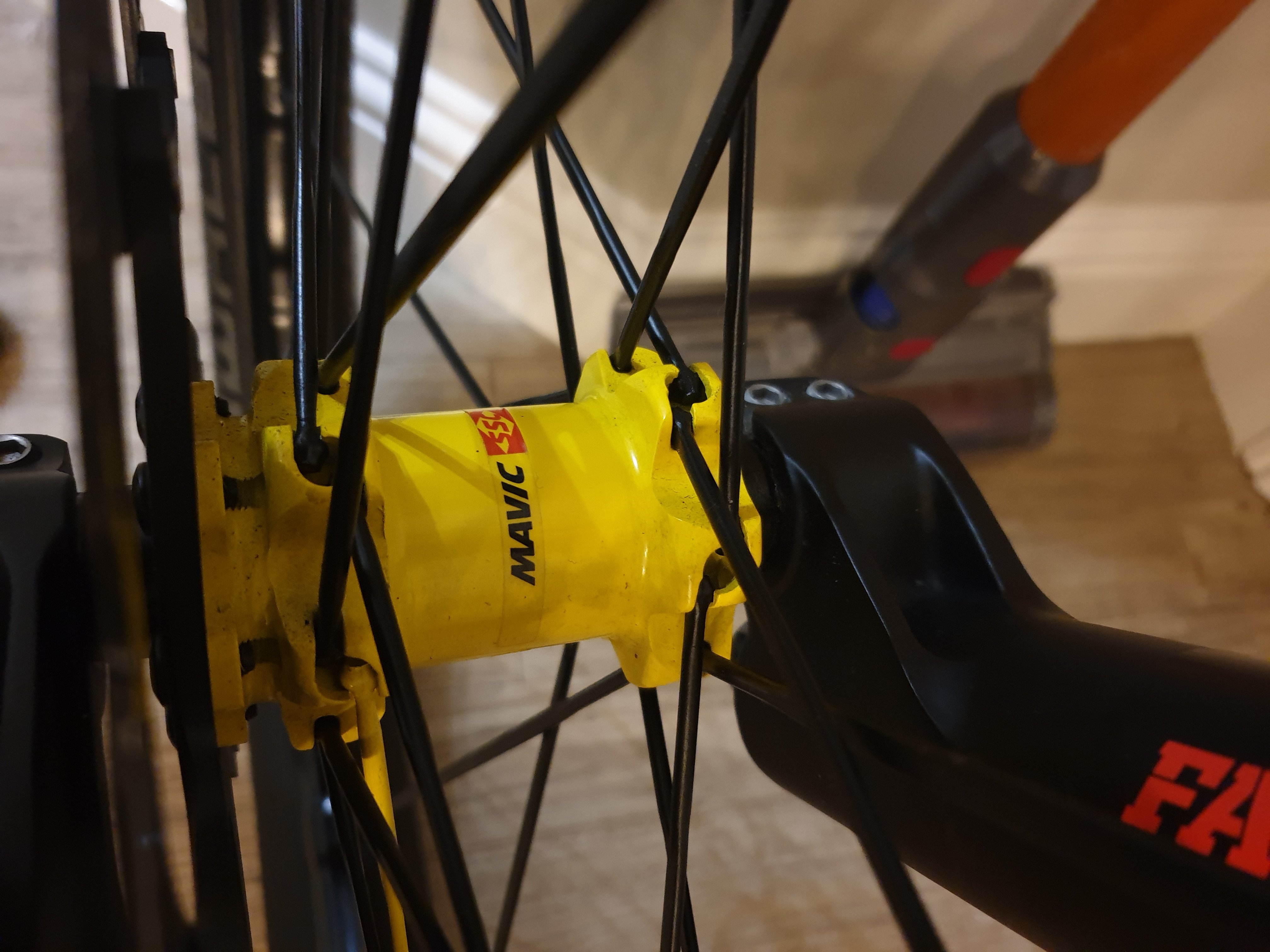

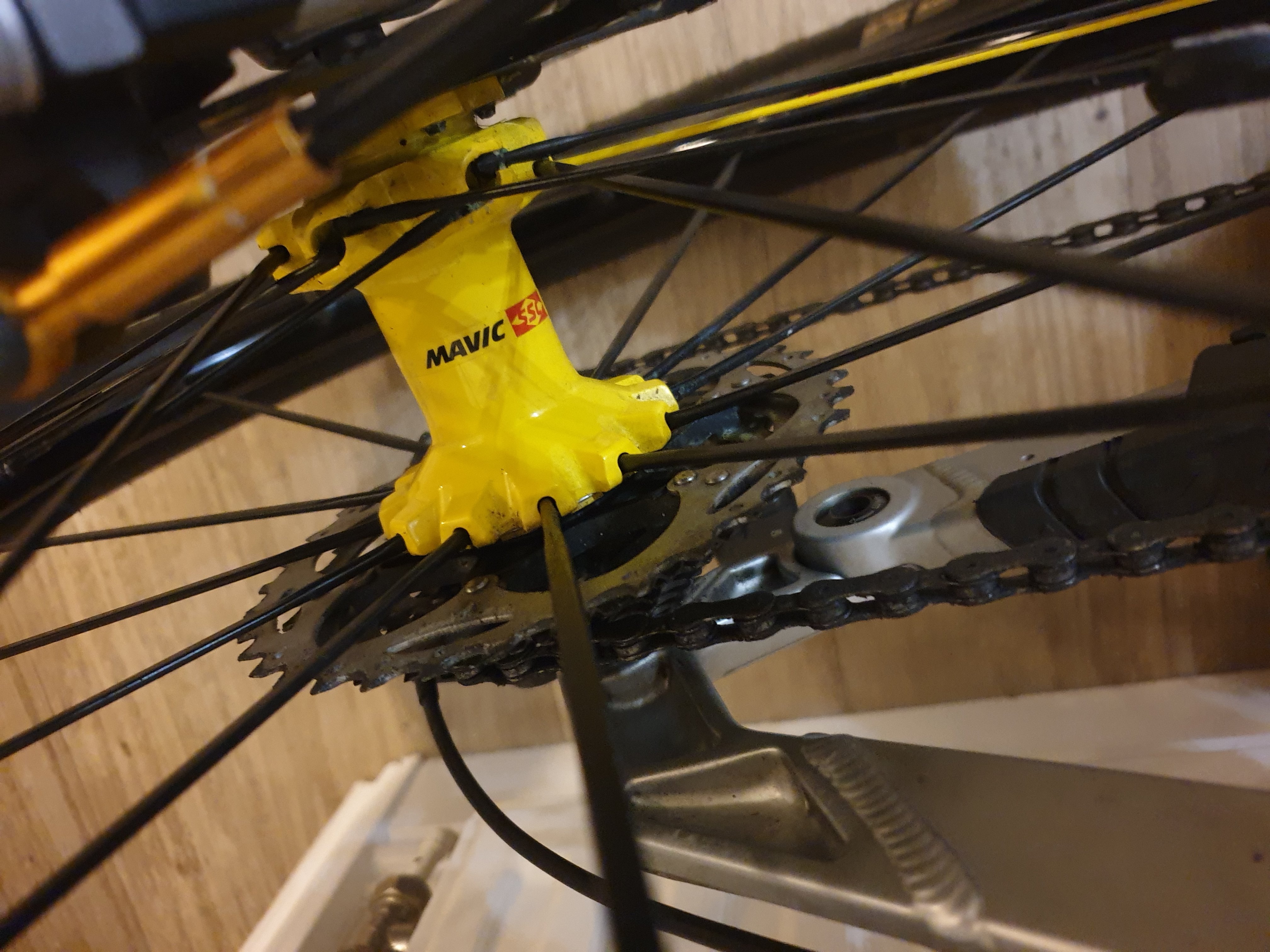

I have Mavic carbon rims on my Hiabike Xduro 10 downhill bike, they were fitted with tubless, but I struck a rock on a knarly decent and it caused a leak through the carbon which I couldnt fix so had to fit a tube. On the aluminim rims on my other bike they just take a bit of a dent but the wheels keep going so I would put to you. If your doing a lot of uphill fell typoe riding and want to save weight, and day long trails then its probably worth it, however if you ride for around 11/2 to 2 hours like I do on knarly trails with lots of lose rocks and do some downhill then stick with aluminum due to the durability. I would swap my wheels around between my bikes but the Cannondale is 29" on both and the Hiabike is 27.5 on both.
View attachment 127283 View attachment 127284 View attachment 127285 View attachment 127286
Makes sense. Thanks. Never seen a droopy saddle nose like
Sorry to hear about Giant warranty. Seems they can effectively deny all of their warranty coverage if they want based on that excuse alone.
