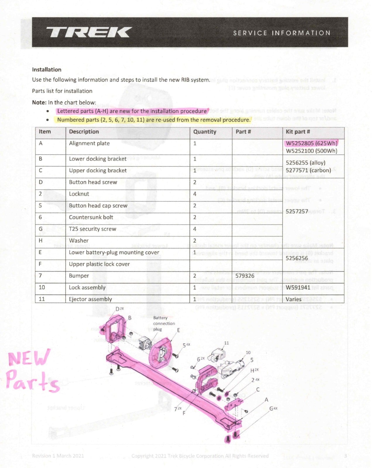

I bought the parts that I higlighted in Pink and changed them (diagram below, all items with letters, not numbers). I followed the Service manual, it was step by step... Sad, the LBS could not get the parts from the distributor, so I bought them myself from multiple sources and countries (around 75 euro). I have a claim in with my LBS and they will give me the parts under warrenty if the distributor ever comes up with them. They claim is in as if I have not yet fixed it. The solution worked great, really, I tried to get it to pop out, and it will not. Before, it was always having an issue.......

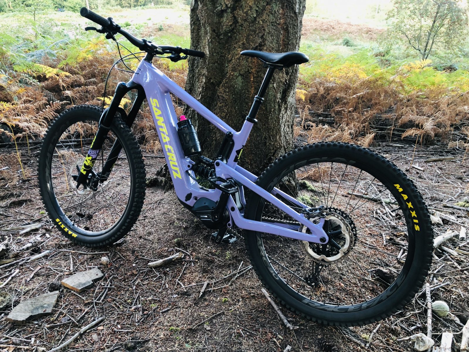

I’ve currently got a SC Bullit XT coil and love it but can’t hide the fact that the motor just isn’t as strong as the Bosh, the 22 Trek 9.8 XT would be what I have been considering swapping to as the spec etc is similar the extra length also is a plus for me as I’m alway inbetween large and XL…….
I like the red smoke colour but not sure it’s as cool as my lavender SC

Sadly this isn’t a fix (battery alignment plate strip) as mine cut out the other day on rocky trail even with two tension straps on. RIB is no bueno I say.

May be the fix for keeping battery from falling out but not from power cutting out on rough terrain due to battery jostling about. LBS got this plate for me and installed and sadly it didn’t correct power cut out at times. I personally believe the weight of the battery in frame like that with tolerances for removal (RIB) act like a jackhammer on the lower connecting plate, pushing it down a bit under load, thus continually recreating extra play up top, thus the jostling and cut out. Continual cycle. I am going to see if LBS can pull up the lower plate to snug things in then I will use tension straps to try to keep battery in place while riding so doesnt clang about

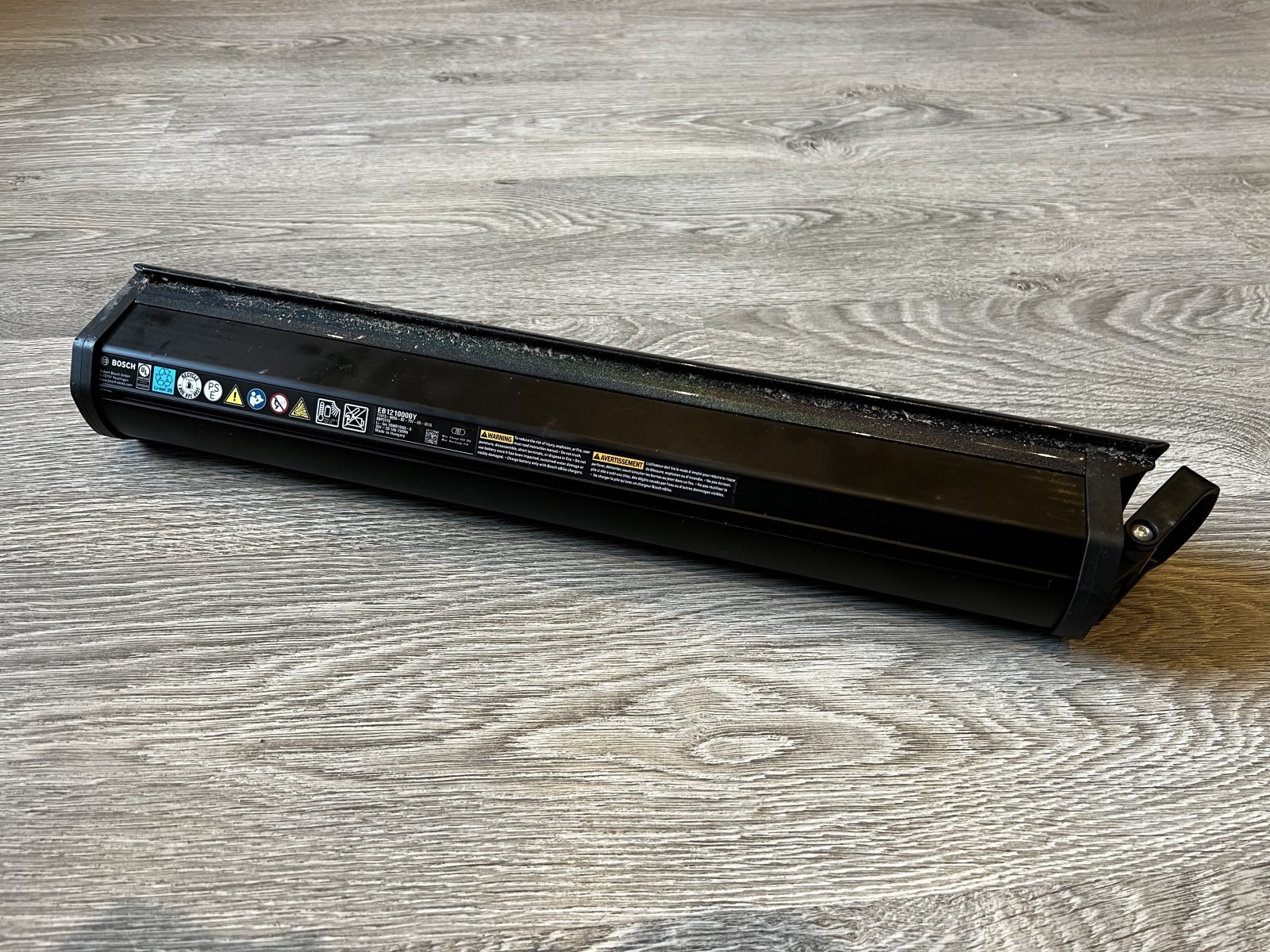

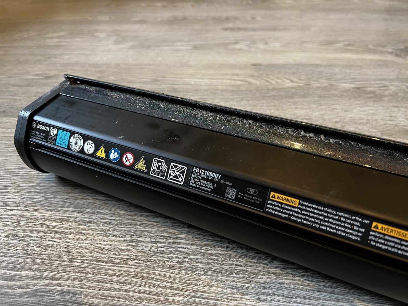

I wonder about the IP rating of the bike given the way the battery fits into the frame. How good is the seal down near the motor where it appears the contacts are? Any water ingress there will be a problem.
I've never had any issue with water ingress on my own rail. Although some mud can seep in slightly under the battery its never been too much of an issue. Here's the new battery after a soaking wet ride:

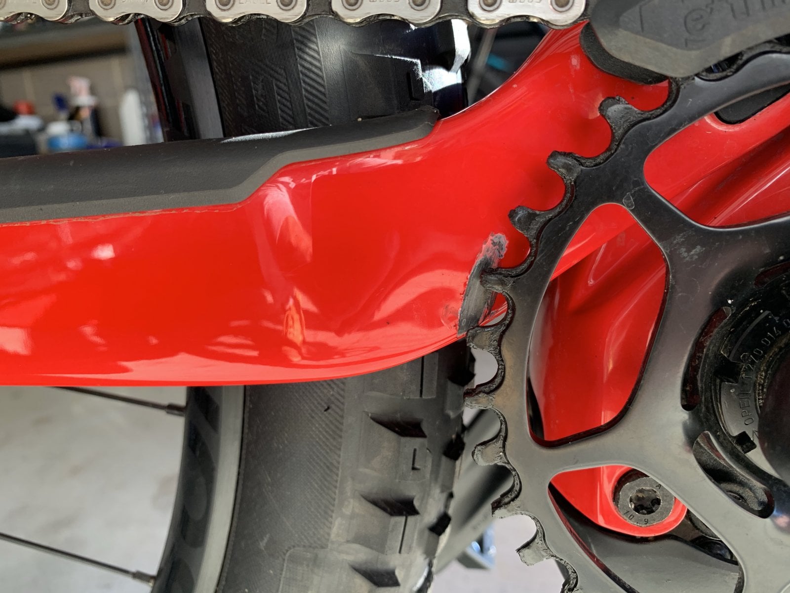

I’m pretty keen on a 9.8 XT. Does anybody know if the gap between the chainring and chain stay has changed at all?
I don’t want to buy a another carbon bike only to have this happen again after the first decent ride on it. And yes everything was tight and as it should be.

I replaced all of the items that I highlighted in pink. Followed the service manual, step by step..... I really tried to get it to pop out again and it is solid now... No issues so far. Finally

My 2020 9.8 looked exactly like that. It was a GX though. I now have the 9.8 XT, and it doesn’t have a single mark from the chainring. I have 1000km on my 2021. Looks like they changed something

I never had the battery drop issue but the power cut plagued me even after Trek (corporate retail store) did the RIB adjustment a couple times, until one of their techs told me what he does: drop the motor cover, loosen the lower battery bracket (the torx on the underside of the downtube) and then use a long hex wrench or something similar to apply pressure to the backside of the lower bracket, through the opened ‘engine compartment’, and tightening the torx while applying pressure. He offered to do it but didn’t have my bike with me and I wanted to fiddle with it myself. I did the RIB procedure first (upper bracket wasn’t quite right). Too much pressure and it’s tough to get the battery out, so test battery removal. I did this with the bike flipped over. Not a single power-cut issue since.

That's what my LBS does as well. Be warned, it's not a permanent fix.
As you note there's the jackhammer effect on the lower brack so I suspect over time I'll have to do it again. So far so good over the same trails I'd been riding all along, about 400 miles over 20-30 rides where previously it would have occurred 3 out of 4 rides. Fingers crossed :)
