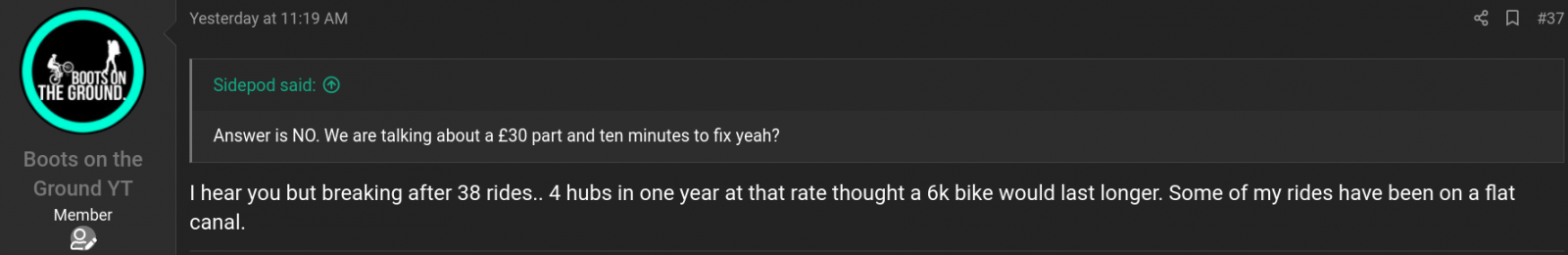

For an example :
Boots has a problem. @Sidepod pointed out that it's no biggie, but you see Boots reply.
For me, if you're passionate about something - you will do ANYTHING to make it work and make it happen. You accept it's imperfections and faults and you try to make those things better. In this case, you improve/upgrade/modify the bike based on your experiences and your requirements.
Boots approach is defeatist. He's had a problem and he extrapolates that problem to it's worse possible scenario even though he might never have a hub fail ever again in his life. Hub's can fail, anything can fail. Sometimes it's our own lack of experience/knowledge. Sometimes it's just unlucky.
If he was truly passionate about it, even from the helpful replies he's had here, wouldn't you be saying "OK guys, how do we fix this and make it better" ... and make a video about that. You might get click bait and all the haters and small minded bigots loving video's about x/y/z is sh1t , but longer term they're boring. It's his positive video's which make the channel worth watching. It's experiences like this which give him the OPPORTUNITY to make interesting video's about how to fumble through diagnosing issues, fix them and improve things.
Boots is obviously a likeable and charismatic character, but I don't think he does himself any favours sometimes with his knee jerk approach, which in turn doesn't do any favours to EMTB. People with no experience seeing video's like this just walk away scared. They don't head off and buy a Merida or an Orbea instead, they just don't buy an EMTB. These people could be future friends you could have shared great experiences with .. but now won't be.

This almost feels personal now, I'm defeatest, I'm not passionate, I want out? Bringing up old videos about brakes, and other topics, what's your real issue here? Jump on pm if you want a chat.
Iv been a rider for 12 years had bikes from orange, trek, Claude butler, muddy Fox and Raleigh I enjoy and love riding I am the first to admit I have little mechanical knowledge on how to fix things.
In the past it has gone to a bike shop or a close friend who is a mechanic would fix things as they genuinely enjoyed it. Lazy? Sure you could say that. I decided on my channel that I would show all aspects of my mistakes no matter how much flack I got off my subscribers such as the brakes which I felt was mud grinding but rode anyway(old video) , because many new riders could and would make the same kind of mistakes. Had I know I would get comments telling me to close my channel or even abuse on social I would still show these things.
Riding through a river.. Yes I did it didn't think the stream was that deep, you think others have not done this as well? Don't be so nieve. I don't do bike maintance Indepth videos because I know I'm not qualified to make them barring the odd clutch video.
So yes I am passionate about riding and mtb, and nobody will tell me that's not how I feel. I wanted my channel to help change my shitty life that how much effort I put into it.
Now it just sounds like you're being irrational and emotional - which is what we're talking about being the issue ? . If you read both my posts in the way they're intended - which I think read pretty clearly .. they don't say that .
I was going to quote them both - but it seems pretty pointless as the second one is only re-quoting the first one to explain what it clearly says anyway.
I've not posted anything about brakes or other video's, so that just sounds like you're lumping other posts in as being me - which again sounds like the same problem. It's fine to complain about things and explain things if they're accurate, but if you're complaining about things which aren't correct you're just giving people the wrong idea about things.
I didn't say you weren't passionate, I said it read like it - I gave an example ! I didn't say you were defeatist, I said your approach was defeatist - which if you read what you've put and think about your approach to the situation - it is ! As I went on to explain why !
If you're only going to read single words and join them together into your own sentence and then blame me for posting your other video's, when I didn't (don't you want people to watch yor videos ??) , then all you're doing is making your own spin on things and if that's your approach then all you'll do is erode peoples respect for you. This isn't a personal thing. You posted an inaccurate video in public, you opened yourself to analysis. You can't cry about the bike breaking and you can't cry about people's reactions, it's not easy, but you have to take things for what they are. You're not "Andy" in the video - you're a youtube influencer called "boots on the ground".
As I said in my post, I think you're a likeable and charismatic guy, I don't have anything against you at all - I just think some of your video's don't represent the facts and I was hoping you'd take what I'd said in the spirit it was intended - which was to think about your content which would lead to improving your channel. It was meant positively.
At no point did I say it was fact or if the issue was Confirmed.
You made a whole video about the motor being broken and how it was going to take so long to fix it and how haibike and yamaha were at fault and how you'd most likely have to get a refund, give it all up and you still had payments to make (which if you got a refund, you wouldn't).
