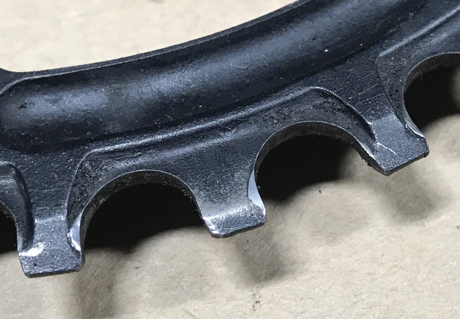

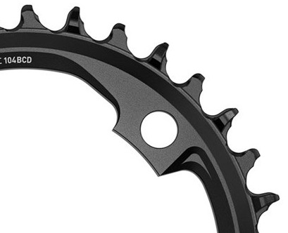

I've had the same issue, took a while to identify it.
See attached video.
Turned out to be the chainring grabbing the inner plates of the chain where the metal at swaged over the tooth, the teeth don't have the classic hooked appearance but closer inspection showed the wear.
Terrible grinding sound amplified by the plastic motor covers.
Replaced with a SRAM Eagle which has lots of relief on the trailing side of the teeth.
See attached video.
Stop pedalling and if the sound is still being made until the chainring stops turning you will know if it's drivetrain related.

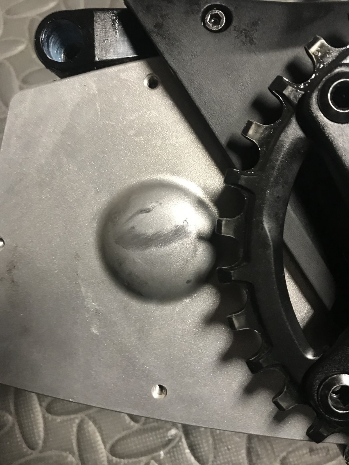

The CREAK IS GONE!!!!!!! Found it on the fourth motor removal. The motor was slightly contacting the right side of the frame and creaking when the left pedal was pressured I’ve greased the motor at the point of course tact and the noise is gone completely intact I’d say it is the quietest it has ever been. See picture below for the offending area and thank you so much for the never ending help from the EMTB Forums Community. YAY!!
