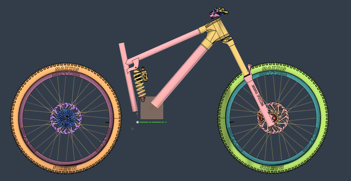

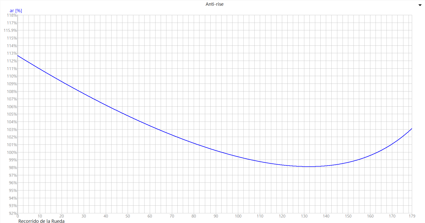

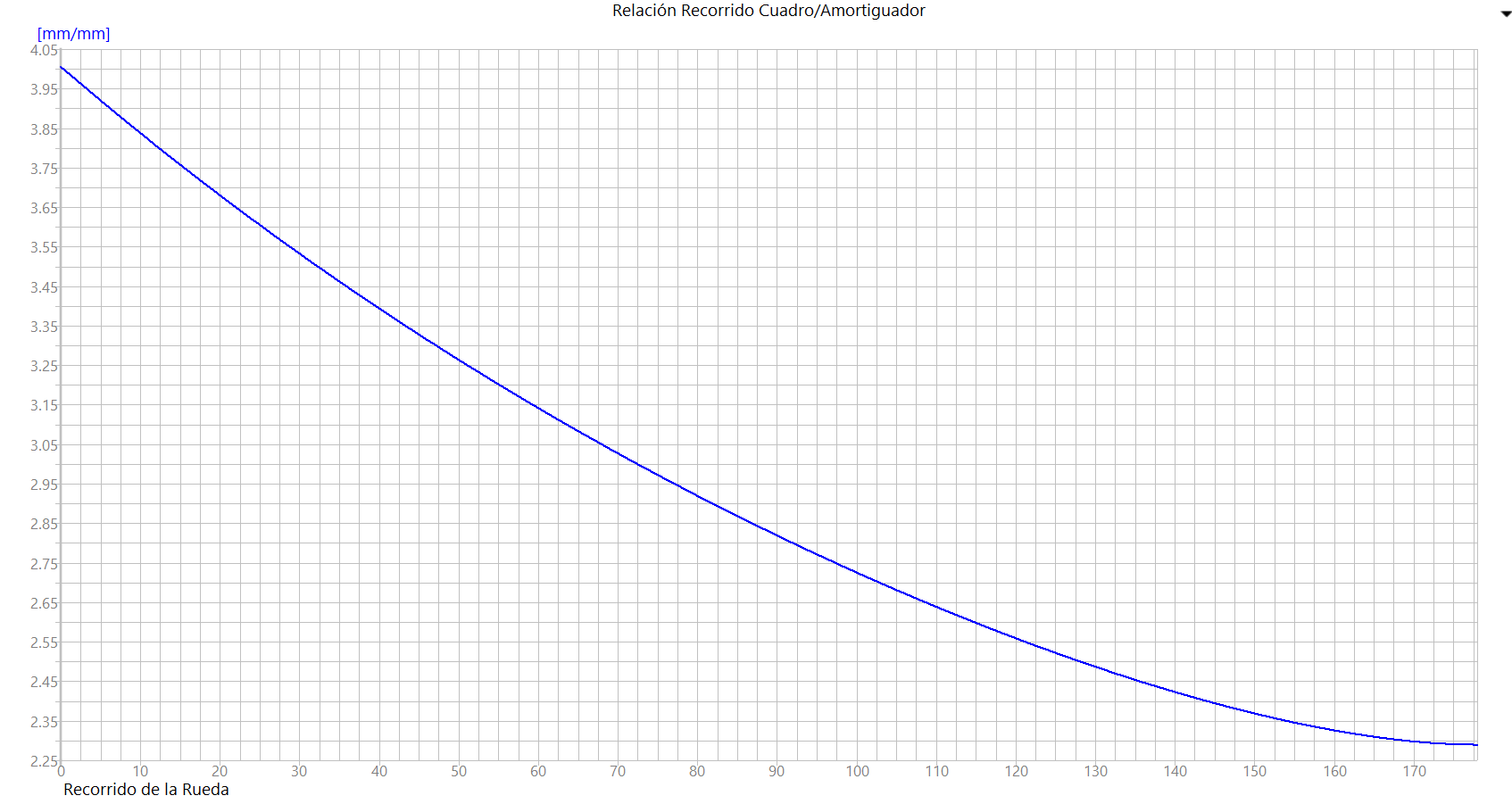

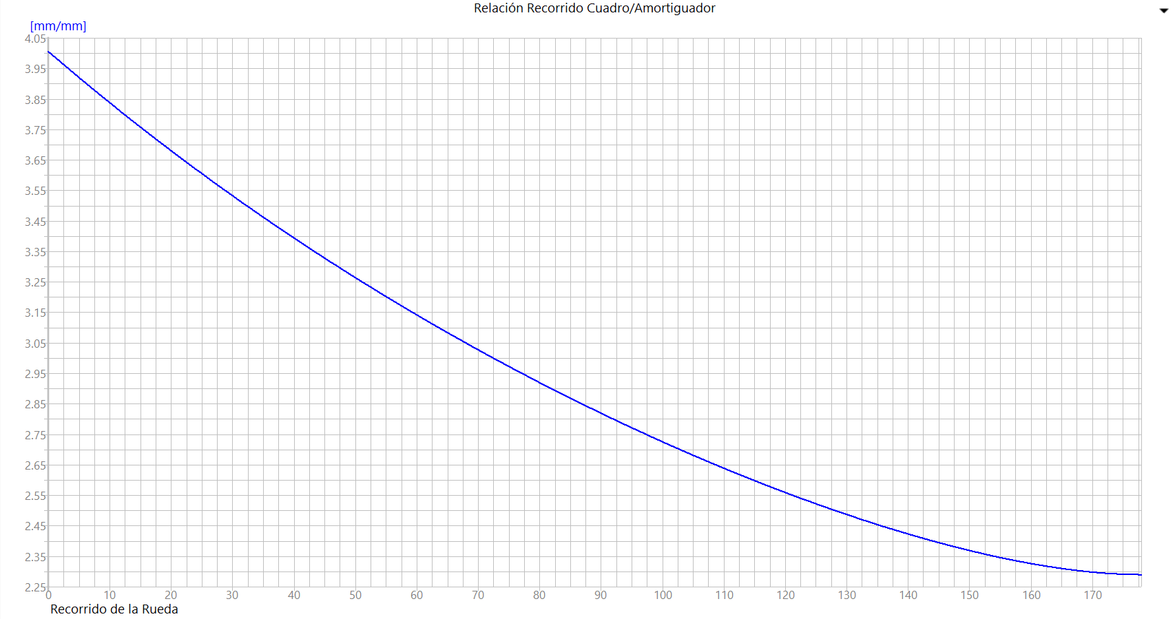

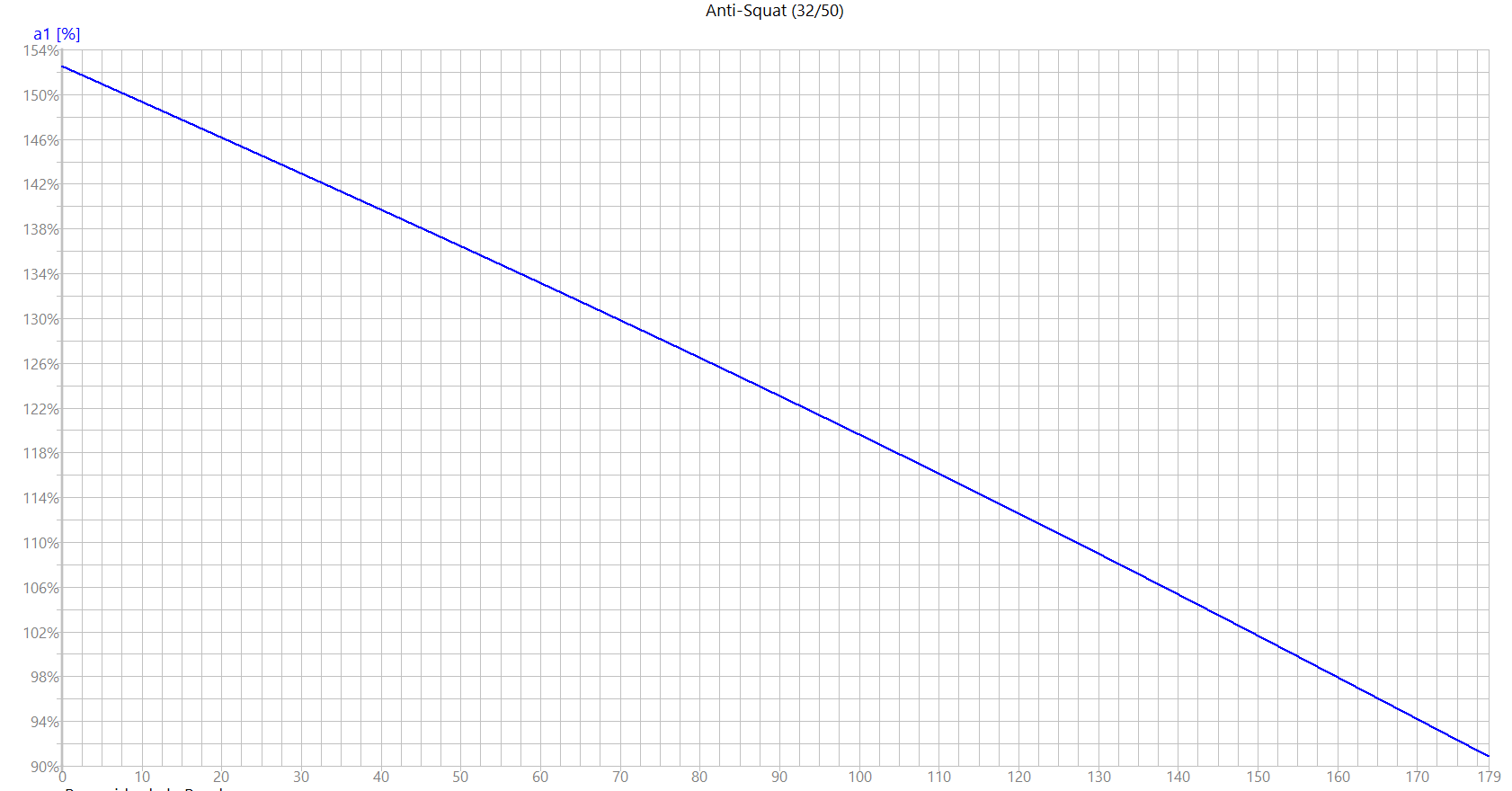

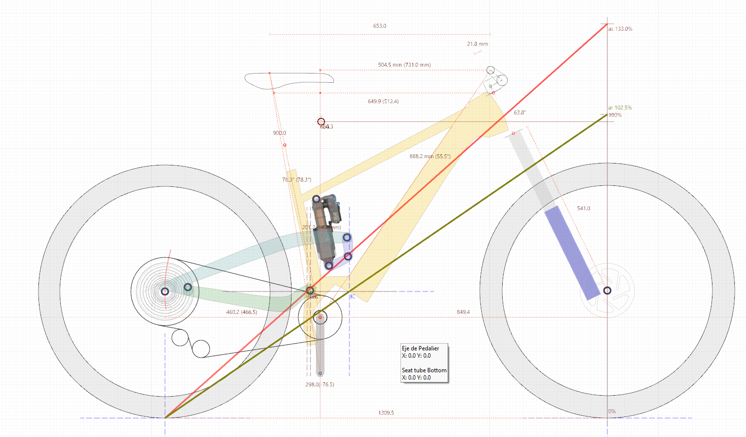

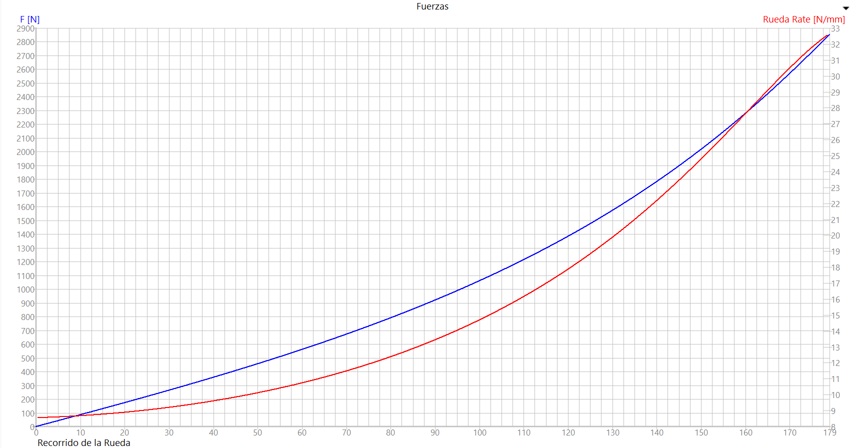

Geo Day​
For this frame, my main focus is downhill performance, so I'm aiming for big suspension travel: 190 mm in the front and around 180 mm in the rear. Ideally, I’ll go with full 29" wheels, using 2.5" or 2.6" tires up front to plow through the roughest terrain imaginable.
Although the focus is on downhill, I don't want to sacrifice too much on uphill performance. I'm planning a steep seat tube angle at 78 degrees for better pedaling efficiency, paired with a slack 63.5-degree head angle to keep it stable on descents. Being about 195 cm tall, this will be a big bike with a reach of around 510 mm. The rest of the geometry will be dialed in using Linkage X3 software, but I can say I’m aiming for a relatively low bottom bracket drop and longer chainstays, to keep me centered in the bike rather than too far over the rear.
In terms of pedaling and suspension characteristics, I’m targeting anti-squat values in the climbing gears starting around 150%, gradually lowering as the suspension compresses to maintain sensitivity while reducing bob and squat. For anti-rise, my goal is to minimize braking squat as much as possible, so the bike stays predictable under heavy braking, especially on steep, technical terrain. Ideally, I’ll aim for anti-rise to be close to 100% throughout the suspension travel, ensuring stability on descents like North Shore-style slabs.
I'll be sharing the initial geometry from my first sketches below (this will likely evolve as I move into 3D CAD work), but it sets a solid foundation to work from.
Main sketch at 30%sag

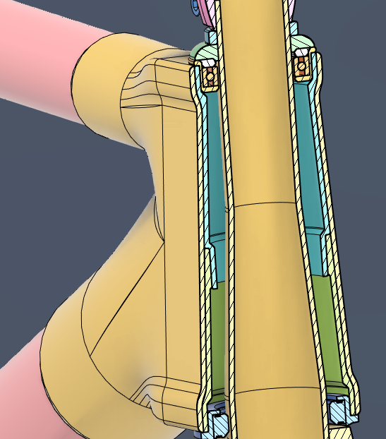

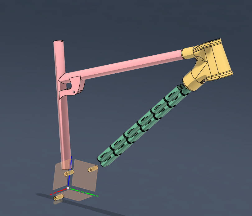

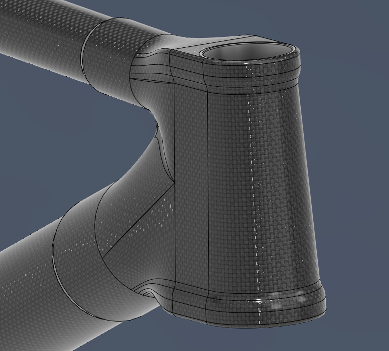

Hello everyone,
It’s time for the first update on the CAD work for the eBike build. After some fine-tuning of the geometry to improve tire clearance at full drop, I’ve now moved on to drafting the front triangle and deciding on the battery configuration.
Battery: After reviewing various options and taking into account the typical consumption of the motor, I’ve settled on a slightly smaller battery than I initially planned. The final choice is a 530Wh unit, which, according to my calculations, should provide plenty of range—enough for between 1,100 to 1,500 meters of climbing under mixed assist modes. The battery is projected to weigh around 2 kg when fully built using conventional cells, striking a good balance between weight savings and range.
Frame: For the front triangle, I’m going with a fairly standard battery layout inside the down tube. The construction will combine carbon fiber tubes with a carbon plug headtube and a forged carbon shock mount to keep the weight down while maintaining structural integrity.
One thing I haven’t started designing yet is the motor mount. I’ll be holding off on that until I receive the motor and can 3D scan it to ensure perfect fitment. That step will come later in the process once I have all the necessary data on hand.
I’ll also be posting some snapshots of the current CAD model so you can see where things are at right now and give your input!
Now, I’d love to get some feedback from the community as I’m working on the design for the rear triangle. I’m still figuring out the best shape for the axle dropouts and derailleur mount. If anyone has suggestions, tips, or even drawings that could help me avoid potential issues down the line, I’d really appreciate it!
Thanks in advance for your input!
I would also go for the M820, it gives you more design freedom and is plenty strong.
You seems to be out of my league with what you are doing, but wouldn’t it be better to start from suspension linkage and from there work out where all the other parts go? You have the shock mount already in place and don’t have the rear triangle figured out yet. Maybe copying some known well working linkage and go from there. A linkage driven single pivot design would probably be a safe choice. Like the nukeproof giga, if you want long travel. There are loads to choose from but suspension design is not easy to get right, even the big brands get it wrong sometimes.
I was using Linkage X3 when planning a Marinobikes full suspension bike. I did learn a lot about linkage just by playing around there.
I really enjoy following your project so keep going!

Hey Freda, my initial plan was to go with the M820 motor, but I couldn’t get my hands on one. Luckily, someone here offered me an M510 at a great price, so I decided to go with that 😅.
As for the linkages, if you check my earlier posts, you’ll find the full simulation along with the geometry values that I pulled from Linkage X3. In the CAD, I’ve started working on everything I can before scanning the motor, which is why the motor mount and rear triangle anchor points aren’t included yet.
Thanks for your feedback!
