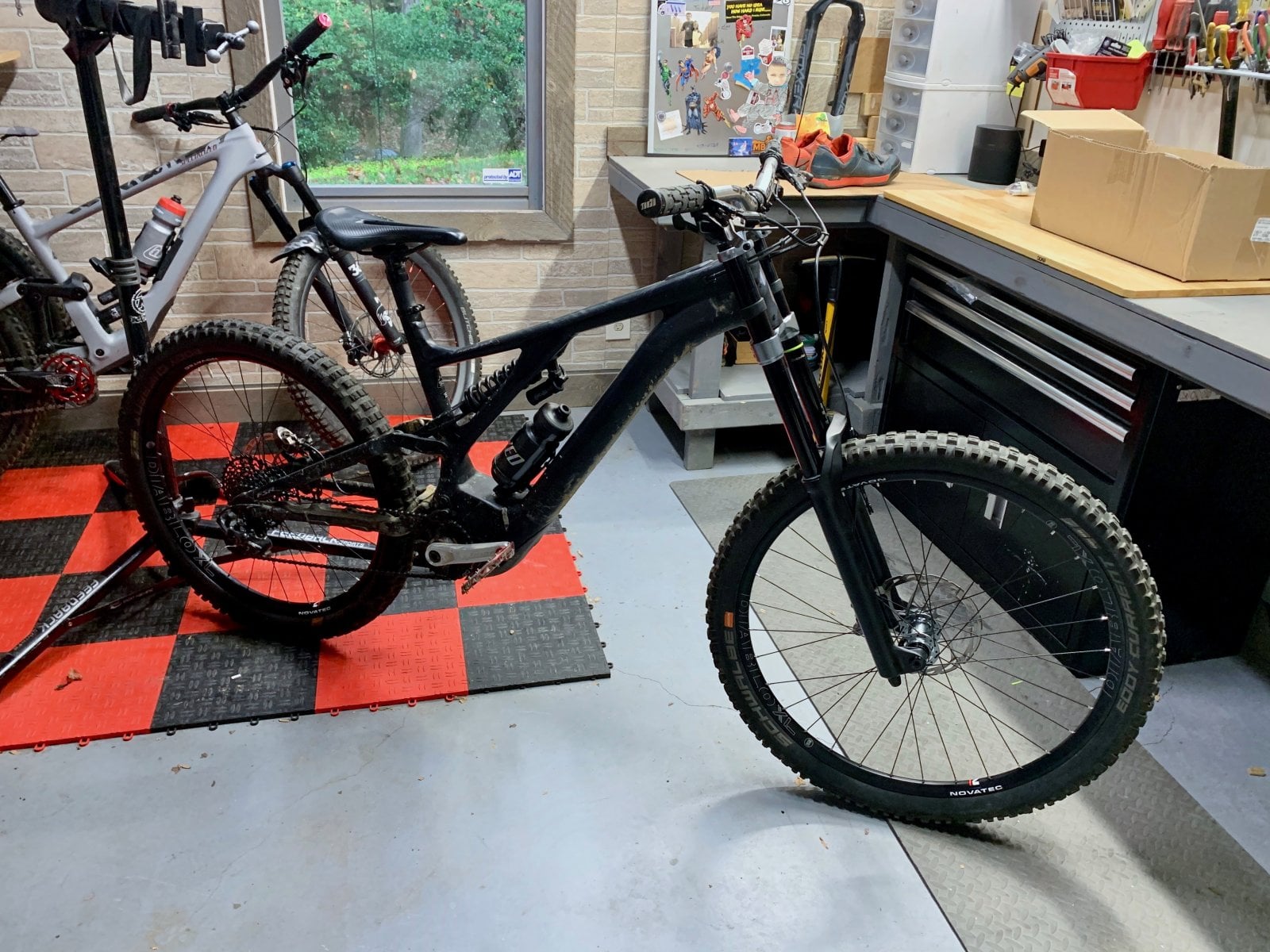

Went with the Zeb Ultimate 180 and a Crankbrothers Synthesis up front. Toned it down from the Fox 49 before that but was able to keep the ride height more or less the same.

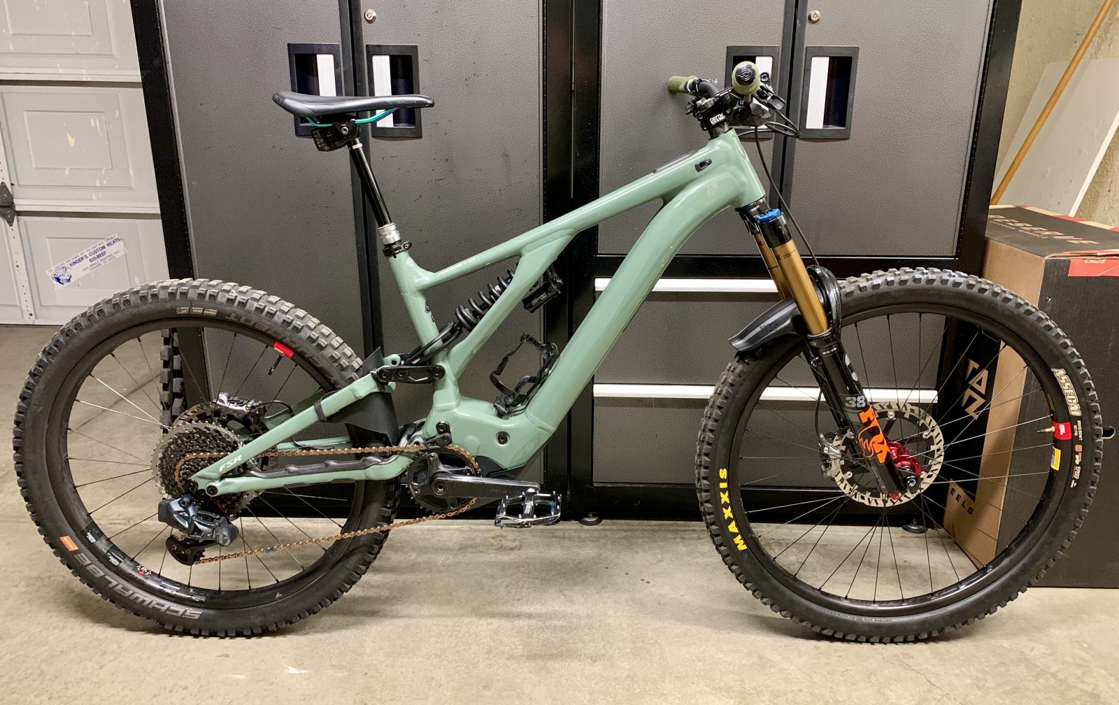

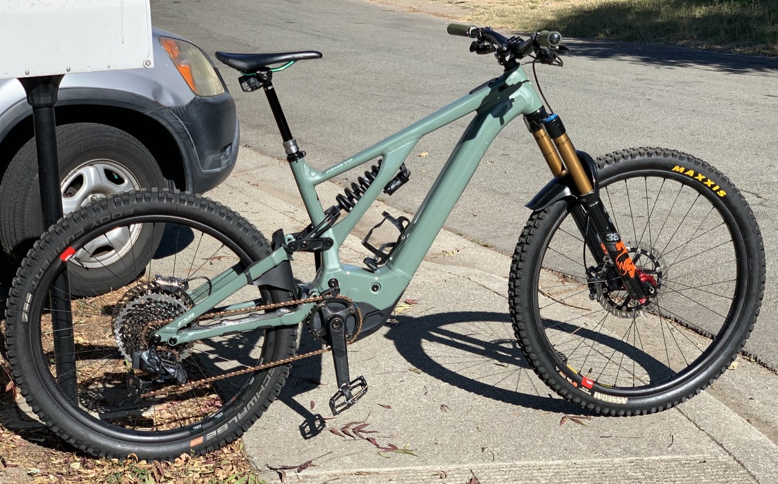

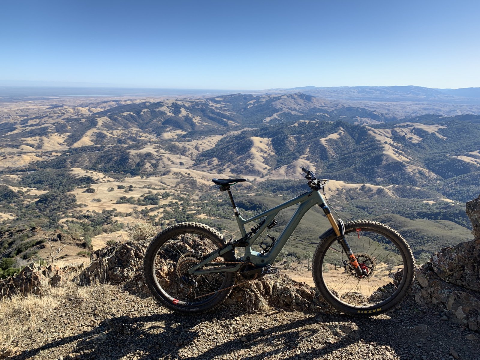

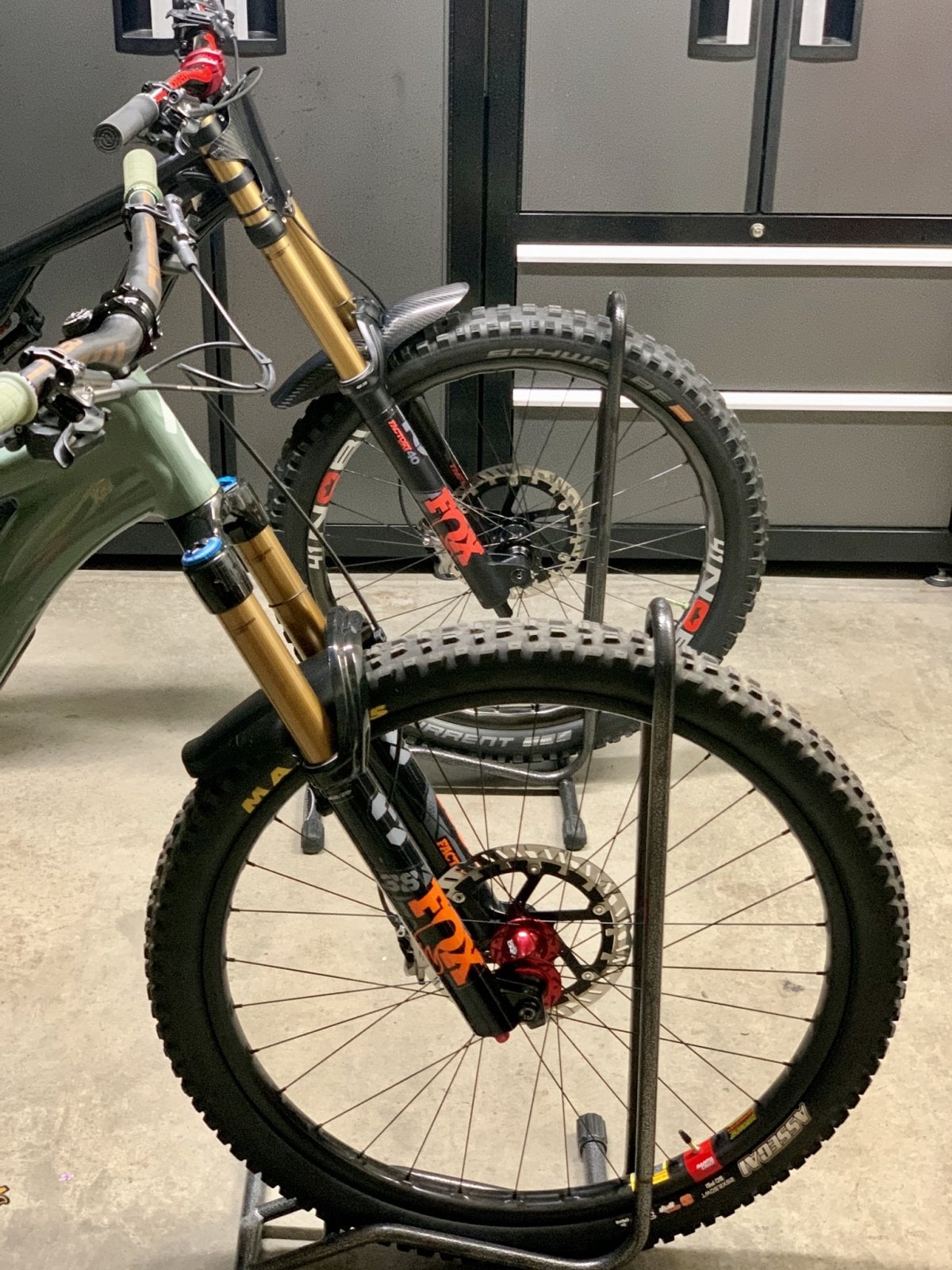

You’ll need a 29er fork. I used my extra fox 38 29er 170mm fork. Stock boxxer will have tight clearances between tire and fork if you fit it with a 29er wheel.
I sold my friend a fox 49, pictured, and he still needs a 29er wheel. I am waiting for my 2021 fox 40 to arrive then I’ll have a dual crown mullet.

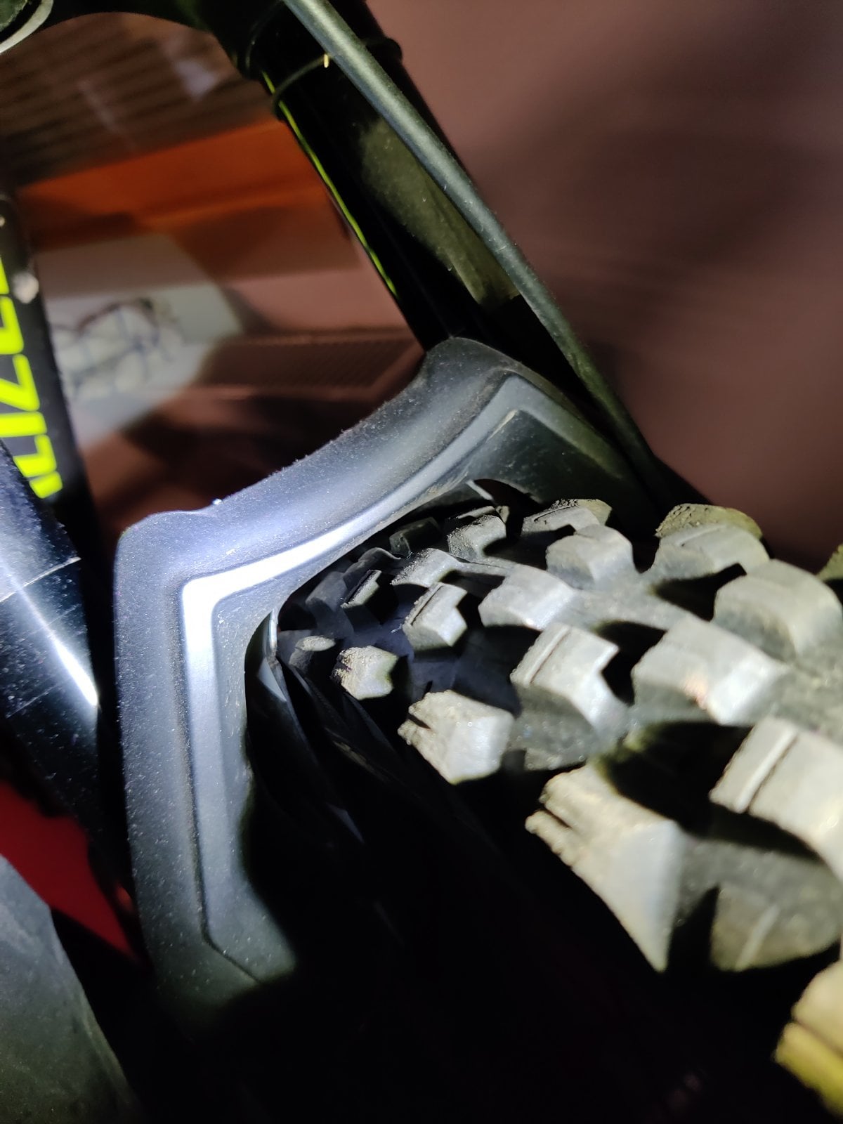

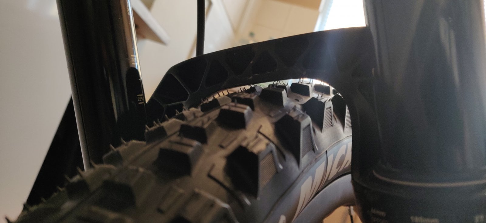

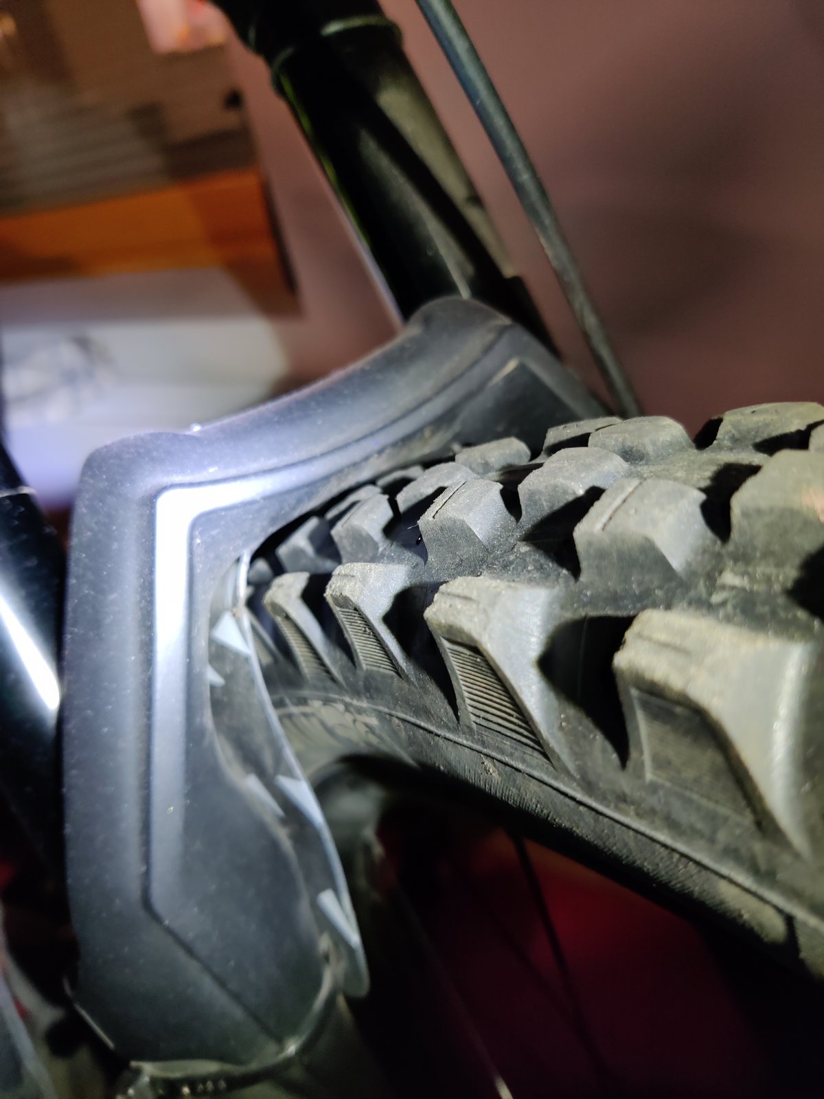

I have ridden this summer with mullet mode. With original fork Zoggi Z1 Bomber and 2.3 and 2.4 wide tire. Not much clearance.
It is good to try the mullet mode before buying a new fork, if you don't like it.
Because I'm keeping the mullet, now I have to buy a new fork or change the lower legs. Zoggi and Fox 36 29" legs are fine.
If I end up buying a new fork, I’ll pretty likely buy a Rockshox Lyrik or Zeb fork. Their maintenance and spare parts are cheaper than Fox's and there is not much difference in operation.
Any chance of seeing a pic showing the 29 clearance on the original Z1 fork ? ..

Hurray my rim, hub, spokes and 2.6 tyre have arrived! Slapped it all together and yes, the 29 boxxer lowers are definitely needed with about a 2mm gap on the 27.5 lowers.
Hopefully they will be here by the end of the week.
EDIT although the spokes are too short. Santa Cruz have increased the erd of the 30mm rim by 6mm since I lasted looked. More spokes ordered.

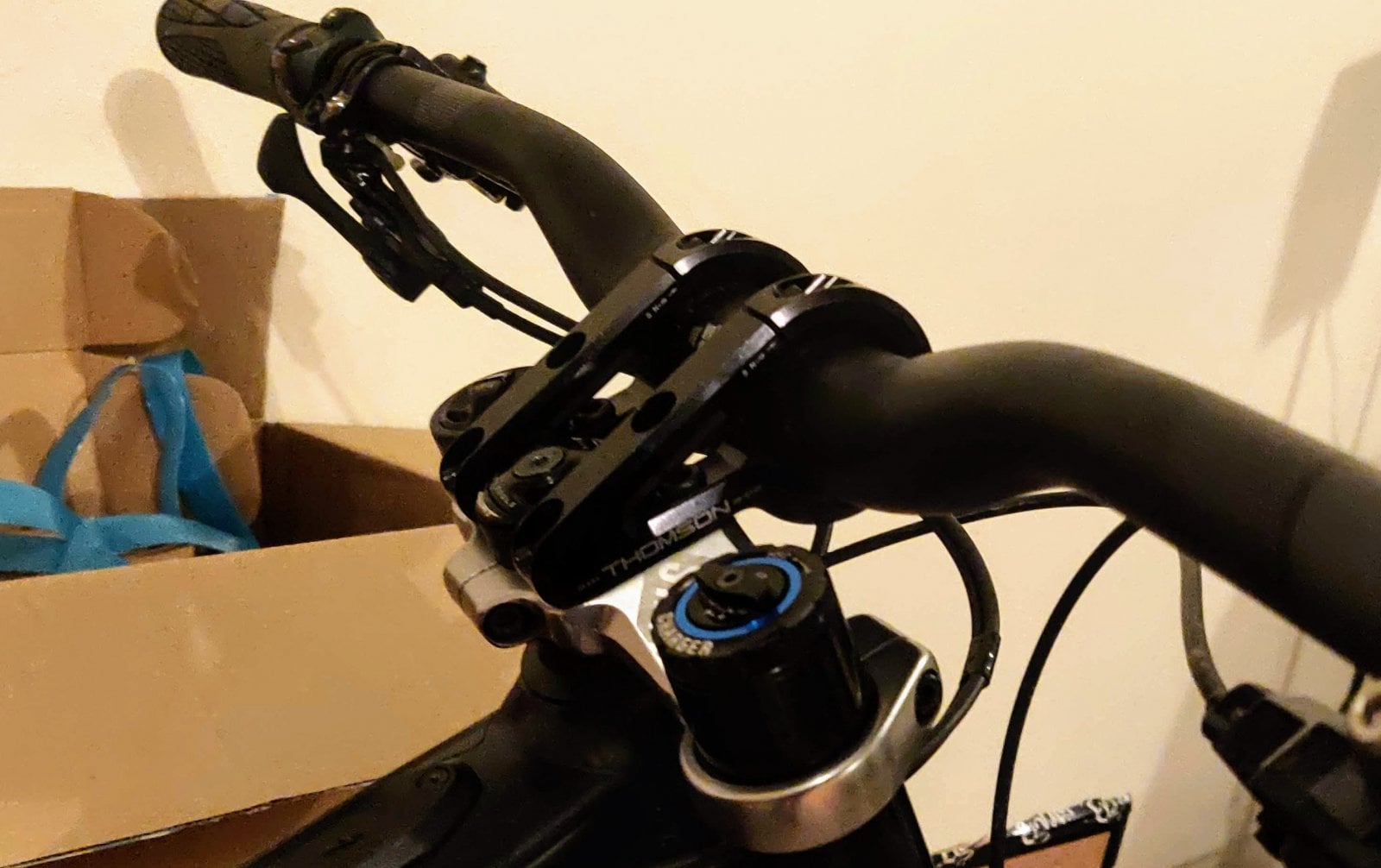

I try to compensate it by reducing the suspension by 10mm and taking one 5mm spacer out from under the stem.
Ive ordered the thomson direct mount stem as it was on offer @ £55, which will drop my bars by 20mm. It was cheaper than a new set of bars as ive only had these a few weeks! Plus the stock stem is a bit cheap looking.
Handlebar height should only be approx 10mm higher than it is currently once this is all complete :)

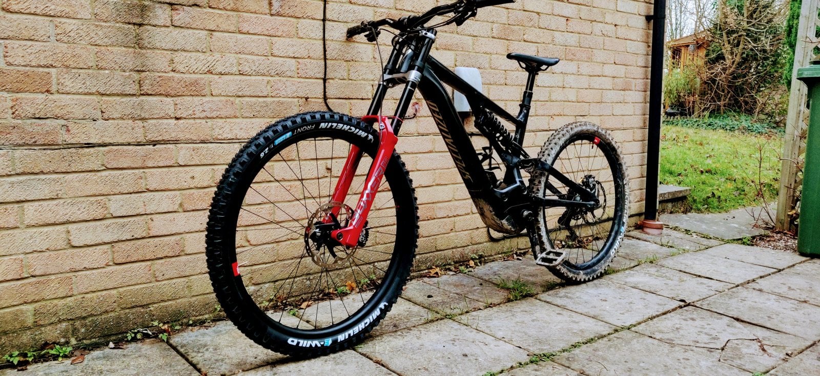

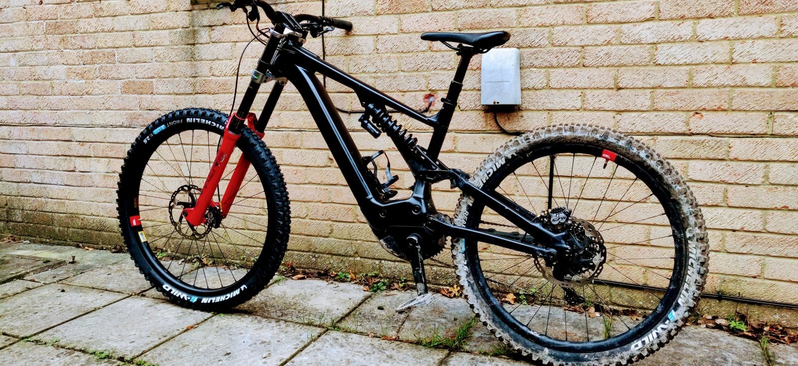

So my project is compete.
boxxer 29 lowers from bikeinn £320
ewild tyre from merlin £40
Thomson drop stem from merlin £55
santa cruz reserve rim from 18bikes £580
dt 350 hub from bike24 £50
dt swiss comp spokes & nipples x2 from bike24 £65 (I had to buy twice, as SC have changed the erd of the 30mm rim, from 590mm to 596mm on the am29-02 rim. So the spokes I ordered at 290mm were not long enough, 293mm required)
I have a 190mm airsrping & the shock is in the low position.
BB has increased from 340mm to 346mm
HA from 63 to 62 degrees
Bottom of bar height has increased from 1015mm to 1020mm
s4 with 15mm spacers under top crown
The modest height increase of the bars was due to what I detailed a few posts up, changing the boxxers to the sram setting of 163mm + using a thomson drop stem. which brought the bars down 15mm from standard.
Hopefully will get a ride in tomorrow to test.

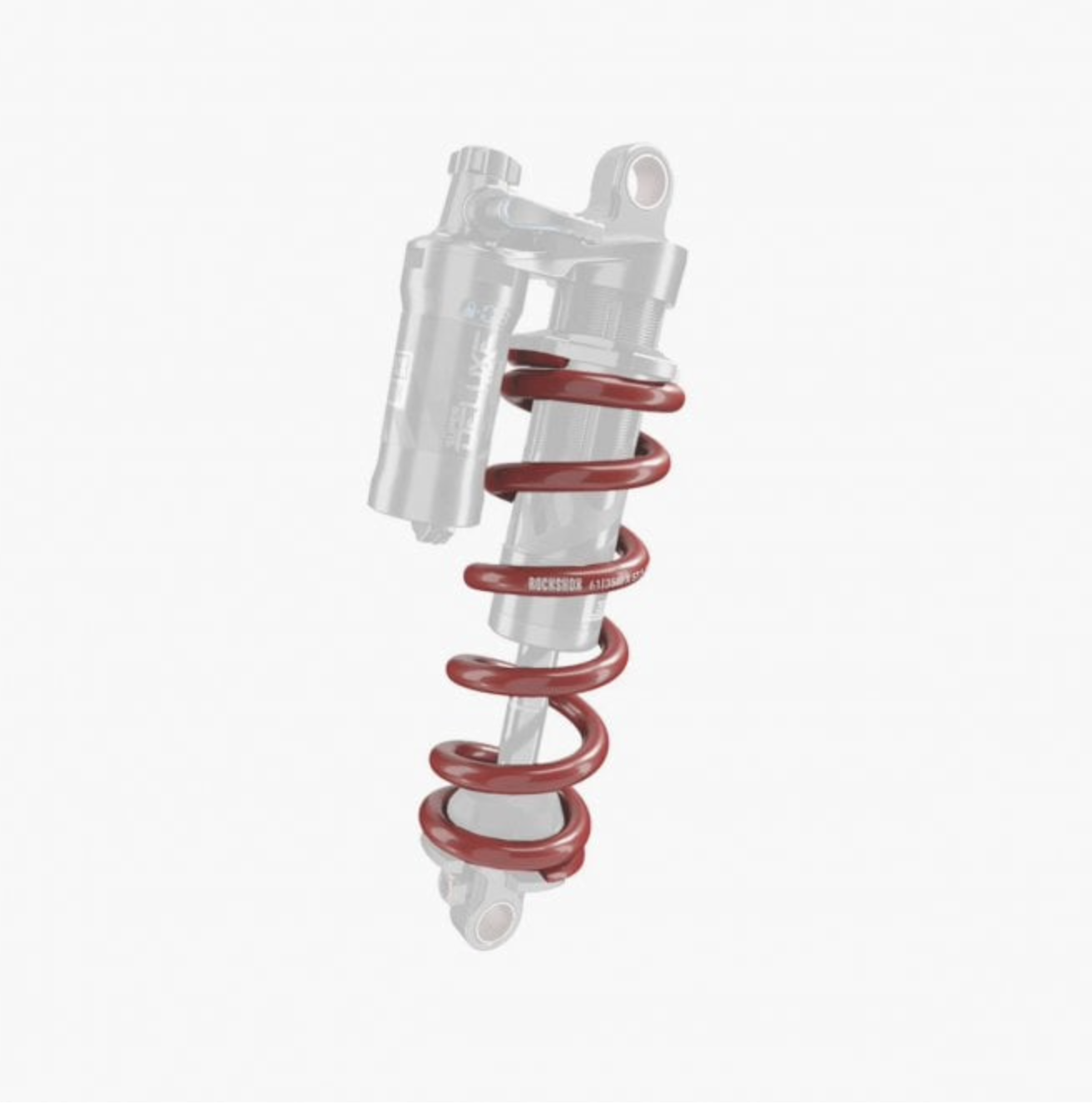

If you use a Levo shock link bracket and run a 10 to 12mm longer shock with around a 69/70mm stroke you can get 200mm travel without any problems.
