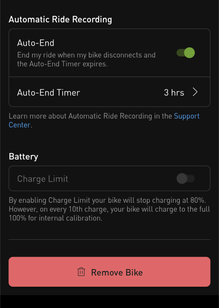

Mine is greyed out.
Android phone
App ver 1.26.0

My first charge when this happened went to 80%.
Went out for a ride battery about 45% when I got home.
Charged the bike again. This time it went to 100%
Been charging to 100% ever since.
In my screen shot you see it greyed out so it's at least charging to what it should do

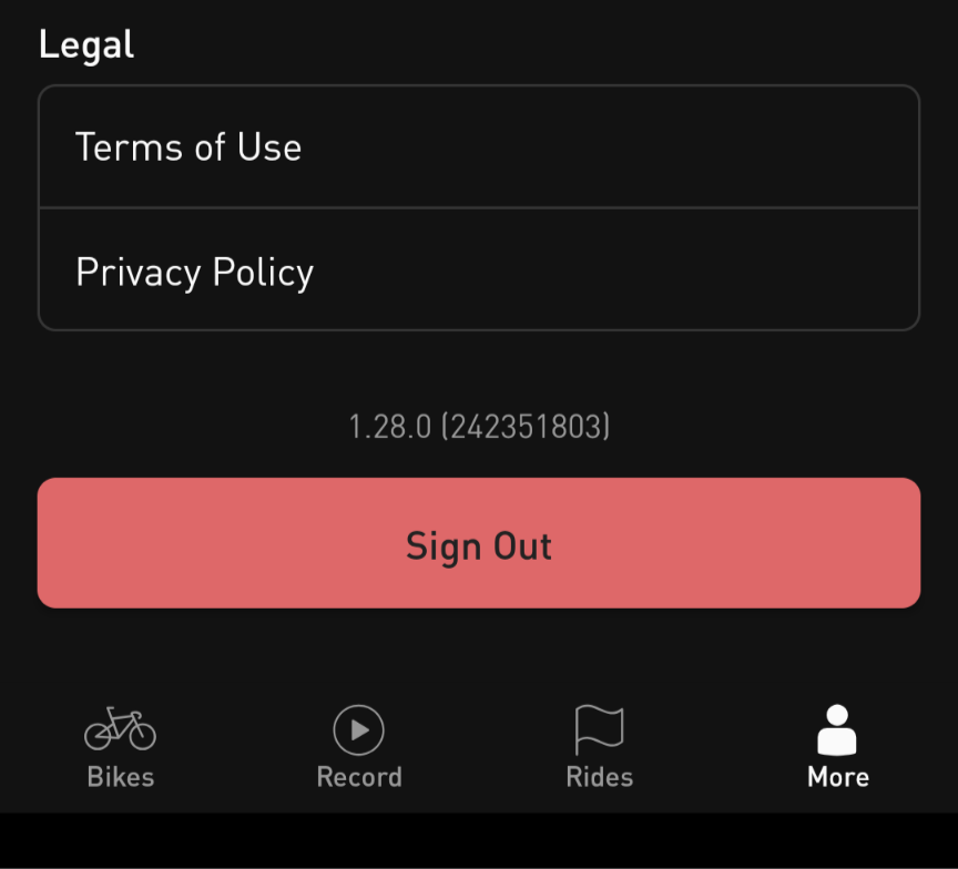

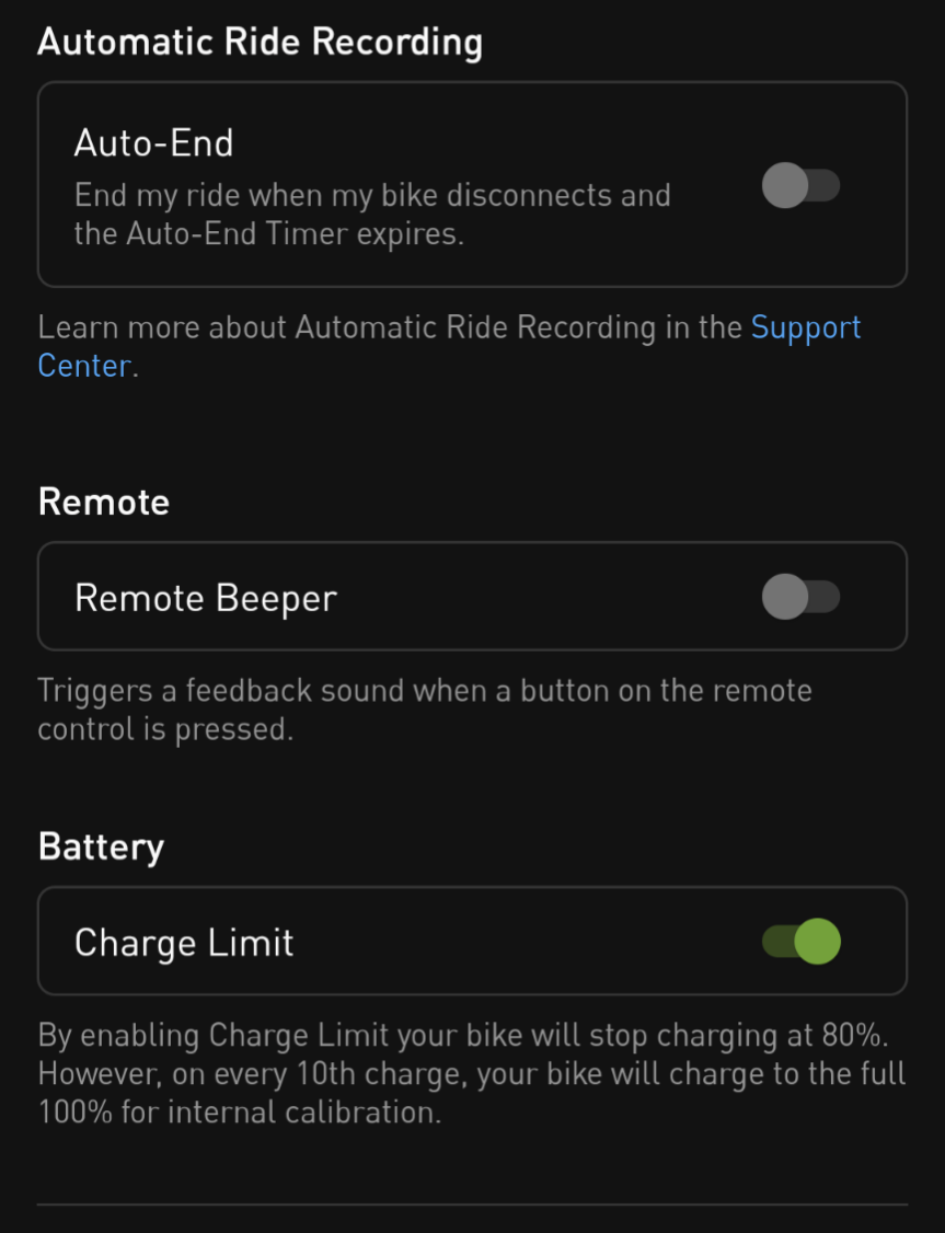

I read in another forum, that there was an firmware update in January 2024 and only those bikes without this update (= my bike) struggle with the App/do not have the 80% limit button anymore. Can anyone confirm, that he has made a firmware upgrade in spring and still have the possibility in the app to reduce to 80%?
Ponzy
Aug 18, 2024
Somerset UK
I took mine into lbs for this reason, it just needed an update and sorted it, charge limit appeared again when I opened the app. Even said on the workshop laptop that it will re appear once updated. Bit cheeky of Specialized to basically blackmail us into updating.

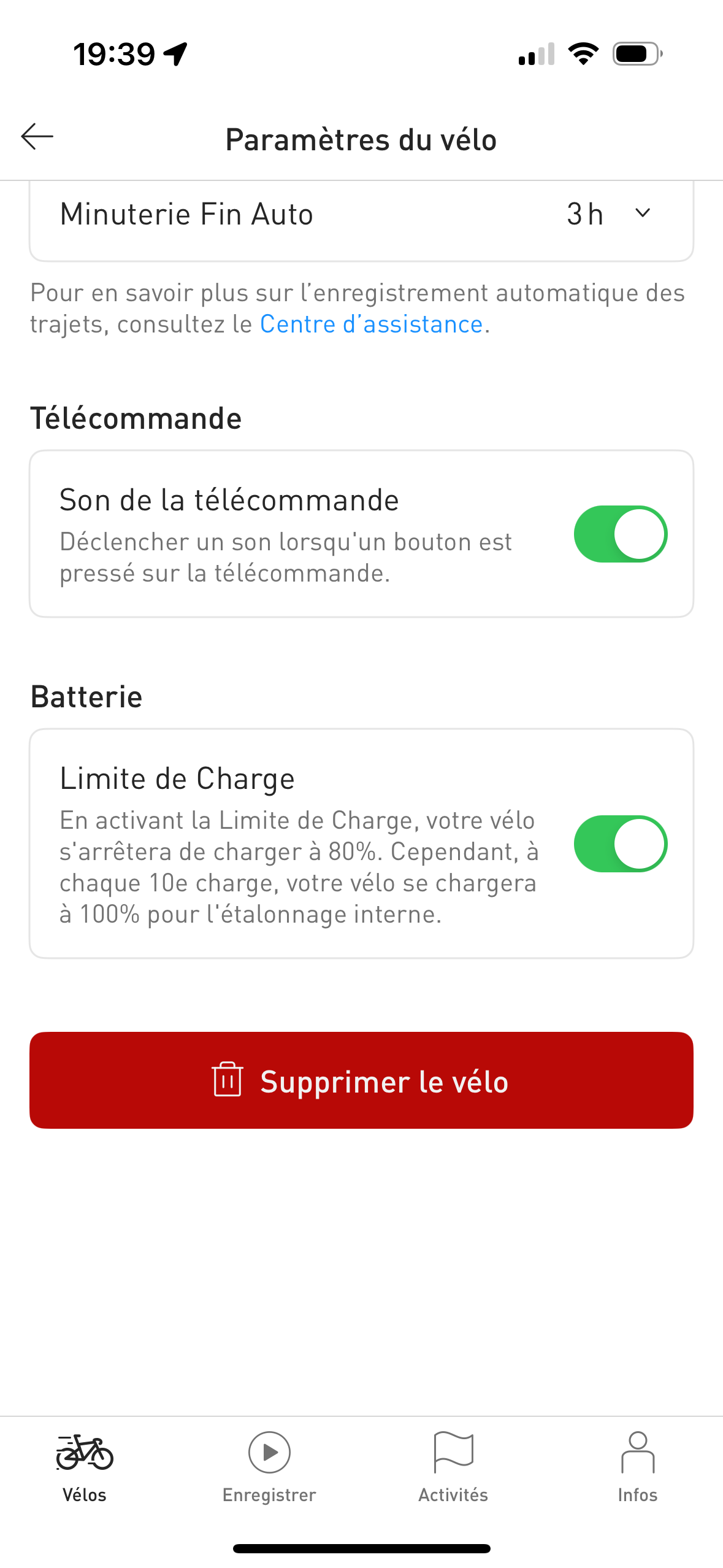

Yes, the button can be found in the app, but it just doesn't work. Always tries to fully charge.
I read on another forum that it would not work if the battery capacity is not less than 35%.
However, I have not tested whether the rumor is true.

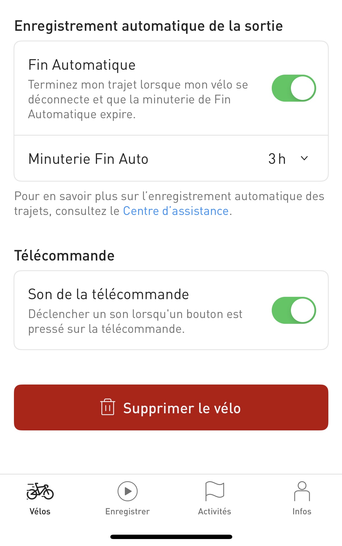

RichMorr
Jun 16, 2024
89
69
Uk

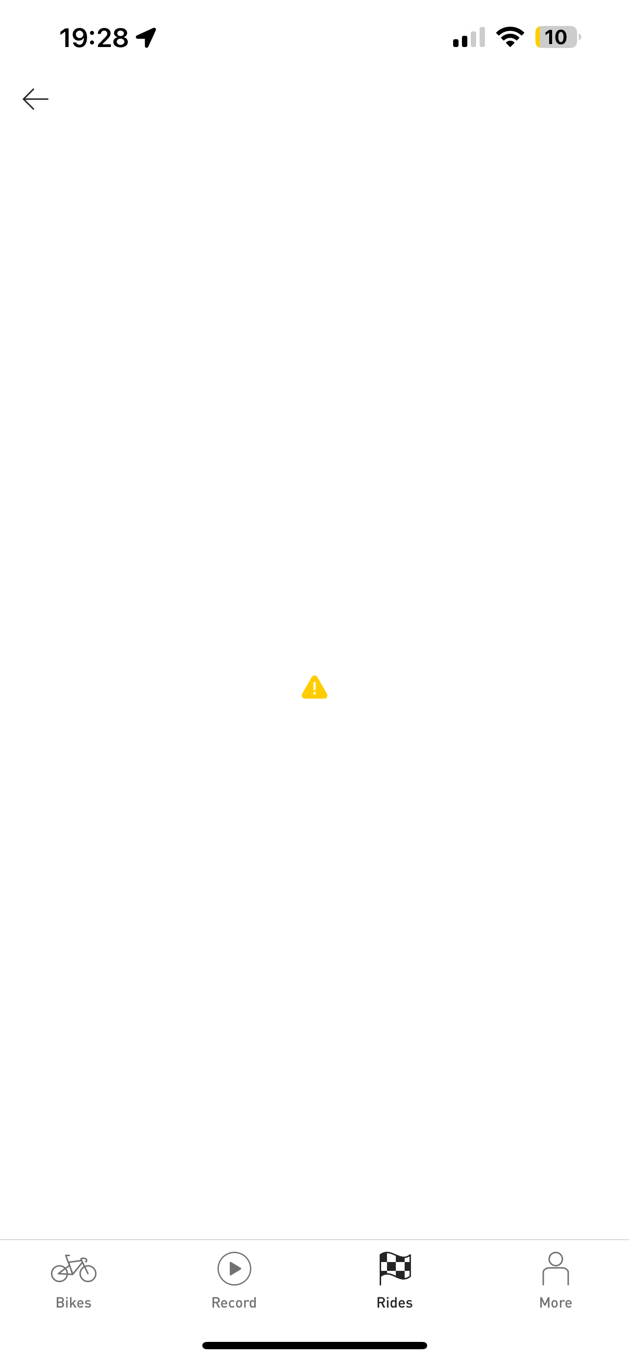

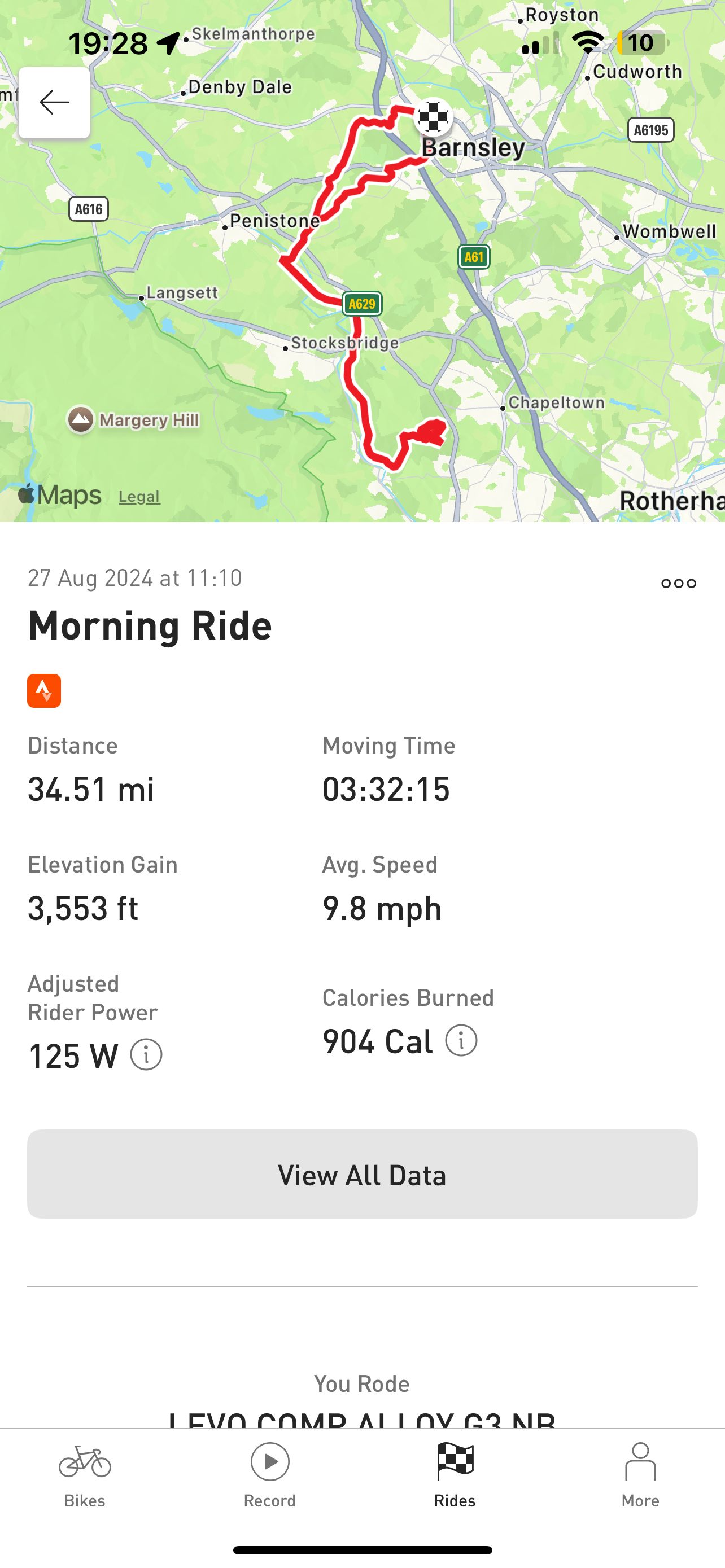

The update seems to have a bug on mine when I click on view all date I get only an error message
