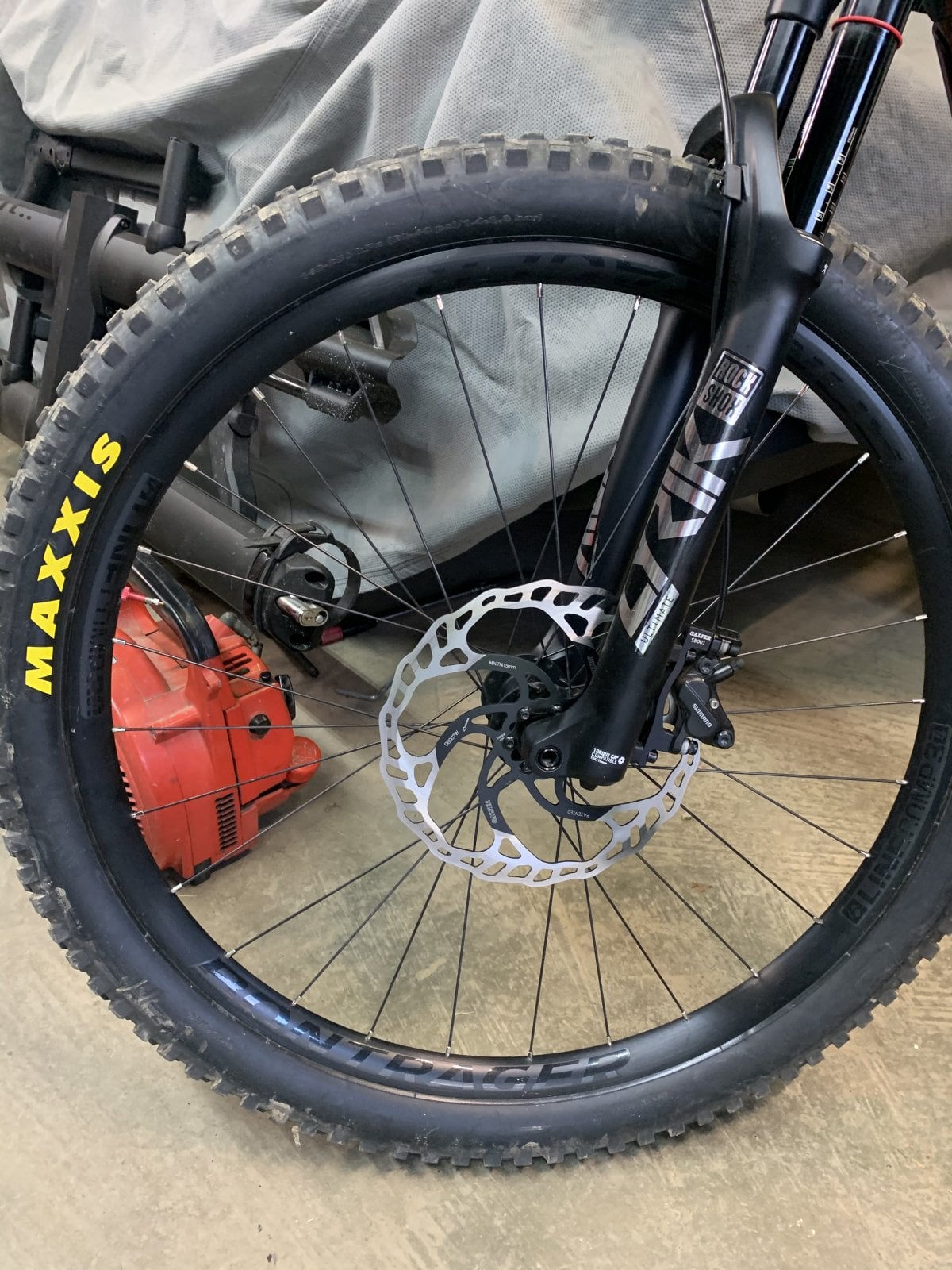

I ride this bike better than any bike I have ever ridden! No mechanical issues at all. The bike has been very reliable. At 500 miles tires are worn out, chain is still in spec. I plan on replacing the tires with the OME ones. The only thing about the bike I don't like is the front brake, its not powerful enough. I ride fast and my front brake gets super HOT and is slow to stopping. I would like to upgrade the front brake to something better, other than that I recommend this bike!

Porsche rotor upgrade

I found the same with the standard brakes, after trying a couple of different pad compounds I fitted a set of Saints and had zero issues, although I do like the look of the MT7’s also...
