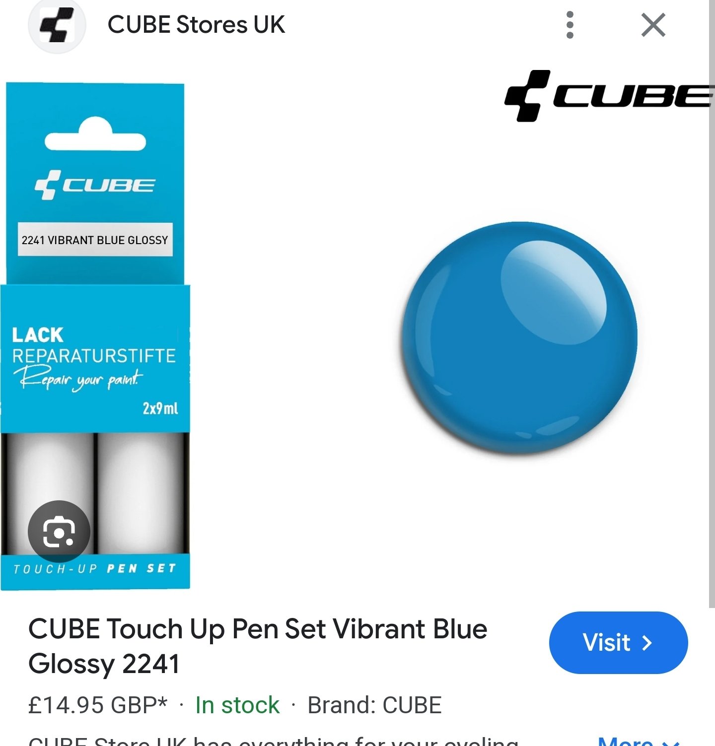

It does make you mad being the top tube, it's staring in the face any other place not as bad, but if you looking after your bike and trying to keep it
Looking like new, then it's a case if your confident in repairing it yourself get the Cube touch up pens, it makes sense.
Failing that find a body repair shop where you live and get them to sort it
I suppose I'm s bit lucky the business my family run has a spray shop and I use it to make good any damage.
Must admit these protective films are a bonus for protection 👌
Anyway good luck with your outcome

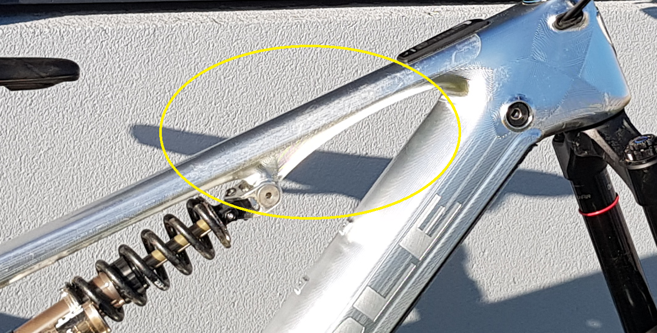

I suppose it a bonus having an unpainted frame like the Pole
Kind of, Scratches are less obvious but they still happen.
My mates convinced me you didn't need protective wrap because its raw alloy. I also thought the machines lines look would hide scratches more. But actually it accentuates it compared to raw alloy tube frame. On a tube frame you can get out the autosol and polish it back up. Scratches are still visible on the machines look even after polishing.
My first real ride was in the mud and grime for 3 hours. My knee pads scratched up the top tube one the very first ride.
Farken disappointed
My mates were wrong. Protective wrap needed to be applied.

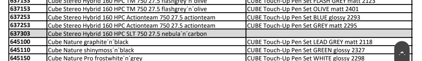

Sent you the paint codes you can get the paints now

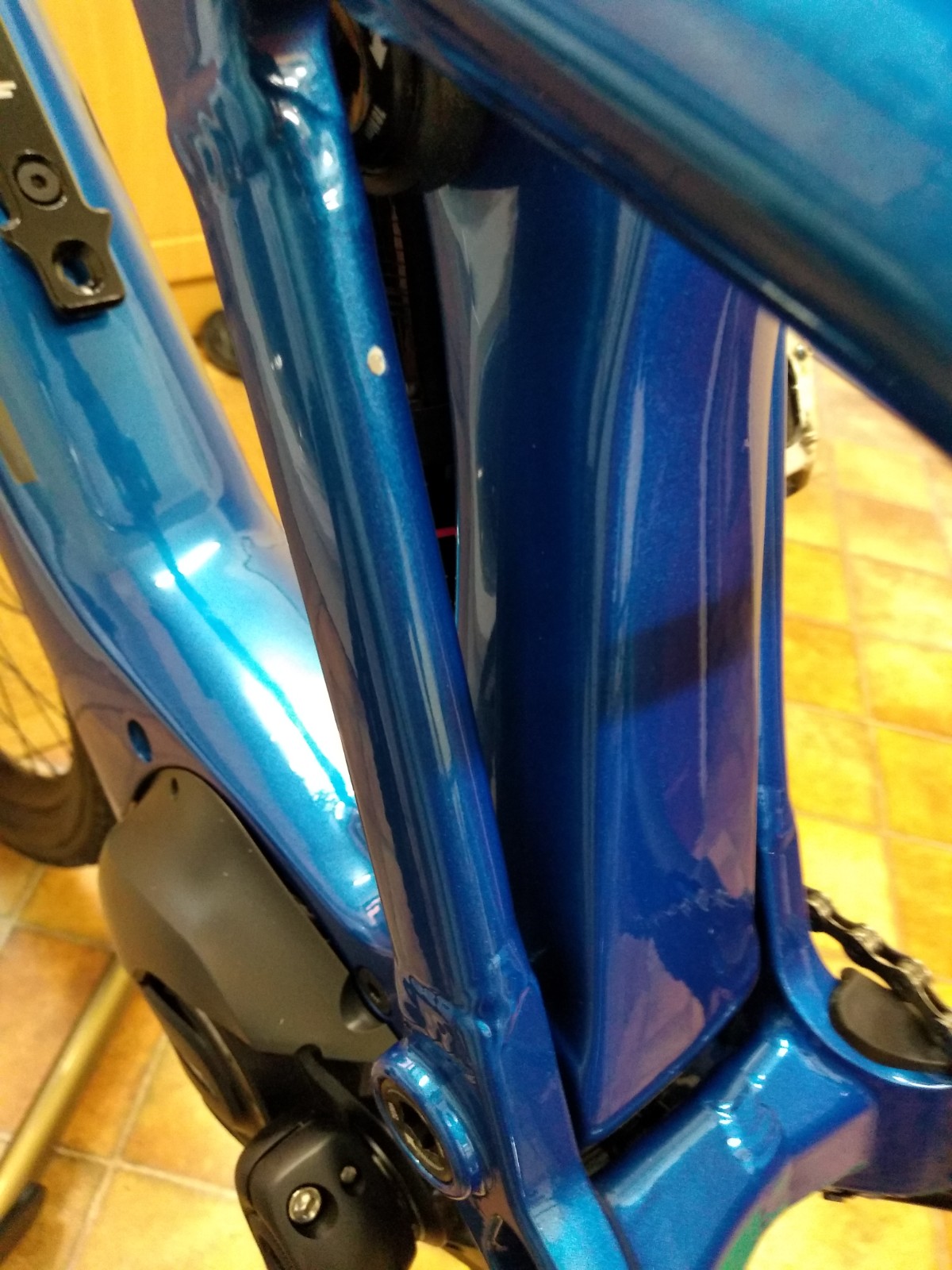

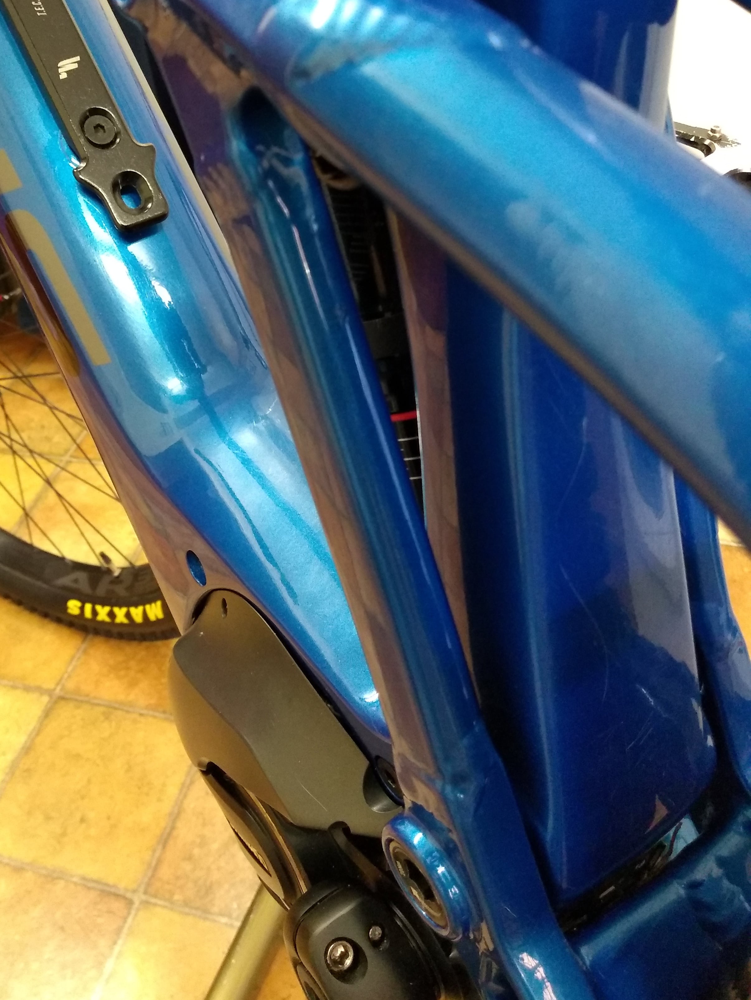

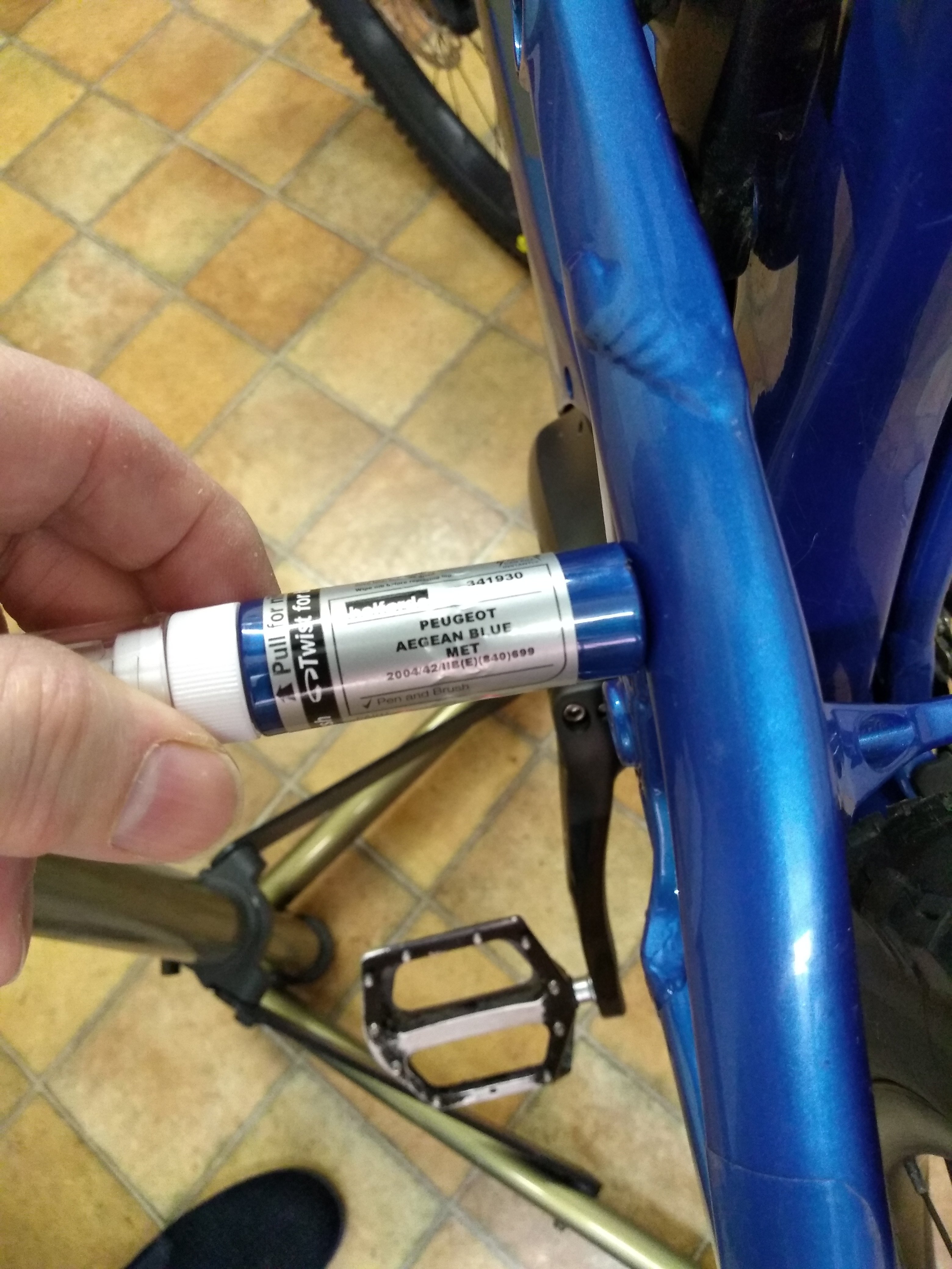

What would you do if it was your car? Some body coloured polish and a bit of T-Cut maybe! How about touch up paint?
Yes, with a bit of luck you can fix it yourself. Maybe so that you can only tell close up. See here:
I could have done a better job, taken more time, filled it first done losts of rubbing down etc, but I was happy with the result. No 1 tip: Use the fine nib and not the brush, take your time.
The key thing is to find the best paint match. If the bike manufacturer does not supply paint, then you need to get yourself down to Halfords (a motor parts and other stuff retailer). They have a very wide range of car paints both in touch up and spray. I took a photo for comparison, but I have also taken the whole bike in to the shop on occasions. Beware of the odd lighting in shops, it is nothing like normal outdoor light, ask to take the paint sample and the bike outside to check. (Or pay for it and get a refund if they are being an arse).
I thought with a German bike (the blue bike above was a Focus Jam2) that German car brands would be the answer, but it turned out to be a French (Peugot) colour that was a perfect match.
By the time you have applied some helicopter tape (stable doors etc) you will not be able to tell!
Good luck with the search! :)
Different blue from the Actionteam
