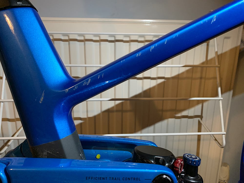

I was washing the loose mud off my Cube Stereo 160 Actionteam this afternoon, leant the bike against a low garden wall, unlocked the back door, and the bike fell onto the wall sliding along the top tube. - you have no idea how wounded I feel. I am not used to the weight of an ebike and look what I have done :(
Can this be retouched?
If this was an older bike I wouldn't bother, but I feel so hurt right now. I look after my bikes / all kit in my life. I have never done such a stupid thing.... errgh
Is this something a car paint shop could do (for example)?

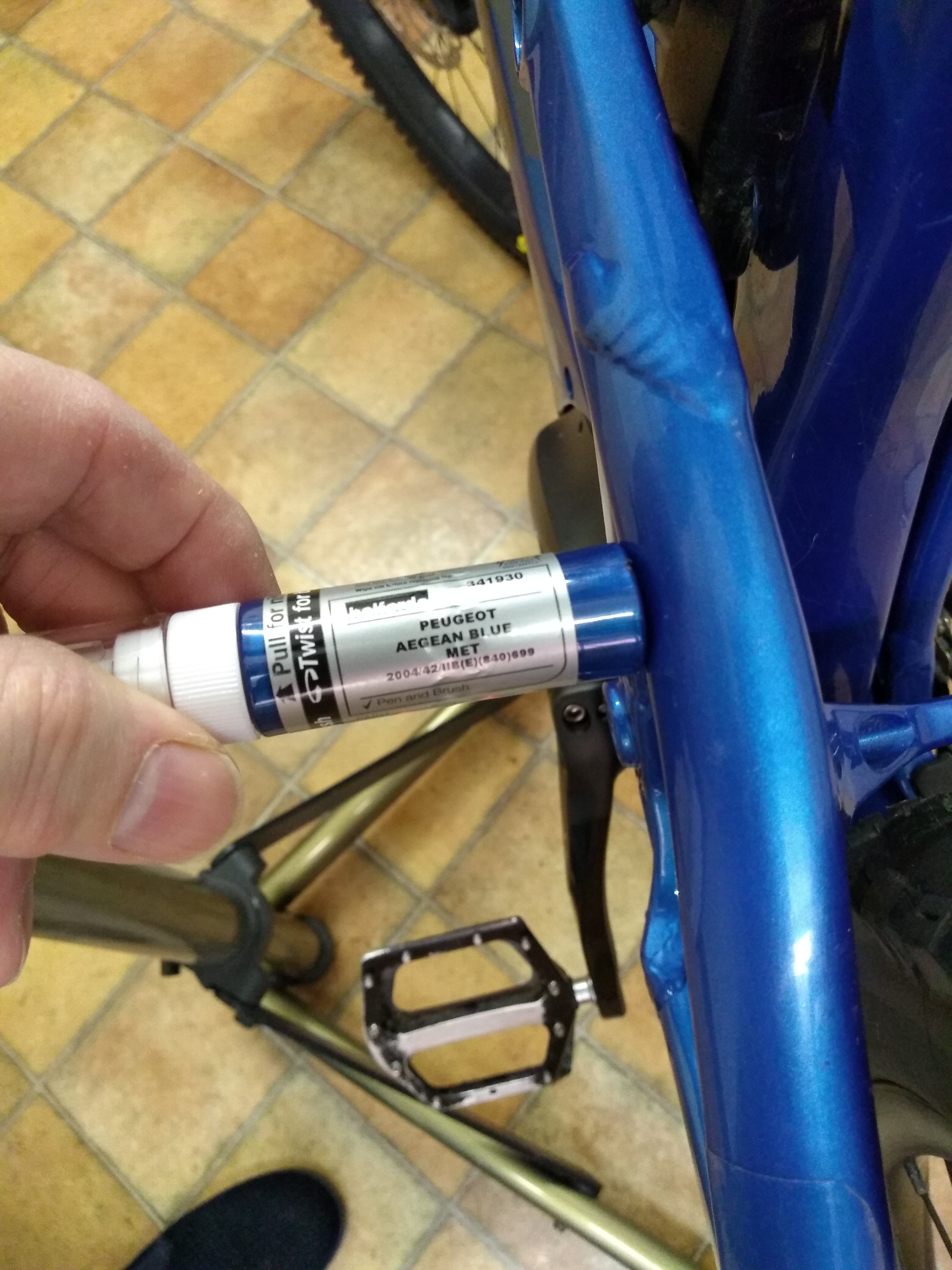

Yes, with a bit of luck you can fix it yourself. Maybe so that you can only tell close up. See here:
I could have done a better job, taken more time, filled it first done losts of rubbing down etc, but I was happy with the result. No 1 tip: Use the fine nib and not the brush, take your time.
The key thing is to find the best paint match. If the bike manufacturer does not supply paint, then you need to get yourself down to Halfords (a motor parts and other stuff retailer). They have a very wide range of car paints both in touch up and spray. I took a photo for comparison, but I have also taken the whole bike in to the shop on occasions. Beware of the odd lighting in shops, it is nothing like normal outdoor light, ask to take the paint sample and the bike outside to check. (Or pay for it and get a refund if they are being an arse).
I thought with a German bike (the blue bike above was a Focus Jam2) that German car brands would be the answer, but it turned out to be a French (Peugot) colour that was a perfect match.
By the time you have applied some helicopter tape (stable doors etc) you will not be able to tell!
Good luck with the search! :)

There's a PDF of Cubes 2023 paint codes here
https://file.cube.eu/azwesc1xfg346/..._Lackstift-Touch-Up_Pen_06.09.23_Longtail.pdf
For the 140/160 Action Team it lists 2 (Page5)
CUBE Touch-Up Pen Set BLUE glossy 2293
CUBE Touch-Up Pen Set GREY matt 2295
Just need to ask your dealer if they can order for you

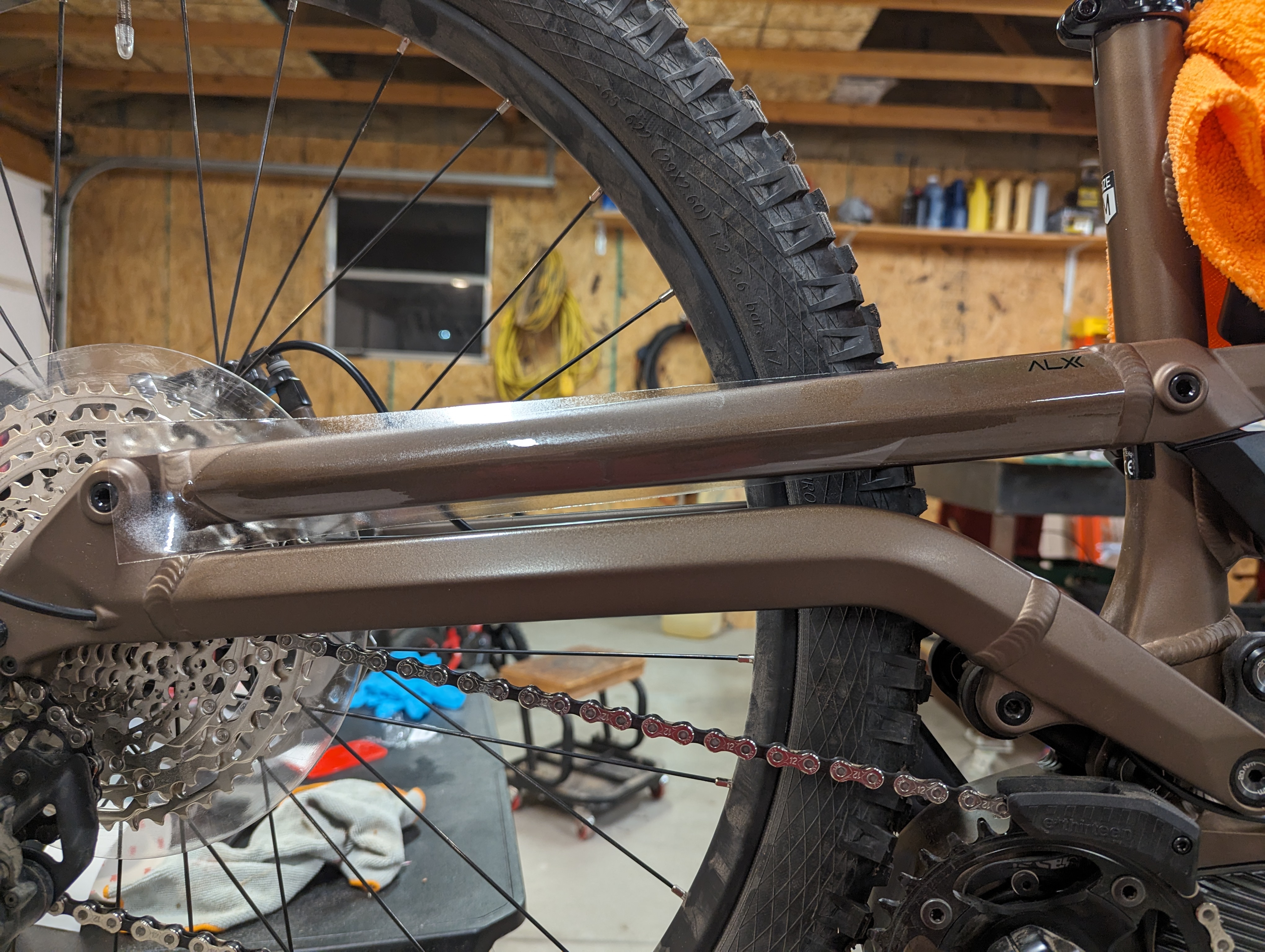

I bought some paint protection film off Amazon for pretty cheap. 2inch (50mm) and 4 inch (100mm) would work for most bikes, it's pretty easy to apply as well. This would add some protection from scrapes and scuffs, and doesn't look too bad either.
Attached is a picture from me applying it, next time I get to the shop I'll add some finished pictures as well. I would have preferred matte finish, but this was cheap and will help the bike look good until it's old enough I don't care anymore 😂.

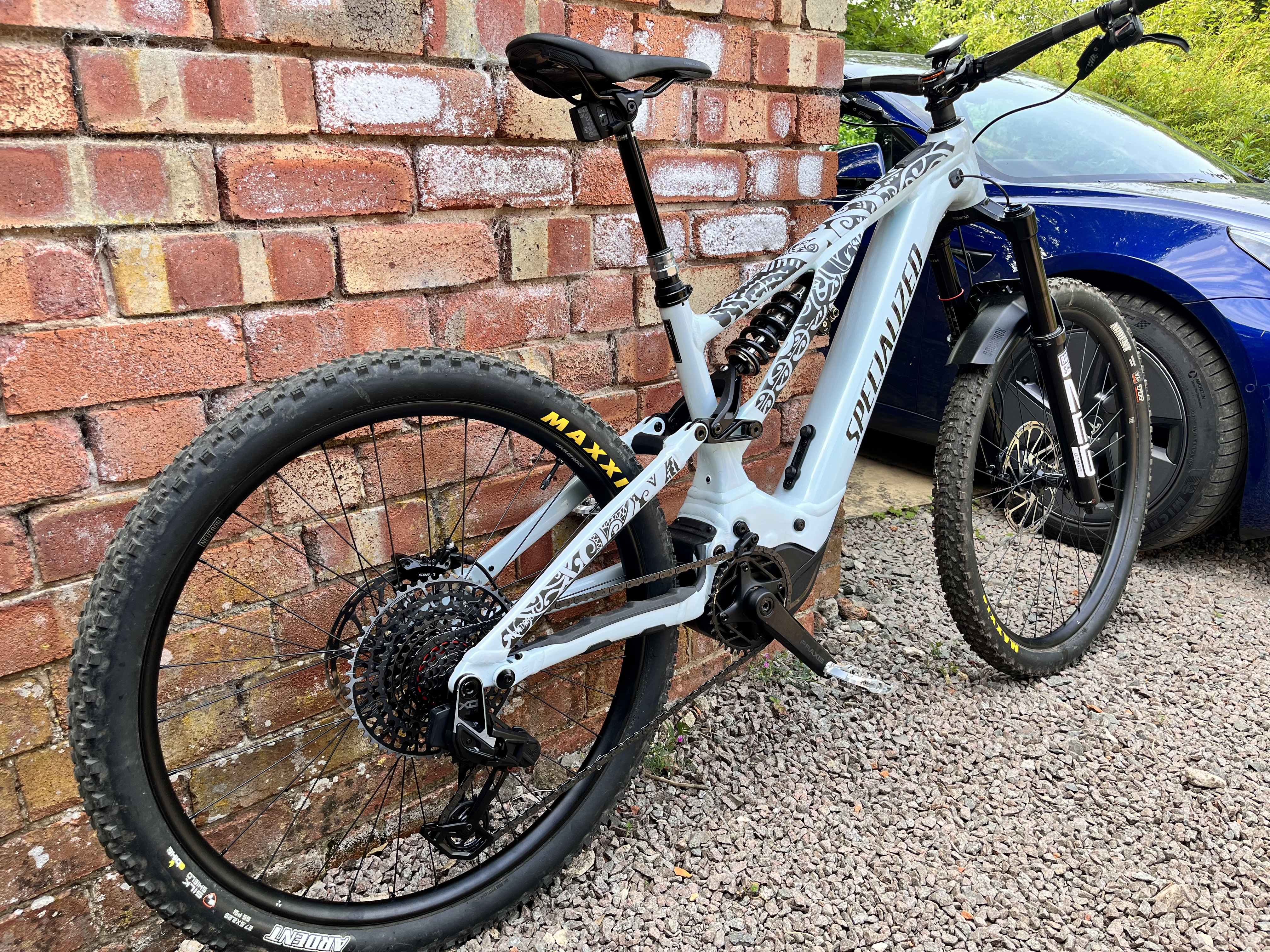

I’ve got one of these on my top tube on the Levo, a dyed bro sticker/protector. The right design/colour would cover 90% of those scratches, and protect from more? Mine is covering a tiny chip on the top tube, but I didn’t want any more.
I’ve got this protection set on the top tube of one of my other bikes, it wraps around the edges and would cover your top tube.
Luxshield E-Bike Paint Protection Film for Ebike, Electric Bike, MTB etc. - 20-piece Frame Set Against Stone Chipping - Transparent matt & self-adhesive https://amzn.eu/d/anNOFvu

UPDATE - Ok I just cycled to a reputable body shop near me (who understood my pain) and they reckon I would be looking at respraying the entire top tube as it’s gone right through to the carbon fibre.
Touch up paint will look like you’ve used touch up paint”, he said, but I’m thinking I don’t have much of an option.
The frame top tube has decals on it, so it would mean removing all those. Errgh…
I’m thinking a sticker would be the answer - what would anyone recommend I get to make it look in keeping with the bike?
Please forgive me, I’m not asking you all to do the work for me, it’s just I’m totally new to all this and everyone is so knowledgeable these days…
