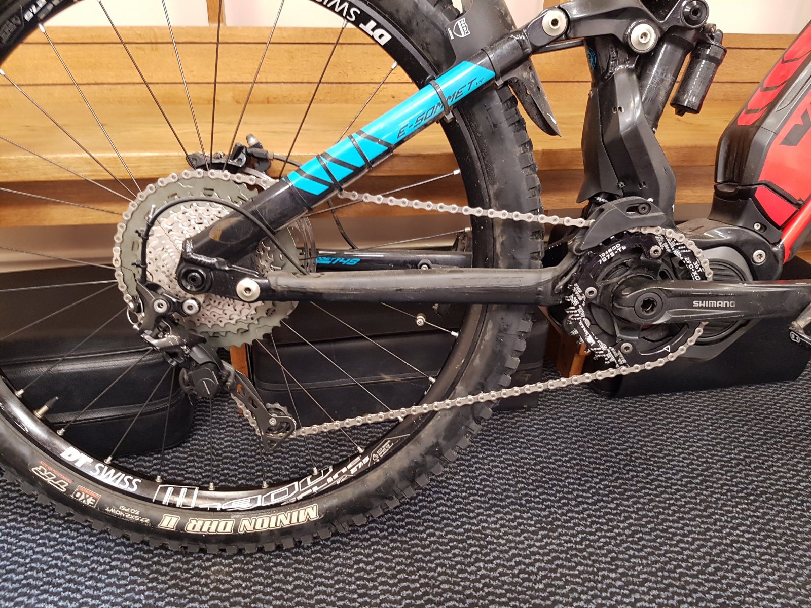

@Evolution Stu Finally got my HG500 cassette installed - plus my new Shimano CN-E6090-10 chain. Really pleased with it! :)
Pic below shows my chain cut to 122 links length. I know from previous actual measurements that I could get away with 120 links, but I went against it for two reasons. 1) Saving the weight of two links [5 grams] is insignificant and, 2) I spend most of the time on the 3rd to 5th cog as in the pic, and a shorter chain would only drop the derailleur cage lower making it more vulnerable to snagging something.
Still in topic - regarding 36T aluminium aftermarket chainrings:
I noticed early on (every time I remove the KMC e10) that there was a bit of chain suck against the MOTSUV chainrings - not much, but enough for me to notice. Didn't recall sensing this with the original Praxis steel chainring with the KMC chain.
But when I installed the new Shimano chain, it seemed free-ier wrapped around the 36T MOTSUV. I got curious if this was just all in my head, so I did some measurements. Here's what I found:
MOTSUV narrow-wide teeth = 3.52mm thick wide tooth / 2.00mm thick narrow tooth
(I'd be interested to know what the RACEFACE teeth thicknesses are)
KMC e10 Chain
Wide plates inside gap = 4.22mm
Narrow plates inside gap = 2.16mm
SHIMANO CN-E6090-10 Chain
Wide plates inside gap = 4.27mm
Narrow plates inside gap = 2.27mm
I did sense that pedalling was easier with the Shimano chain but I'll just discount and ignore that as psychological bias. What I can't deny is that it shifts much nicer. Could be because it's a brand new HG500 cassette and brand new chain. The KMC chain with the 11-36T cassette makes a 'clunk' sound most of the time I shift. The Shimano chain with the 11-42T cassette would sometimes shift completely silent - to a point where I would doubt if it even shifted (it does). If it makes a sound, it's more like a 'ping' instead of a 'clunk.' To be fair there is a component to the clunk sound that is probably the Yamaha BB axle ratchet taking up the sudden chain slack when I shift to a smaller cog.
I'm loving the HG500 11-42T cassette mate! Not so much because of the large 42T cog - but more because the cog sizes from the 5th cog upwards, step-up to larger sized cogs. I'm ignoring the largest aluminium cog (I won't be needing that much) but I'm treating it like a 9-speed with a much nicer (quicker) ratio progression. I now find myself shifting one or two clicks, instead of three. (y)

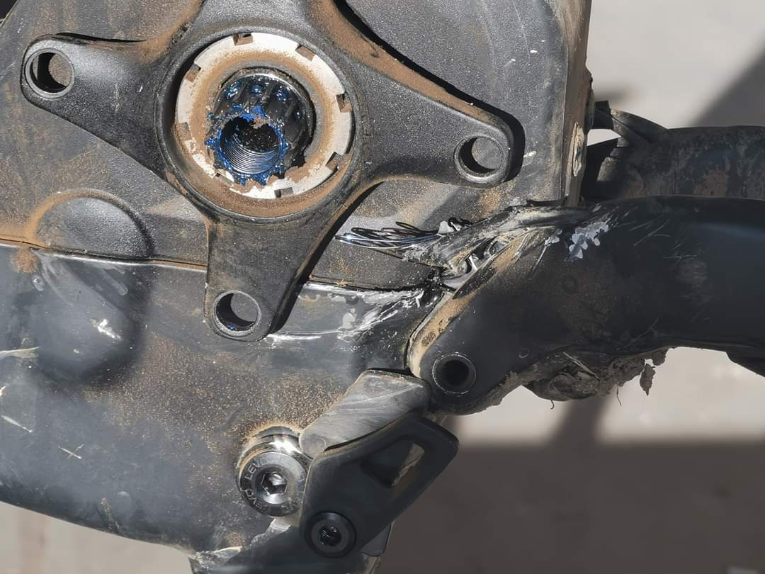

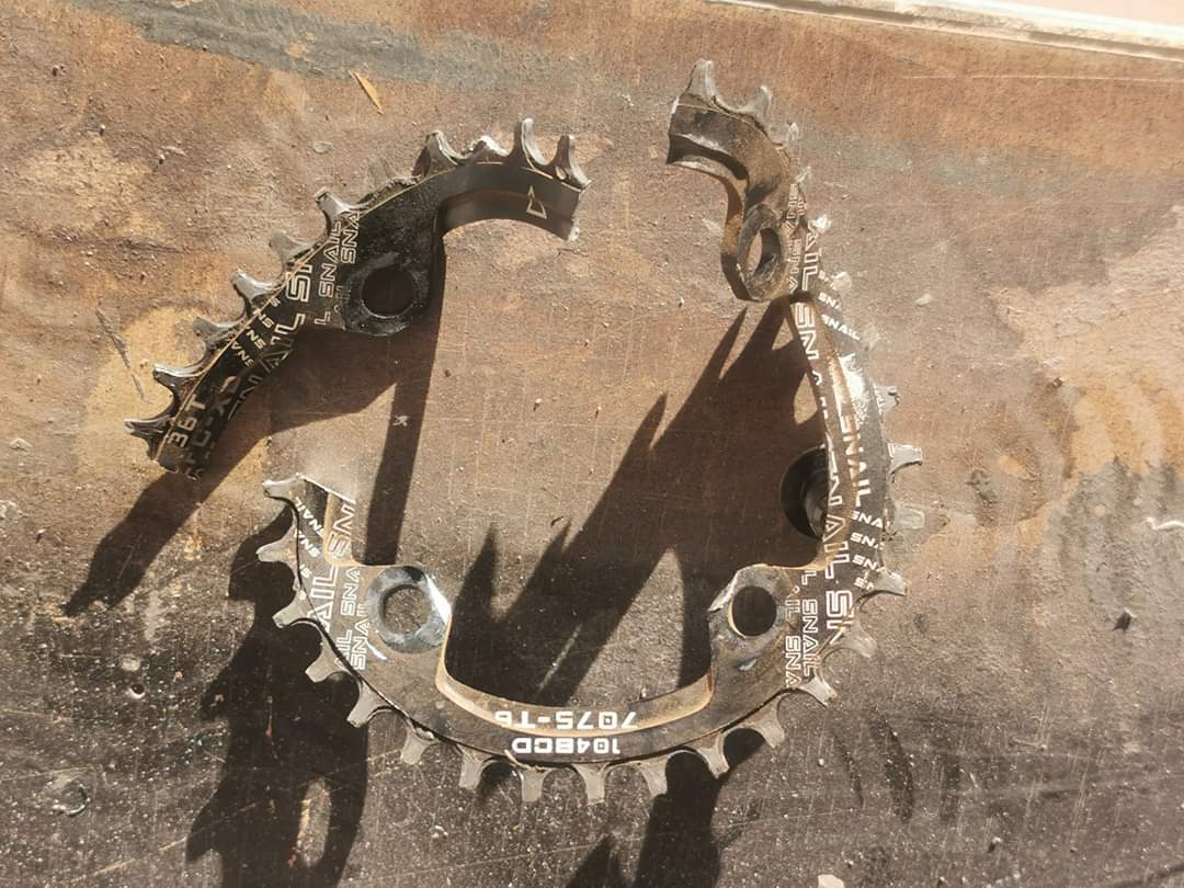

Just bringing this back up. I've just fitted the cheap alloy chainring a few others are running. A mate pointed me to a thread on the Levo owners page showing one that's failed. I'll be switching back to steel I think.

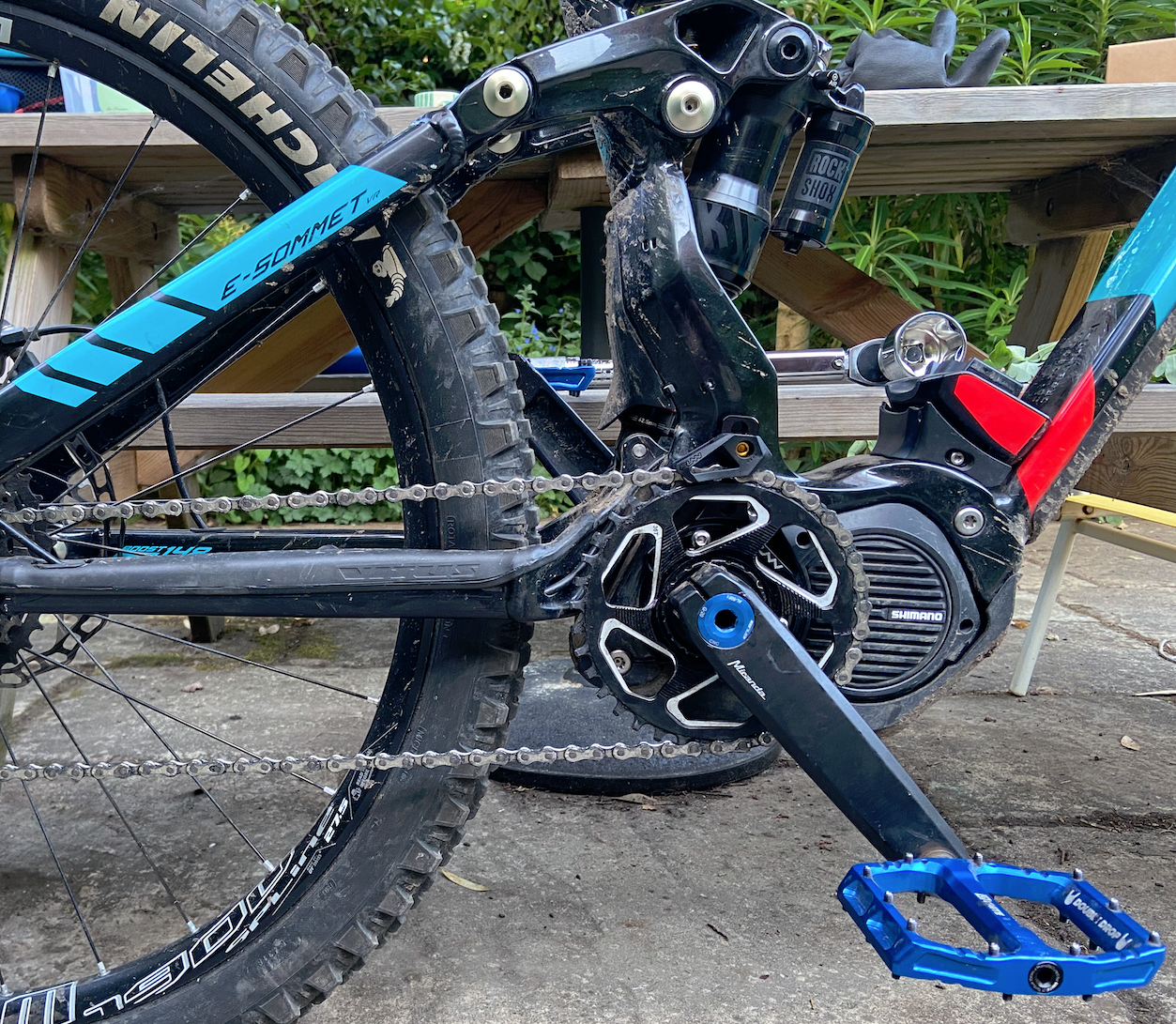

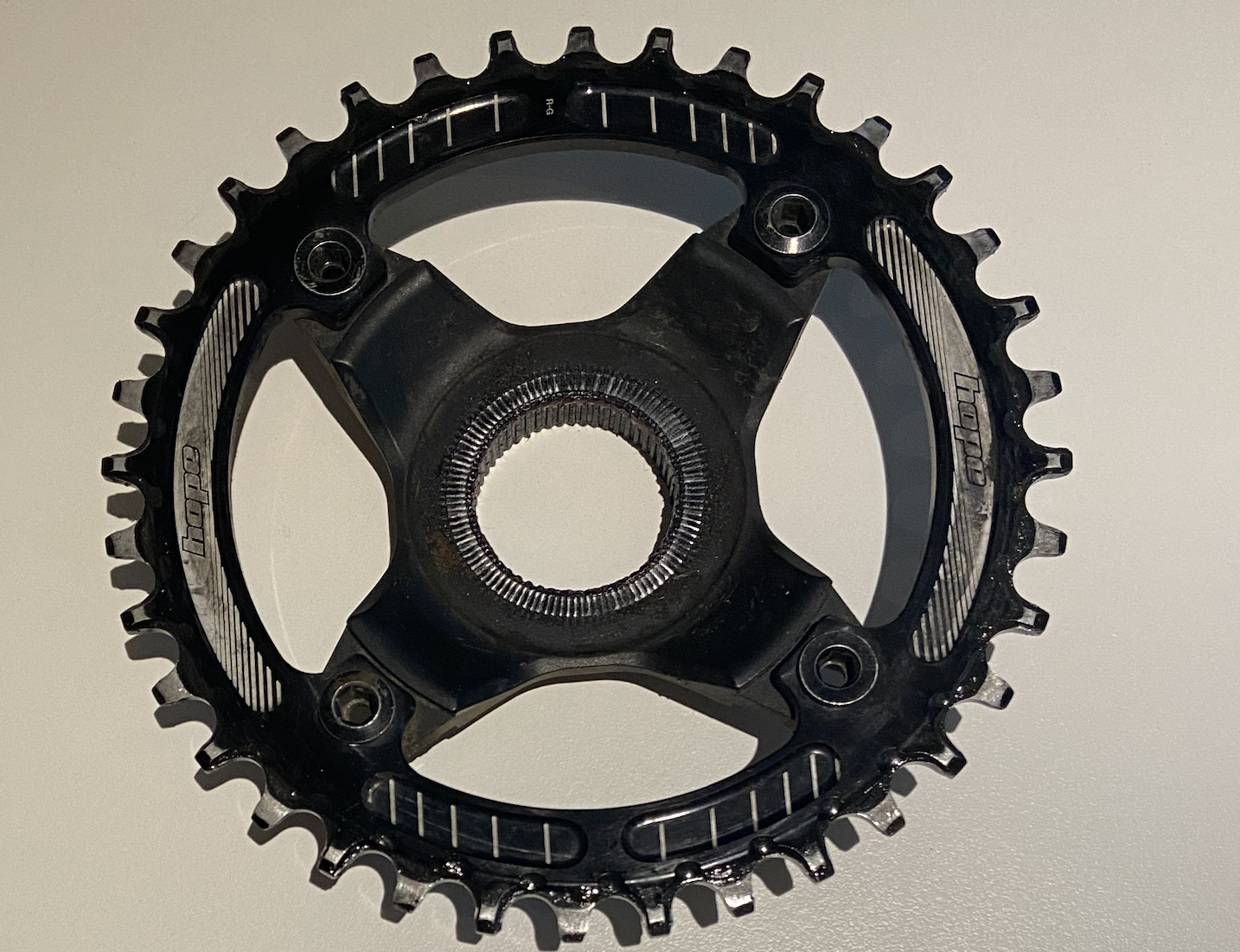

I am running the new Funn direct mount for E7/8000 , also swapped out the OEM chain guide to the Funn one too. So far so good. Was running a Hope 36t but it never ran that smoothly, not entirely sure why as no obvious reason.

Failed?
or smashed the fuck into something by it's owner?
Failed, took chunks out of the bike too.
Might have been a bad one, but thought I'd post it. I'm running on ?
Quite a few ebikes are steel so maybe there was a small chance of failure and manufacturer's opted for steel.
I'm planning to swap it out as soon as I can. At least the alloy one wasn't expensive ?

If you are going Alloy you need a decent one, cheap one is going to bite the dust quickly as you have found out - I did 500 plus miles on the Hope Alloy one with no issues in terms of unusual wear or going out of shape.
The Funn one I have just fitted is alloy too, in the blurb they say its some magic formula for EMTB's but we will see.
