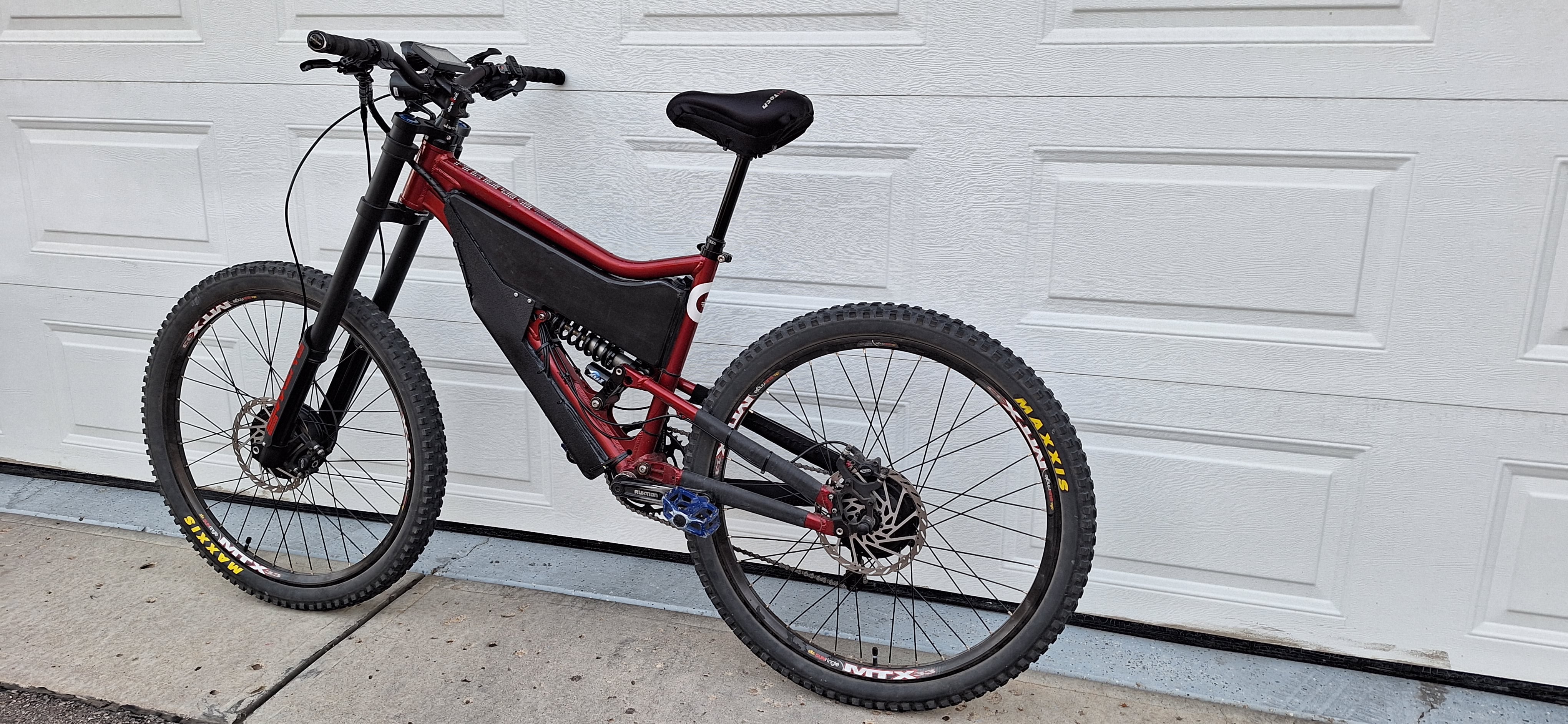

Someone please correct me if I'm wrong. But at 75.8lb did I created the lightest full suspension 1600wh battery 2wd ebike by accident? Lol??
I did a Google search and every dual suspension 2wd ebike is a fat bike and they all weigh like 80-100lbs.
Also. I have 200mm for travel front and rear, most have like 100-140mm.....
Also Also, mine is 3000w total. Most I see are only 1000-1500w?

Nice one @michael.kozera !
What capacity battery where you able to fit in there?
It will be interesting to see what range you get knowing that hub motors are actually more efficient than mid-dive motors, also the fact that it is 2wd makes it even more efficient.

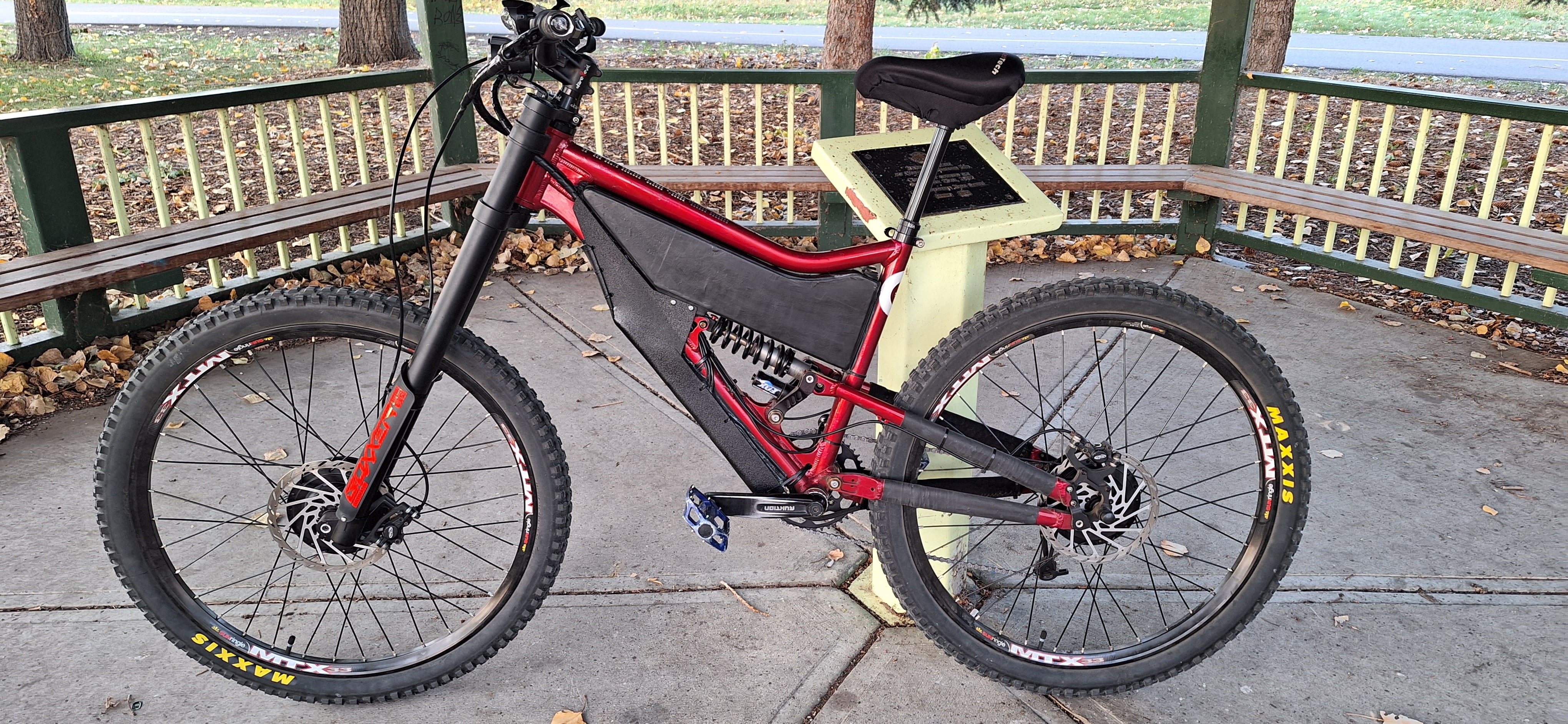

OK. Finished up stress testing 2 days ago. Here are the results:
Relatively flat 60% With modern hills 30% and 10% steep hills.
I used the full 3000w up the hills. And on flat hit around 800w at 60kmhrs.
I got right around 124.4kms before LVC kicked in. I then rode around for another 20kms on low power mode (500w ish). So not bad for full power.
Today. I was able to do a more realistic test. Hardly ever used full power. I got 170km. Still had 30% charge showing. Ran out of time. Had to go to work, my guess is around 200km average range.

Farkenell... That's some proper distance, I get nowhere near that on my Bosch Performance CX.
Is that pedalling the whole time or mainly on the throttle?
Hub motors are efficient!

yeah , seat cover is temporary lol.
first test was throttle only,
2nd final /realistic test was while pedaling.

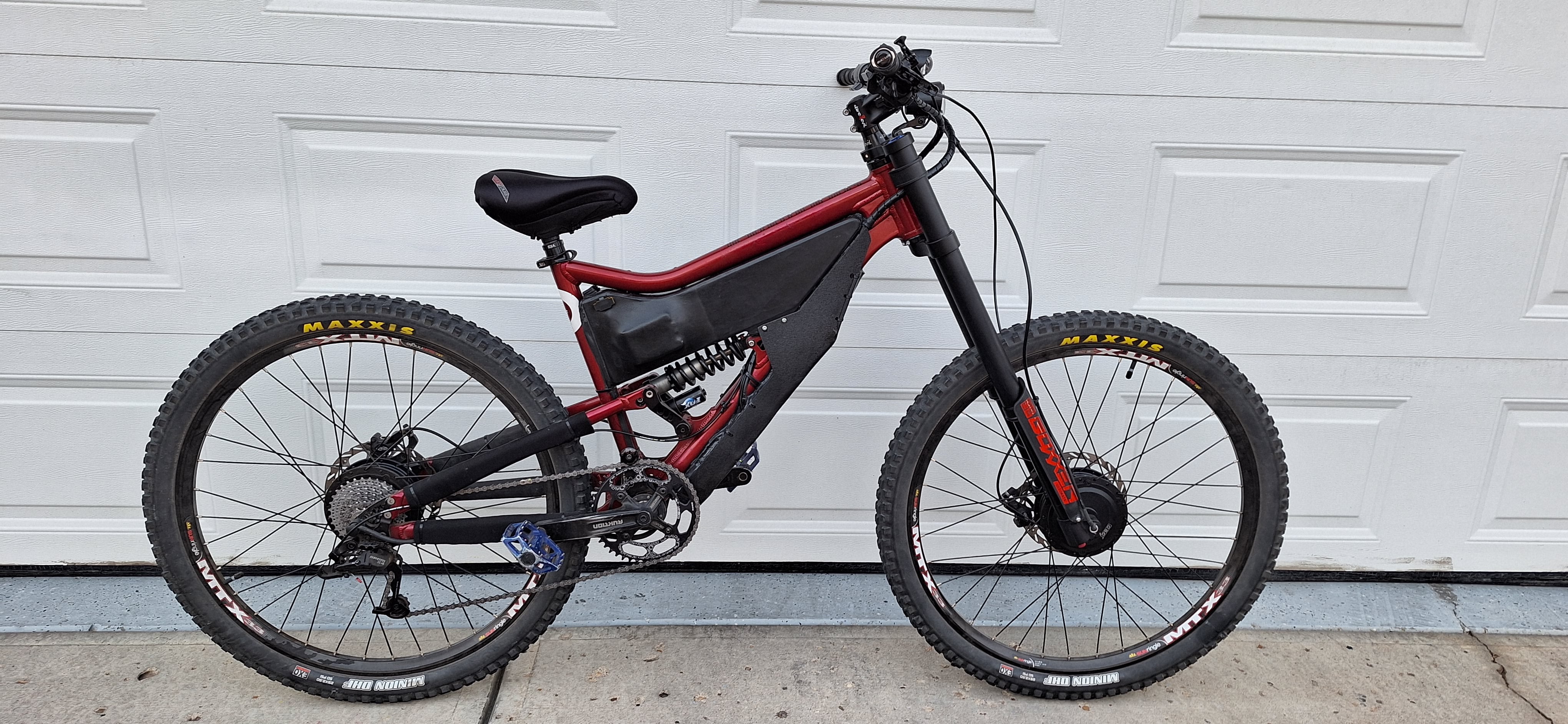

hiya bud, i love this, could you tell me what its like on trails and jumps please? i have a carbon bike which im told should not have a mid drive fitted to it so i was thinking of going down the hub route....what hubs are these please?
