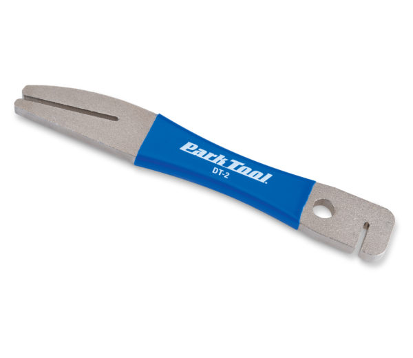

In my experience, all bike rotors develop a bit of warp after some heat cycles. You can use a cut off tie wrap as a warp indicator and a Park Tool DT-2 or an adjustable wrench to true the rotors. I like the Park Tool better than an adjustable wrench because the rotor slot is deep enough to reach the spider. It shouldn't take more than a few minutes to eliminate rub caused by a slightly warped rotor. Just don't use too much force! Better to sneak up on it than to put a visible bend in the rotor.
