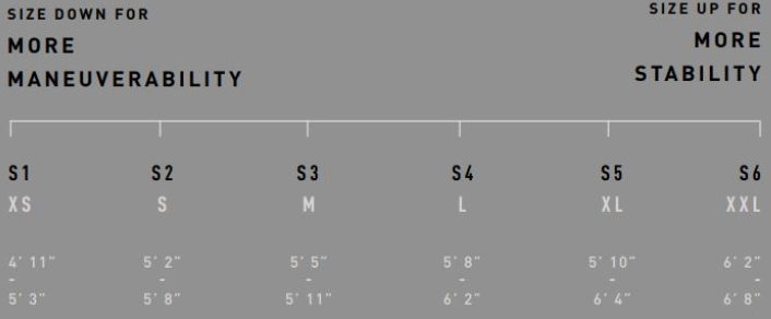

Size Guide :

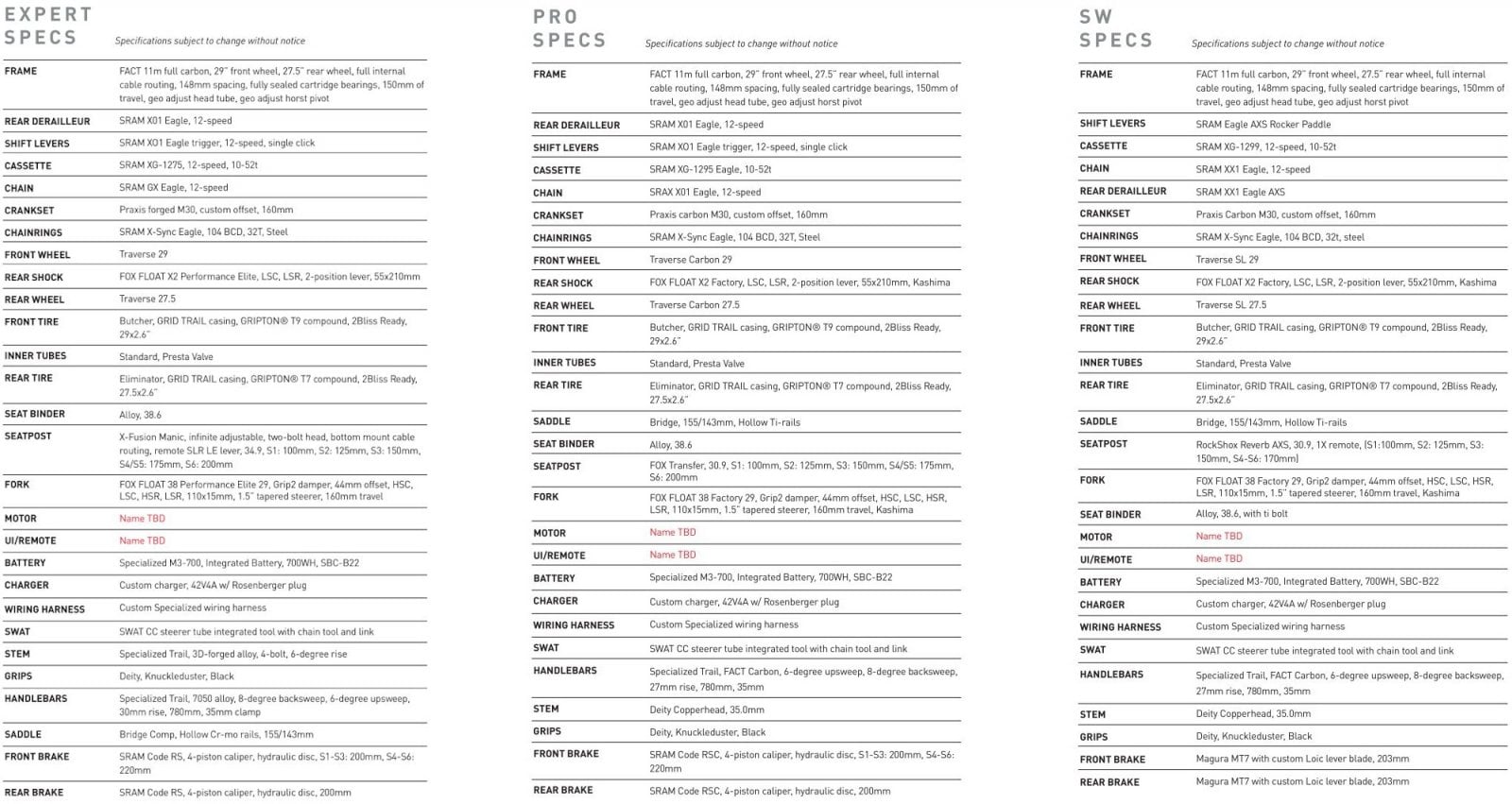

Specs :
22 Pro (£10,750) and 22 S-Works (£13,000) models. 22 Expert (£8750) model expected (unconfirmed) June/July 2021.
Reference pricing :
21 S-Works (£12,500). 21 Expert Carbon (£8500). 21 Comp (£6300). 21 Base (£4800)
20 S-Works (£9,999). 20 Expert Carbon (£7249). 20 Comp (£5499). 20 Base (£4249)

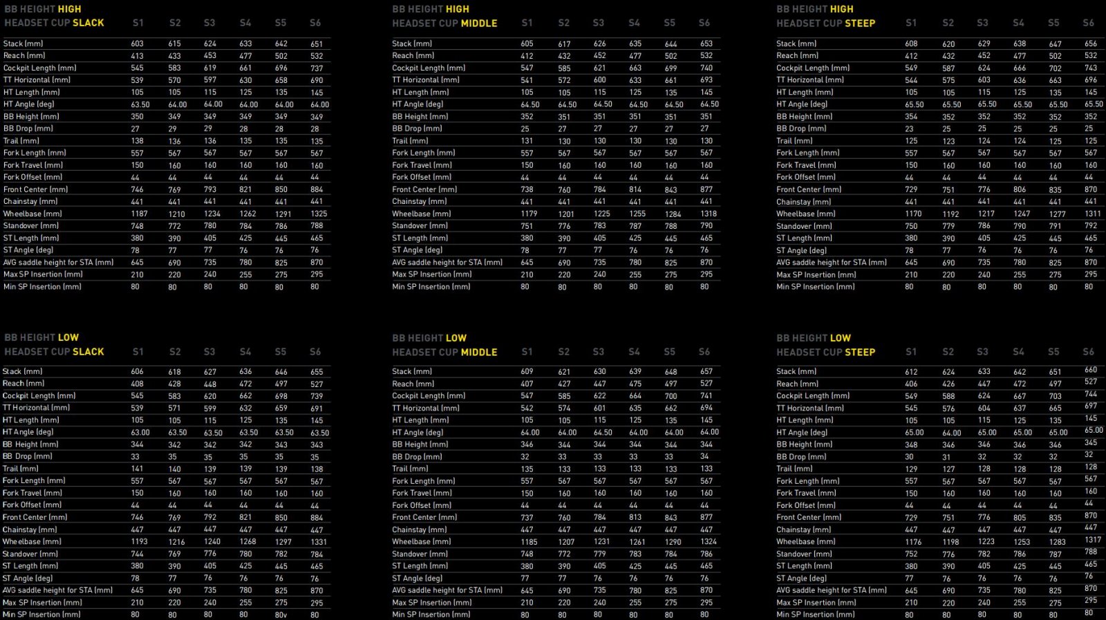

BB Height Low , Chainstay 447, BB Height 342-348 (size dependant/headset cup dependant)
BB Height High , Chainstay 441, BB Height 349-354 (size dependant/headset cup dependant)
Max Seat post insertion S1-210, S2-220, S3-240, S4-255, S5-275, S6-295mm
Seat Tube : 34.9mm shimmed to 30.9mm.
Rear shock : Custom Float X2
Part number: 979-63-010
Short ID: D9MP
Description: 2021, FLOAT X2, F-S, K, 2pos-Adj, Specialized, Levo F1, 210, 55, CL002, JCR010, Rezi CM, SBC S08 Dream Silver Satin/SBC W03 Metallic White, Neutral Logo, N/M
Battery : M2 700wh battery with new Gen3 "bash guard" housing the aqua (© Zim) door. Different "Packing Bung" at the top of the battery to accommodate the different frame shape - sold complete as the M3.
Rosenberger plug seals are treated with "Nyogel" Synthetic silicone lubricating grease - DO NOT get this on the plug connections if you re-treat as it's none conductive.
Mastermind TCU V1. - Backwards compatible Levo/Kenevo/SL. Not available for purchase at launch due to supply issues.
Mastermind TCU Configuration and problem solving :
Motor : Specialized/Brose 2.2 - Backwards compatible. 2.1 motor with all the incremental upgrades to firmware, sprag, bearings and a new belt for the 2.2
Frameset Only : £6500. The frame comes with:
  • 2.2 Brose Motor
  • 700wh Battery
  • Handlebar Controller
  • Mastermind TCU
  • Float X2 shock and
  • CRANK SET, PRAXIX,
  • 160MM CARBON ARMS ,
  • BCD 104MM SPIDER,
  • AND A SRAM CR EAGLE 34T CHAINRING
