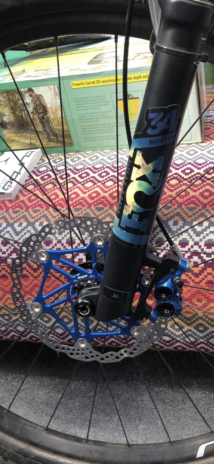

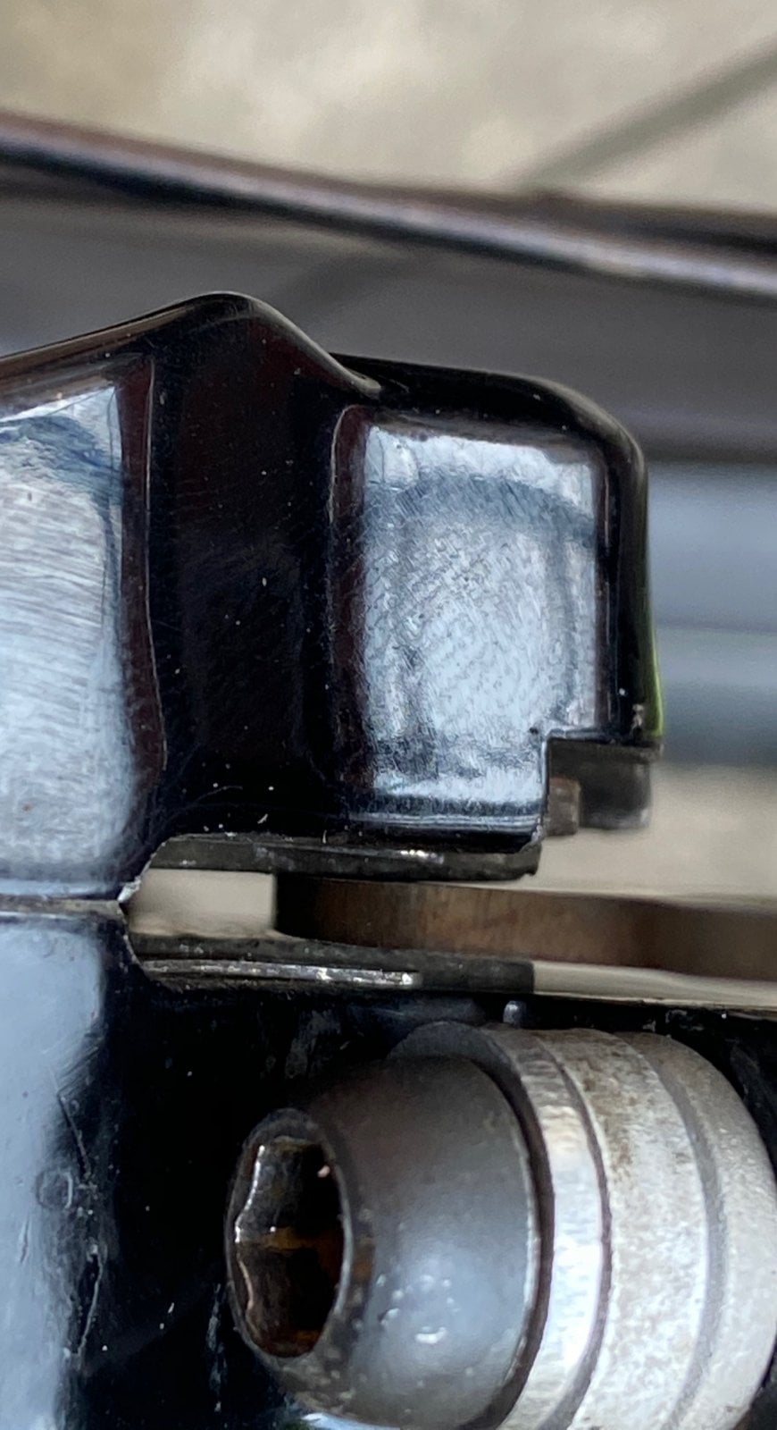

Took some pics one is with the 203mm adaptor installed ignore the long bolts don’t have any smaller ones till tomorrow
The problem I’m having is second pic the rotor only goes half way into the pads/Caliper there’s quite a gap
On the previous mount they reached the outer edge so I won’t get uneven ware on pads (new ones on the way)

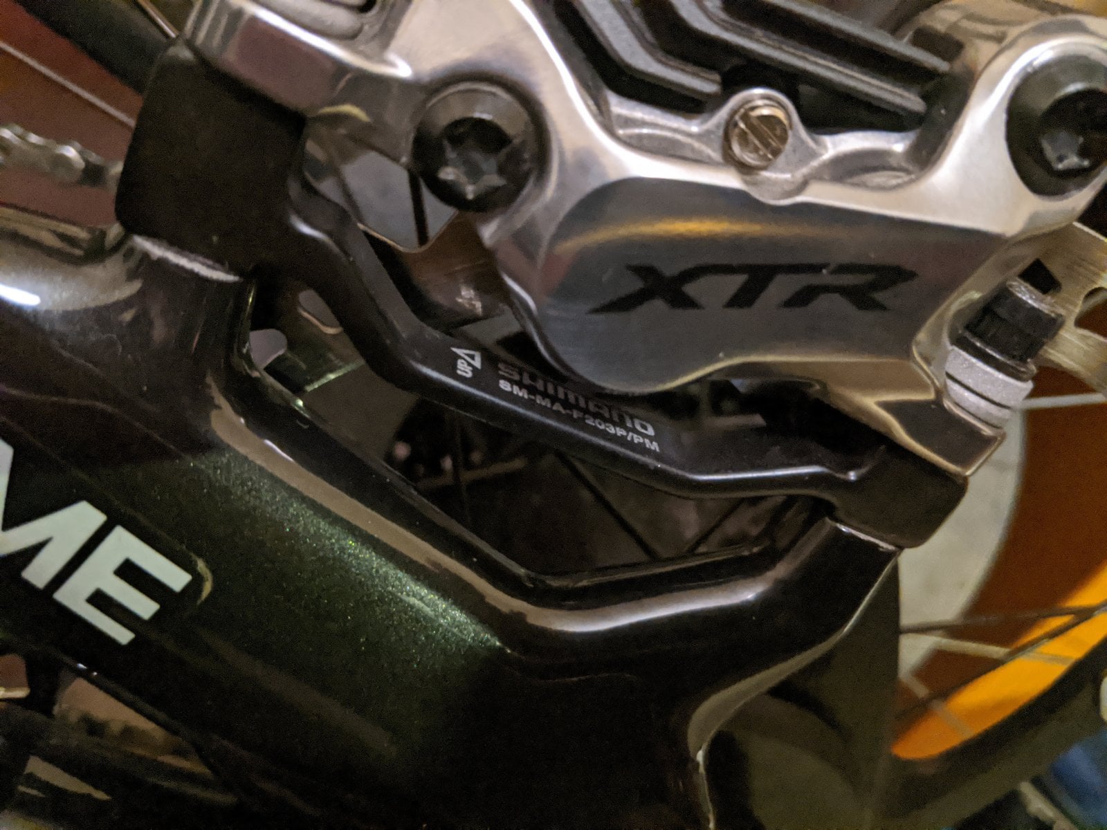

Third pic is of the rear brake with the washers and original mount (front was the samej
Was looking at shimano SM-MA-F203P/PM adapter will that be a better fit ie making the rotors futher into the Caliper
As in pic 1 I can’t make the Caliper any closer to the mount
Any help, info or what Iv done wrong? Is mucho appreciated

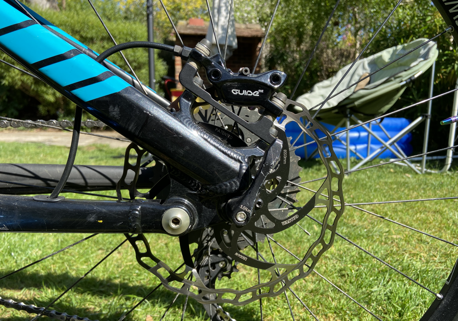

I have Guide RE's with 203mm rotors, and just have the one washer added under the mount at the back, on the front I have the adapter.
Thanks that looks like the shimano one that I’m looking at
Also yours looks like the rotor goes in fully where mine doesn’t

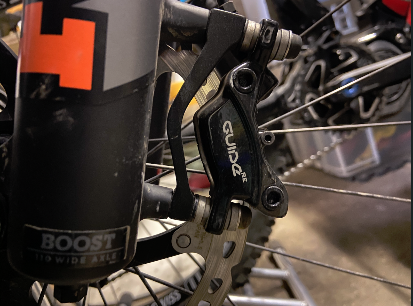

Here you go - the washer is at the bottom of the spacers on the front, you can do it either way though I believe it is generally done at the bottom of the spacer stack. I have a different mount to you though.

Oddly I think you have the same mounts as me but at different ends of the bike, sure you didn't swap em around by accident?

Thanks that’s exactly the same as I had my front setup
Although I had to put 3 extra washers on topto mount it higher up

The rear is the original adapter with washers added to make it fit

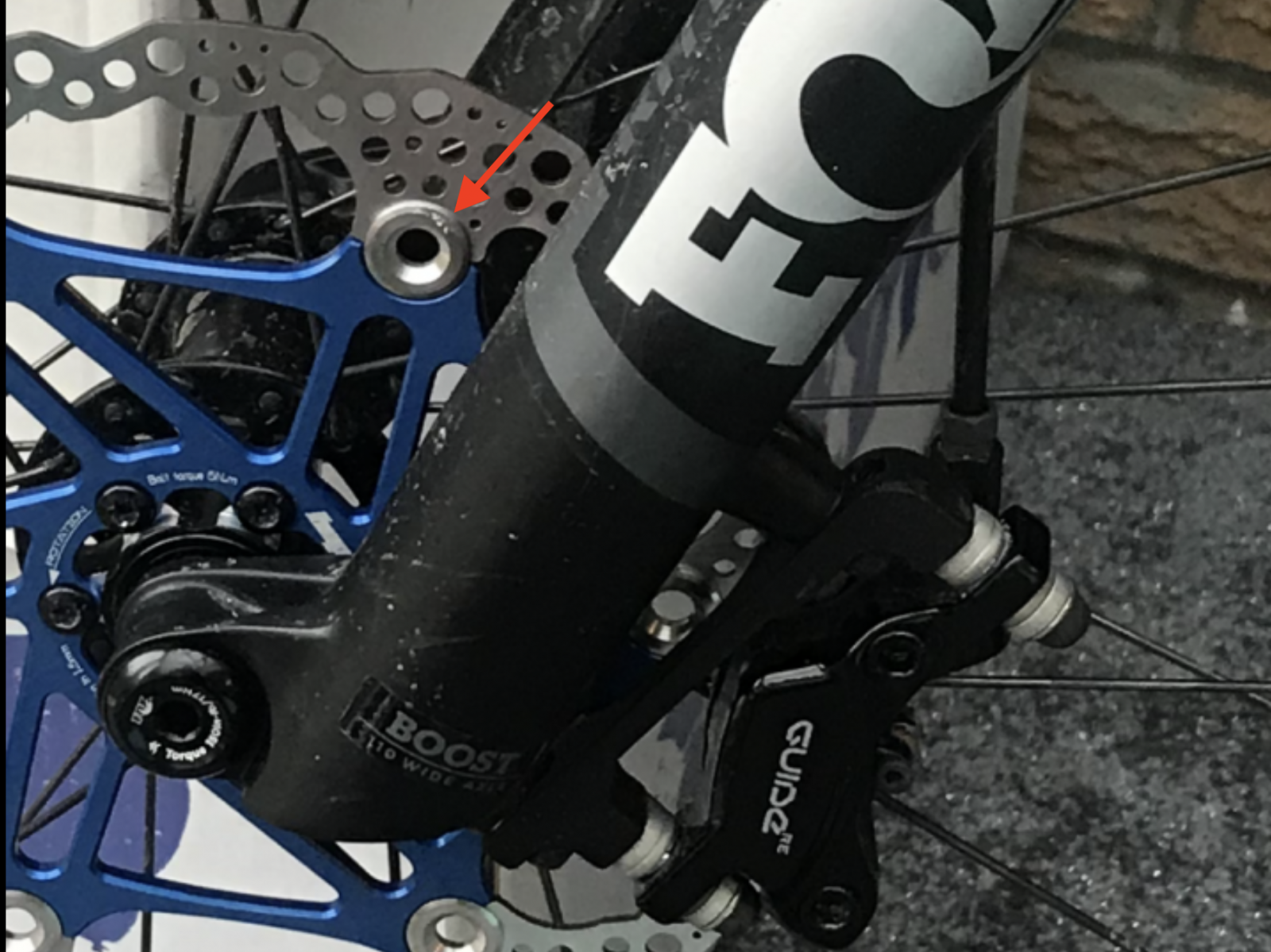

Hope discs won't work with Guide RE's as the part that holds the inner and out part of the discs together hits the Sram calliper. They do do 200mm and 203mm adapters though

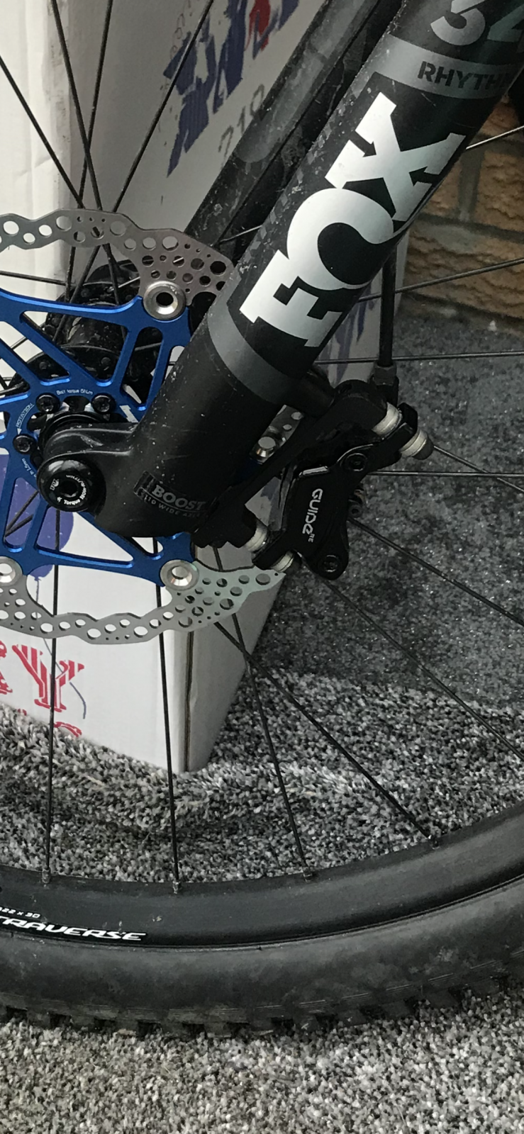

With Guide RE's? If fitted correctly the rivet or whatever it is they use will rub against the body of the calliper - people have done it but filed off a bit of the caliper body. It doesn't stop the disc rotating, but you hear a soft clicking sound of it hitting the calliper when it goes around.

No idea, my bike had a full custom respray and the LBS did the brake swap when they put it back together.

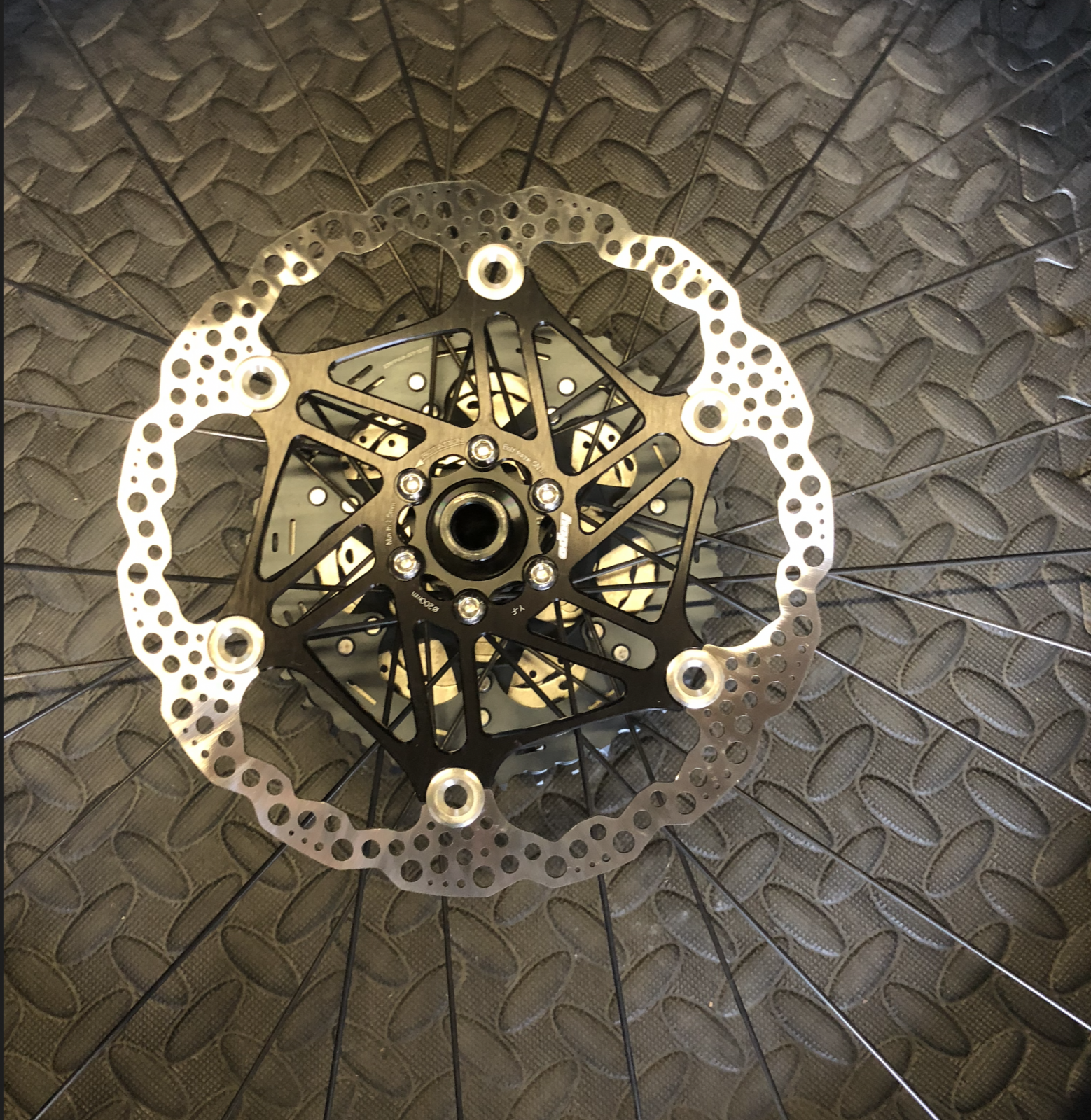

you sure that's not hitting? Interesting if you got it to work without moving the calliper, I know a few people who run the Hopes with the Sram and they have all had to mod the calliper, its a pretty well known problem.

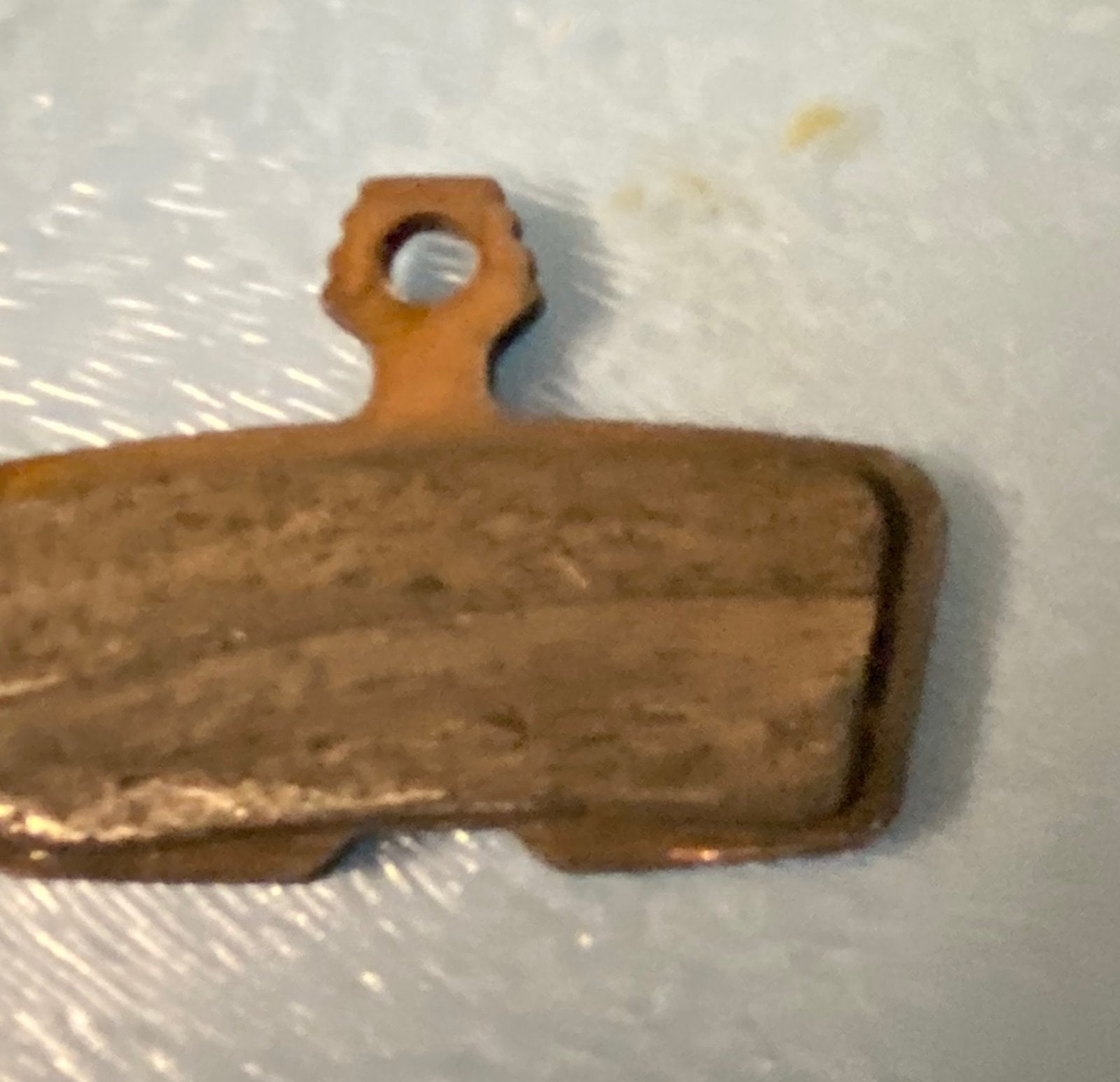

Quick update removed the pads, to have a look at and there only being half used see pic you can see the arc where it’s goes to
The adapters I’m using isnt right hence the issues I’m having
Need to find the correct adapter for 180mm to 203mm
Forks are direct mount for 180 rotors

Yeah check its right - I tried fit Hope rotors a few years back, and didnt bother googling if matching them up with sram brakes was an issue, sure enough I got them positioned right and they hit the calliper, and a bit of research and some calls informed me of the issue, but I wasnt willing to modify the calliper. Shame as they looked nice!

I think the adapter you have is for 160 (160mm direct mount) to 203. I researched these a week or two ago. I have ordered a 203 rotor. Currently I have a 180mm rotor mounted directly - so I needed a 180 - 203 adapter. I found it pretty frustrating - many sellers don't say this, they just advertise it as a 203mm adapter. If you're going from 180 to 203mm I think you need this (same as picture below). If you look in the link they describe is as "Frame/Fork Mount: 74mm Post Mount (180mm native)". I have an all shimano setup.

Yeah that’s what I ordered last night of eBay for £4
The mounts on the kenevo are direct mount for 180mm rotors
With 20mm adapters to make iit 200mm
The ones I bought pushed the callipers out of line hence my problems
I’ll order a second if the one from eBay works properly for the rear
Have a new rear brake coming as the one on doesn’t work as apparently the bleed screws are made from cheese
And is totally stripped but that’s a whole new story haha
I think the adapter you have is for 160 (160mm direct mount) to 203. I researched these a week or two ago. I have ordered a 203 rotor. Currently I have a 180mm rotor mounted directly - so I needed a 180 - 203 adapter. I found it pretty frustrating - many sellers don't say this, they just advertise it as a 203mm adapter. If you're going from 180 to 203mm I think you need this (same as picture below). If you look in the link they describe is as "Frame/Fork Mount: 74mm Post Mount (180mm native)". Mine are all shimano.
