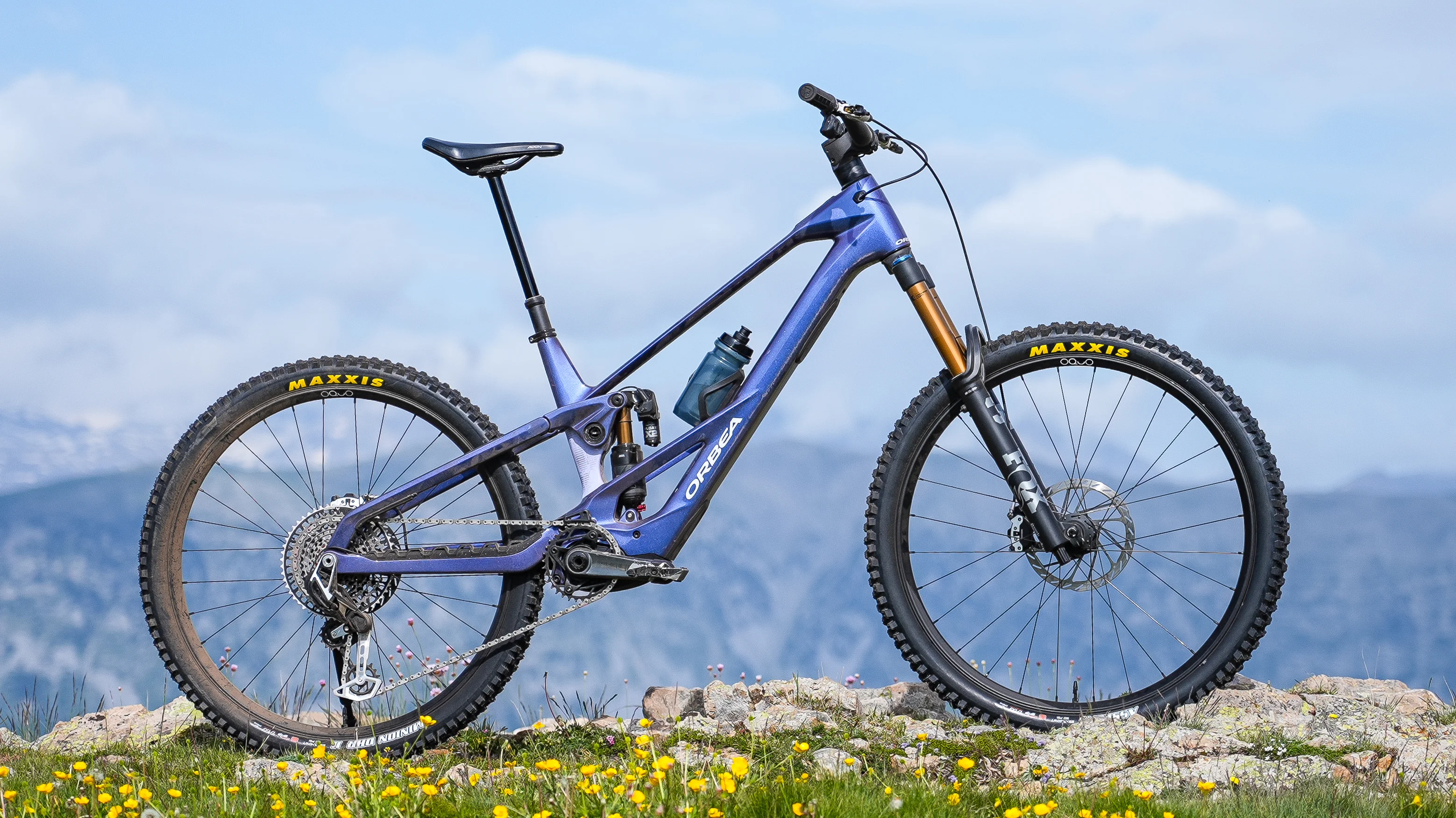

Orbea has lifted the covers on the new 2027 Wild LT, and this is a fairly major shift for the Wild platform.
But the bigger story is probably what Orbea is trying to do with the bike as a whole. This is not just a motor swap into the existing Wild. Orbea is positioning the Wild LT as a proper long-travel, gravity-focused eMTB, taking influence from the Rallon and Rallon DH projects while moving the Wild platform into a more aggressive space.
All the Wild LT models listed in the 2027 range use the DJI Avinox M2S motor system. 1300w peak, 150Nm peak torque. And Orbea's RS tune on the motor, giving a faster startup and more aggressive power ramp at lower RPM.

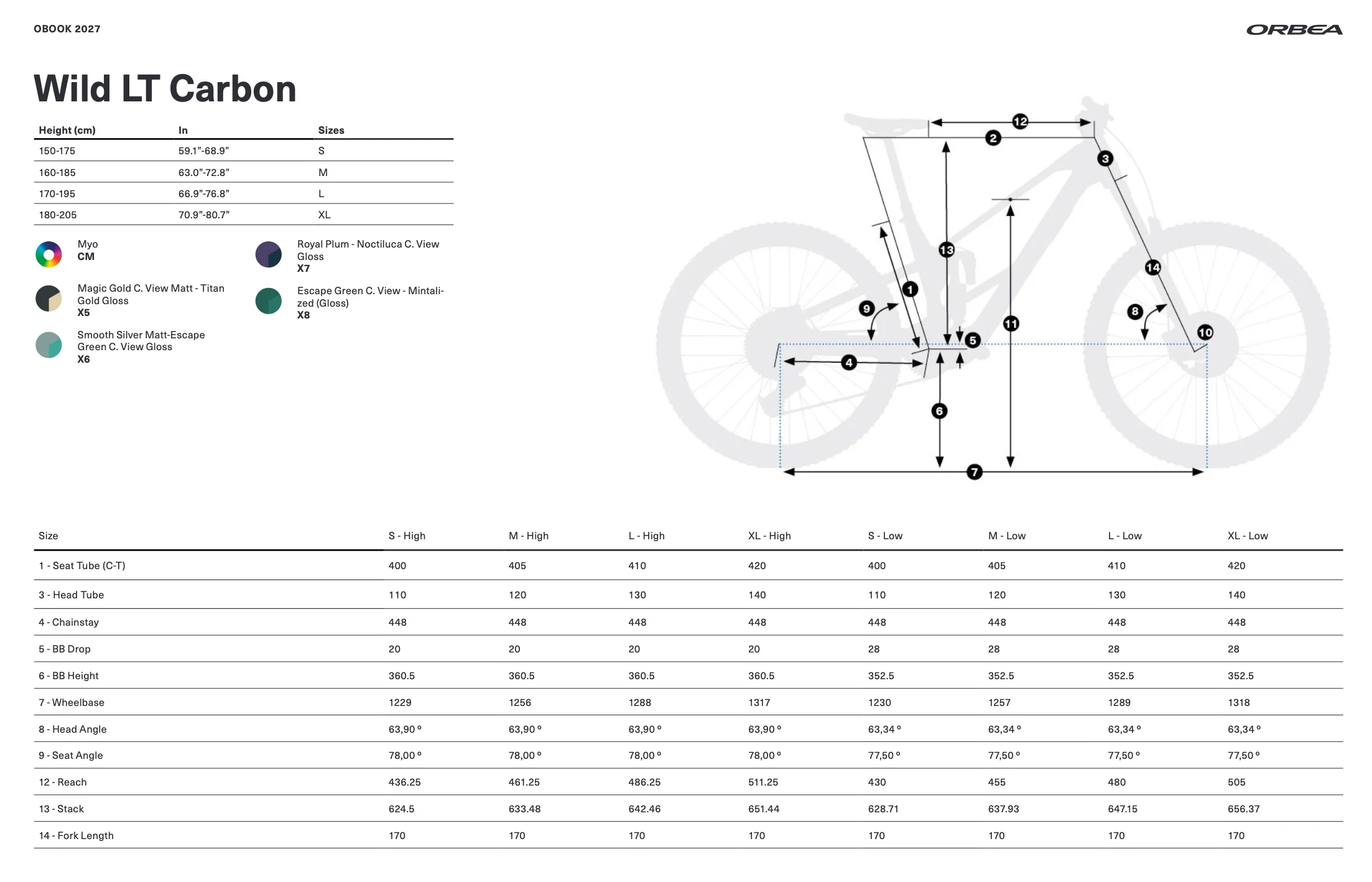

Can you confirm that the BB height in the geo chart you shared is correct? Is BB height really 360.5 in high / 352.5 in low setting?
And how does the geo chart look like for the mullet setup?
According to the geo chart, that is correct. If i remember correctly the MX geo is preserved with the rear rocker link change. So it should be the same give or take a couple mm.
That being said, I measured my full 29er XL in HIGH with 180mm fork at 355mm so I think their chart is off a bit.

They seem to have been overly conservative with the geo.
Yeah, I think this is a miss to be honest. Wish it had the same as the Rallon.
My XL with 180mm fork is about 875mm front centre according to my tape measure. Pretty skewed FC:RC ratio
1.94 f/r ratio for the xl.
Those are some 2014 numbers.
1.87 for the large, which is more in line with modern very conservative/older geo.
Medium is the only decent size.
It looks nice... no chance I'd buy one with that geo, unless I was a size medium.
