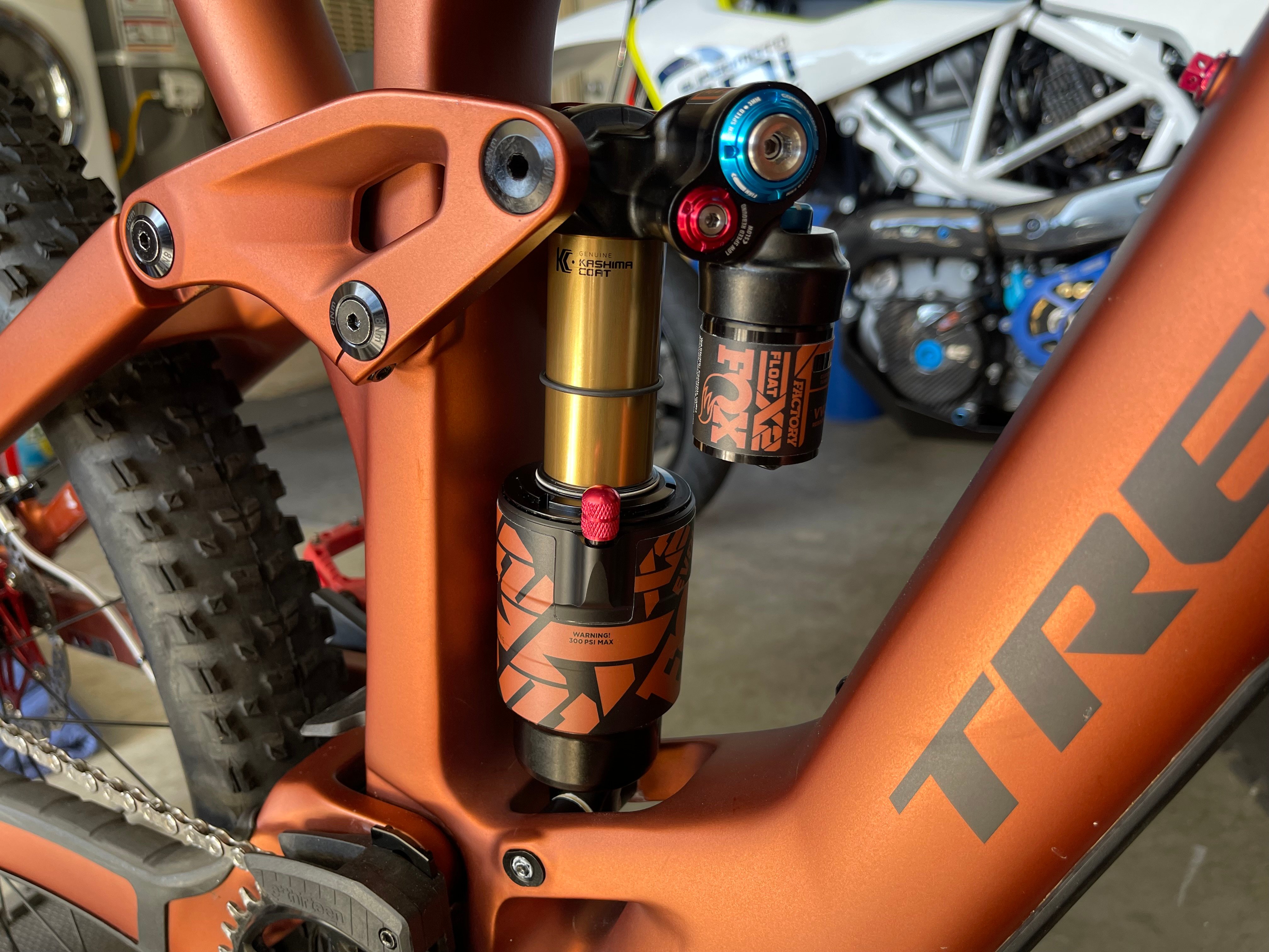

I received the replacement and it is worlds better than the low-end OEM RockShox that came on the bike.
One issue I had was in setting sag. I'm at about 265 lbs. with gear and when setting the Spring at 265-290 PSI it always sagged the same 24mm, when I was aiming for 17mm.
After talking to a Fox tech about it, I decided to run it at 265 PSI, then dialed in the dampers to the baseline range on Fox's chart. After a 17 mile loop with a few good G-outs the O-ring was still about 8mm from bottomed. So, that seems okay to me.
I'll likely fiddle with the clickers, going faster on Compression to see what happens. The ride was firm and smooth, and I liked it, but wouldn't complain if it were a little more cushy. It was nice having the back end of the bike ride a little higher as it helped with steepening the steering angle. On a long wheelbase, raked-out geometry a little faster steering is nice.
I'm happy with it.
