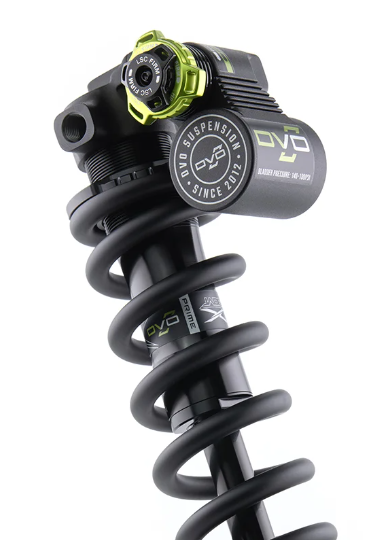

I’ve run the following on a 2023 M10 medium….
DVO Jade
DVO Jade X
Ohlins TTX22M.2 (MTBM 2228 - with compression lever rotated from factory location)

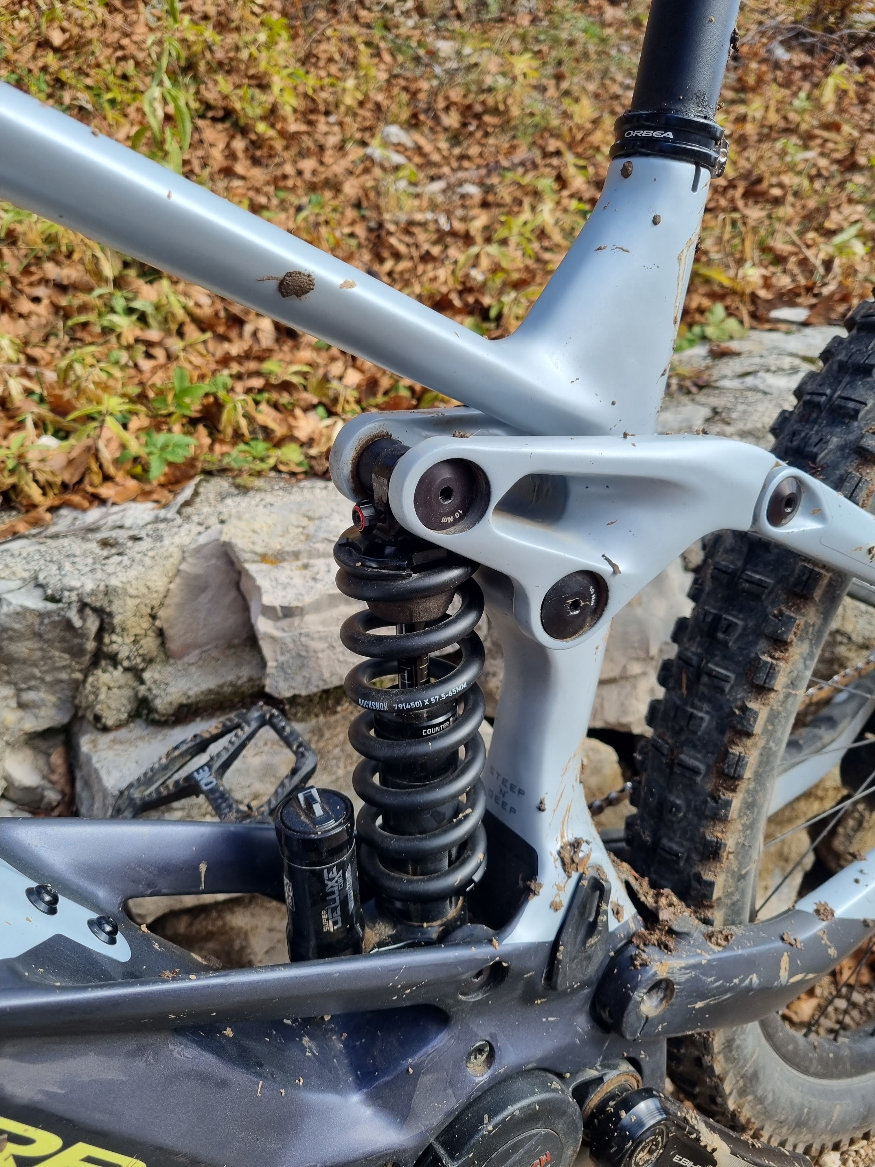

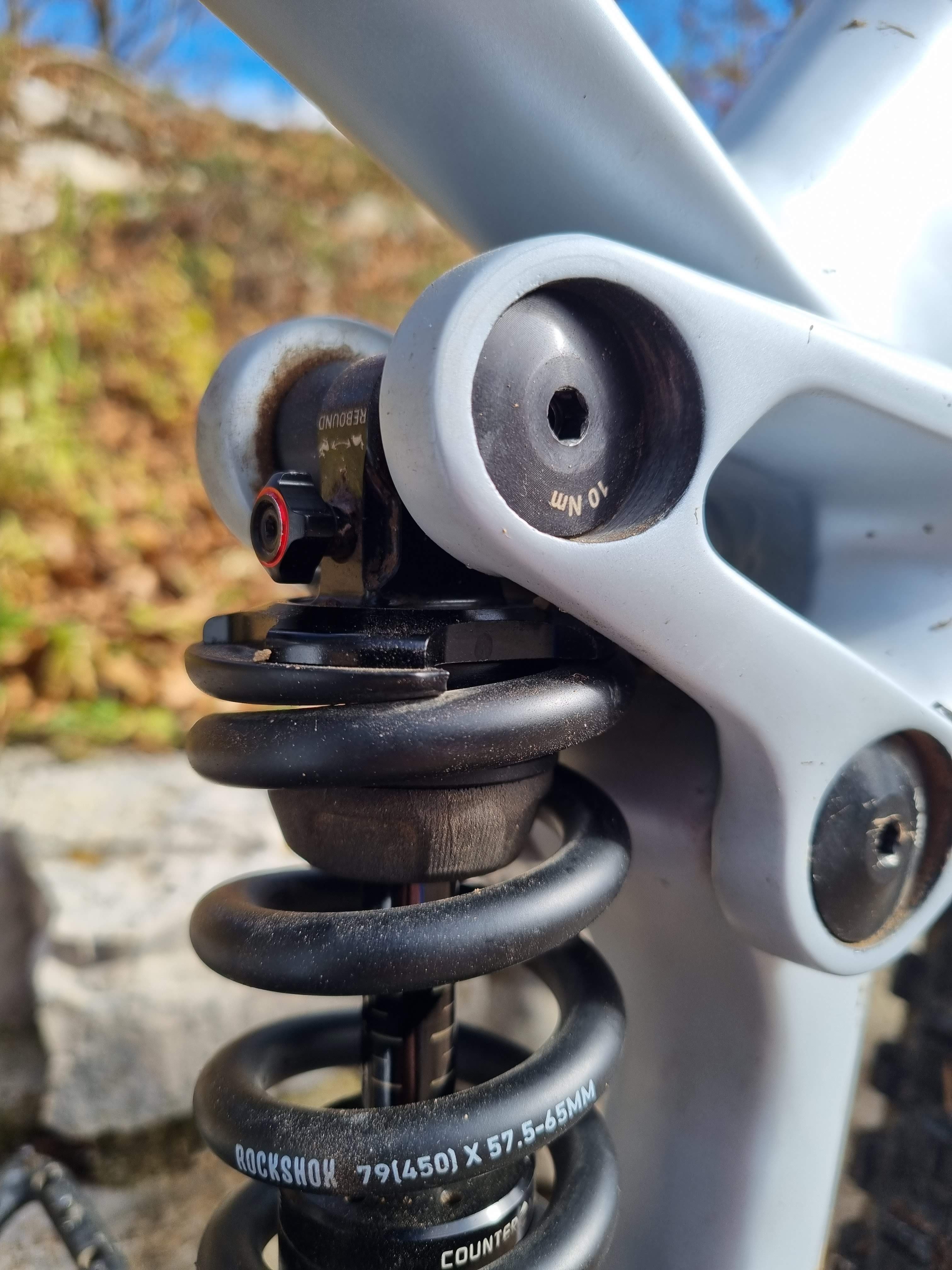

I replaced successfully the air shock in my L M10 Wild with a Rockshox super deluxe coil RCT, using a 450 lbs coil (my weight is 82 kg).

It's a 2022 model. I'm attaching some pictures taken today. Sorry, I don't have pictures at full bottom out, never experienced.
