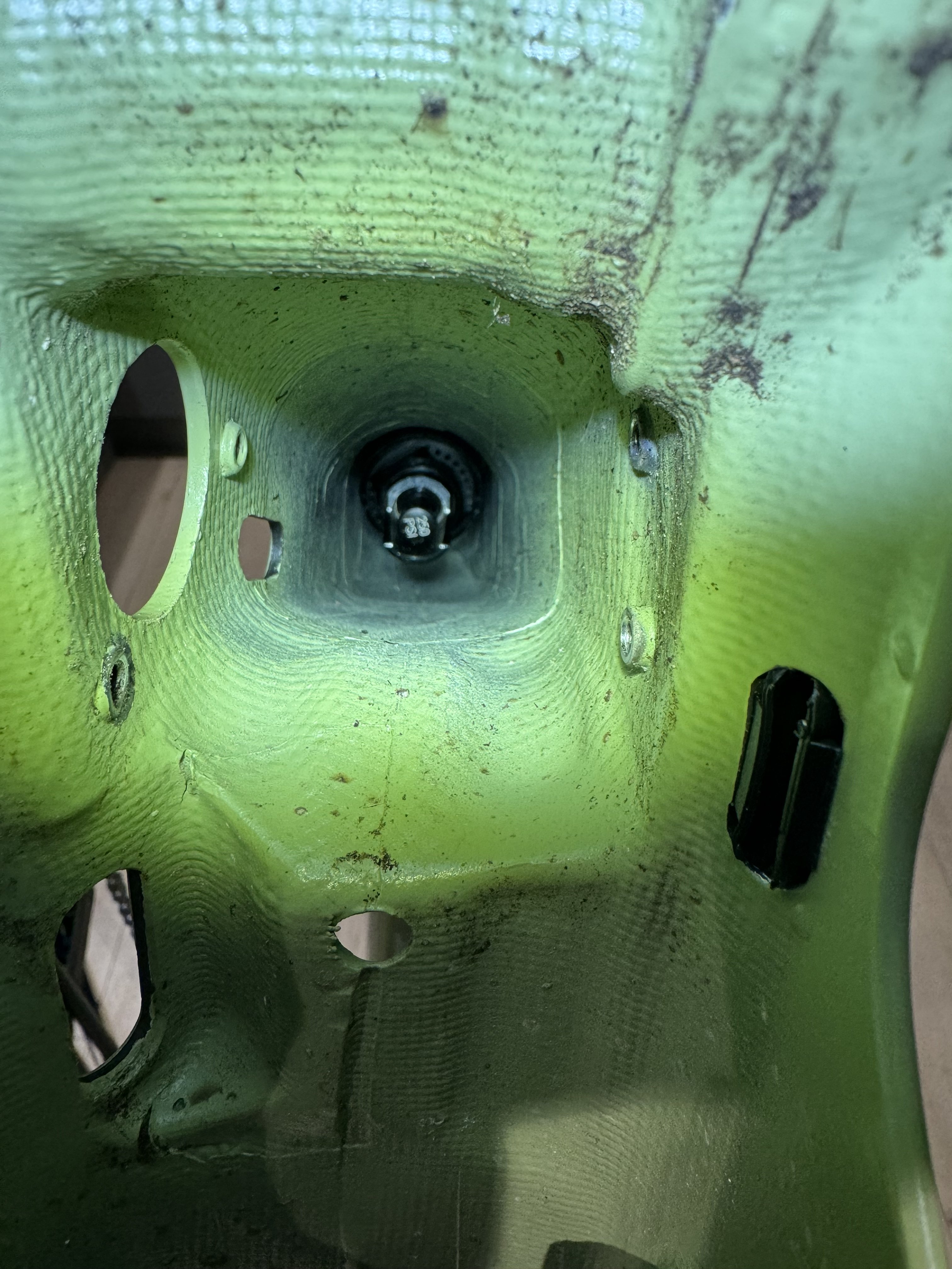

So I’ve pulled the bike apart and got this picture of my 150mm Axs in a medium frame. Maybe 10mm clearance when fully inserted. Bottom part of this post measures 248mm with the vent valve.
