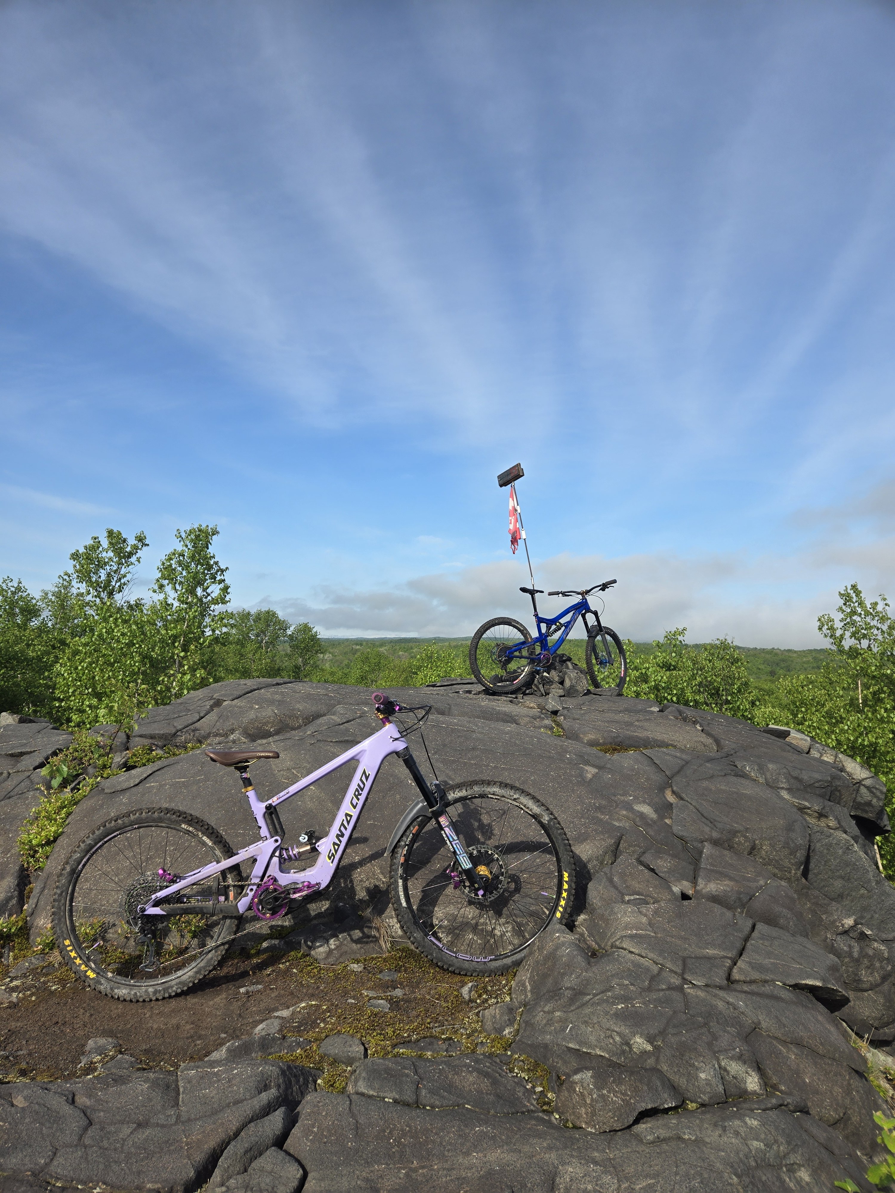

Not too much has changed on the bike since the last update, just been riding the shit out of it.

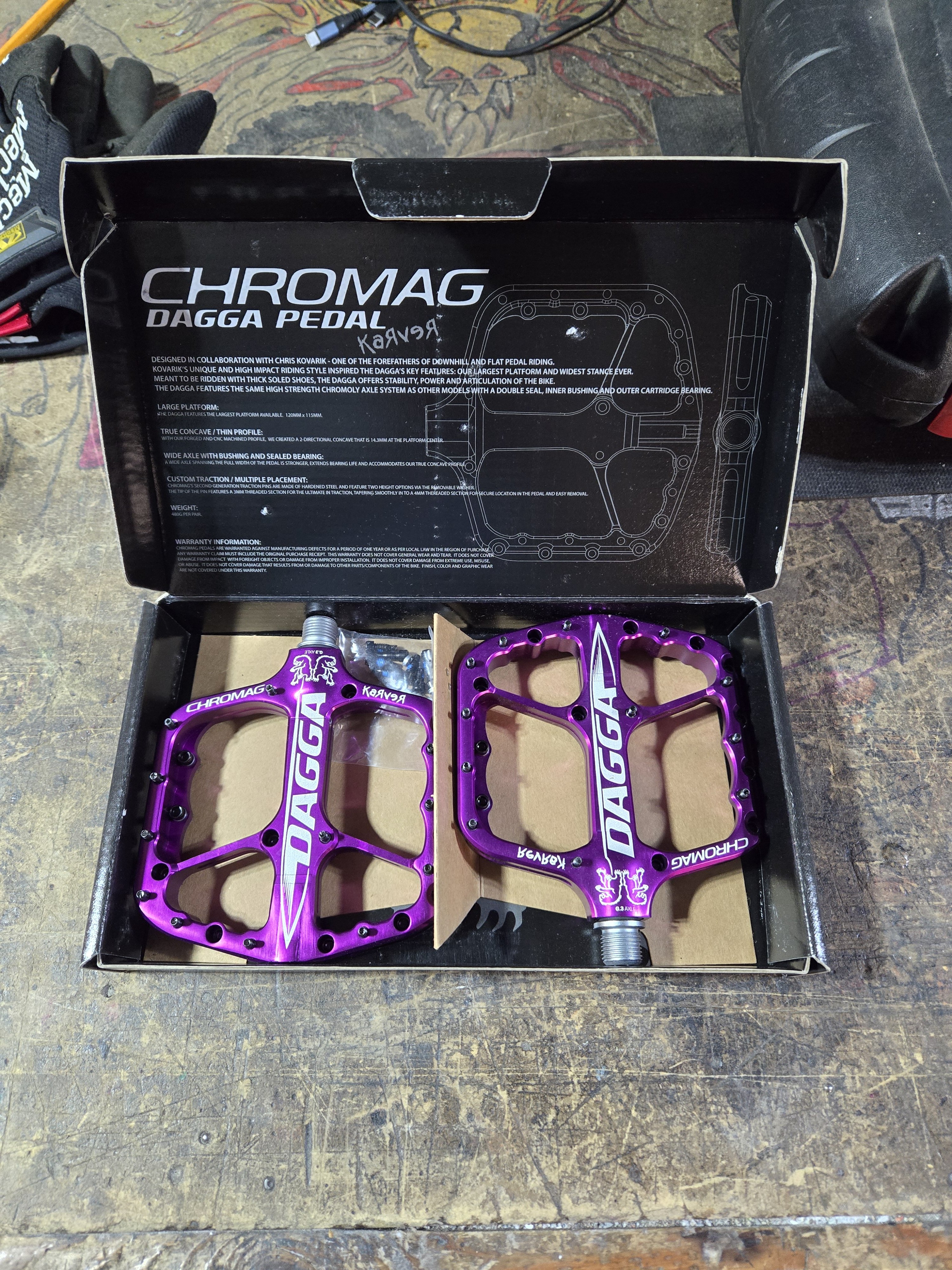

I did throw a pair of chromag daggas on to replace the oneup pedals I had been running. The bearings in the oneups just don't seem to last very long imo. Liking them so far.
Also put the oneup v2 180mm dropper back on begrudgingly. I love the action of the 170mm sdg but the standover height was just too high. The oneup gets the seat low enough for my liking but honestly doesn't work as well as the tellis overall. Seems like it requires more thumb force to actuate.. maybe I've just been spoiled by the surprisingly good sdg.
Last but not least I was reminded how well a maxxis dhf works as a rear tire. I have been switching between a dhr and assegai for rears but had the dhf on the shelf so it got put on. Holy hell, I freaking love it... The cornering is outstanding!

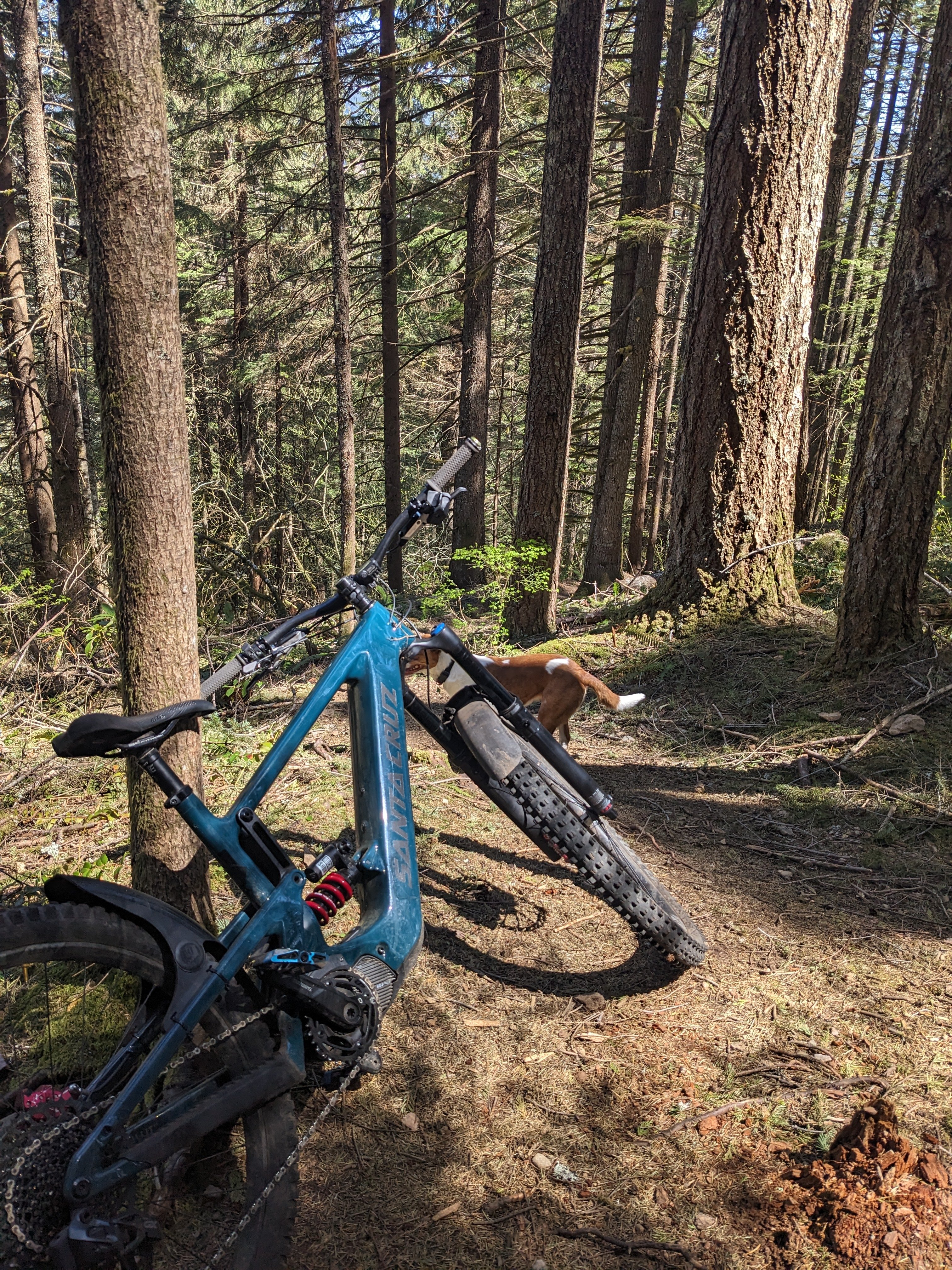

Sweet ride! Here's a recent of mine.its been a beast of a bike and checks all my requirements of a bike that can handle steep and gnarly trails.
One issue I've been having is a steady creak. I thought it was a pivot issue but turns out it's the battery. I need to figure out if there's any adjustments on the battery mounts to make it go away.

Mine was creaking from the udh/rear axle before I tracked it down. Took it all apart, cleaned/greased and the creak is gone.

Glad u found your creak. I found that if I squeeze the battery compartment while riding it goes away. I think u can adjust the battery connectors.

Just wanted to give an update to the creek coming from my battery. After doing a full days ride yesterday and listening to that annoying creek the whole time I went home stripped The battery terminals off and readjusted. As I was taking the skid plate off I found a shit load of tiny pebbles trapped in there which explained one noise and as I was bolting it on it made the same creak that's been driving me nuts as it touched the frame. 2 pieces of mastic tape to keep it from touching frame and my creak is gone!!

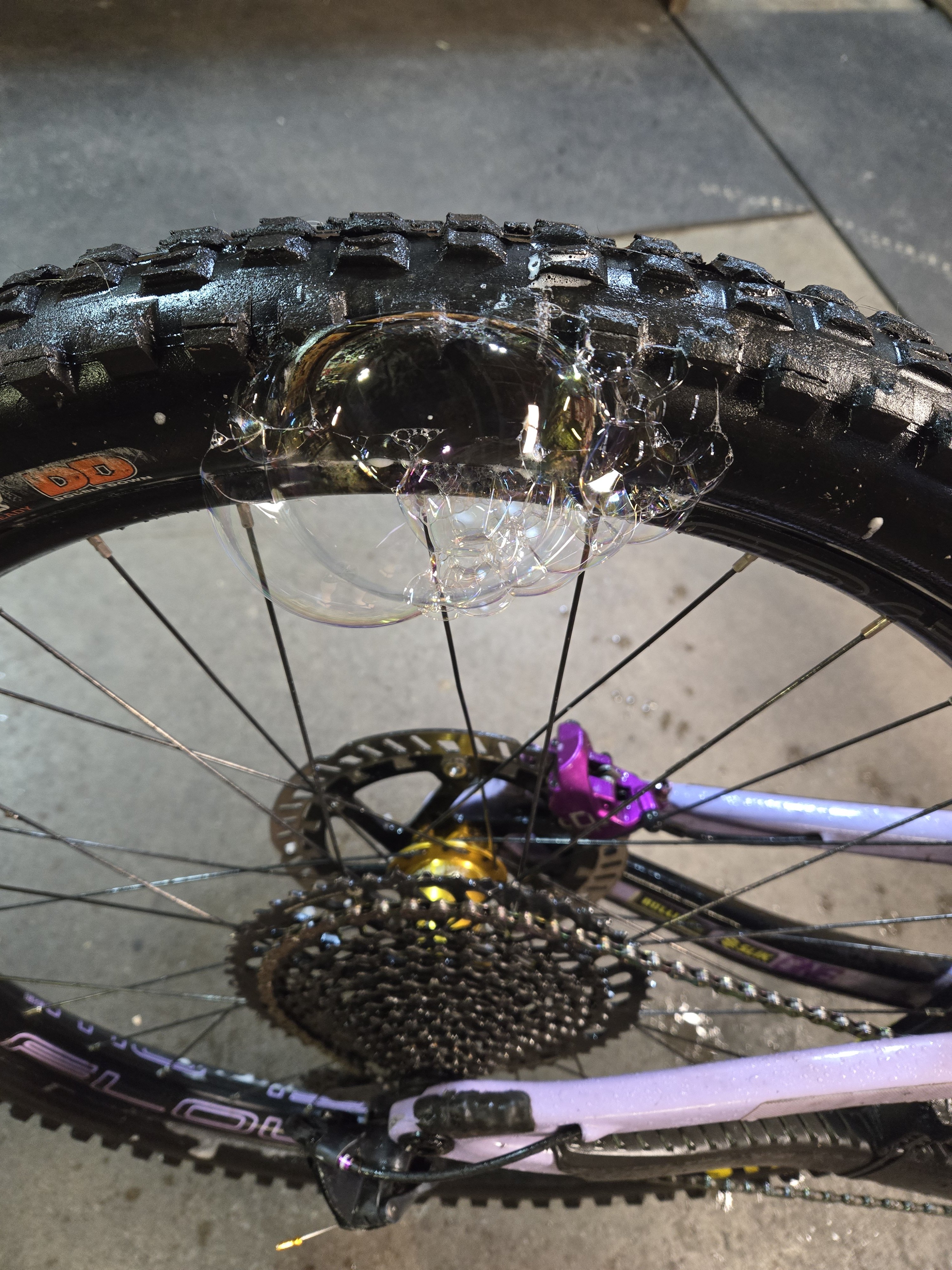

Great ride tonight... till I slashed a tire near the end. Damn double downs. Cushcore saved the day again and I was able to ride out.
Threw my spare wheelset on when I got home and the rim tape is leaking on the rear. Can't win.

With pebbles getting in I wonder if the battery cover and skid plate aren't sealing against the frame?
I had same type of creak so I placed my bike on its back (crank side up) with good lighting so I could take the time to more closely look at fit and seal. Ended up putting thin bead of silicone grease around cover & plate contact area with frame… no more creak and it's been a year.

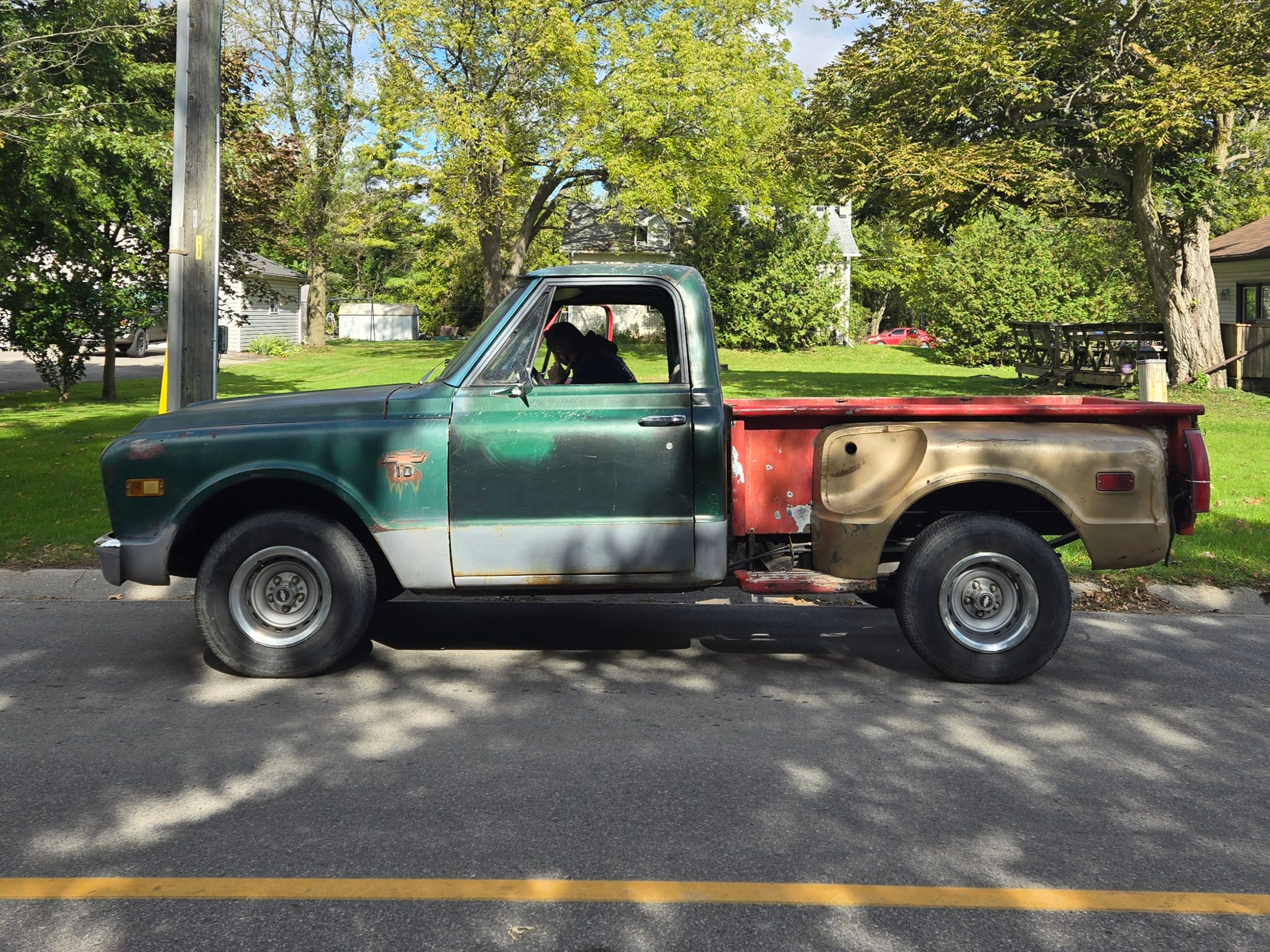

The 40 is put away for the winter and there's a new project in the garage. I picked up a 1968 Chevrolet c10 stepside shortie about a month ago so I've been messing with that.

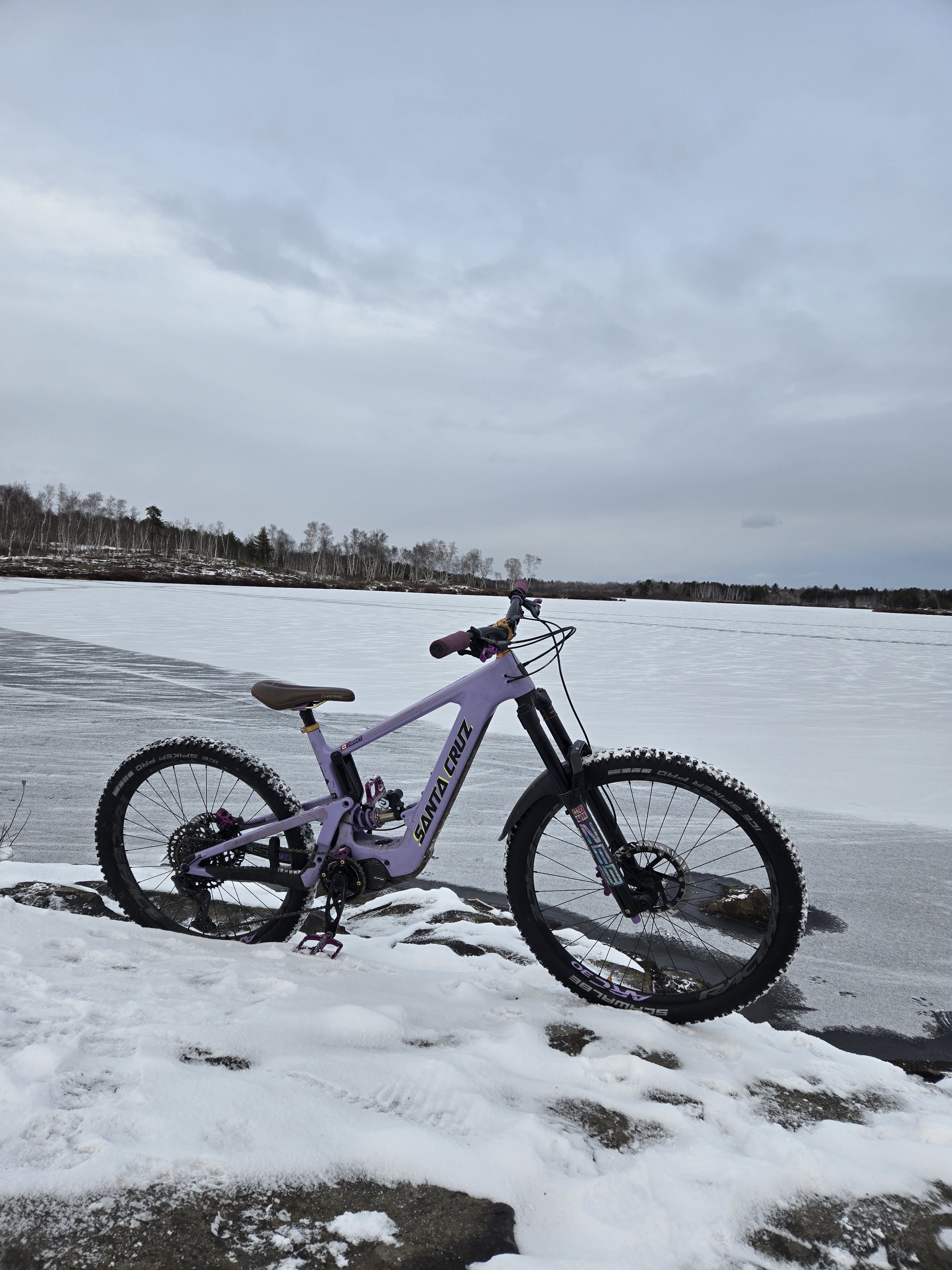

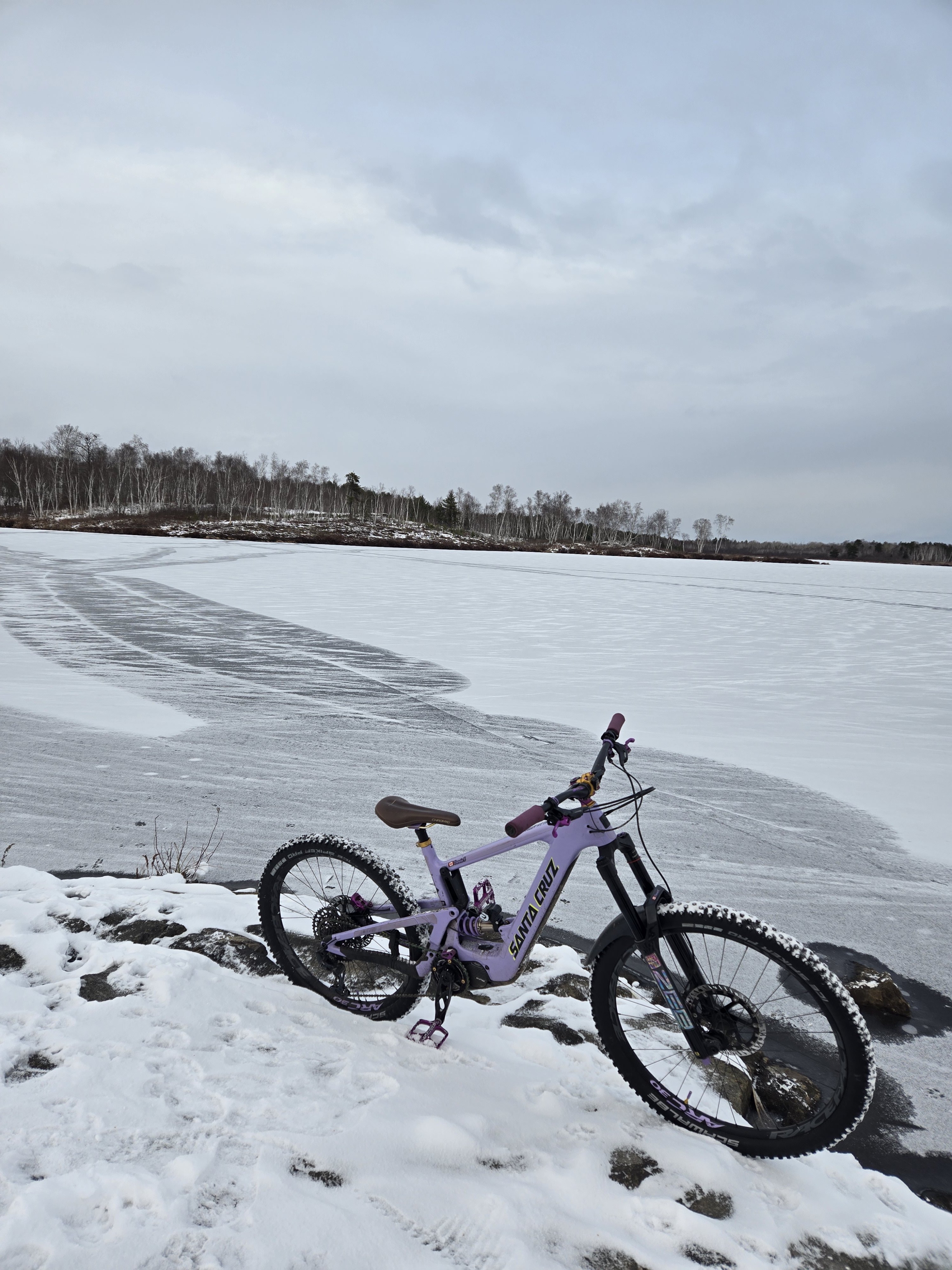

Dreaded riding the hardtail fattie so much I took the ice spiker'd bullit out in the snow last Friday lol. Wasn't super terrible but a fattie would have been better, I guess...

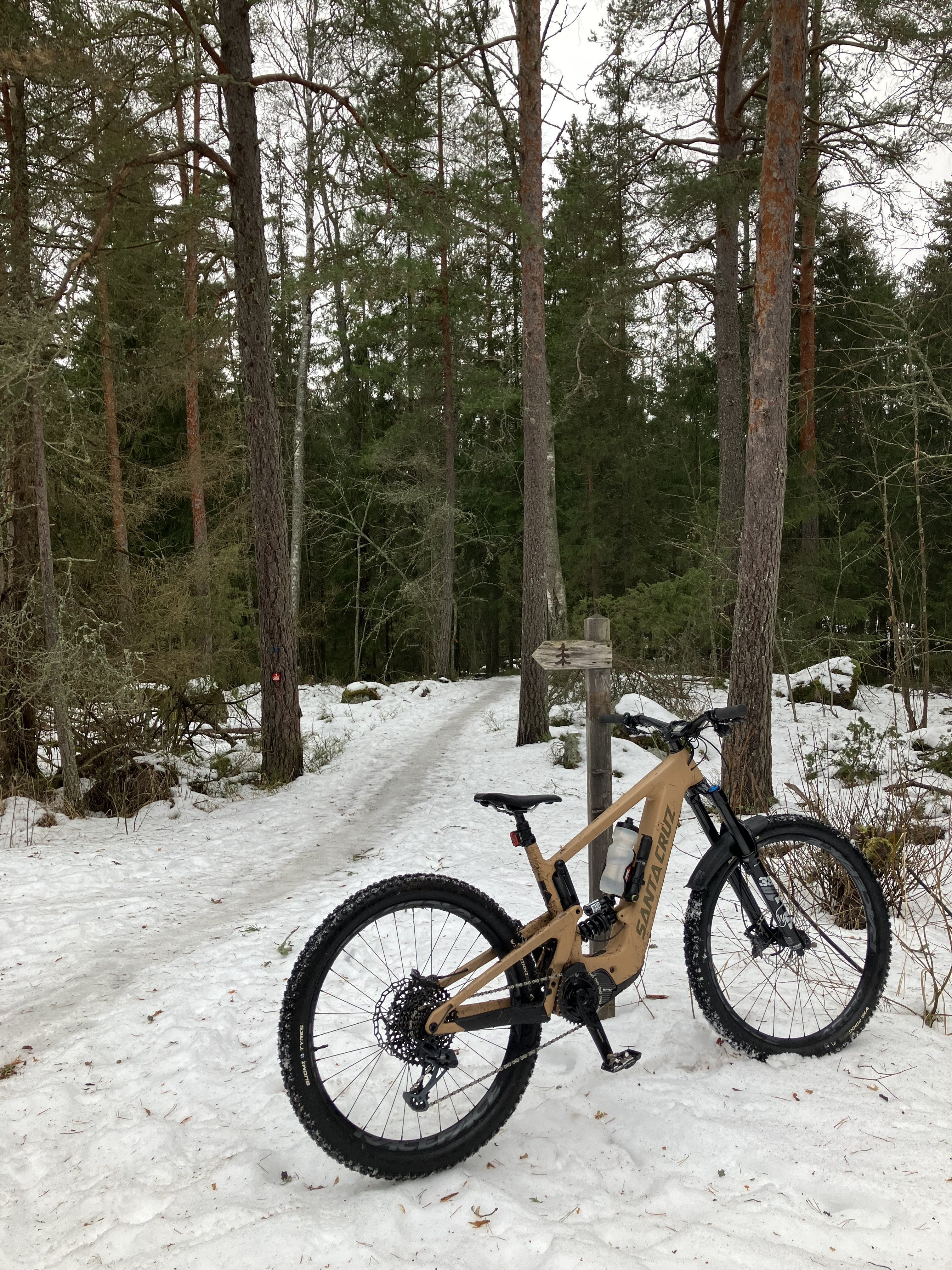

I took my Bullit first time out in the snow few two weeks ago, it thanked me with E914 code...took it out again last friday and again, E914...looks like my Bullit doesn't like snow so much or honeymoon is juts over :cry: Well it was great 8 months/1600km's, best ebike ever :) Shimano will send me new battery, hope it solves this...
I have now experience with Specialized, Bosch and Shimano, started to look some back up emtb because it looks like all bikes needs some repair shop time :D

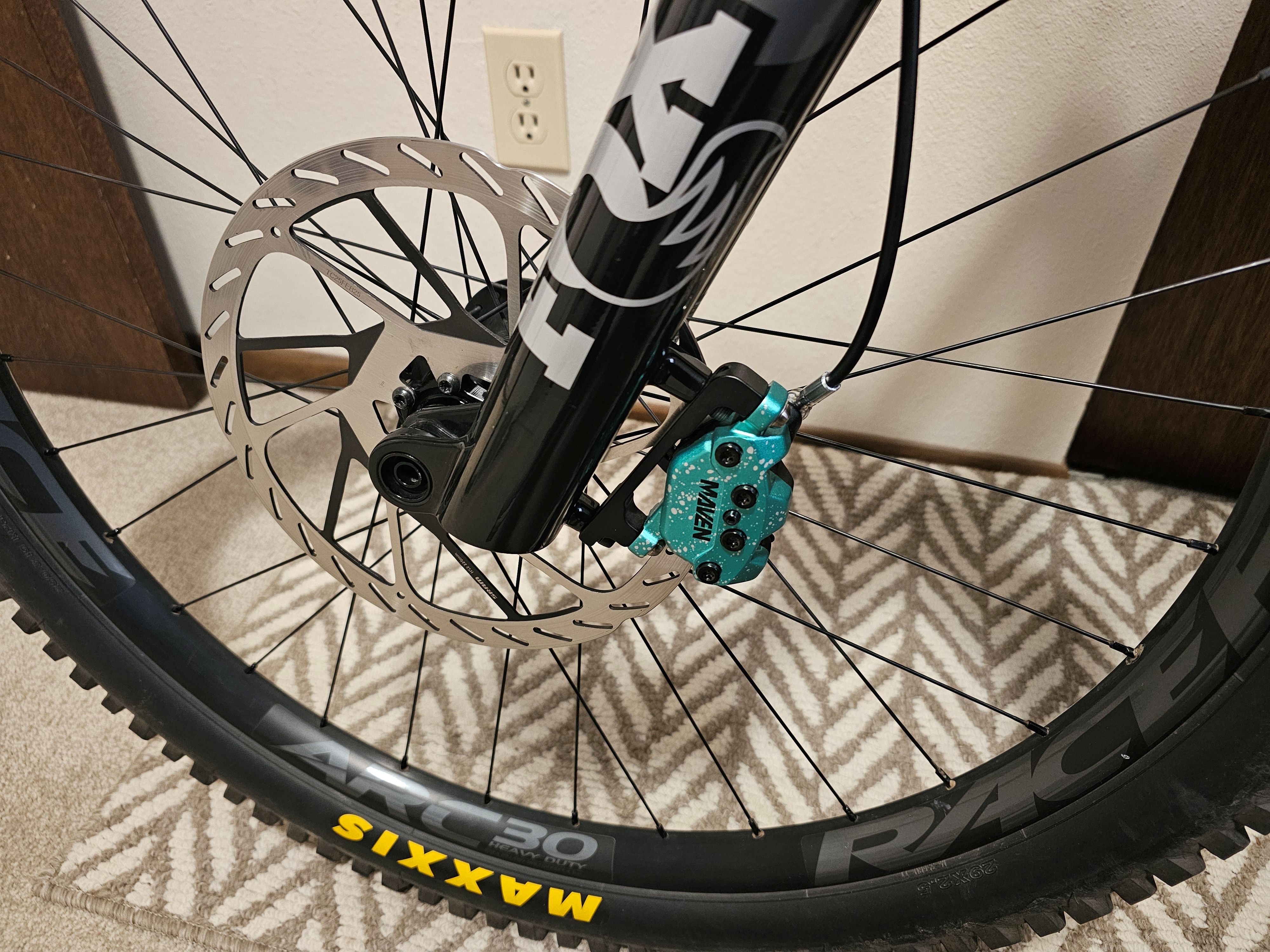

New Mavens! Going to give them a workout tomorrow. Last upgrade I have planned for this machine. I can already tell I'll have to be careful on the technical stuff when on the brakes. They bite. I went with the 220 rotor up front and 200 in the rear w/organic pads.

I expect you’ll love ‘em. Both my son & I switched out Codes for the Mavens, just be sure you get a good bleed. Since we have a lot of long steeps here in California we changed pads to MTX brand (he's running Gold formula F&R, since I’m not as aggressive/fast rider I run Gold version front pads and Red rear. We both use Sram’s latest rotors 220 front & 200 rear.
