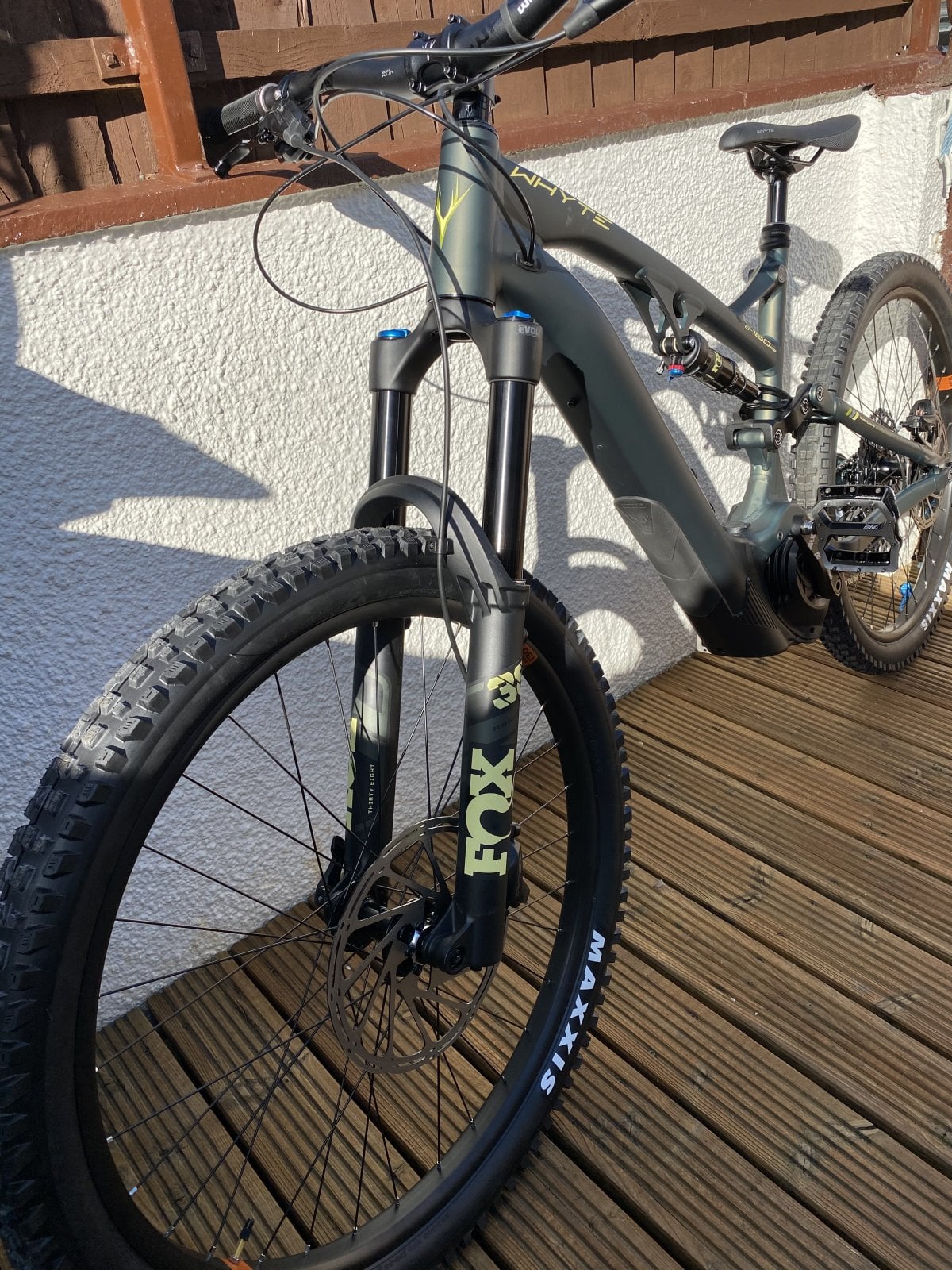

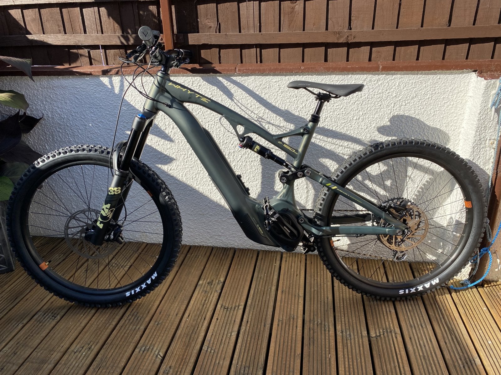

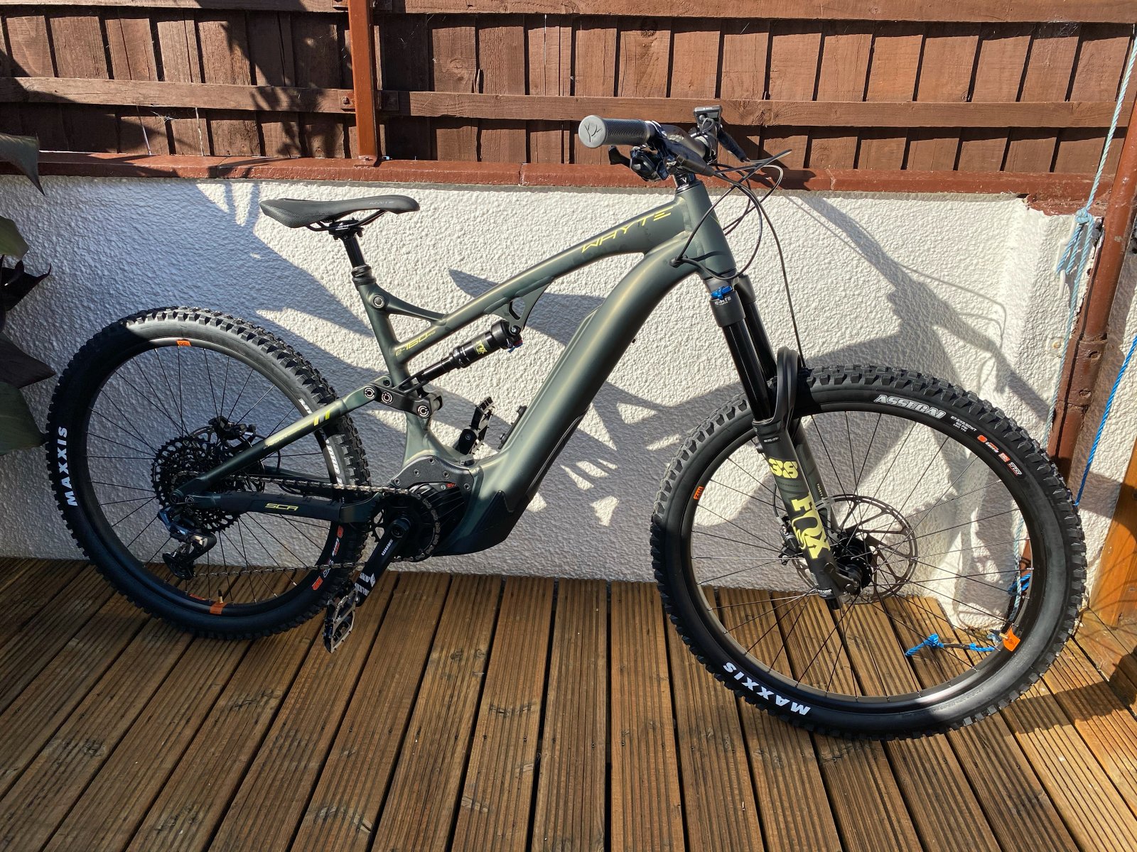

Bit later than expected but its home! Managed a go on it one handed (one arms in a sling due to broken shoulder blade). All I can say is wow ? steep hill on the end of my street, absolutely flew up there. Can’t wait to get out on it properly. View attachment 37297

looks great, is there any chance you can take some pictures of the new gear cable routing over the motor? Does the cable pass through a grommet?

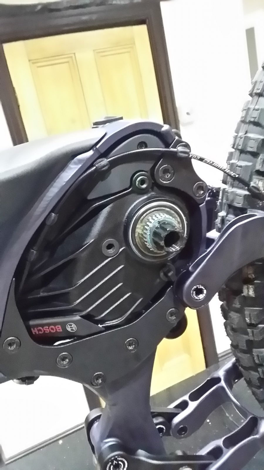

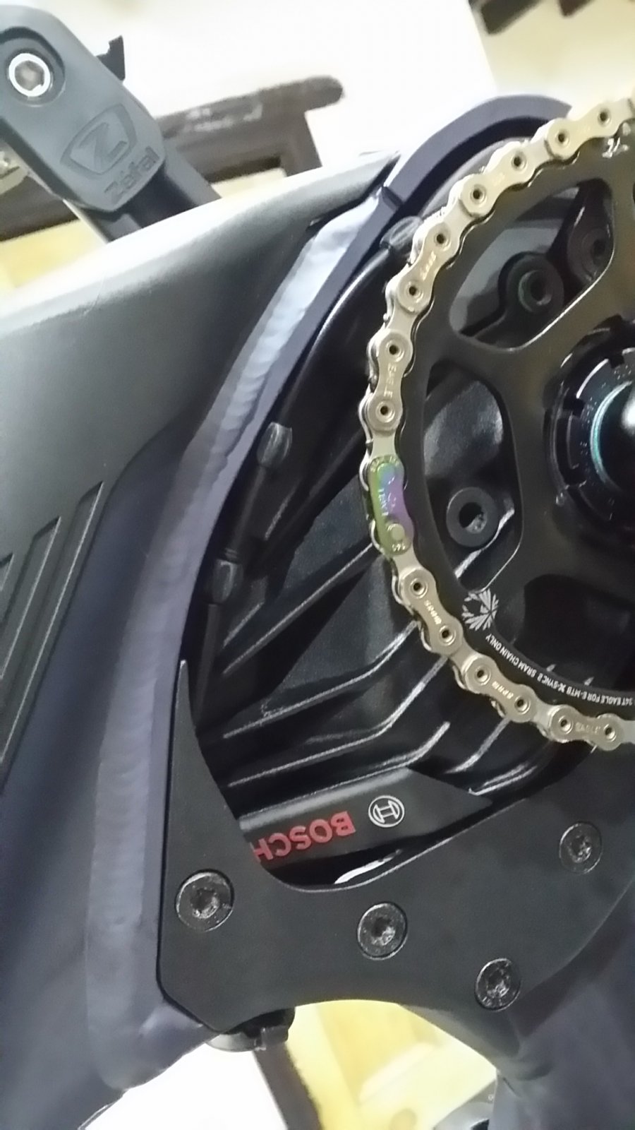

From this MBR picture, looks like brake hose is unchanged, but speed sensor and gear cable both moved.
My guess is one or two new holes in the motor casing, just below and behind the pivot point.
I can see the drill coming out, come winter :eek:
Guy's I am going to need detailed pictures of the outside, and pictures with the LH motor cover removed.
Sorry to be a pain :p:p:p
As soon as I get clear pictures of how it's routed the drill will be out! I've even got the proper grommets ready and waiting. My current routing is alongside the motor under the crank spindle which works ok for now.

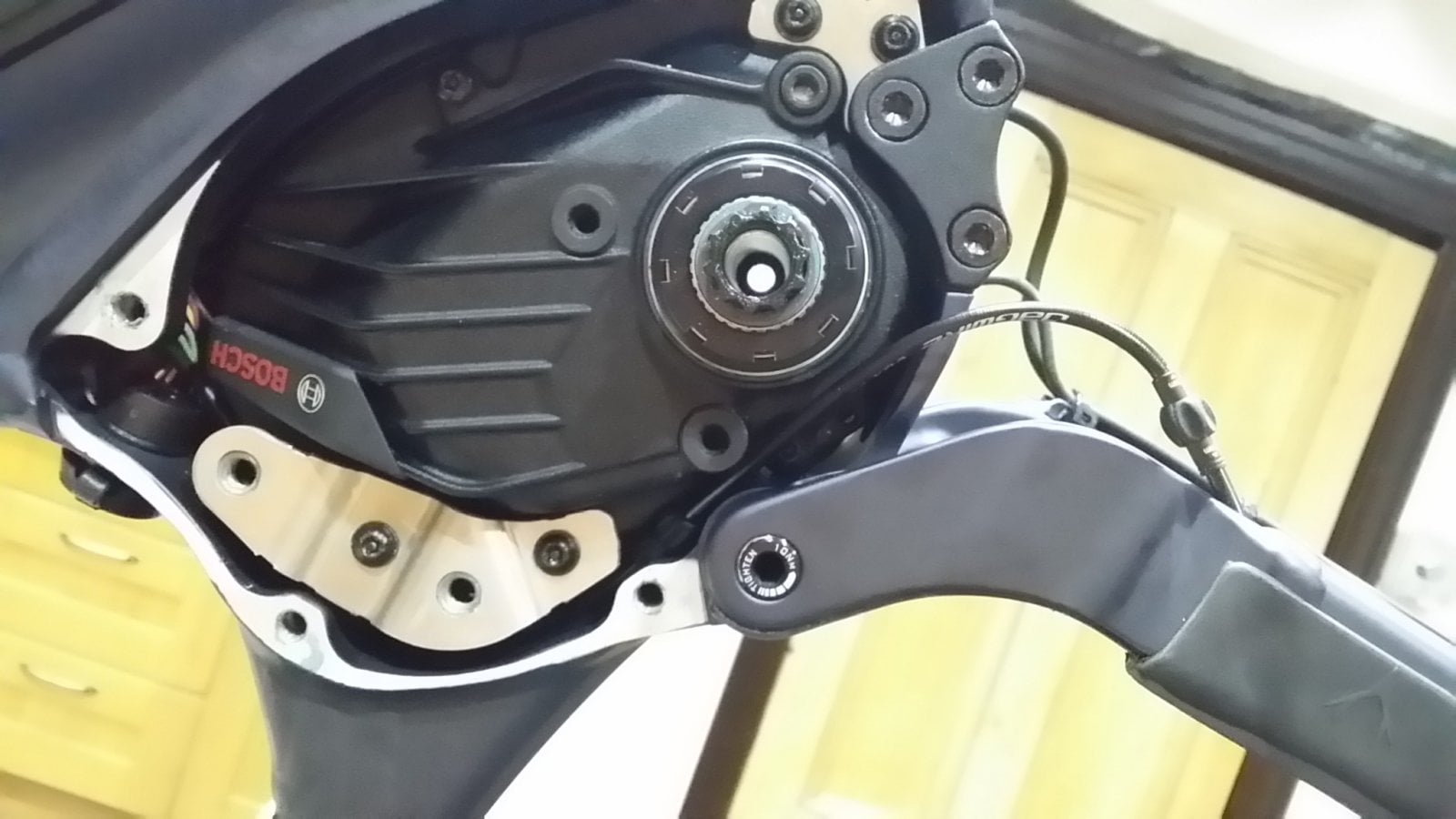

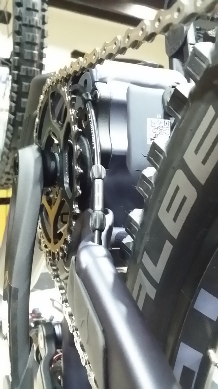

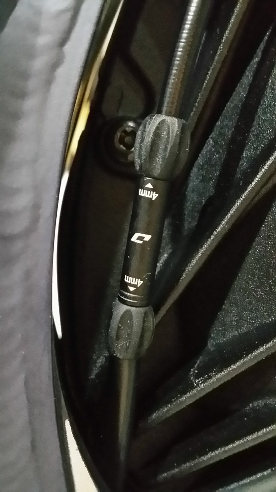

Hi, did you manage any more pics of the gear cable routing? Mine is stripped and ready to mod depending on how the new routing works. This is my current adaption using a jagwire flexible cable section bought from bike24

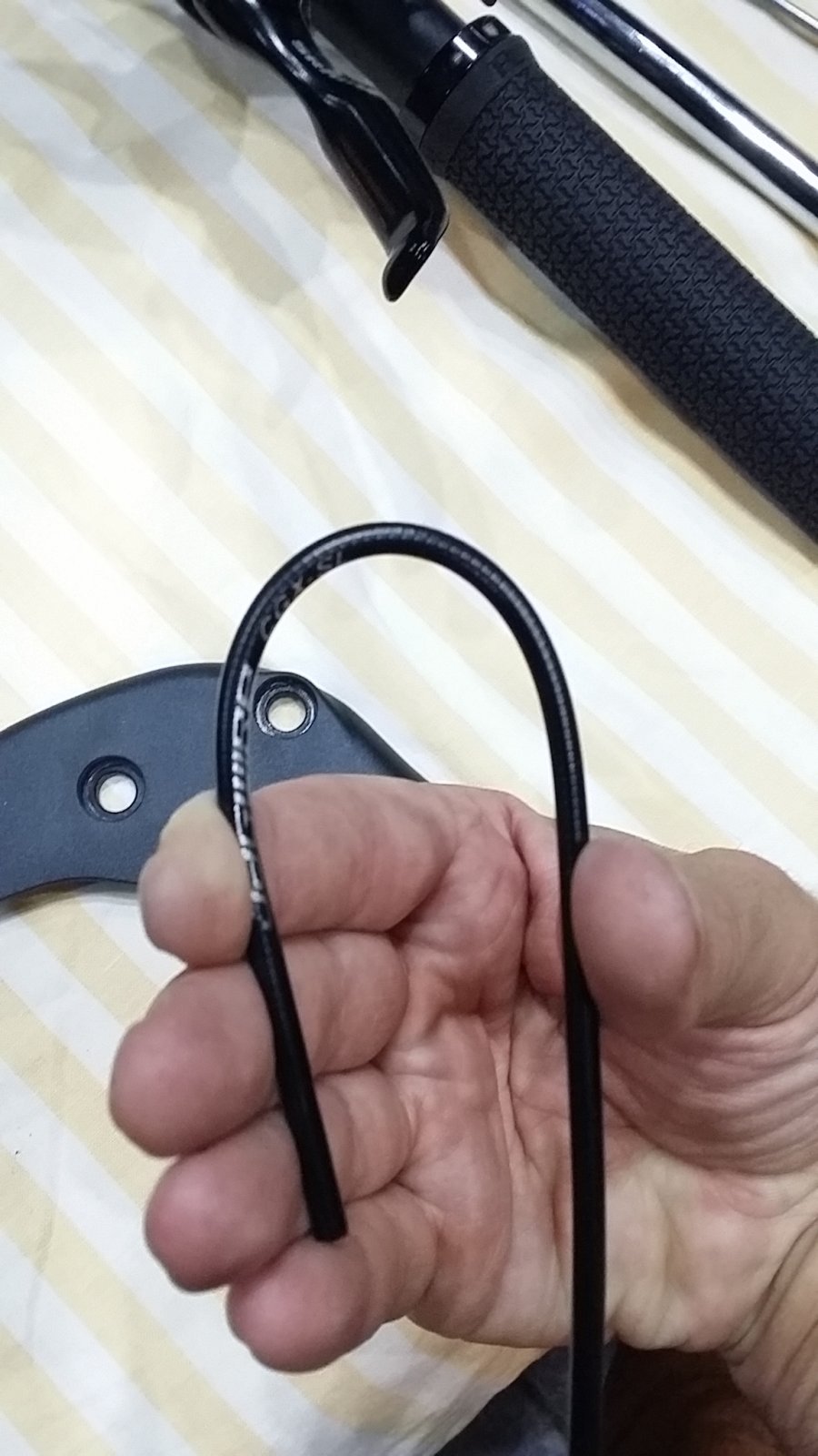

Is it not just a single length of Jagwire outer?
Does it stay in place?
It comes as a 25cm length with a double ferrule at one end so I had to buy two to get two ferrules so it could be added into the existing cable. It's basically spiral wound outer casing like old brake cable outer but in a smaller size. It can bend round a very small radius. It seems to be stopping in place ok at the moment but I have thought about making a support that threads into the spline bolt directly above the crank spindle for the new routing.

This seems to be the neatest option and places the cable nearest the pivot axis. I don't think drilling the frame to take a grommet would be of any benefit with this routing.
Here is the link to the flexible housing
