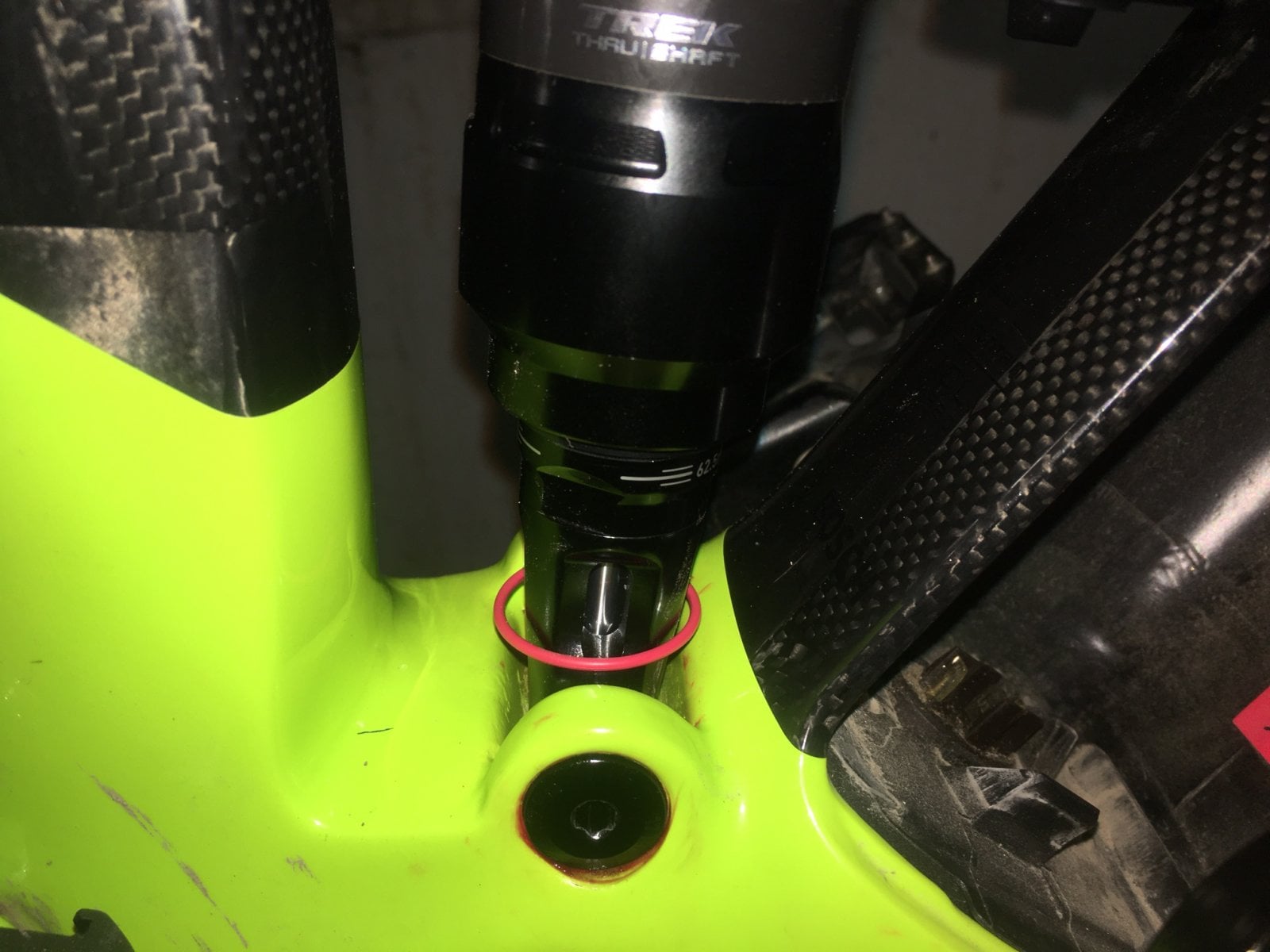

I realised I don't actually have the means to - then I looked at the later shocks & realised they have a weird lower clevis mount which is I assume for the thru-shaft to poke out under compression (and handily also allow all the oil to piss out when it inevitably fails? :) ), which answered my just a thought ramblings.
I've run an 11-6 at 62.5mm travel, now on something that started life as a DPX2, but no Fox internals, also at 62.5mm stroke. Couldn't get that much travel out of a Storia unfortunately, due to piggyback sizes.

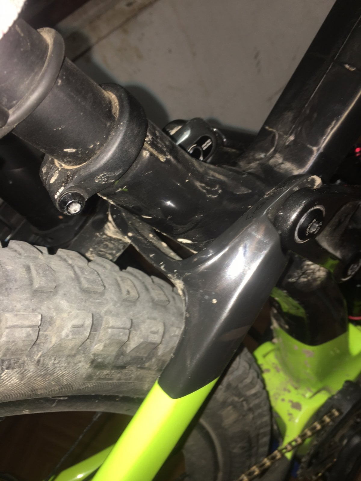

Things to consider. The brace on the seat stays comes 'very' close to the seat tube with the increased travel. I run mine at 62.5mm & only have ~2/3mm on a hard bottom out, which is a little close for comfort when you allow for frame flex. Bear in mind mine is a L frame, there may be more clearance with an XL.
Also consider the tyre may buzz the seat tube and or saddle.
Except that's not how it works, because at that point in the linkages travel the ratio isn't 2.608. It starts at 2.4 and drops to 2.35. Thanks for the frame clearance heads up (y)

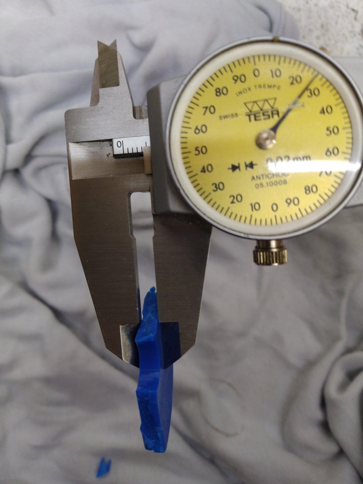

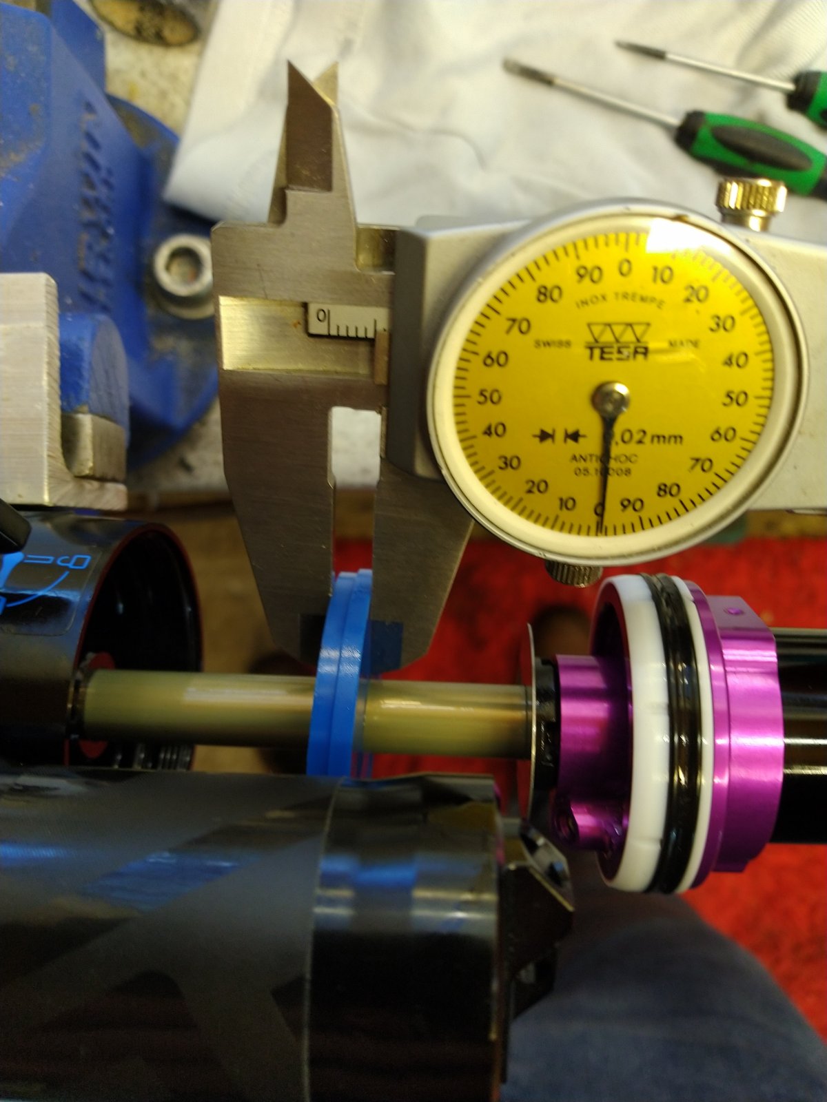

Ok it's done. The shock is fine with the spacer cut out as has been said already. There isn't enough frame clearance with the minolink set to low on my medium but plenty with it set to high. This steepens the head angle up by 0.5 degrees, which will be offset by the fact that the sag point is now different and the forks are getting bumped up to 170mm. The HA measures 64.7 static as it is, with the minolink set to high, Zeb's at 160mm and a 3mm cane creek spacer under the lower race for fork/frame clearance.
The blue shock spacer is actually 4.2mm as it's recessed slightly. So good for just under 160mm total travel.

I've got a 9.8xt in XL, is it the shock to downtube clearance you had issues with?
Nope it's seat stay bridge to seat tube clearance. Just swap the minolink to high. The difference in HA when riding with sag and forks bumped up to 170 will be tiny. There's no chance in hell I'd ride the bike with a 62.5mm shock with the minolink set to low.
I'm assuming yours is a carbon frame & zerofunds, hobnobs & Robs are aluminium.
The different material frames must differ in clearence at seat tube - seat stay bridge area.
Edit...
I just checked my carbon frame clearance with the 57.5mm bottomed out, it's 15-20mm so already really close.

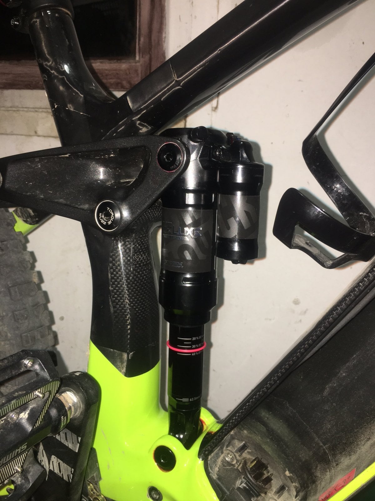

Hello guys, just confirm that you can use Rockshox Super Deluxe Ultimate Thru Shaft from Slash 2021 also on carbon version. Mine 9.7 2020 with new shock (230x62.5) and fork (zeb ultimate 170), which should be same as on rail with removed blue travel spacer.
Yes works mint, just be careful of the gap between the seat and rear tyre, if your sitting down at full compression it's gonna buzz your backside. Ask me how I know ?

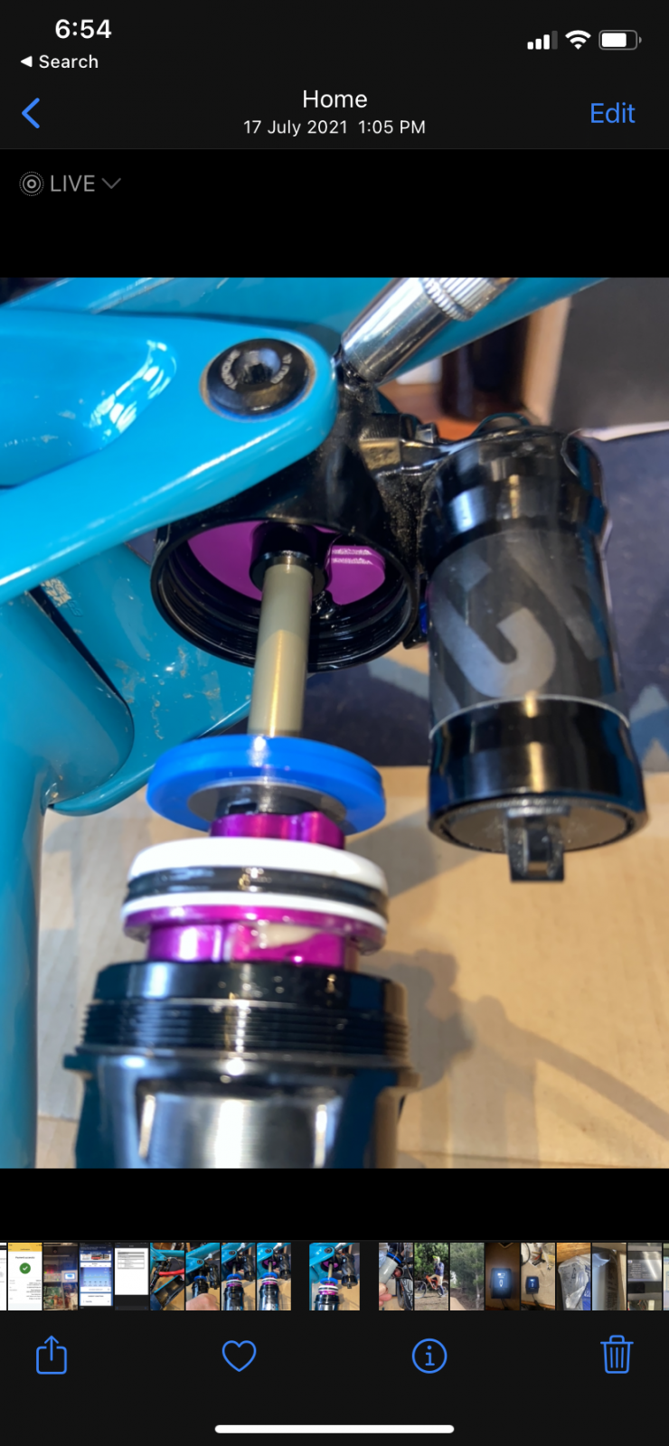

Do you think this tune is reversible? From Trek Slash shock 230x62.5 rebuild shock with adding 5mm travel spacer and get stock Trek rail 230x57.5? I found these 2 spare parts which should differ from these 2 shocks, but thinking if only markings on damper body is different or is it really different part + 5mm travel spacer. I have shock 230x62.5 in minolink High position but feels that bottom bracket is too low and getting hits to motor cover frequently so thinking about rework it to factory settings.
11.4118.054.002 - ROCKSHOX DAMPER BODY SDLX THRUSHAFT C1 62.5
11.4118.054.001 - ROCKSHOX DAMPER BODY SDLX THRUSHAFT C1 57.5
Slapbassmunky
Aug 1, 2020
285
300
Isle of wight
To replace the spacer the entire shock needs to be fully stripped down. But yes, you can add the spacer to reduce a slash shock to 57.5mm.

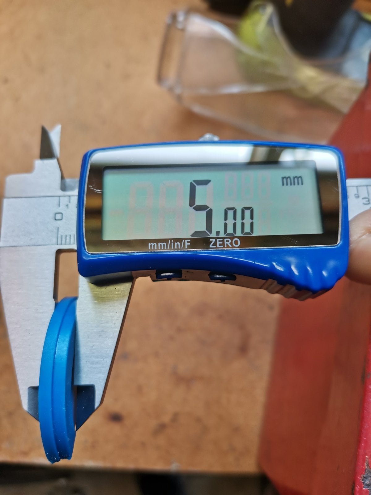

You could dremel out a channel the width of the shaft so that it looks like a C and slide it in.
You could, and it'd probably work as long as the channel was a touch narrower than the shaft. Giggiddy.
The seat it sits on is pretty small though. I'm not sure i'd trust it not to open up and slide down on a hard bottom out.

If one cut the spacer with a Dremel, do you think it could be removed without braking it ?
If it's broken, may be one could 3D print 2 "C" shaped parts that lock together (with some pin), and glue them...
@JMD I have an XL 2021 carbon also. Did you do the mod on yours ? With the minolink in high ?
If you want to use a Dremel you're a braver man than me, one nick on the shaft and you'll have problems.
