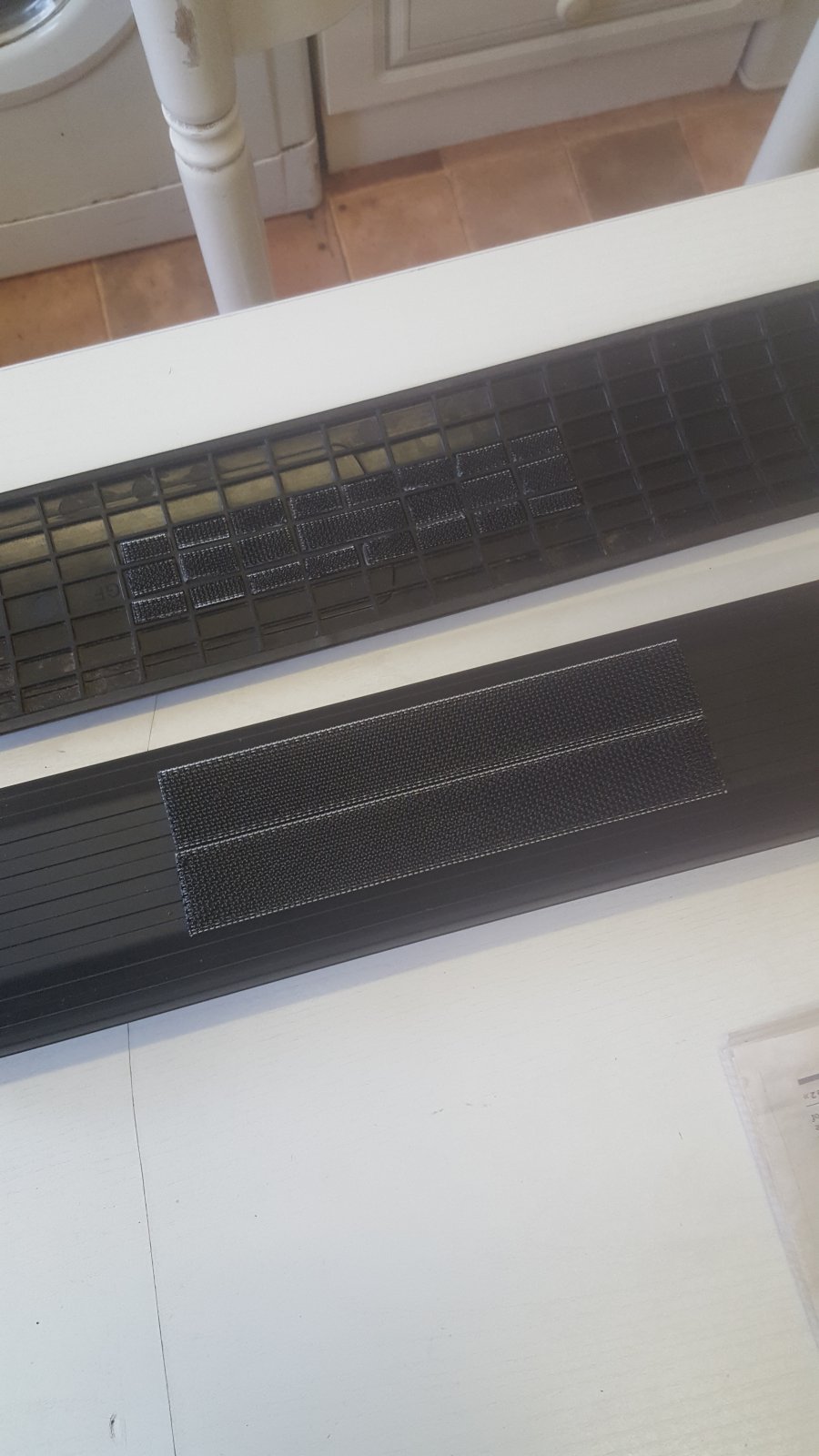

Anyone else notice a bit of play in the top clip that holds the battery? When cover is off I can feel it, and over rough terrain I can hear it clattering about.
Cisco
May 1, 2018
186
182
Elderslie
Yeah, Mine was rattling too but seemed tight in place. I think part of the noise is the cover vibrating as it is fairly flexible. I was going to adjust the battery mount but it needs the correct go/no go tool/dummy to get it spot on. I ended up with some foam behind the battery and some Velcro Alfa lok between the battery and the cover. Bike is quiet now :) .
Also, check your chain ring lock nut (reverse thread 40nm) and your motor mount bolts. As with any new bike things can work loose if not properly bolt checked.
ATB Frank
Thanks for the reply. I've tried some foam behind the battery also with some success but still some noise. Interested in trying the Velcro Alfa Lok, had to Google it to see what it was? Any pictures of it on the battery?Every little helps ? Thanks again.
Hi, I just put a 6" piece at midspan on battery/cover. Just use normal velcro it should work fine. Good luck with your new bike. I tried it out with a 650b wheel today. Feels great too!!

Interesting, tried the velcro on battery and cover this evening but it's causing the cover to sit out too far and I can see daylight through it now?

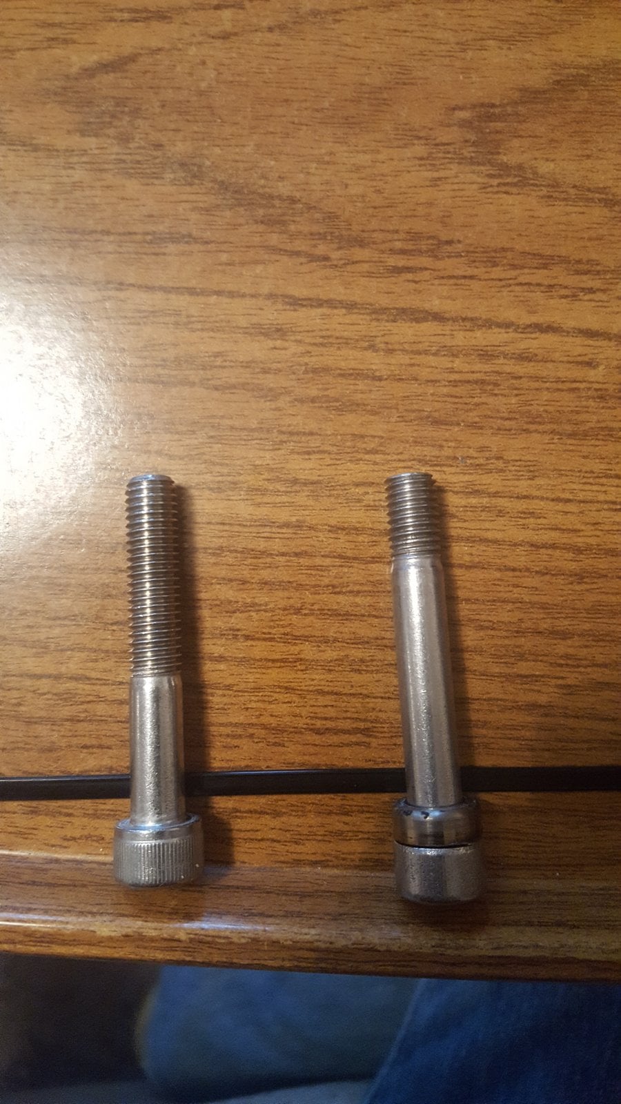

I've ridden the bike a few times now, and am loving it! One question, has anyone else had an issue with the lower shock mount loosening off?
Silencesound
Feb 11, 2021
10
Bt465qq
Yes I have. Tightened up again and then was wondering should it have greased it as it was dry, but not sure if your supposed to.?
Cisco
May 1, 2018
186
182
Elderslie
Cheers, I was wondering about threadlock given that it's happened a couple of times. Good to know it's not just my bike though!
When I replaced my shock I realized that Vitus had used the wrong mounting bolt for the lower shock mount. I replaced it with a bolt which I made up with the correct stem length. The original (wrong) bolt is on the left. You can see the problem. I assumed that it was just my bike but I found a post on it on FB here
Shardlake1543
Oct 11, 2019
15
10
Marsden
When I replaced my shock I realized that Vitus had used the wrong mounting bolt for the lower shock mount. I replaced it with a bolt which I made up with the correct stem length. The original (wrong) bolt is on the left. You can see the problem. I assumed that it was just my bike but I found a post on it on FB here View attachment 57208
Good knowledge, I'll check that, thanks.
Cisco
May 1, 2018
186
182
Elderslie
@Cisco please can I ask where you sourced the bolt?
Soz, I had it already lying around and cut it down. I needed the collar you see to ensure that the bolt was in tension rather than have the bolt stem back up in the receiving thread. The bolt stem should be the same length, or a couple of mm more than the shock bottom mount. Bolt spec is A2 IIRC.
Check the FB thread I posted, I think one of the guys bought some on ebay...
