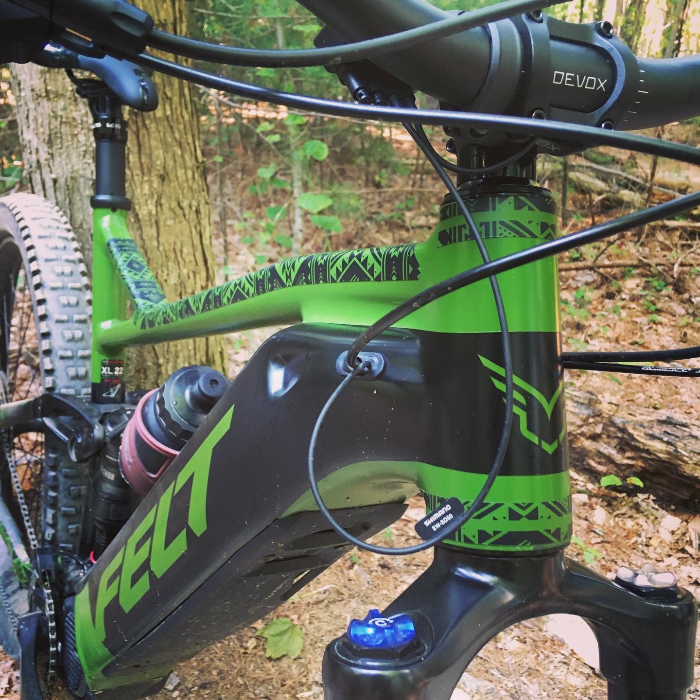

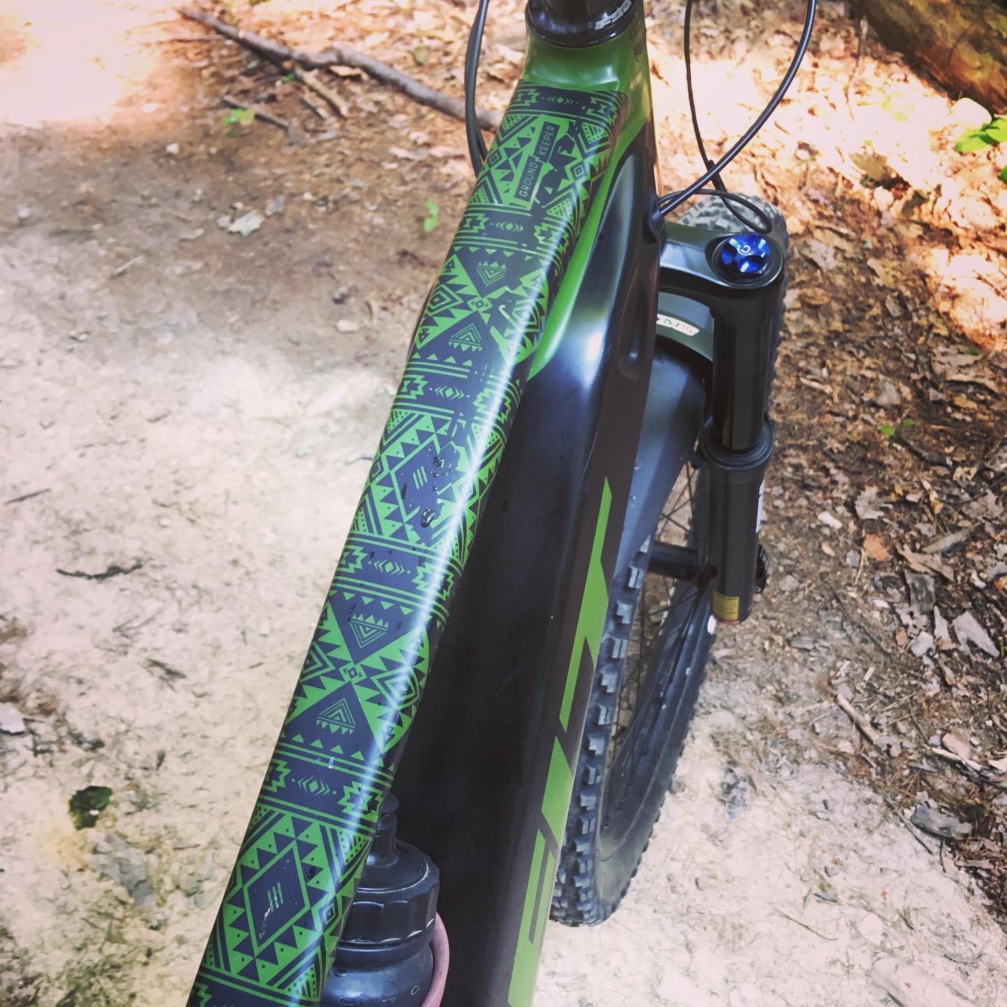

After doing a ton of research earlier in the year I purchased a 2019 Redemption 50 off of eBay in April. Got it brand new from the wheel and sprocket and wow what a deal! I paid $3200 (including the 2 year eBay warranty lol). After doing all the research I realized the 2019 had the better drivetrain vs the 2020 option and in addition the 2019 came with a 35mm SR fork instead of the 32mm RockShox. Gotta say I love this bike.
It’s mostly stock, I did upgrade the shock though, I went ahead and installed the MegNeg kit and it’s amazing. This bike should be spec’d with that installed. No more wallowing in the travel, it feels bottomless. Waaaay less rock impacts and getting hung up. Seriously the best $90 you can spend on the bike.
Aside from that I’ve just added some vinyl graphics to protect the paint. I also installed some moto foam around the motor. I'd recommend doing that if you haven't already. I stole the idea from YT, they do that with their Decoy. I removed the bash guard and cut some down to size then reinstalled in and packed in additional pieces in any gaps in the frame I could find, like around the base of the shock etc. Hmm what else...I have a set of 170mm crank arms I need to install because the 175’s are just too long. I also have a new bar/stem combo I’m gonna install but I need to drill holes In the bar so I can keep the internal routing (I’m only a little sketched out about that). Oh and I purchased a crazy bash guard for a Merida ebike off of another user on this forum actually. It’s a great looking product, however I’m going to need to modify it slightly before it’ll install properlyI’ll share pics of that when it’s done.

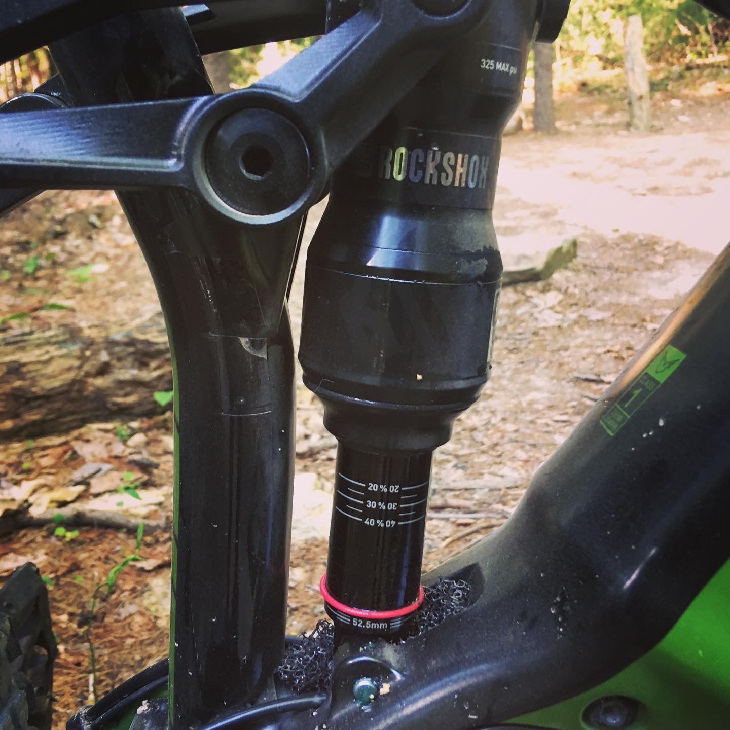

Yea I did the shock myself, took like 20-30 min. Super easy, just give yourself a nice clean work space. The hardest part is pumping the damn thing back up to 290psi
The decoy is sweet, feels a little small but definitely playful and of course the extra squish is nice. But I have no complaints with the Felt so far, i've taken this thing over some really gnarly terrain and love getting it airborne. I'm riding DH trails with complete confidence. And yea i'm considering two options, 1. i'll probably get a 29er wheel to toss in there for a mullet set up (since the fork is 29er compatible...) and 2. i'm probably going to get a Marz Bomber Z1 Coil 170mm 27.5 specific, that way I can get 20mm more travel and retain approximately the same geo and axle to crown height as the SR fork. oh and the red would look sooo good with the green

My shock came with 2 tokens in it already, and I kept bottoming it out off jumps/drops, so I put in a third token and I'm maxed out. I'm not bottoming out hard anymore, but I do feel like it might be better if I had more negative air, and more pressure to keep the overall spring curve more linear. What was your final setup for number of bands in the MegNeg? I'm curious to know how much negative/positive air volume you're using.
I don't think this frame's leverage ratio curve is very progressive, considering how many tokens I need, and the fact that you like the MegNeg so much. Considering the lack of progression in the frame design, I would recommend against putting in a coil. Since you can't manipulate the negative and positive air volumes on a coil to compensate for lack of frame progression, it's likely that a coil would run like crap on this frame.

I went with the recommended two bands in the magneg and it feels great. I have the air set up around 290psi and I weight about 170lbs. Prior to this I wasn't bottoming out so much, but I felt like the bike would just stay down in the travel during sections with repeated hits, which would also result in a lower BB height causing more impacts. And yes, I think this bike has pretty linear feeling suspension movement so an air shock is ideal, but I like the look of those Cane Creek coils with the Valt spring...not to mention when I do top to bottom pulls my shock gets HOT

Interesting... How many tokens do you have in the can, and roughly how much sag do you end up with? I'm running 203 PSI with 3 tokens on the stock shock. I weigh roughly 165 with my gear on. That puts me around 30% sag, and I still bottom the shock out from time to time. 203 PSI seems quite high considering my weight and the number of tokens.

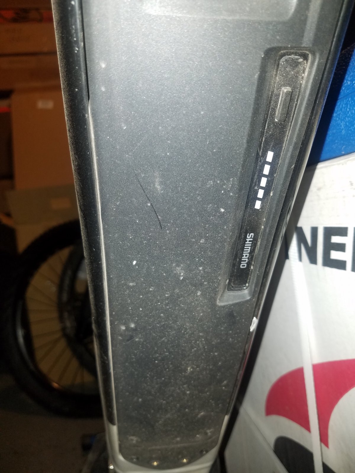

No issues with the new motor after a couple hundred miles. ? I did get a new battery cover. It is for a Scott Spark 2018 (#267293) Ordered from the EU BIKE24. Much better cover. Keeps out the dust and got rid of the rattle. ? Bike is even better and now I have two batteries. Anyway finally took some pics. Enjoy .;)
That's great info, thanks for sharing! I might eventually switch my battery cover out too... It's pretty bad. I have the stock one taped in place right now on the top with clear gorilla tape!

That reminds me. The Scott cover only covers the battery NOT the keyhole. Right now I have the bottom Felt piece covering the keyhole. Not sure if anyone else has the "rattle" but the bike is quiet now. Probably should take an old tube and cover the cables running behind the battery. A pic of the cover
