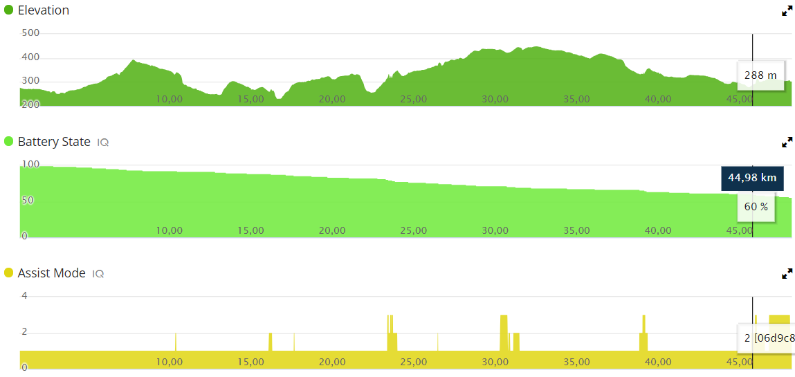

JanCapek
Aug 16, 2018
157
139
Czech Republic
Last week I rode 45 km/720m in woods with my 2018 Levo for 40% battery so range would be around 110km until battery empty. Mostly in 10% ECO with occasional TURBO for short and funny brutal uphills. :)

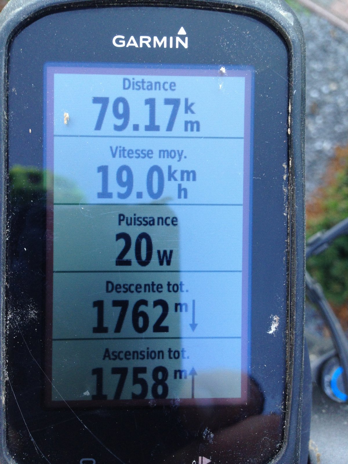

Great. My xperience yesterday: 79,18 km, elevation gain 1758m and 20% battery remaining.
Eco: 30/30, Trail 45/50, Turbo 80/100. Up to 1000 m elevation gain often Eco mode, after Trail and Turbo.
