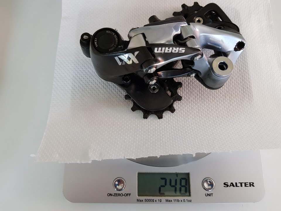

XX1 Mech should see much improved shifting over NX and save 75g to boot.

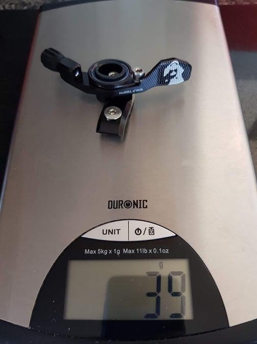

Probably gaining a few grams with this over the Fox lever, but it looks a lot more sturdy (& grippy - although i've not struggled with the Fox, just want MM compatibility). The pics online make it look big, this thing is dinky!

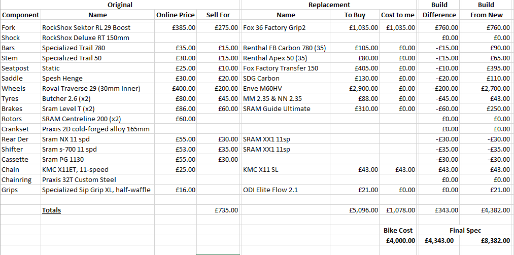

Being the geek that i am, i made a spreadsheet of the mods/changes. It might help someone else with the idea of getting the base model and upgrading. It would be much easier if frame/motor/battery option was available.
