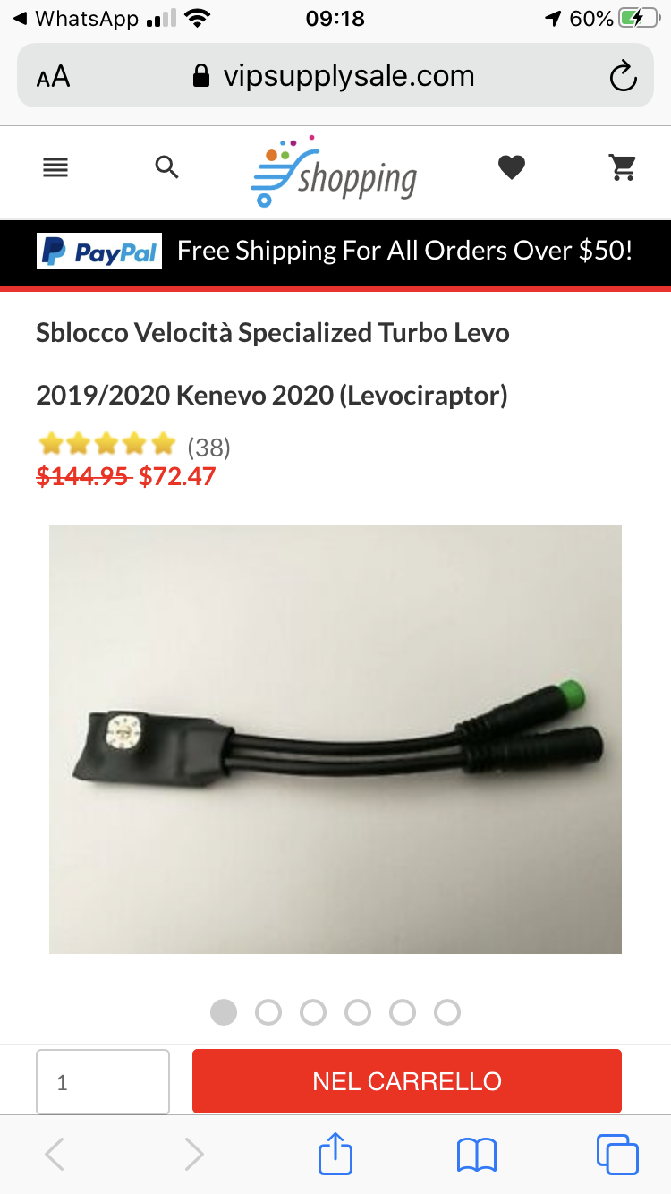

79B24615-84BD-4B59-95B8-F2141B532B19.png Do not purchase from any other websites like the attached image. You can only buy the product directly through the official website at:
