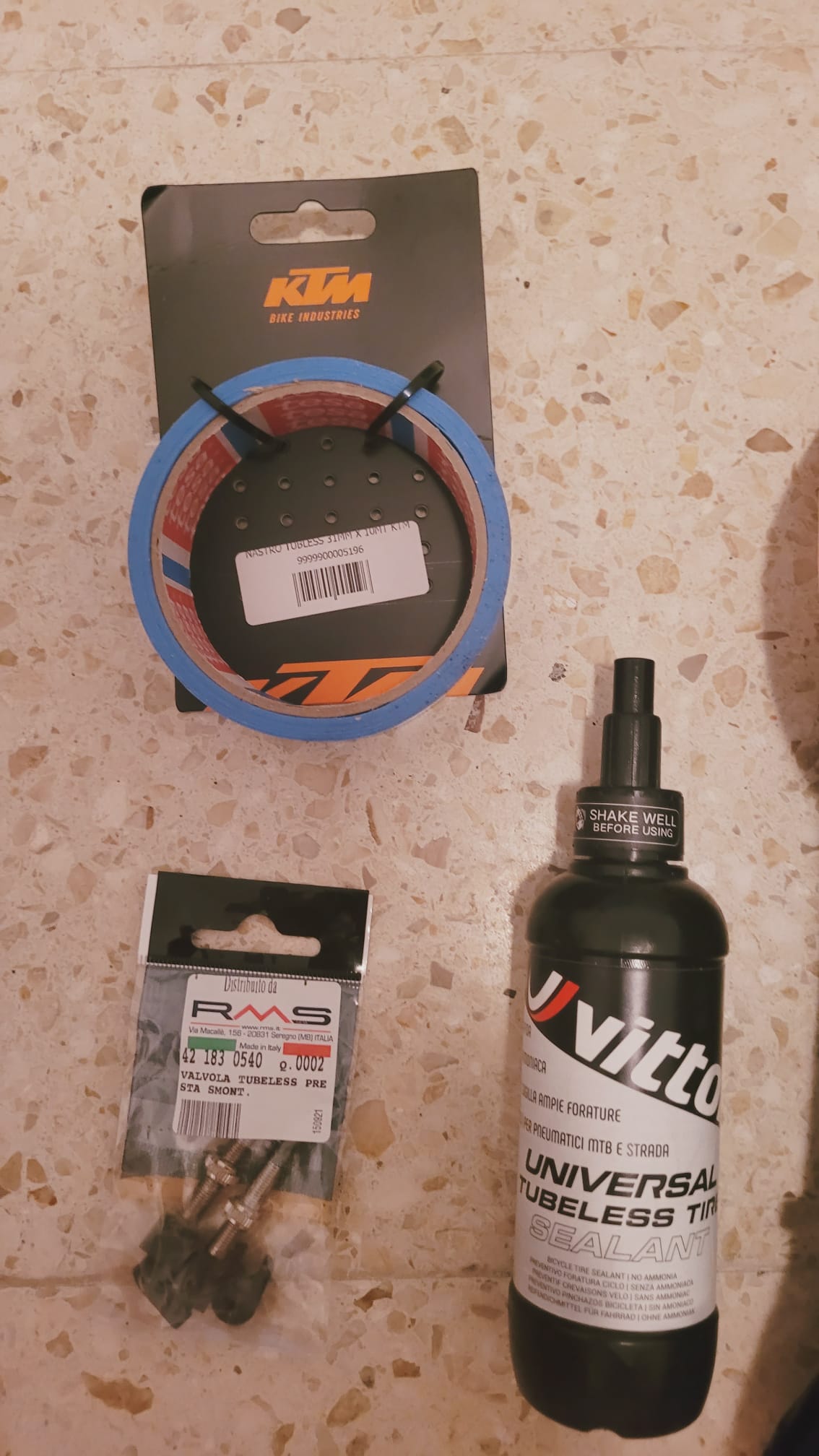

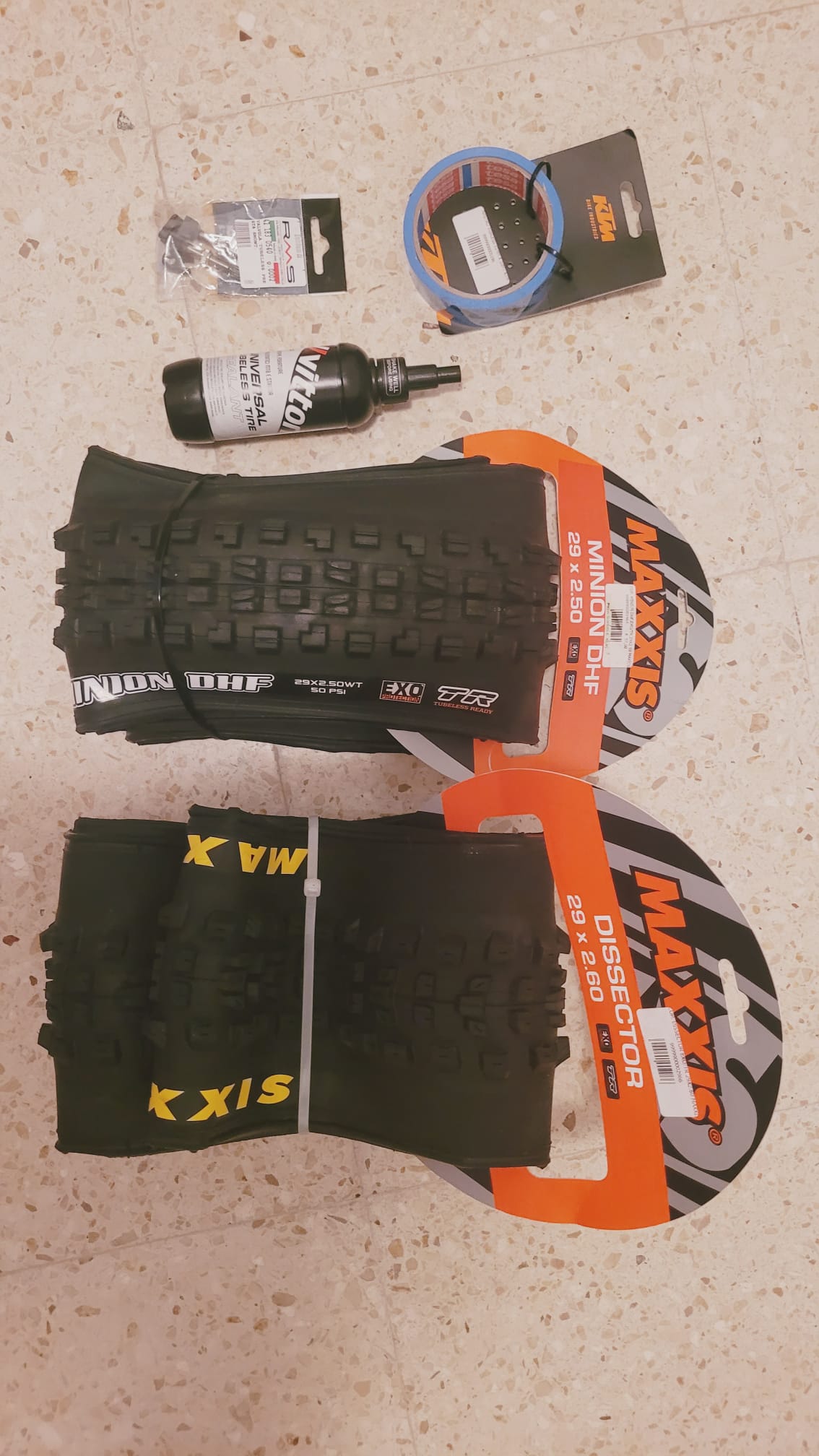

Hello everyone,
I have been on a business trip and since the availability of MTB tires here is very limited (and the prices very high), I took the opportunity to buy a pair of new tubeless tires for my Trek Powerfly. In fact, I booked a night in transit at a B&B to find that the B&B had a beautiful bike store downstairs where they gave me an absurdly low price on everything. (I'd rather not say the name, for obvious reasons, but I gave them 10/10 on Booking, also because of the absolutely total courtesy and quality of service...)
In the end I bought 1 Maxxis Minion DHF and one Dissector (it should fit), two valves, the tape and the fluid, I hope they are decent quality (I don't go downhill but just MTB and commuting). And around 29 x 2.4 there wasn't much.
Now I ask you: do you suggest to try to do the conversion to tubeless myself? I have good manual dexterity, I am used to doing even quite complex works, but I have just a few tools at home. because I am renting. And I never did it.
Also, the seller told me that to mount them it is better to have a compressor (which I have), but I was wondering: if one punctures while somewhere far from home, even if it happens infrequently compared to tyres with tubes, is it possible to re-inflate a tubeless just with a small pump? I would hate to find myself in the middle of the woods, alone, 20 km from home, with a flat tire and the inability to inflate it....
cheers

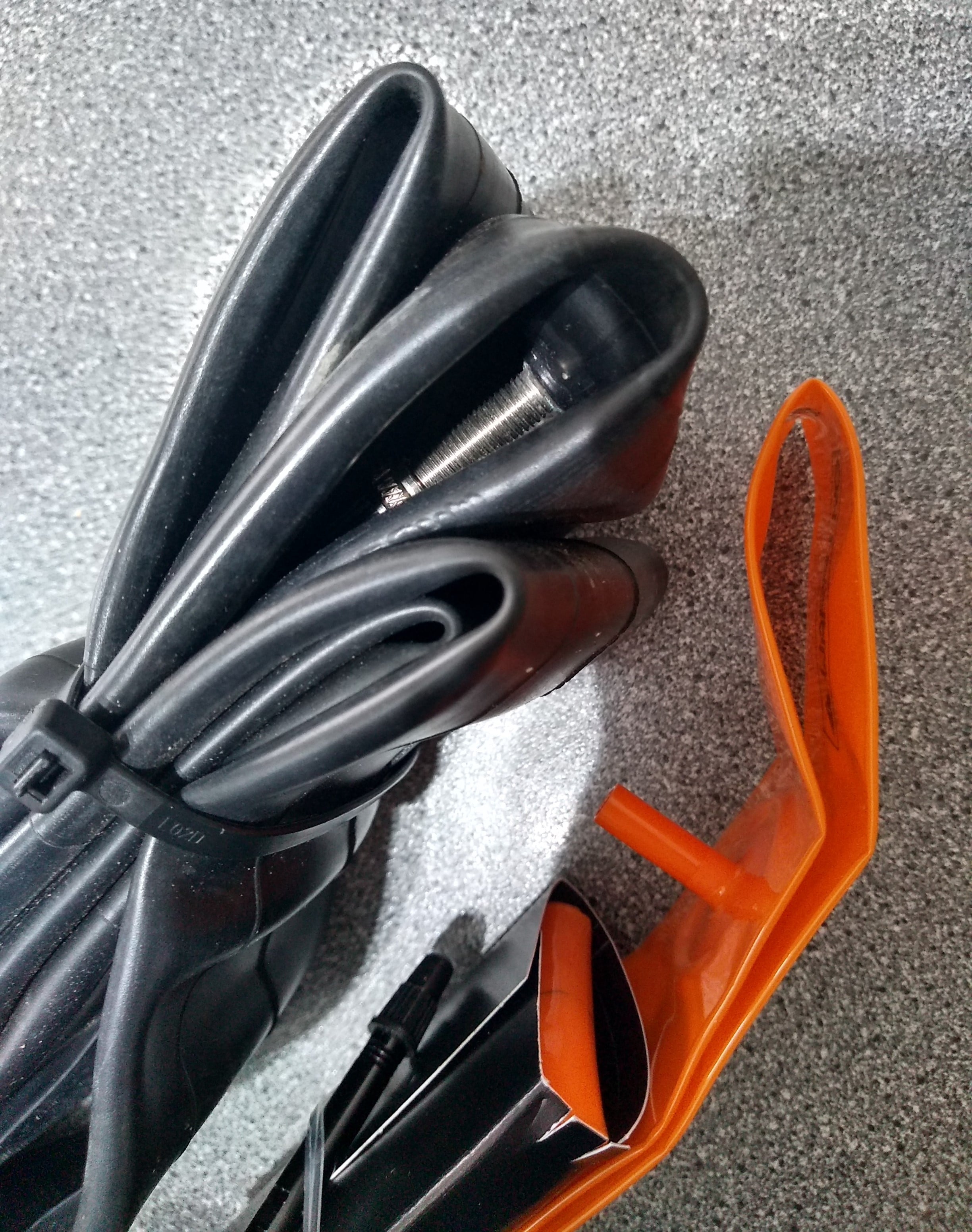

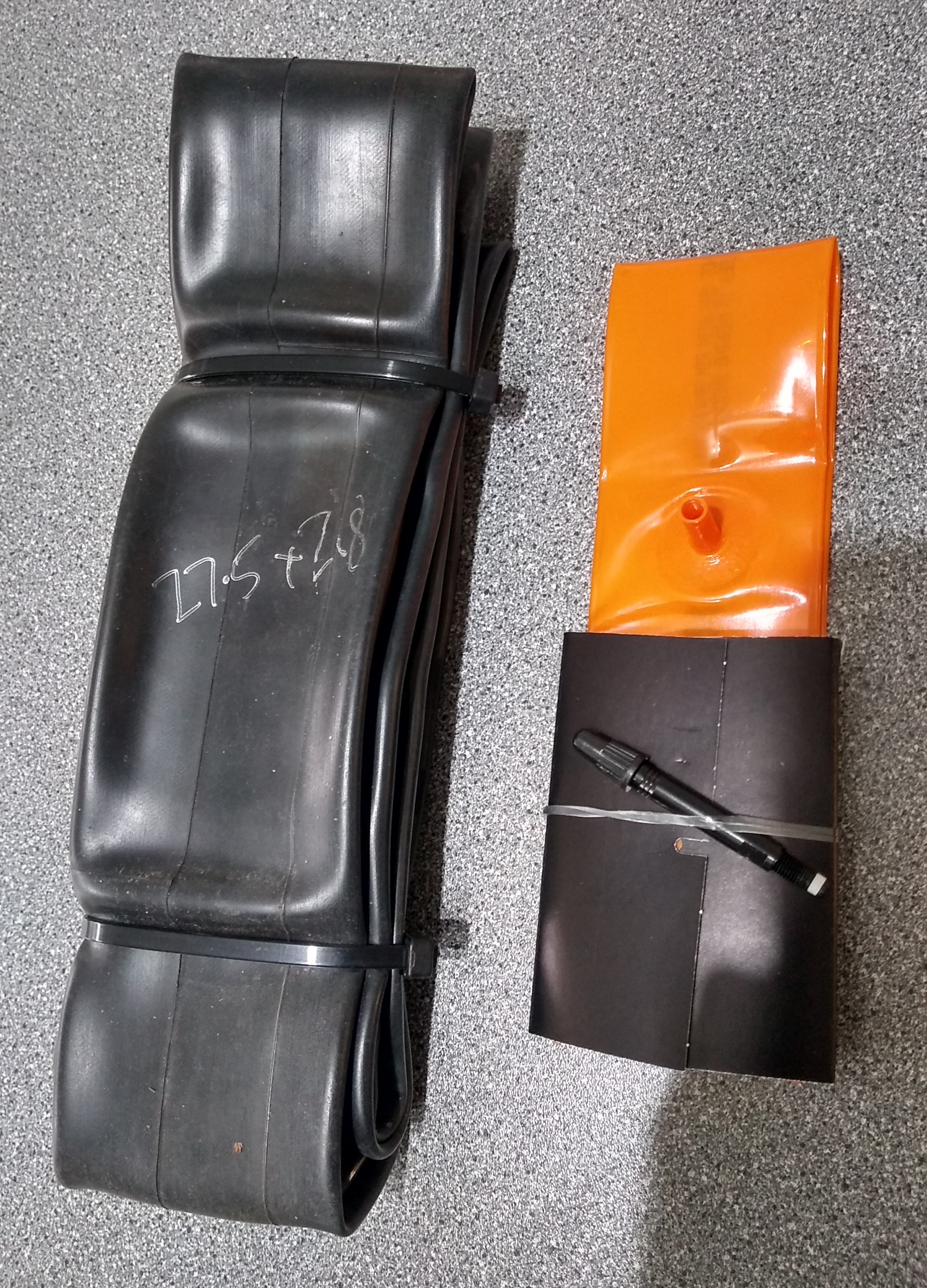

I'm a bit belt & braces when it comes to flats. Despite my excellent record, I carry the following:
Tyre levers
Pump
Two superlight Tubolito tubes (see pics), in case I absolutely need a tube.
Some self-adhesive tube patches, in case I subsequently puncture the Tubolito.
Some bacon strips (bits of rubber to push into a hole and make it small enough for the sealant to work.
Some self-adesive tyre patches in case the bacon strips don't work.
I bought the Tubolito superlight/superstrong tubes when I got my second emtb. It was a mullet and I needed two spare inner tubes. They were huge and heavy. See below for the comparison. each Tubolito weighs about 30g, about one tenth of the tube weight and as you can see, considerably smaller! :)
In case you think that this lot is too much, think of it as your talisman. A talsiman that will prevent all future tyre problems occurring on the trail. I KNOW that as soon as I ditch any part of that lot, I WILL need it. And it will be raining and cold, and I'll be far from home! :eek: I bought the Tubolitos almost 3 years ago and I've never had to use them. :love:

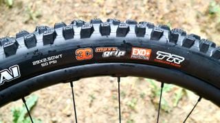

No it doesnt. There are 3 variants that describe the way a tyre is constructed and protected from punctures/damage. Not all tyre brands give that information but for Maxxis tyres those are:
The problem is how to identify which one is used for the tires I purchased. I looked at Bike Technology but I couldn't find a clear mark on my tires that would tell me which one of the three.
Maybe I missed something... I don't know.
The compound , protection tyre diameter and width details are printed on the sidewall of the tyre. You need to refer to your tyre on the Maxxis website to see other details like TPI
It looks like your tire has no compound material (3C, Maxterra, etc.) listed, so I expect it's the DC (Dual Compound) version. The sidewall protection is EXO (EXO+ and DD are more protective). TR, of course, means tubeless ready.
This tire shows all of the info on a non-DC compound tire:
interesting... So, you say by default the compound is DC.
Thanks, mystery solved! But why it is so difficult for Maxxis to explain this clearly?
