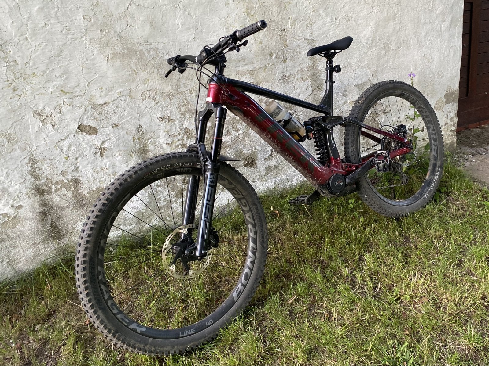

PetrD
Jul 27, 2020
70
21
CZ
2.6 are nice but with 40mm rims - bontrager line pro 40 carbon :) Whole wheel looks like better and do better. (I did it because my weight)
