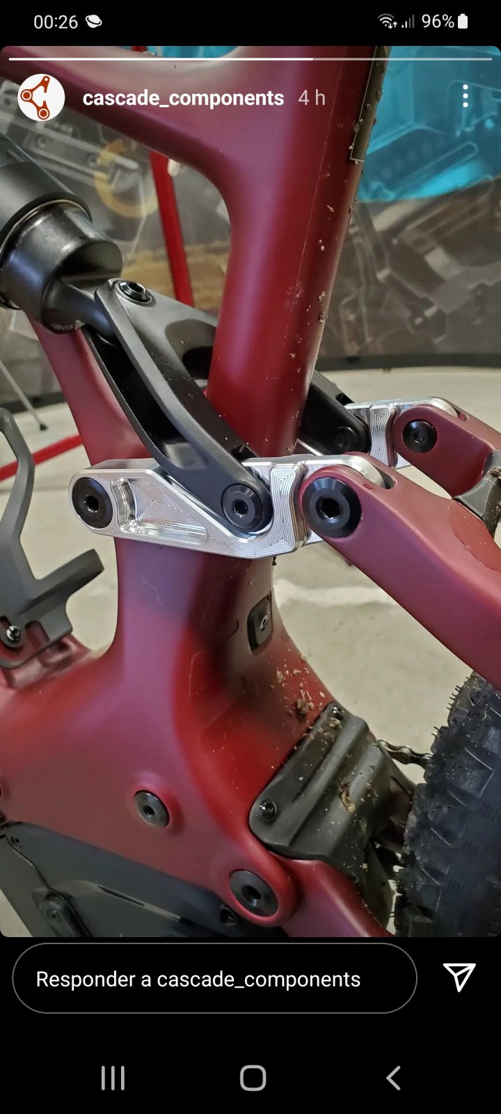

They are currently working on it! :D
Now that is a great x-mass gift :)
Together with a 170MM air cartridge for the forks, and enduro it is! I had the Stumpy Evo of 2019(RAW), and did the same type of modification. Made the bike pretty epic tbh :cool: From 150 Rear to 150, and front from 150 to 170 🤘

Hopefully the new cascade link wont make the suspension much progressive.
But that's exactly what their links do. I have one on my 2021 Stumpjumper Evo and it's fantastic, especially with an X2. Can't wait to get one for my Levo.
I actually talked to them at Sea Otter this year and they told me the only reason they hadn't made one was because they couldn't get a Levo to build a prototype on. They offered me a free prototype and production link if they could use my bike. I almost loaned them mine until I looked up return shipping.
