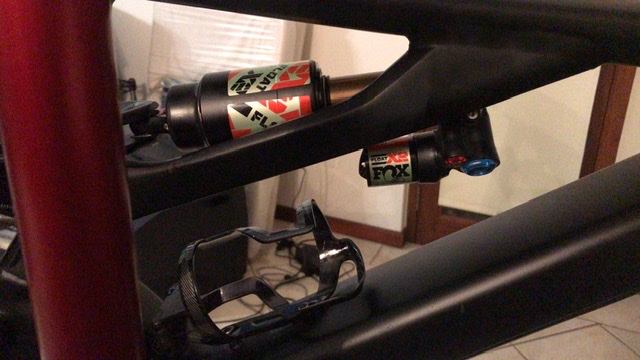

If you want a like new Fox X2 I can help you. Seems like air would be more adjustable for your weight - and it is Gwins shock so proper hardcore kit.
What shock length is the Kenevo eye to eye. Mines 222mm. Only 1 ride since a full service and rebuild At Sprung Suspension with new Kashima body and the aircan end casting.It’s only done trail riding.

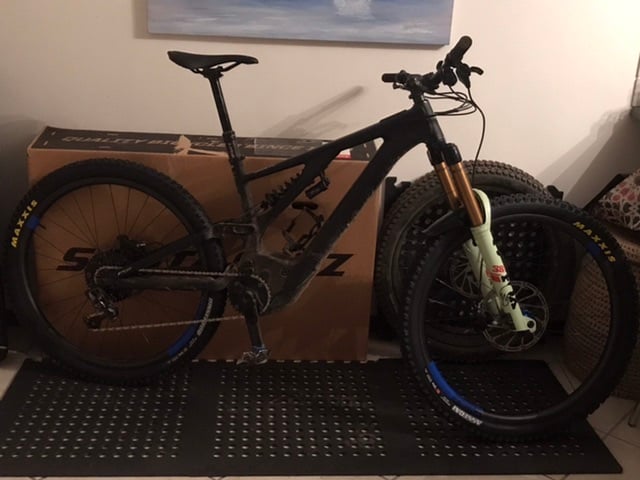

Hey Krisj, sorry to hear of your mishap .
I’m 5’12” and 90kgs without kit , when I purchased my S3 the first thing I noticed was case and pedal strikes . I’m amazed you are running such a low pressure in the rear , I usually run 28psi and an insert .
i yanked the Rockshit Boxxer off and put on a Fox38 and what a difference it made , then put on a 2021 Fox Float X2 on the rear, I’m still playing with settings , but it has transformed the bike . I also built some 29er wheels for the bike and have yet to case strike , the bike is now amazing and I drop DH lines all day long with my mates
The kinematics on the Kenevo is way to linear for a coil shock and you will blow through travel all the time , air makes a big difference and is way more progressive.
Another issue is the Boxxer comes with an RC damper cartridge and many on the Kenevos where faulty , Specialized know of this issue and usually replace it with an RC2 damper cartridge which pretty much turns the fork into a Boxxer Ultimate .
If your LBS doesn’t want to look at the bike call Specialized and let them instruct a store to help you . There is no reason why any store wouldn’t service you , what if you’ve just moved into the area ? After all Specialized has a worldwide warranty program .
Keep us posted on your actions mate

Sorry mate , to small , Kenevo uses a 230mm x 62.5mm , but a 230mm x 65mm works fine .
the 2020 X2 fits perfect , the 2021 X2 needs a minute frame mod with a 2mm field surface to clear the fatter air can .

230mm eye to eye and 62.5mm stroke dude so it's not going fit unfortunately. :(

Everything mate . Quite a bit stiffer to start , so wheel placement in rough stuff is much better . Small bump compliance is unbelievable on this fork , and the ramp to full travel is very smooth . The big advantage is obviously much tighter cornering on a bike that is already long as you don’t have the frame bumpers of a triple clamp fork banging into the frame . I tune suspension with Motion Instruments equipment and these forks can really be dialed in .

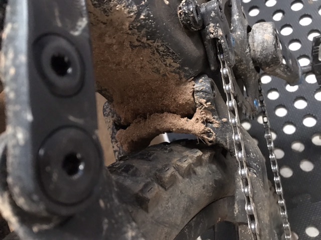

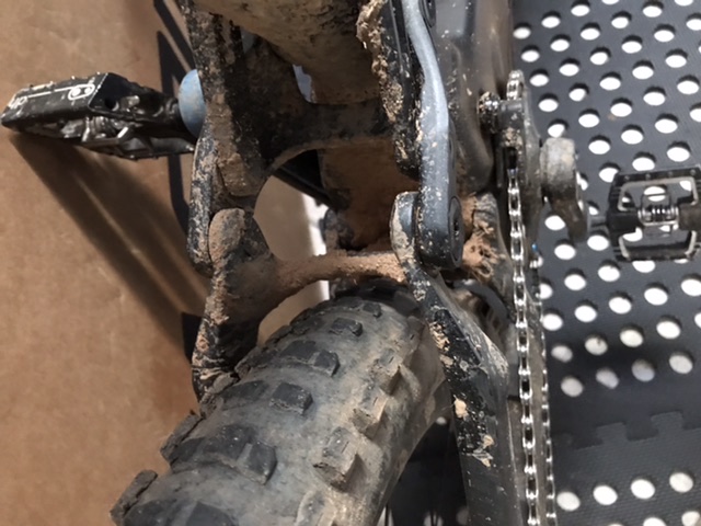

Isn’t the BB rather high with 29” wheels? How is the rear wheel / frame clearance? Really appreciate BB measurement (static) and a pic of rear shell clearance near bb please.
thx
Will do it tomorrow mate .
The BB needs a little more ground clearance as it is rather low to start then with the coil shock out back and a linear kinematic on the rear end , it blows through travel real easy , this is why they strike so much , with the 29” wheels it’s more like the Levo and is amazingly stable at high speed on a jump line . With the X2 out back , the rear runs more progressive so runs higher in the travel through the full 180mm of travel , I don’t BB strike anymore and I’m running the flip chip on high setting . This bike is way more stable on hard descents then my Santa Cruz Megatower for me .

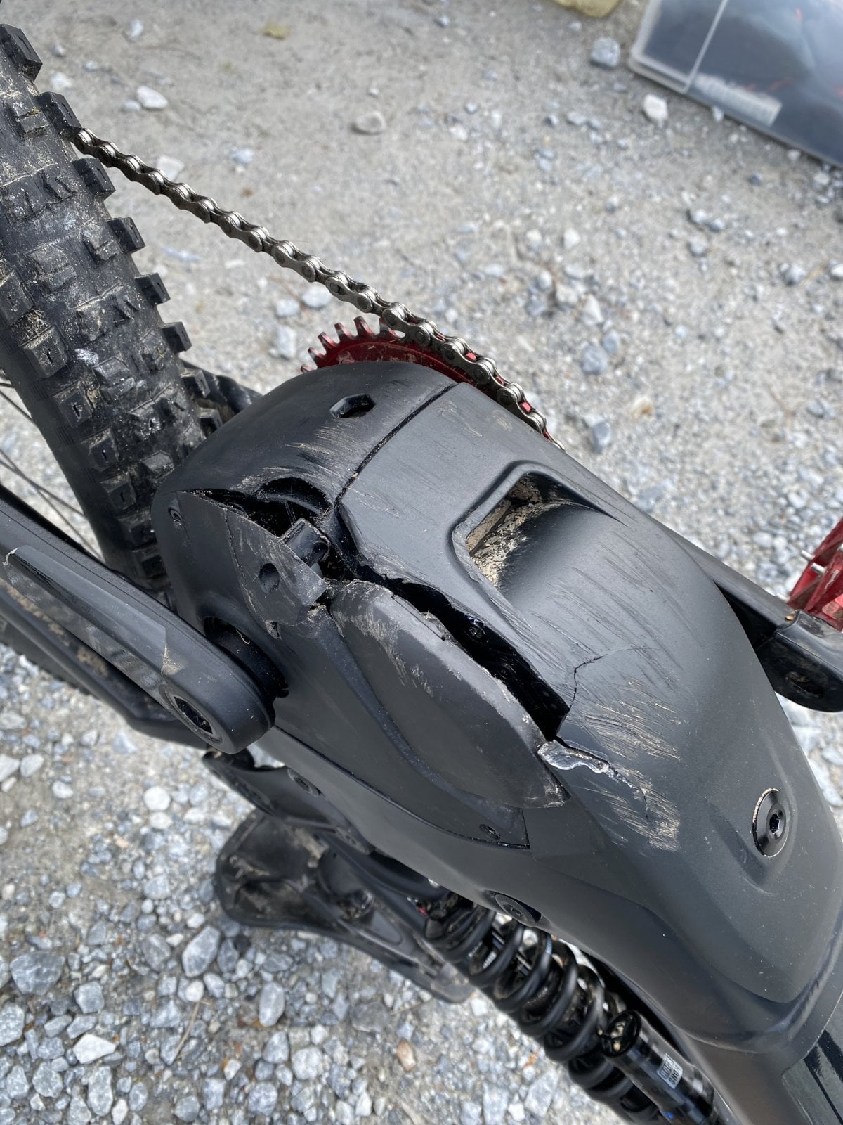

Aww.... naw.. Shit luck Kris
Fort Bill is relentless. I must've done 1000 runs there over the years and even with DH bikes I'd rarely come back without a mechanical or destroyed parts. (lots of wheels, a ton of tyres,a few cranks, chainrings, chainguides,shocks/forks and a ton of rear mechs). I wouldn't ride an Eeb there at all. But I still have the luxury of owning a couple of (older) DH bikes.
Hope you get the motor sorted.
if it's any consolation your pic where the bike's bottomed out is the last triple into the arena isn't it? DH bikes,set up properly also bottom out pretty harshly if you don't make the downslope clean there.
Regarding tyre pressures. I've also never run less than 30psi with 2.5 dual ply DH casing tyres at the Fort (a fair bit lighter than you)
If you can't get a suitable spring, One bonus of swapping out to an air shock is you'll gain a ton of progression. I'd go that route if I were you.
plenty WC DH bikes run air shocks
thx
nB2000 , here it is mate , BB height to center of axle 352mm With 2.5 DH casing Maxxis tires on a 30mm rim , my Santa Cruz V10 29 is 356mm .
Excuse the dirt in the pics , I rode from 8.45 to 5.30 yesterday and didn’t have time to give the bike a clean . The tire clearance is no different to my mates Levo . I’m not sure , but I think the chain stays and seat stays are the same on the Kenevo and Levo , if not , there is very little difference in dimensions.

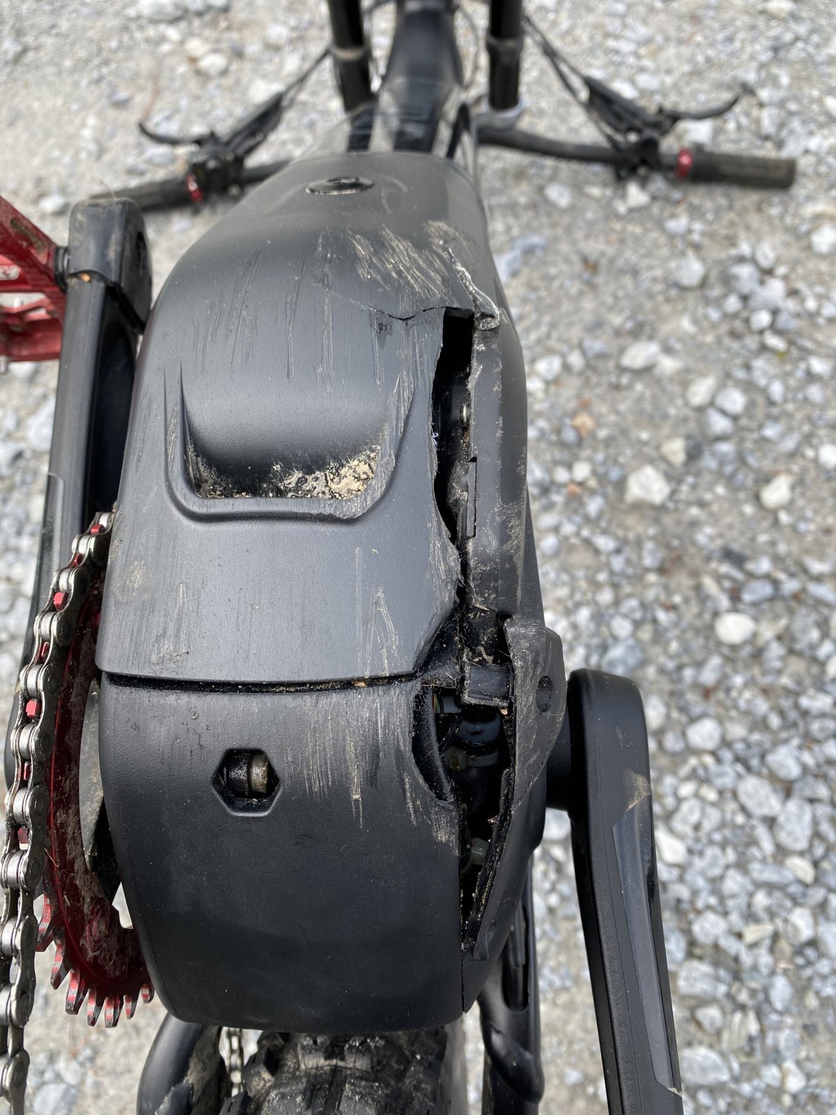

I’ve purchased a S5 kenevo just over a week ago. I’m 6ft 2 inches and 16 1/2 stone kitted up. The RockShox rear shock only comes with a 600 lb spring on as standard
I rode at Fort William over the weekend on the World Cup track and blew through all the travel to point where my motor made contact with the floor and smashed the motor and battery casing. I didn’t send the large features either as I did not have confidence in the bike at all.
I find this very disappointing for a 7k bike that it supposed to be a dh orientated bike. It’s taken me months of saving to get this bike because I believed it to be the bike best suited to my riding.
I had a Levo before the kenevo with a coil shock fitted and I’ve never had any issues with the bike blowing through travel.
RockShox only go up to a 650lb spring too and I believe I would benefit from a 700lb spring for my weight but RockShox don’t even have it as an option. Surely Specialized have tested the S5 this with larger rider weights in mind.
The problem I’ve got now is I bought the bike from the internet and the shop is located at the other side of the country and my local Specialized dealer won’t have a look for me.
Ive spent over 12k with Specialized now find it very disappointing that you can’t take your bike to any Specialized dealers to get things checked out , another concern with this is when my motor fails which seems to be on the cards am I going to have to send the bike back down south to have this fixed too.
Ive always loved Specialized bikes and trusted the build quality and after care but I’m losing faith now. The bike I’ve saved my Hard earned cash for and dreamed of owning is slowly becoming a nightmare. Has anyone else who’s a larger rider had any similar problems. @Specialized Rider Care can you help and advise me please as I’m stuck on which way to turn. I’ve attached photos of the 4ft high drops that did the damage and the one with the suspension bottoming out is a screen shot of the drop off
just an update on my situation, spoken to tftuned and I’ve been advised that for my rider weight I would be better suited to an air shock to the price tag of £620 that’s great after spending 7k just over a week ago ?also the air shocks aren’t available till the end of December

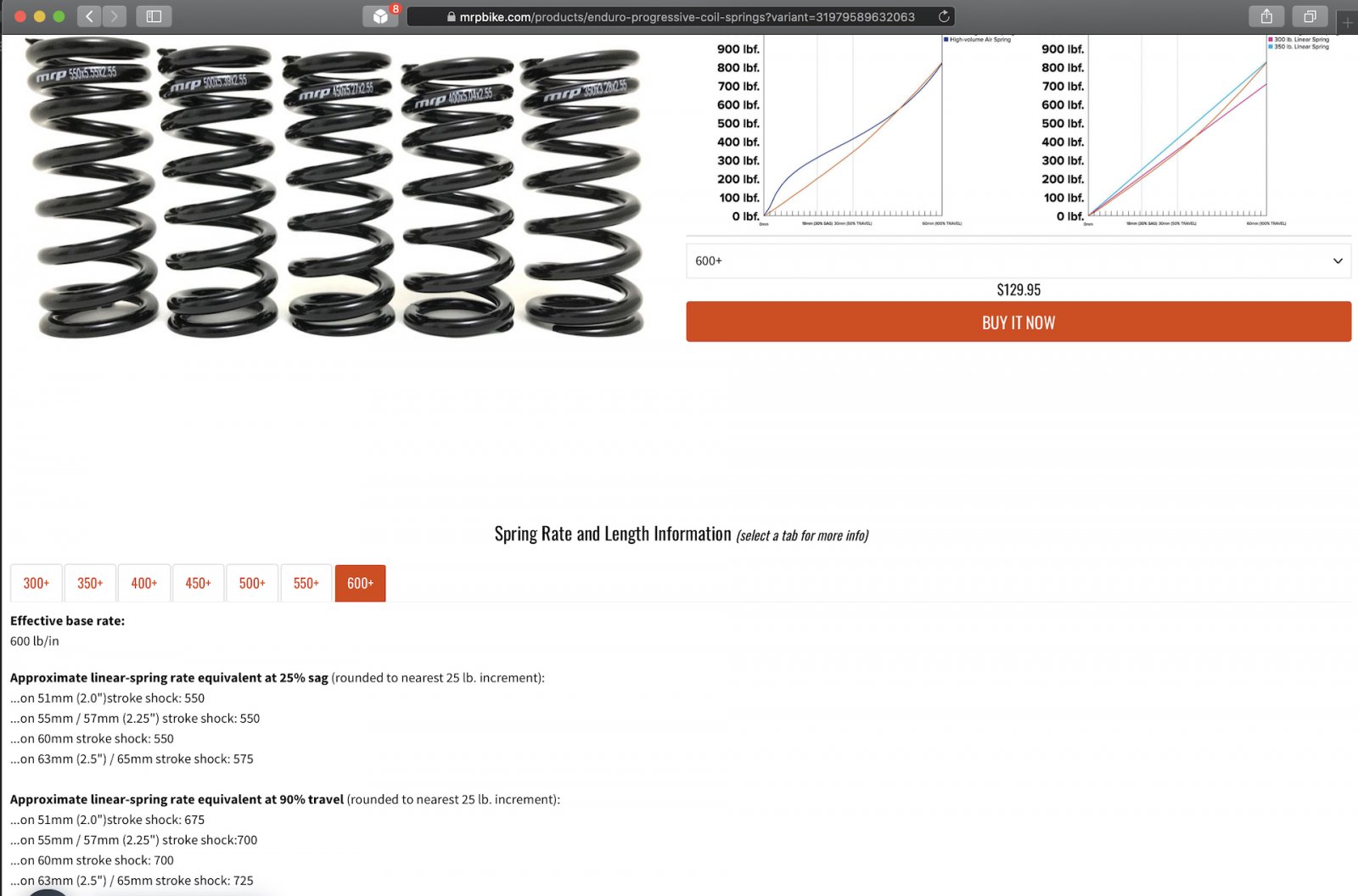

The rear suspension on the Kenevo is pretty linear. It can, and will, as you've found out blow through the travel pretty easily. I have damaged my battery cover cover in the same way on my S5 although not in such spectacular style. I've made a metal skid plate which I've then attached with glass fibre the original cover. It's not pretty but it works.
The material choice for the battery rock guard and motor covers is poor as it's too brittle. Ideally it would be thicker and more durable and there'd be a proper skid metal plate like Orange do on their ebikes.
I had an Amygos bashguard on my old Kenevo due to damaging the motor cover on that and it was ugly but worked. Never had an issue smacking that into anything after it was fitted.
Amygos Bashguard
A progressive spring would definitely help however the Cane Creek Progressive Valt spring will not fit the Rock Shox shock as the internal diameter of the spring is too small. MRP do a progressive spring but the stiffest is 600 rising by 20% at the end of the stroke. Even this may not be stiff enough for you.
MRP progressive spring
A shock rebuild with more high speed compression damping would help too. The EXT Storia has a hydraulic bottom out bumper if you want the best shock out there at the moment.
Hopefully Cascade Components will bring out a more progressive linkage for the Kenevo like they have for the Levo.
Cascade Components
If you ride these bikes as full on DH bikes there are some changes that have to be made and it’s annoying that you have to spend more money on top of the cost of the bike.
I would speak to Berkshire Cycles or RaceCo. I’m sure they’d help out with the warranty issue.

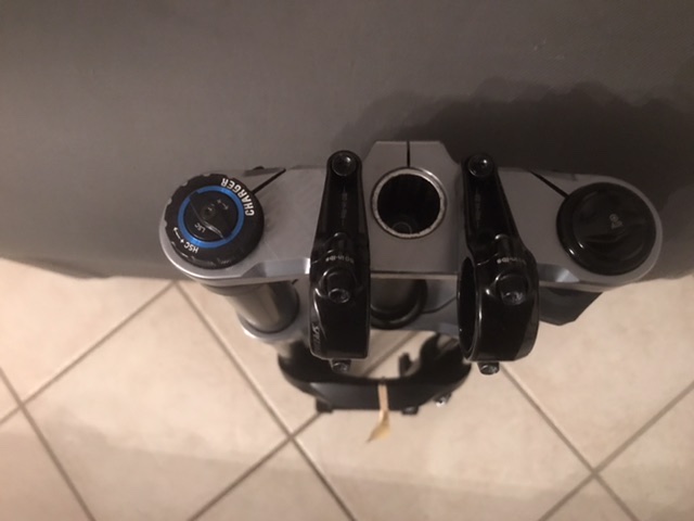

Cheer for the informative post dude what’s the symptoms of the faulty damper ?
RocratRacing
Aug 25, 2020
16
23
Friendcamwinch7@
You get a sucky sound on compression and rebound and the compression dial doesn’t do much to change the damping . My bike did this from new and Spesh sent it to RockShox for warranty, they sent it back as an Ultimate with RC 2 damper.

I'm trying to get my suspension sorted too, I'm 108-110kg with gear and ride pretty aggressively. I was running 180psi, two volume spacers 25% sag. I found this quite harsh on the small choppy stuff but I'd still blow through the stroke and bottom it hard on the big hits. I tested 4 spacers and 25% sag over the weekend, it was plusher but still blowing through on the big hits. I've just fitted 6 spacers and will try that out and give you an update.
I'm only two weeks in on the bike and have already bent a crank arm from a 5 foot huck to flat, surprisingly the casing didn't hit the ground like yours or the ground was too soft to do any noticeable damage. I did damage the bottom like you in the separate incident over the weekend doing a run on last years national DH track, I launched some roots and landed on the knuckle of the next set so I'm not surprised by the outcome of that one. I've ordered two different types of guards to try, the Airpro fork which is CNC machined and a carbon one by RockGaurd.
For the rear I'm hoping my LBS will be able to sort out a progressive spring to suit my weight. If there is something worth looking at I'll let you know.
I’ve given up on looking for a suitable spring and ordered a fox float X2. I like the fact it has low and high speed adjustments to deal with the small choppy stuff and bigger hits

The front fork had 160psi in with 2 tokens
The rear tyre started at the top of the run with 26psi in my have got burped on the way down the World Cup track is seriously brutal to say the least.
The kenevo S5 surely should not be limited to sub 15 stone riders or if this is the case there should be a weight limit warning
Dude, i weigh 75kg and i run 155psi front fork and 26psi rear tyre on an S3.
No wonder you broke it.
Also did you keep the 600lb spring and then do a 4 foot drop?
Your fork is totally bottomed and with that PSI im sure it smashed it in to the crown. The rear tyre is pancaked. The rear coil is 100% compressed and all the force is now going in to places that can cause permanent damage to the frame and suspension..
I dont think you can make the motor hit the floor even with 100% compression of the suspension so this means you probably seriously bent something which is not supposed to bend.
