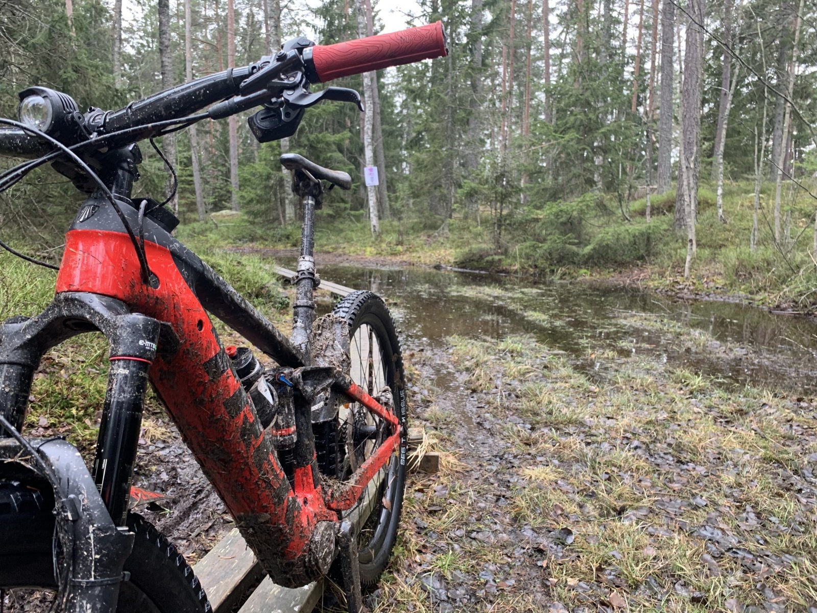

I got the Lupine light for mine, (integrates with the bike battery). Happy with it, (1100-1200ish lumens)
I'm planning Lupine SL X (1800-2100 lumens) for Trek Rail 5 2020 Bosch CX GEN4. I need some lights for short trips on road between trails and something like SL X + helmetlight.
Any tips or thoughts on Lupine products now that you have some experiences?

Love my lupine SL X + C14 setup, great light coverage, and it automatically turns on and changes brightness based on darkness (cover the sensors on the back with your hand to test when it is light out ;) )
One note: a LBS will have to activate the lights in Kiox / Purion; one can connect it yourself (need to get the cranks off etc though); cable is already in place. Watch the C14 diameter, as it goes instead of the normal ring.
