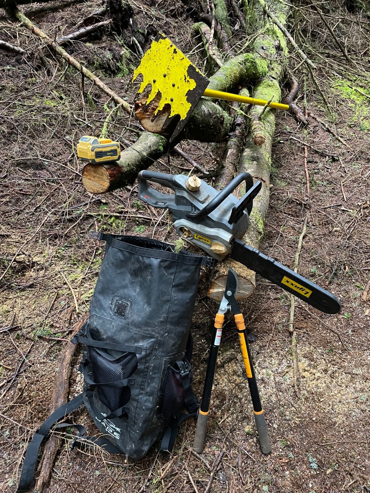

Although my pack is pretty tight it does weigh a bit but doable for getting it to the trails on the bike. I do leave it stashed out in the woods if planning on using it again soonish though and just take the batteries home for charging as necessary.
That’s a big pack!

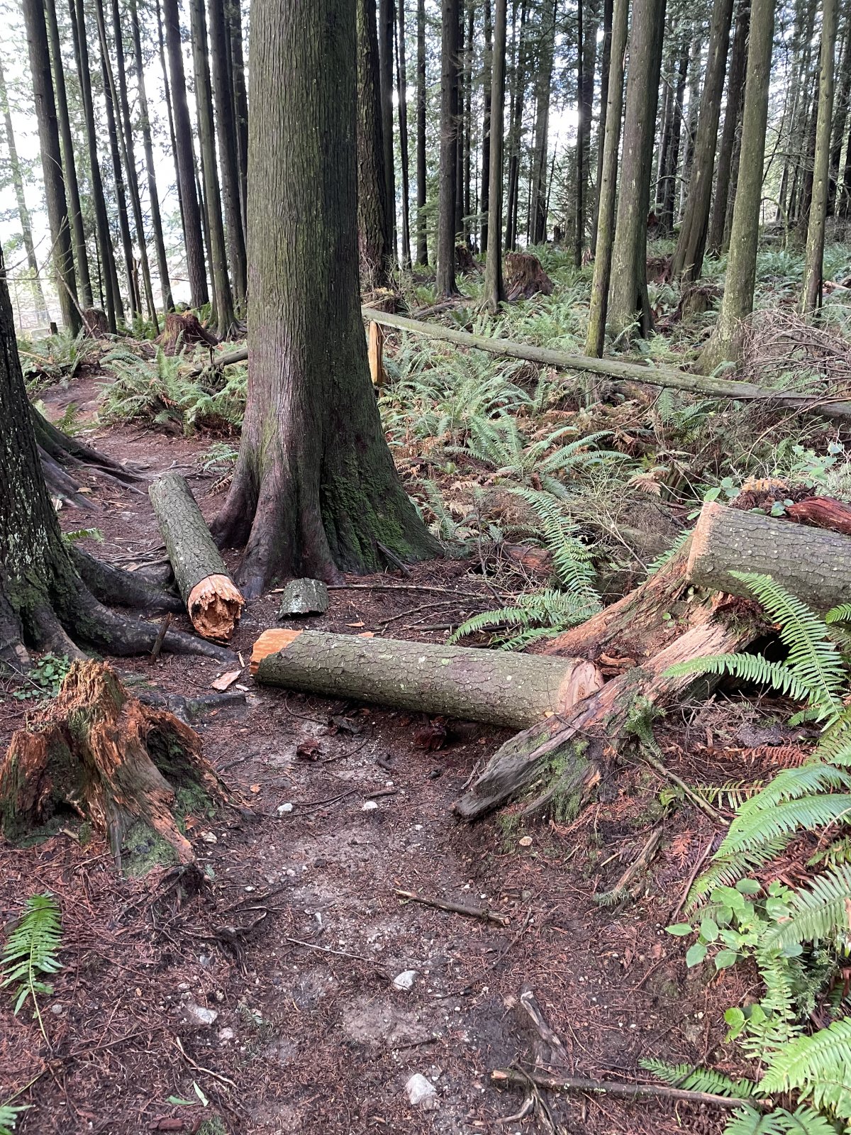

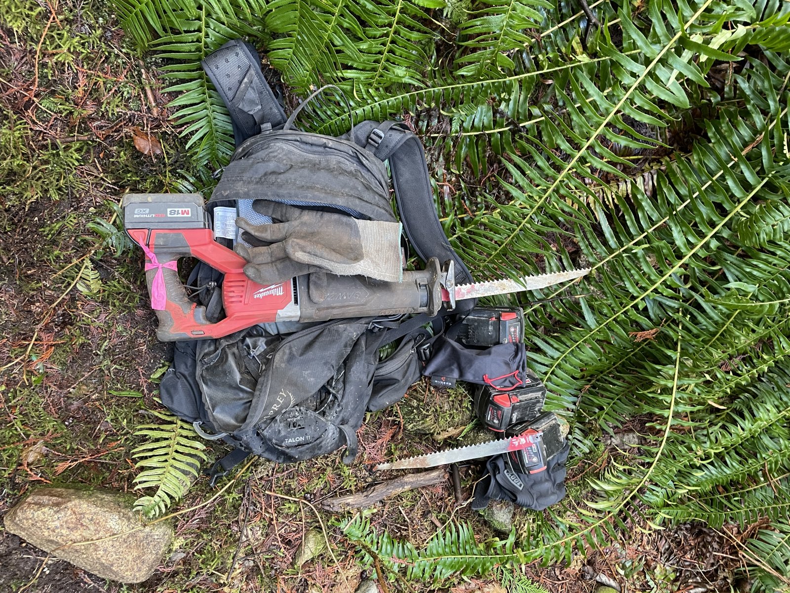

I use a Milwaukee sawzall with a couple of pruning blades and pack 3-4 batteries. There’s always blow-down across the trails after the winter storms and the eMTB makes the trip a little better with the extra weight.
A bear ate my other pack so I got another.
Cut blow-down like this into a bite size piece.
I usually stash other tools around the mountain, take pic, then write down the area…in case I forget where I was working. (It’s a memory thing). Sometimes I find buckets, shovels and other things on old abandoned trails also.

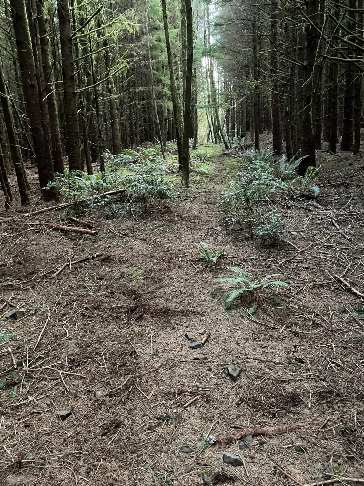

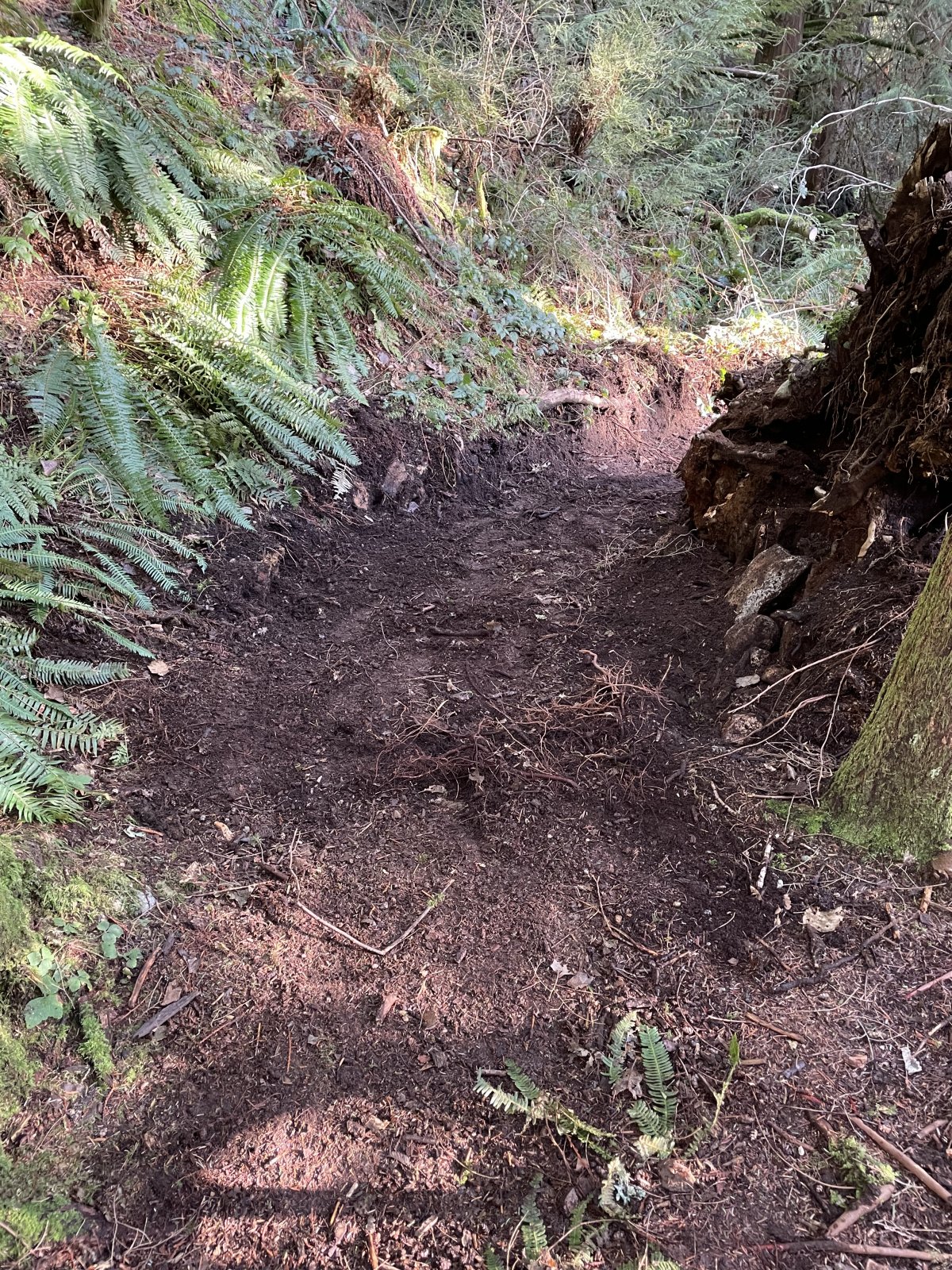

Yesterday I was scouting a connector using my POLR method after parking my bike and heading back towards my tool stash. Came across a couple of choke points that are going to take some effort but the bonus was quite a few sections like this:
that just need a bit of raking and riding in.

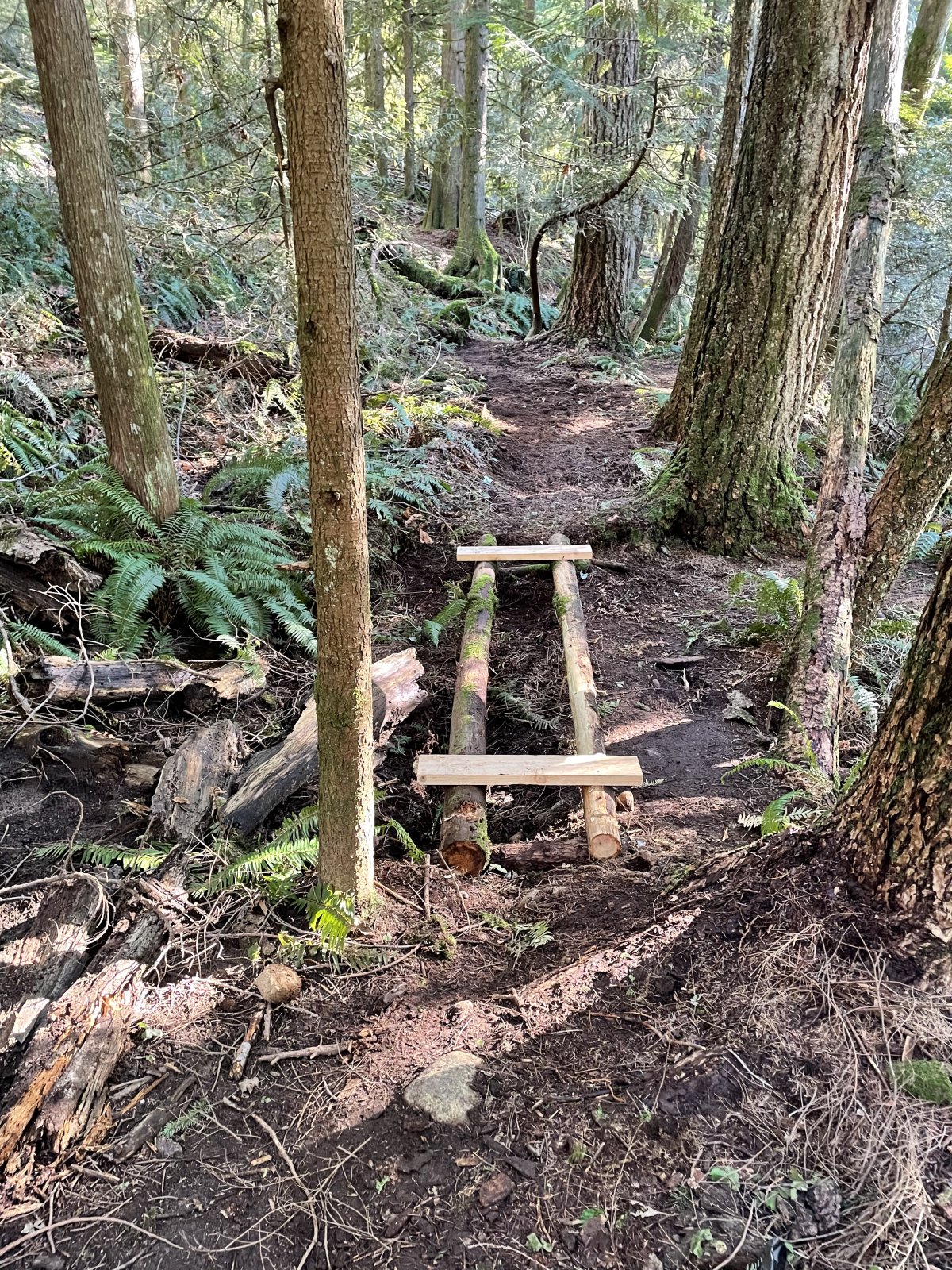

Working an abandoned trail for the past 3 weeks. Trails should be nice after I’m finished in a few more weeks. Packing in decking for 2 new bridges (rough 2x6x 32” cedar).
The nice thing is that I still get a decent ride in too.
I like those short connector trails too but this one is quite long. Will probably only be a 4 min ride(after)from entrance to exit so that’s good.
1 of 2 bridges under construction.

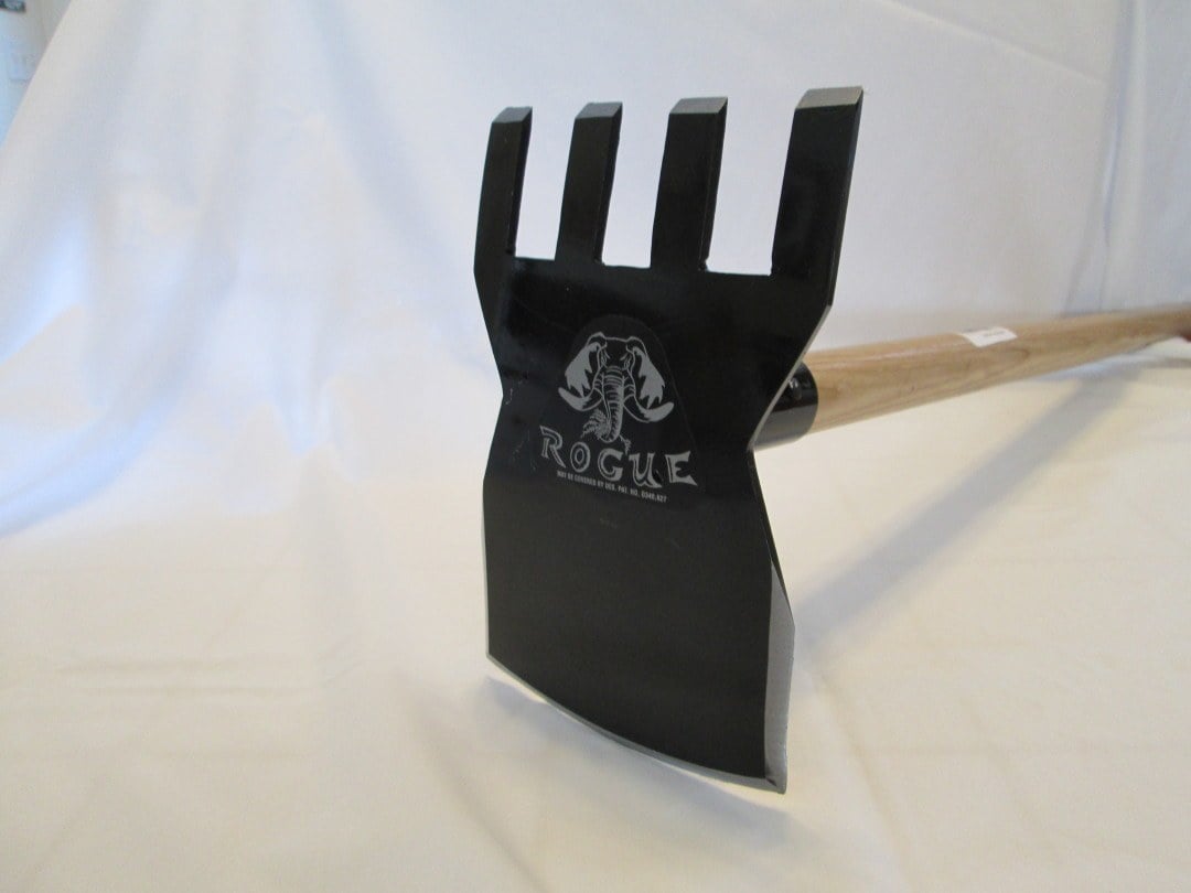

So in past weeks I’ve been looking at the Rogue 55 or the McLeod corona. Either one seems like a decent tool …but the price. @Mabman has a McLeod tool that cost $50 usd I think. (My apologies…I thought a McLeod was a chainsaw, it’s not 🙃, it’s a trail tool).
Id probably cut the handle shorter for easier transporting on my bike. Anyways, my search continues for a decent priced tool ($100-200).

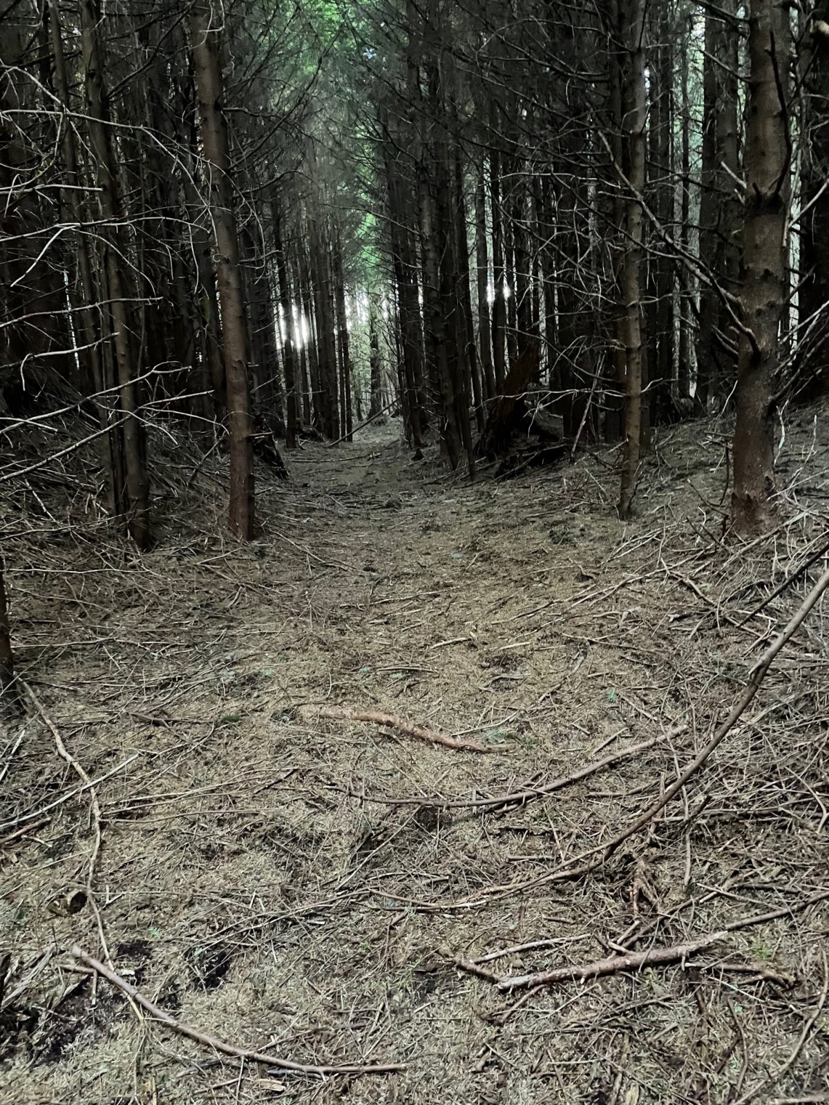

I was just thinking about this thread today as I was out stick flicking the Chanttrail. I almost took a pic of the stick I was using cause it was a particularly nice one that lasted quite awhile.
Chanttrail 2'25:22.jpg
There is an iron rake around there somewhere that my buddy left there last year but now he can't remember where....My McLeod is on another section under construction this trail is pretty well there except for it just need ridden in after I get all the winter sticks off of it. There is a nice DH at the end of this section that is probably about a mile long.

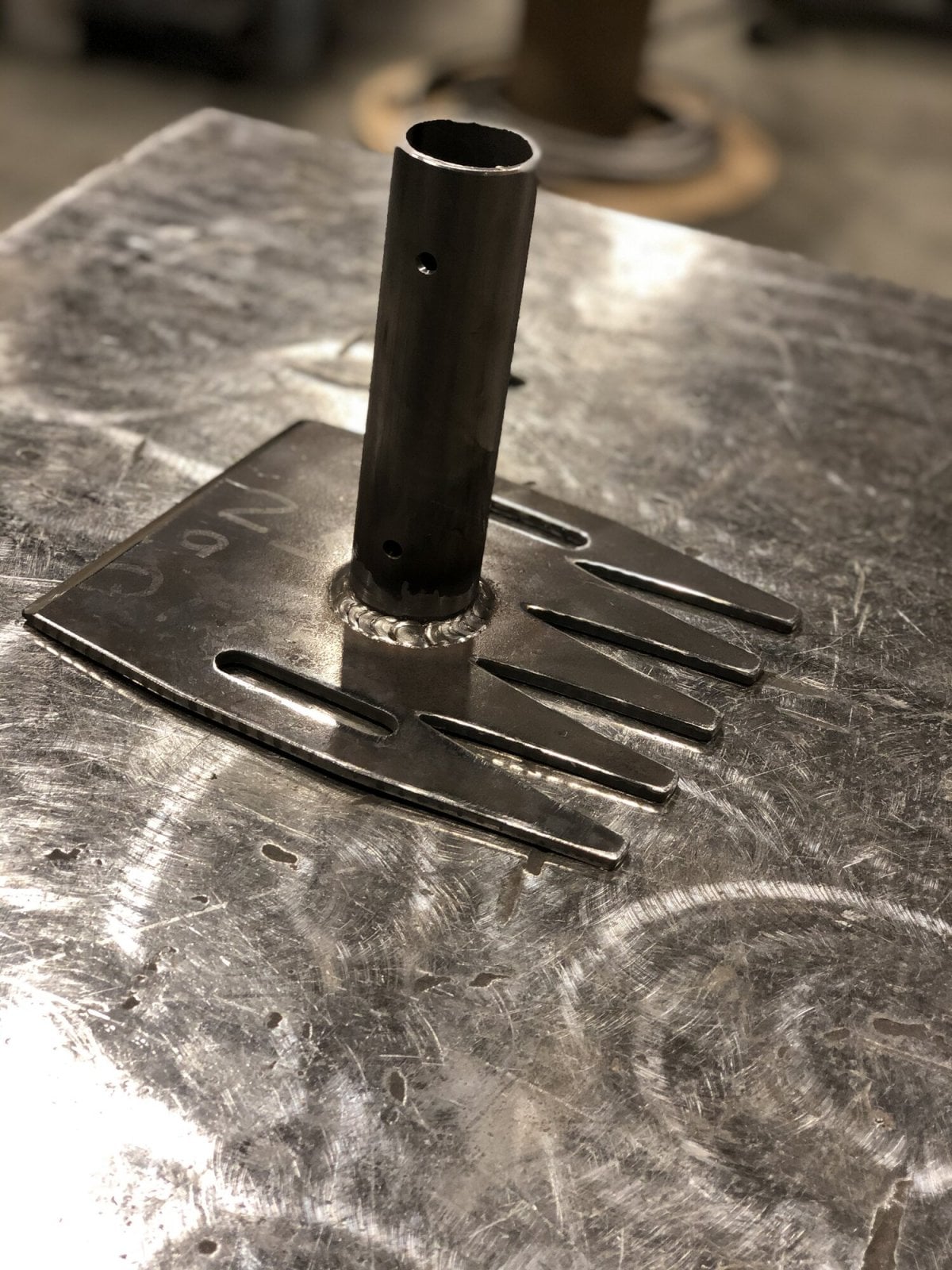

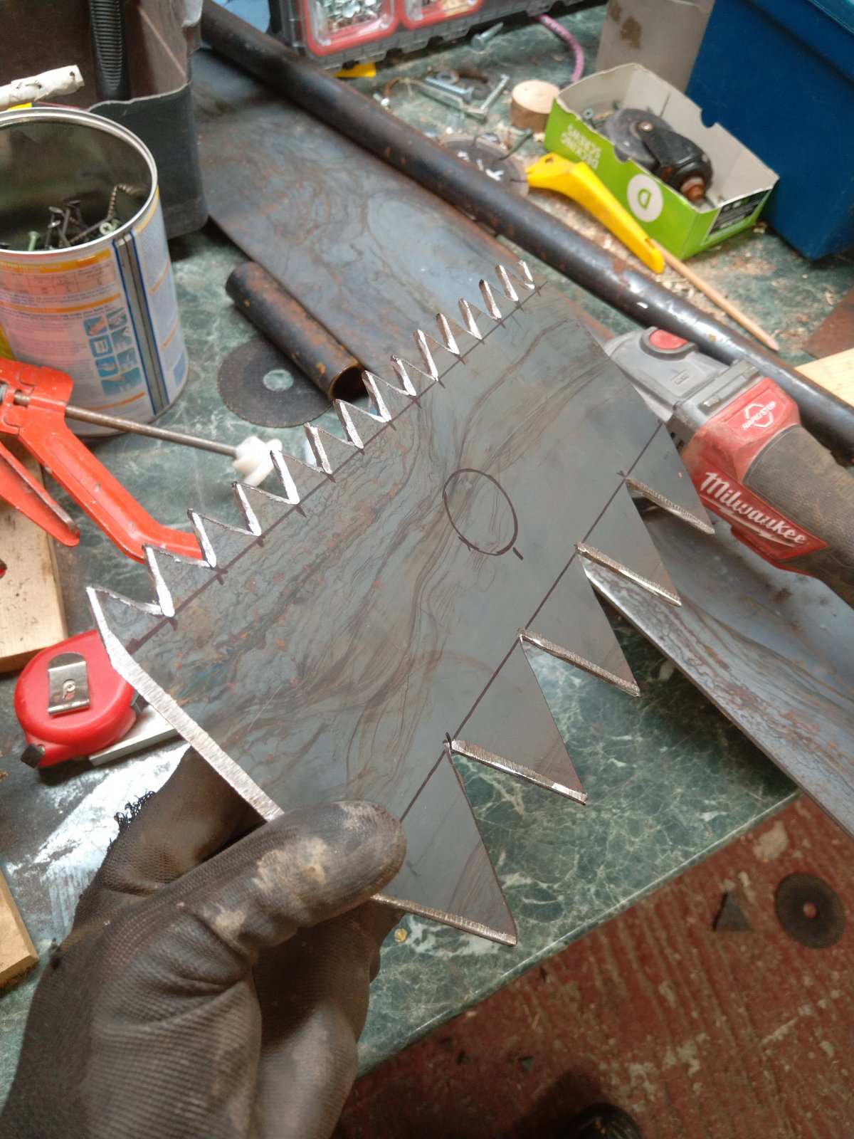

Finally made a start, should get 4 tools out of the 20 quid I spent on materials.

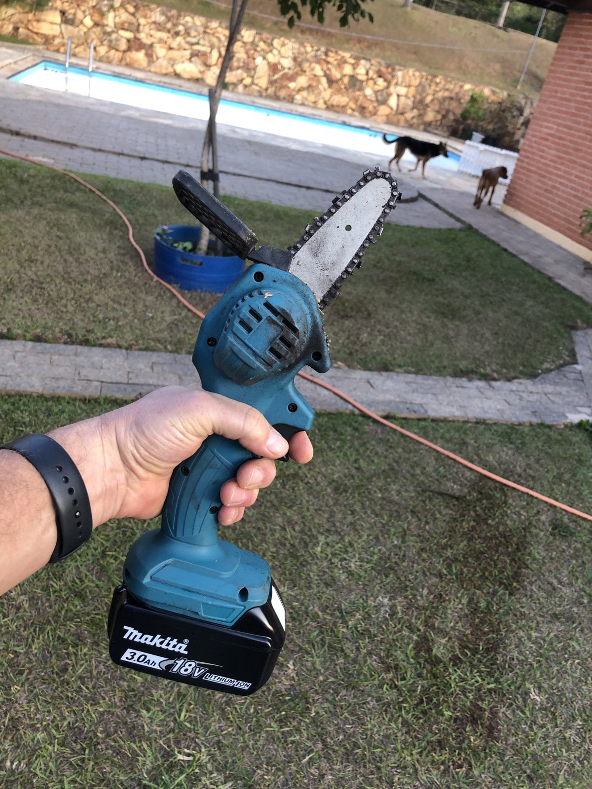

I do not build trails, just ride the ones I find opened in the woods. But in when there are small trees blocking, I will take this little devil on the next ride:
I call it chuck, the assassin toy. No safety mechanism, just pull the trigger …
Always keep the batterie off of this thing!!!
That’s a great little tool but I can put the sawzall 12” pruning blade right in the dirt. A chainsaw chain might not hold up as well. But sometimes I wish I had a chainsaw.
