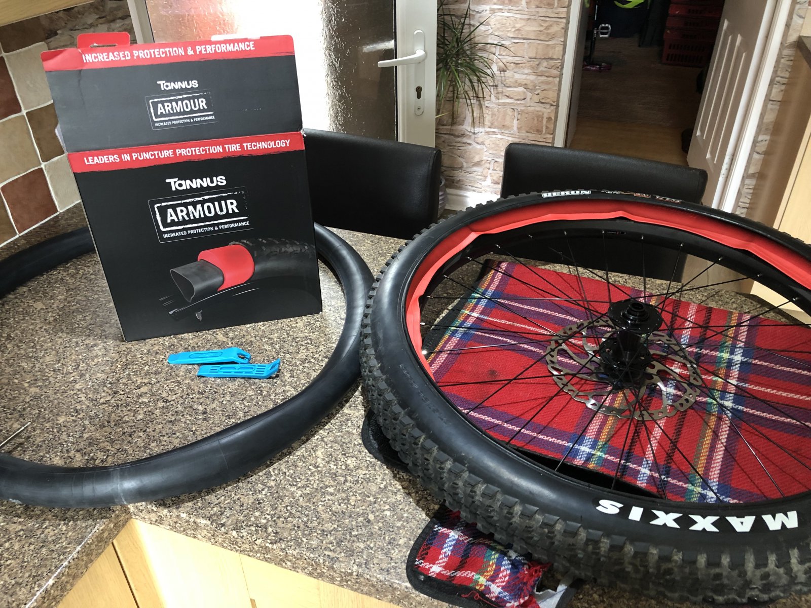

Took my time and they are “relatively” ?easy to fit, test time on Sunday ??

I just fit one to the rear - it actually went on pretty easy. I did it the way tannus suggests - put armour in tyre, put partially inflated inner tube into tannus. Once the inner tube was in the tannus, I pumped it up pretty hard so that it was sitting straight, then let it down to just partially inflated. I also used some soapy water on the last bead to go on, don't think I needed it though. Pumped it up to 40psi to seat the bead properly, then let the air out so that it is pretty flat. It's blowing a gale here today so I won't pump it up till I'm ready to ride.
I'm only going to use this on really light tyres - I have a maxxis dhrII exo which is way too light to go tubeless. My replacement tyres when this wears out are 60 tpi - I'll try those tubeless again because they are a bit heavier. The tannus seems like a good option to have for those really light weight sidewall tyres which might work out a lot cheaper than buying the heavier sidewall counterparts - just another possibility.
