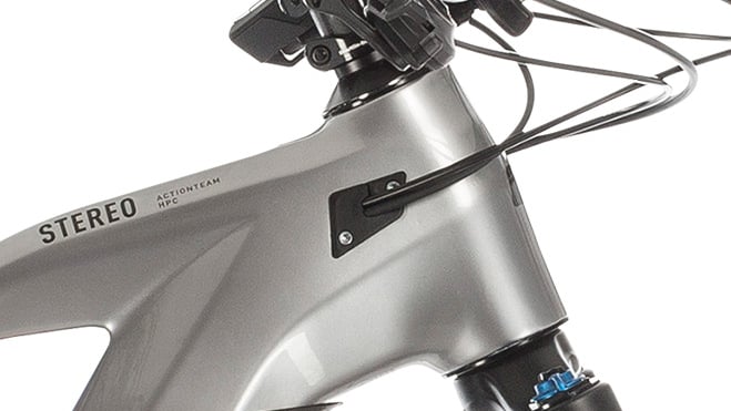

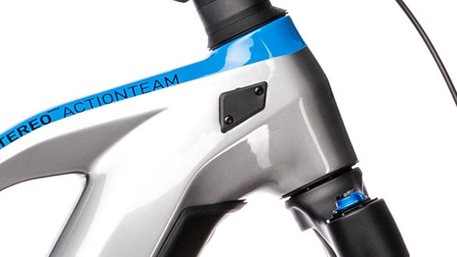

I have the 2020 AT and looking at the differences, all I can see is there are a couple of holes and a split in the top of the 2020's blanking plate.
I'm sure that the 2021 would have a backing plate, so I would just take it out and drill a couple of holes in to suit.
A close up of the 2020 is here to see and compare
2020
2021
Just a heads up, it is awkward to re fit!

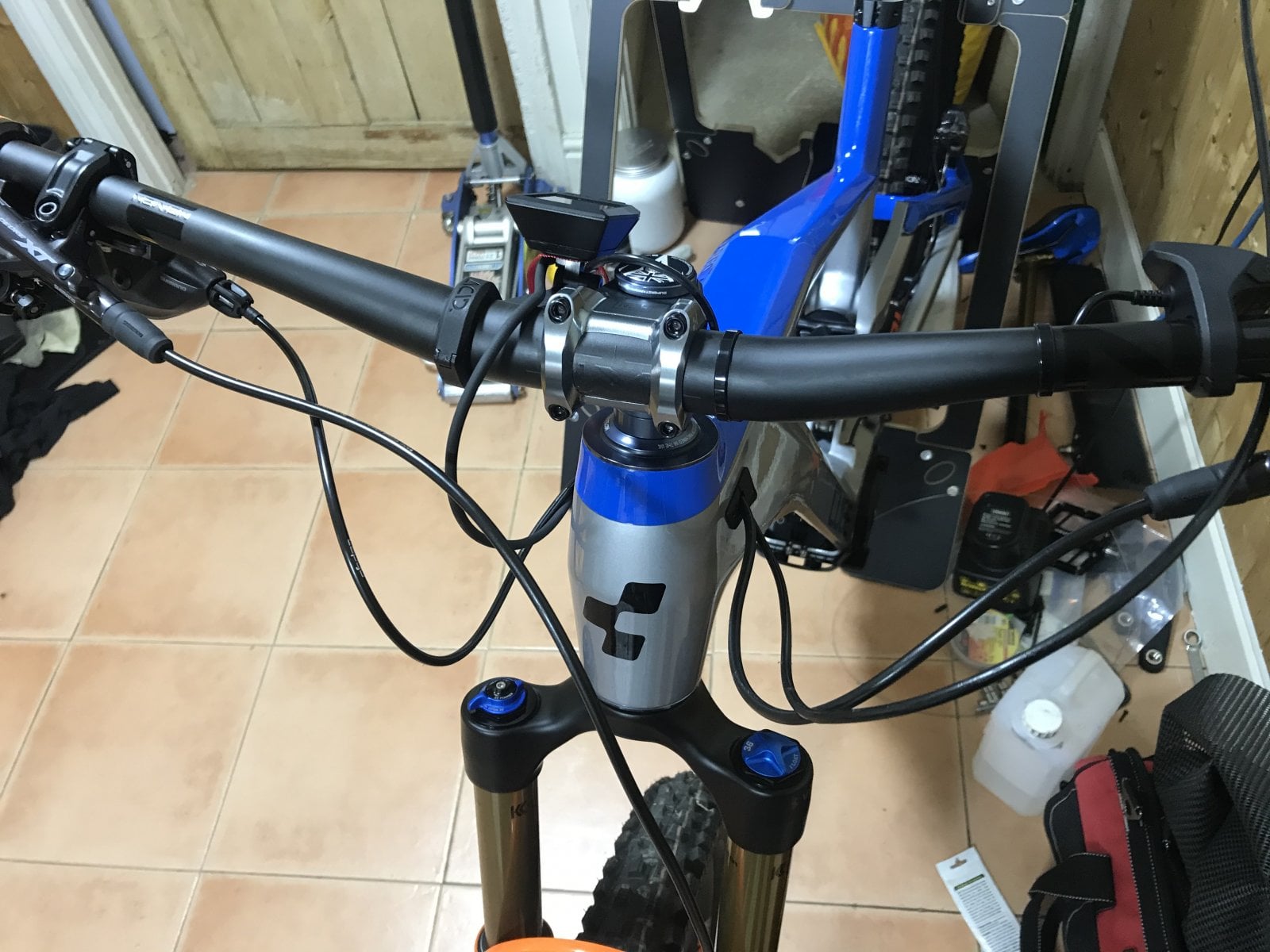

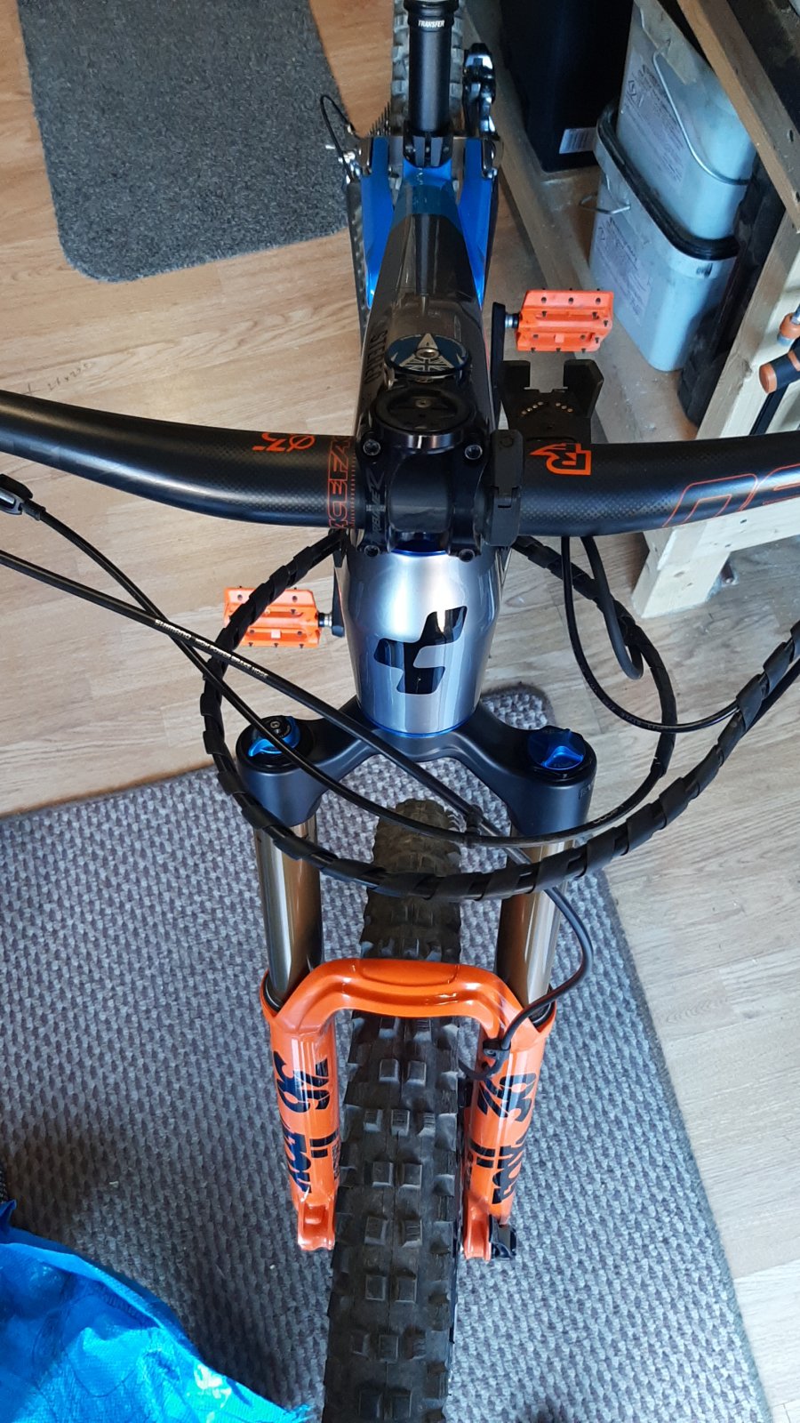

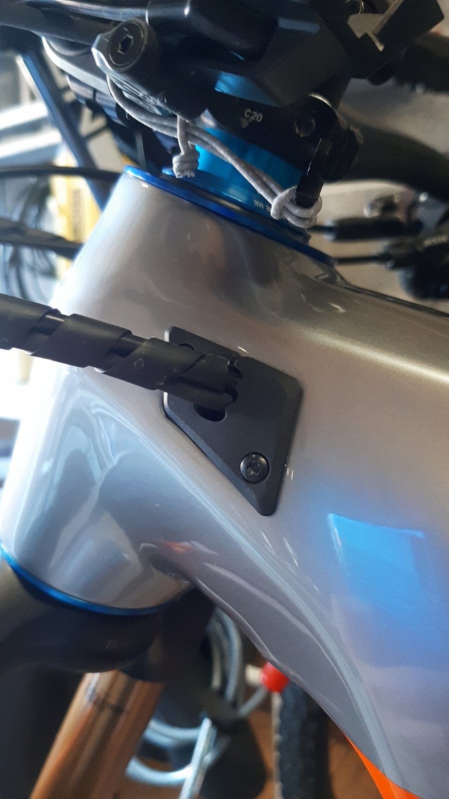

The pics above are from Cubes website, but the following are from my bike with a Superstar headset fitted
Right side
Top = Rear Brake
Bottom = Dropper post
Left side
Top = Gear cable
Bottom = Kiox Cable
I keep the cables tidy with some short pieces of spiral cable wrap

@Morpheous Not sure if you've had a chance to do your cables yet, but I decided to tidy mine up today.
This time I re-routed the gear and rear brake hose to the same side the control is on.
Mine are now set up as Right side = Gear cable + Dropper, Left side = Kiox + Rear brake hose. I ended up cutting about 150mm of the factory setup gear and rear hose.
If you route yours the same, you may have enough without having to replace the entire hose/cables.
When routed like mine are now, if there is enough hose to reach the end of the brake master cylinder and enough gear cable to reach midpoint on the trigger lever, you should be good to go.
You could also run the dropper on the left as well as the stock frame blanks have 3 holes (see my second pic above).
You will have to take out the top cup to do it, but its easy enough to do.
HTH
