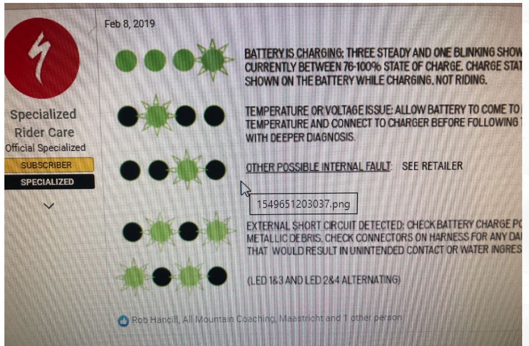

Recently had this, on and off, for months. Most recently it was fine for a whole month then started playing up again. It comes and goes on its own, independent of whether you have ridden it or not. New battery and so far so good. But - confidence in it turning on has been hit hard.
Have you seen this ?
I dont understand at all how a battery fault can come and go like that!
Ahh thanks a lot! I was looking for that when I was waiting in the bike shop. They didn't know what the 3rd flashing LED was, and I said that I had seen somewhere what the different flashing LED's meant; and that's when I started searching and found the eMTB thread I posted (and this one). I couldn't remember exactly where I had seen it, so that's when they called Specialized support.
But cheers - that is the exact post I was looking for, and now I've saved the pic.
