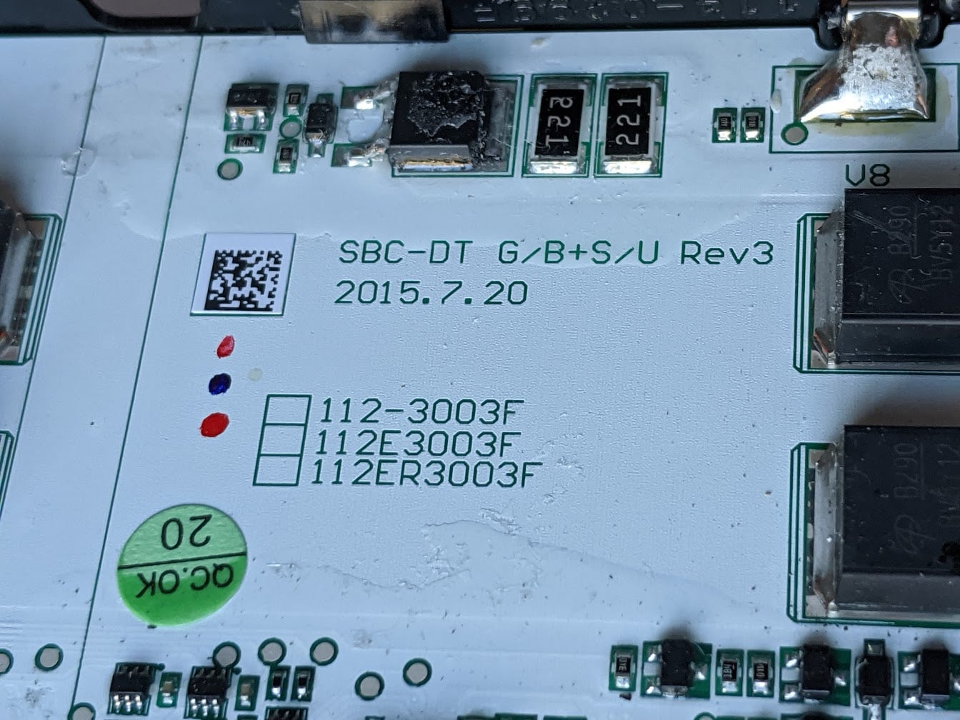

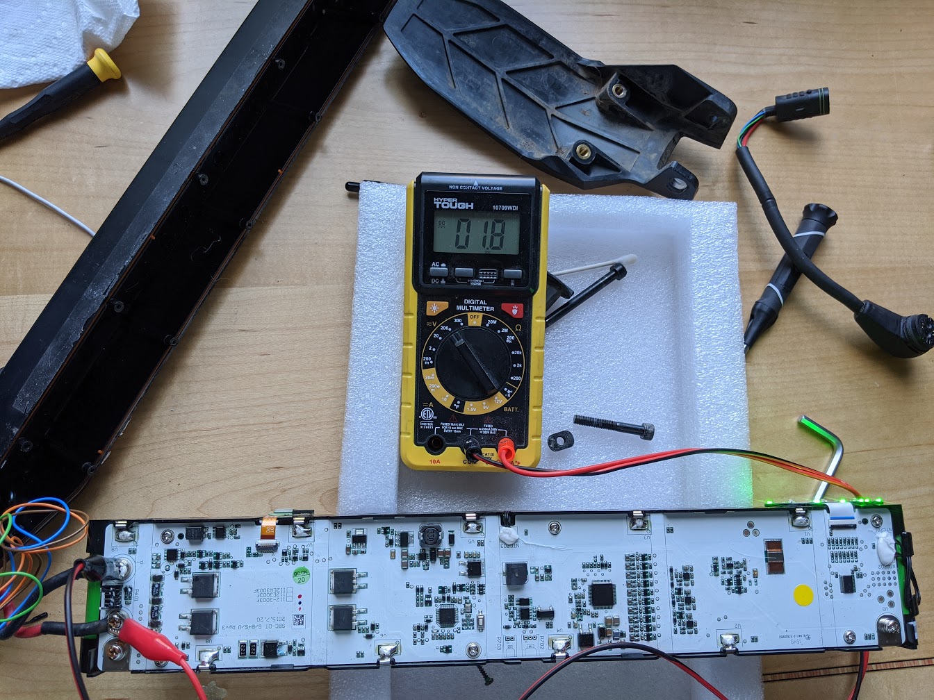

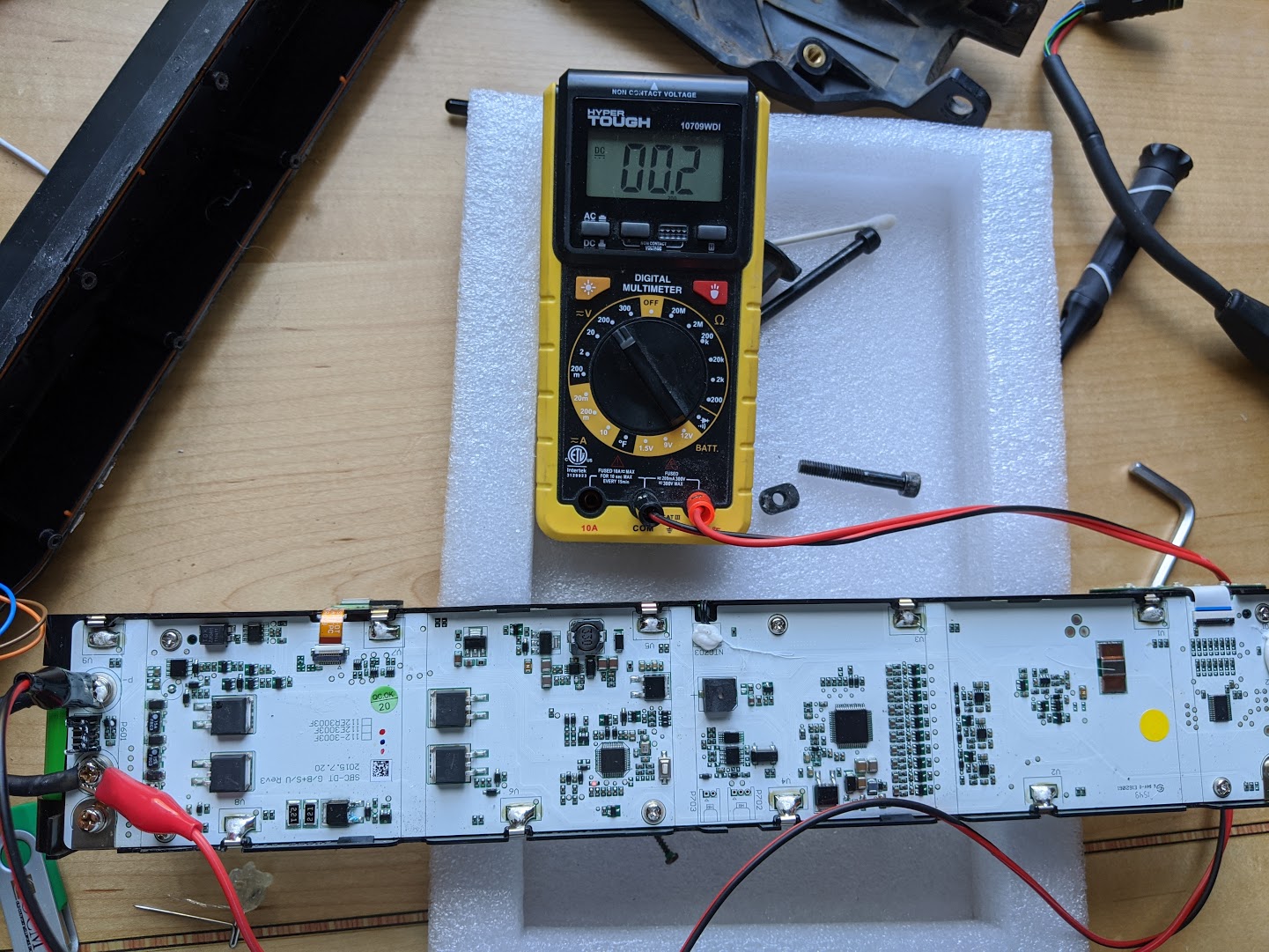

Hello all, I still have this issue and would love some help please.
A LBS sold me a new wiring harness. I took it home and installed it, but the issue was still there. I compared the old wiring harness with the new one and found they were not the same. There is a difference with the wire order and I verified this with a continuity test. The LBS confirmed I had the wrong harness and ordered it the correct one. When I picked up the new harness, I took my bike in so the tech could have a second set of eyes on the bike. When the tech installed the new harness, the problem was still there - no power to the motor. The tech suspected the motor was bad because the battery appeared to be working and communicating via the app, he even was able to upgrade the firmware. A few days later, I replaced the motor and still had no power to it. After this, I just left my bike at the shop who agreed to test the new motor and harness with a different battery when a battery was available. When a battery came in, the tech swapped it and IT WORKED!!! Now it seems like my battery is bad, but I'm not so sure and suspect I still have a wiring issue. When I measure voltages, everything seems fine, including battery cluster and total voltage. I think there is plenty of power in the battery, but the motor is not calling for that power via torque sensor through the CAN.
I'd really love if someone has knowledge or a schematic. Anyone know of a diagram or pinout on the CAN side? Are there ways I can further test or measure this? Also, when I measure standing voltage to the battery when the battery is on, I get roughly 1.8 volts and off I get .2 volts.
Another thought that I have is this battery is dated 2015 and my bike is a 2017. Anyone know if there was a wiring harness change during this time?
Please help me if you know this. I'd love to ride this bike again.
