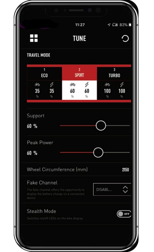

Hi all,
I've had my 2020 Comp SL for about a week now, and I'm enjoying it immensely - even at the age of (nearly) 60, and coming from a FF Bosch-powered Cube, I think that Specialized has really read the room right with regard to their power decisions with this bike/motor combo.
But here's a thing: I can feel a distinct difference between the Eco and Sport modes (at default settings, and at any sensible changed settings I've chosen to try); but I'm feeling no difference between Sport and Turbo (or if it's there, it's incredibly subtle), regardless of the settings I've tried so far.
For example, at the moment I've got Sport at 50%/60%, and I'd expect to feel a clear change between it and Turbo at 100%/100%, and there's no discernible difference whatsoever.
I might have picked up a difference between the two when I've dropped Support to 70% in Turbo, but it might have been wishful thinking - to all intents and purposes it's as if I only have two distinct support modes rather than three.
Is this normal? Is the difference between Sport and Turbo really that indistinct on the SL? I'm thinking not, or I would expect to find other posts on the topic, and I haven't.
Or is it some sort of cadence/user input thing that I haven't yet found myself riding to? I'm a spinner on the flats, and the support in the other two modes seems to suit my style perfectly: but I was really expecting to feel a difference between all three modes - my settings in Sport and Turbo are different enough to imply that - so what am I missing?
(I've read the support mode explanation posts on here, and I've read the manuals, but they don't shed a light on what's going on. Up to date firmware, and nothing in the diagnostics.)
TIA of any helpful suggestions.

Thanks for the reply, boBE. On the face of it then, there's appears to be something wrong with my bike.
Just to be clear - that's on an SL?
I ask, because you mention "Trail" mode, and Mission Control for my SL doesn't have that - it has "Sport":
Anyone else care to share their experience of the difference between Sport and Turbo on the SL?

I've just been out again - 25 miles on mixed terrain - and I've really paid attention to cadences, the feel of the different support modes, everything.
And I'm still getting little or no obvious difference between Sport at 50/60 and Turbo at 100/100. Once or twice I thought I might have noticed a tiny extra bit of push, but nothing within a million miles of "a huge difference"; and TBH it might just have been wishful thinking again.
Changing Sport to 100/100 feels the same as Turbo (as you'd expect) so it's as if 100/100 as you're describing it, just isn't available.
I'll see if a(nother) factory reset makes a difference - and if @Specialized Rider Care could chime in, I'd be very grateful - but it seems quite clear that my bike isn't working as it should.
Disappointed...

@Zimmerframe has the right idea. This spells out how:
1. Activate Mission Control on your phone and go to the LET'S RIDE icon.
2. Click on the STATS menu at the top and set two of the windows to report RIDER POWER and MOTOR POWER (just press and hold a window to see choices).
3. While riding compare the RIDER and MOTOR readings with your Tune Settings.

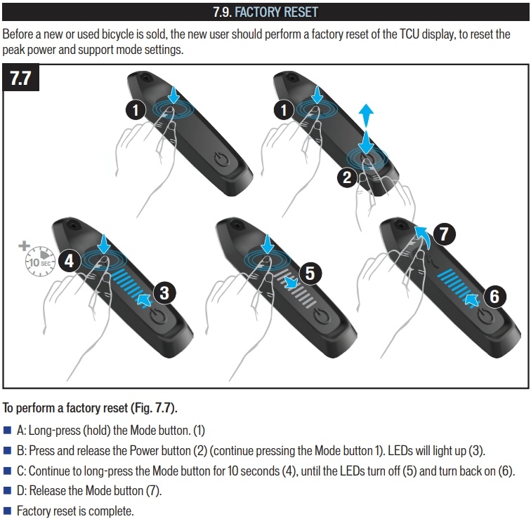

Just to bring this to a close.
I don't know whether it was as a result of deleting/reinstalling Mission Control, or (maybe and/or) doing another factory reset, but I was out on the bike again today, and - I'm delighted to be able to say - I'm now getting a clear difference in support across all three modes. Turbo at 100/100 really is obviously more support - if quite subtle in its initial delivery (is "subtly obvious" an oxymoron? ;)) - than Sport at (say) 50/50.
(I know that should be obvious, but it wasn't happening previously.)
Point being, I'm now getting distinct, additional levels of support as I click through all three modes, so it's all good.
Actually, no. It's bliddy brilliant..!
Thanks to all for your help and advice.

I am having the same issue on my bike between Sport and Turbo, doesn't seem to be any difference in boost.
I have deleted the Mission Control app and no difference.
How did you do a reset, I am curious?
