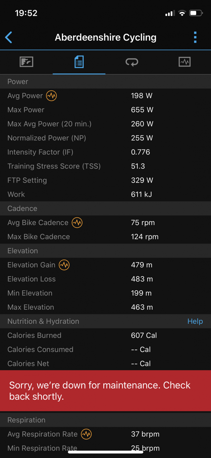

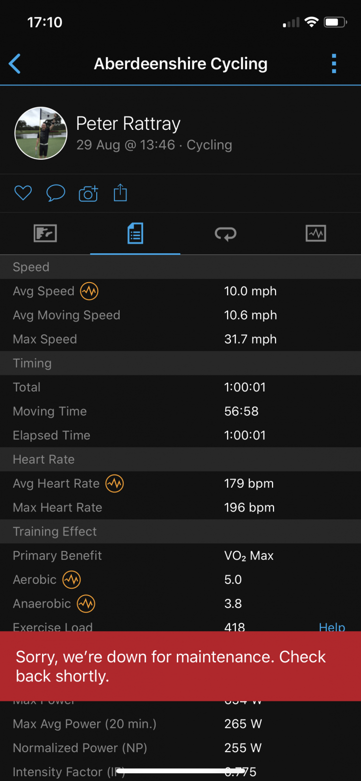

Yesterday, I set Eco to 35/80 and did this route. I started with my battery at 100%
As you can see, it took me 1 hour exactly... with 56.58mins of this as my moving time. I stopped in 2 places for a drink of water.

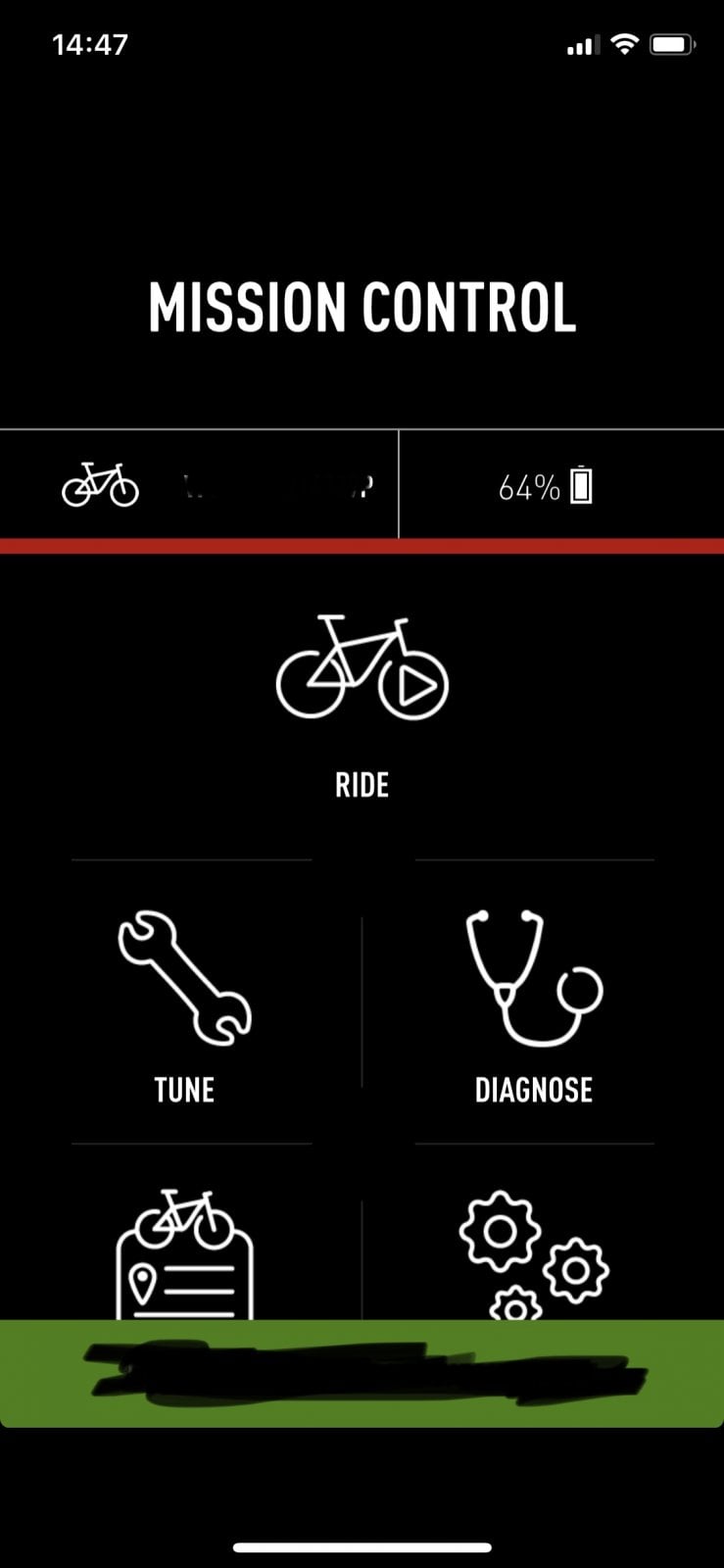

My battery was at 64% when I reached the car.

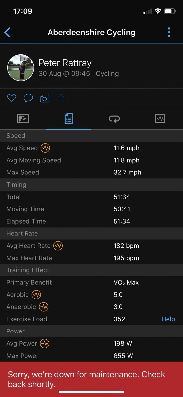

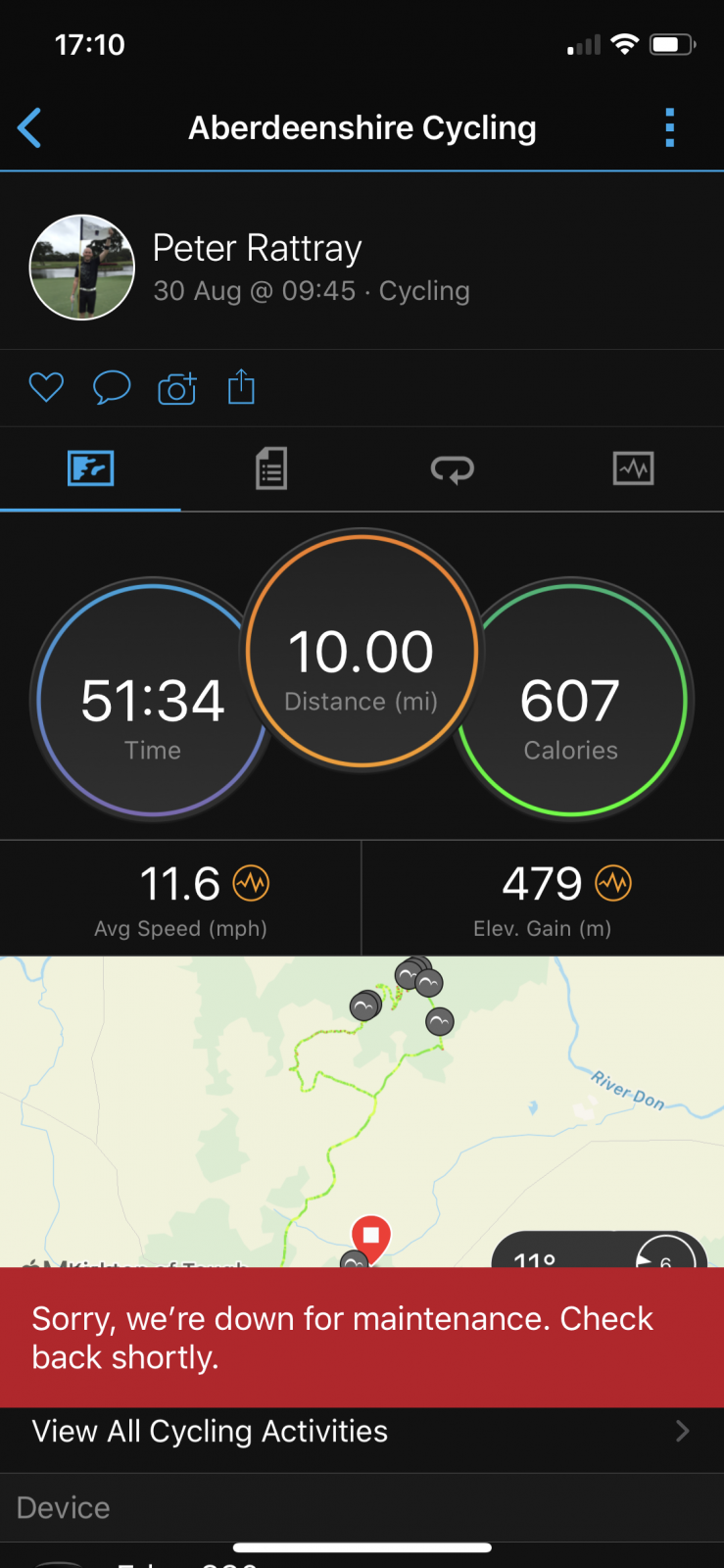

Today, I set Turbo to 35/80 and did the same route again. My battery was fully charged for this one too.
This one took me 51.34mins, with 50.41mins moving. I only stopped for 1 drink this time. The reason being that there was a guy sitting at the top, and I knew if I stopped, I’d have ended up ruining my experiment and having a chat... so I just kept going!!

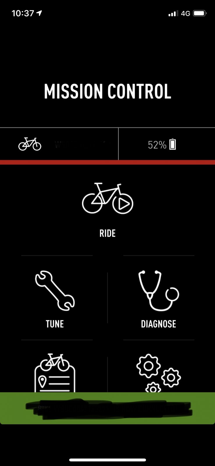

At the end of this one, my battery was at 52%.
So - what’s the conclusion?!
To me, it was obvious when riding in Turbo that it was going to use more battery as it accelerated quicker. The motor seemed to kick in much quicker and also seemed to be louder. It also had more over-run when I stopped pedalling. The easiest way to describe it would be as more aggressive.
If anything, my legs were a bit more tired today (Turbo) after my first ride in a few weeks... yet it was still 6mins and 17secs quicker. Over a 1 hour ride, that’s quite a significant difference.
It also used 12% more battery. Again - a significant difference over a 10 mile ride.
I tried my best to make sure it was a fair test. I was pushing pretty hard on both rides, and was pedalling most of the time with the exception of some downhill parts. I had similar clothing on both rides, so would have weighed the same... and the conditions were identical on both days.
Hopefully the Garmin data for Power and Cadence etc shows that both rides were very similar.
