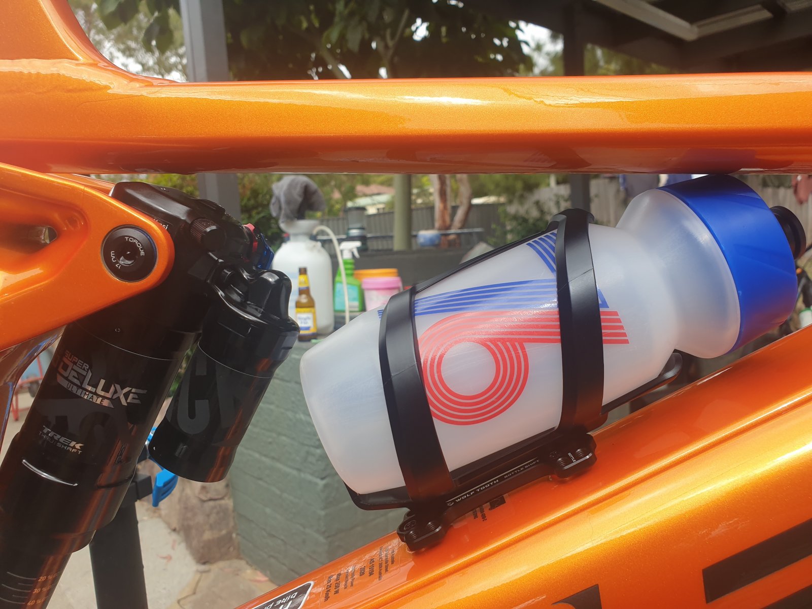

From within the thread @Philly G has given...
And another option from the same user on a medium bike .. (rail 7)

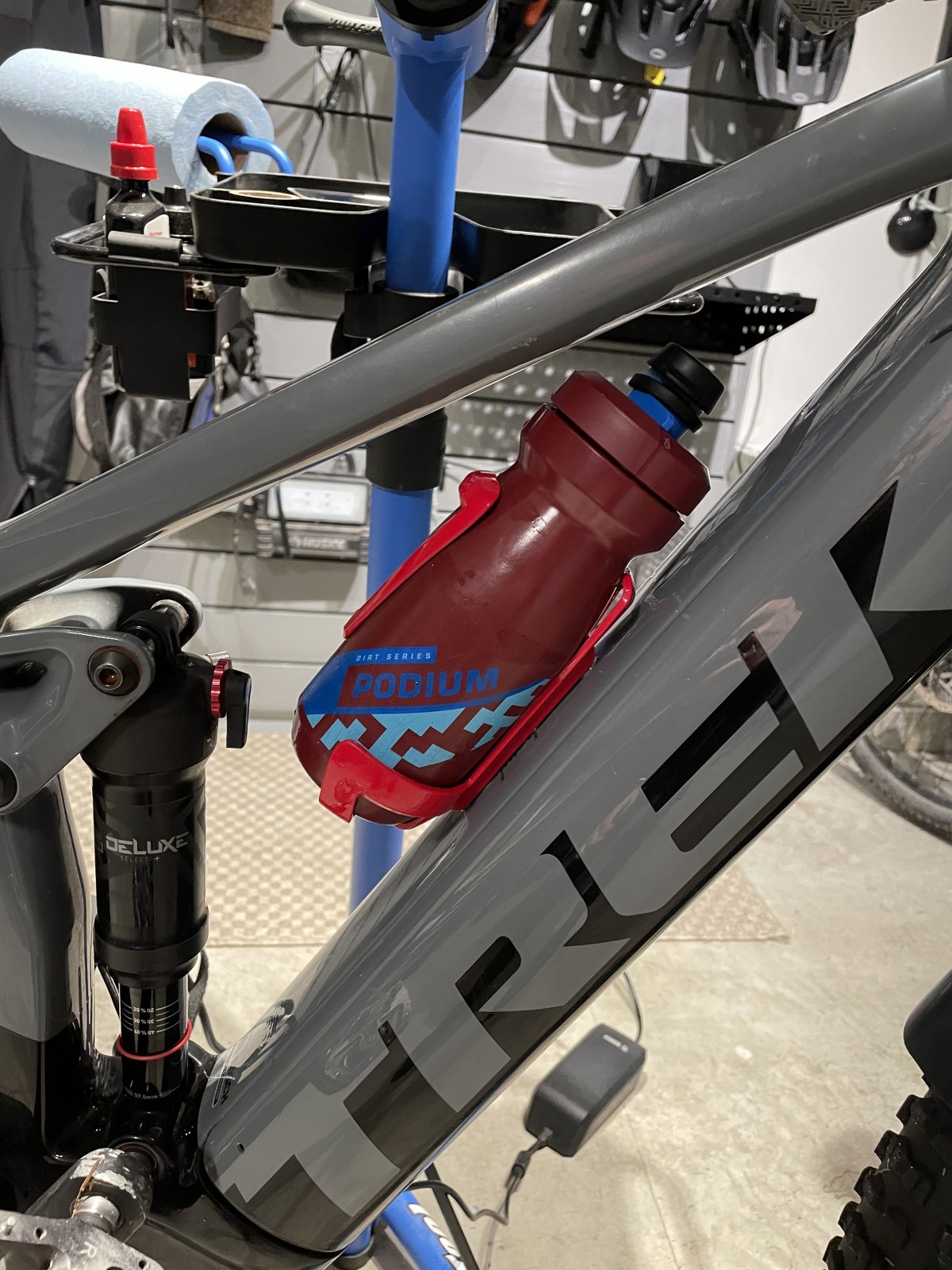

I have a medium rail 2021 and have a bontrager side load cage with it pushed all the way up. An old camel back podium 620ml bottle squeezes in but rubs on frame, so i put some tape on to protect the paint. A fly 550ml bottle fits with clearance, so it should have ample room on a large frame.

I have the 2021 rail 9 in medium. I filed the slots a little more on the cage and have it pushed up as close to the front of the bike as i can get it.

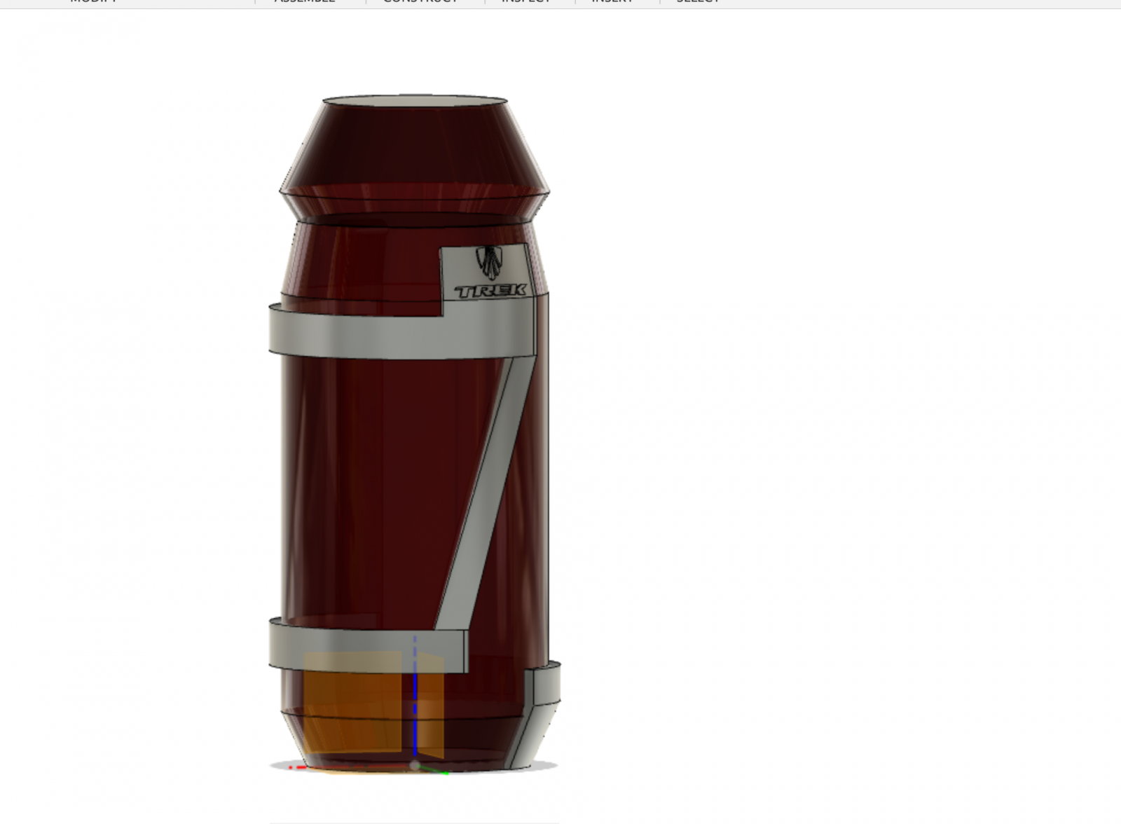

Making progress....

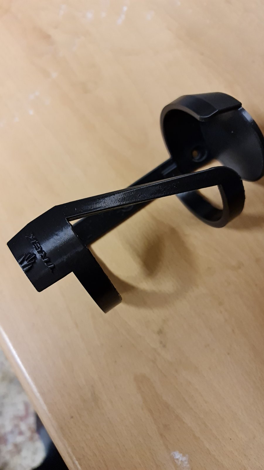

I have just completed my design and it will take a 500ml (I reckon a 550 would fit) side loaded and won't require a bottle shift. I already have a side load bontrager, got that when I got the bike assuming it would fit. Sadly not. I will post some pics once I have my design on the bike. I have nice clearance top and bottom even with the 9 series shock cannister at the front.
Link
Nov 22, 2020
152
140
pretty happy with that, even got the Trek logo on the top ! :) , loads of clearance and doesn't stick out to one side.
the bottle seems nice and tight, but can tweak some areas if i need to make it hold tighter following some rough terrain testing, but i am pretty sure its good to go. Not sure why Trek/Bontrager don't make one that fits, but anyway one exists now.

Hey, Not really thought about it but assuming I am not breaking any forum rules ? I am happy to offer them (have a range of colours too) ??.0

i have a medium and never found something that worked well and hence made my own, i didn't like the bottle shift as it looked odd having it hung to one side.

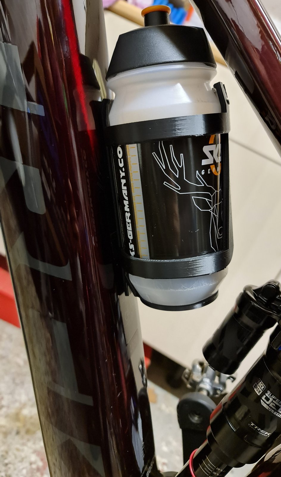

Hi, I just bought two bottles, which fits well size M and S. One is Zefal Sense PRO 50, where on my size M is like 2-3cm of space left, so it will fit size S without touching something. Another one is ELITE FLY 0.55 l, which fits my size M too and there is like 1cm of space left, so puting it in and out is without any problem. For the cage I use Bontrager Left Side Load (code 5274463).
