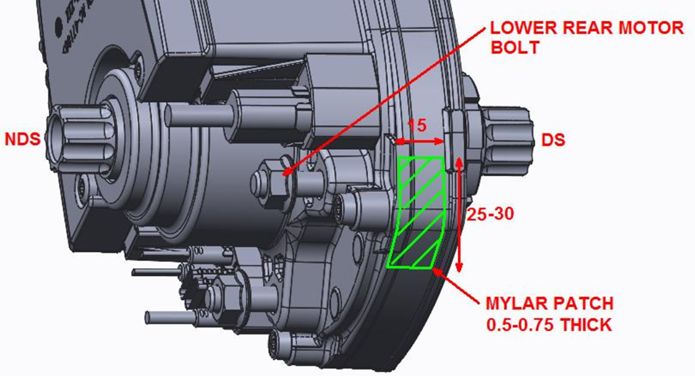

Sorry to hear - if the above ideas don't resolve the issue then advise the retailer to try this for you. On MY18 Carbon Levos the motor can contact the aluminum sub-frame after the main motor mount nuts are properly torqued. There is no need to replace any parts - an adhesive mastic rubber or mylar patch is all that is needed - applied to the point of contact, which locates the motor away from the sub-frame while the motor mount hardware is re-torqued, best in a cross-pattern.
I can’t see any contact any other suggestions please?
