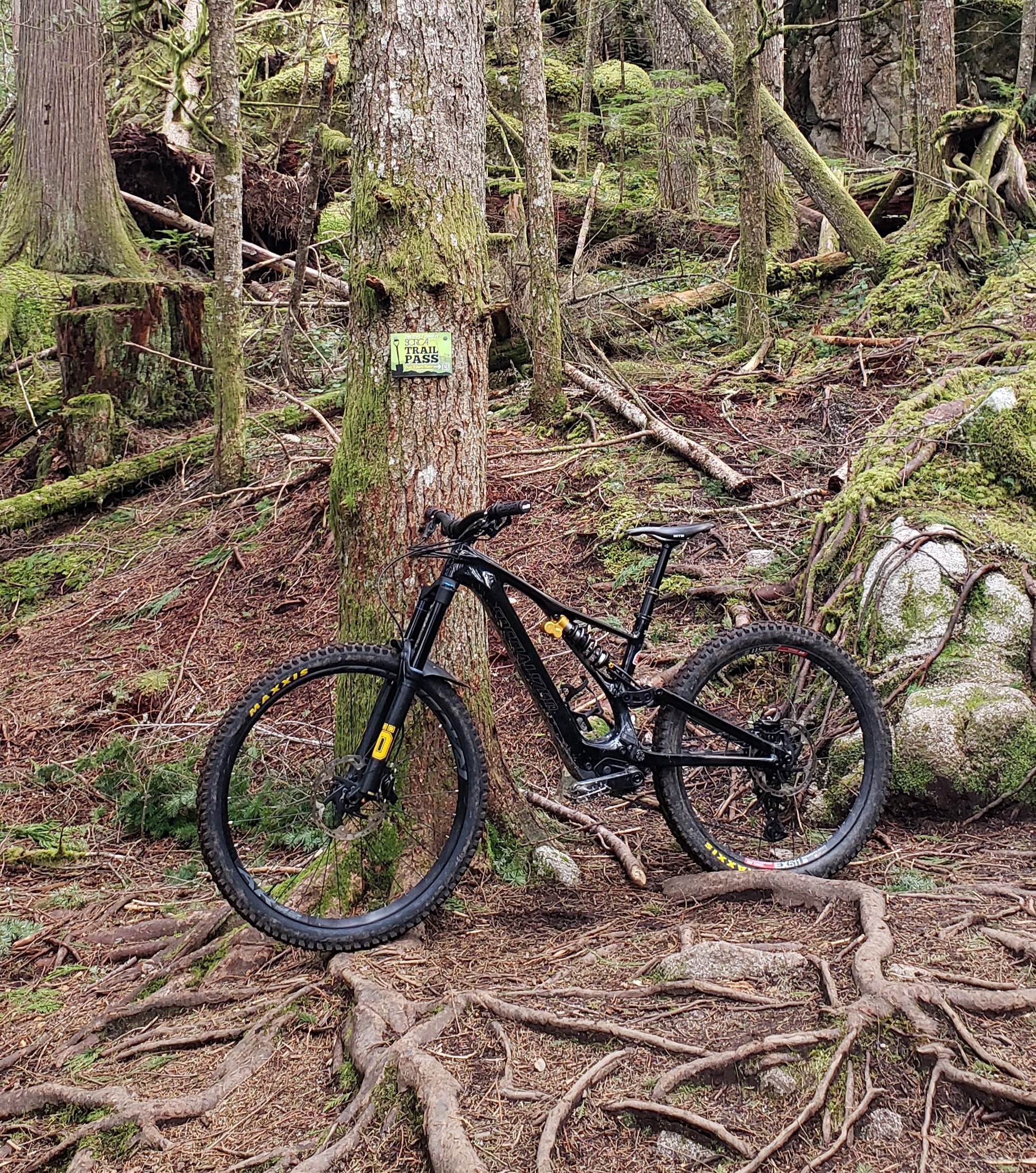

We run the RXF 36 170mm along with the Ohlins coil shock on our Levo SLs. It's a nicely balanced bike that can ride down any trail I have ever put it on. I like the Ohlins RXF better than my FOX 38 Factory if that means anything.
Nice bike! Still got it?
Can I ask which spring you have got on that bike? Looking for a black one for the TTX m2.
KnollyBro
Dec 3, 2020
1,028
2,389
Vancouver
Thanks! Yes I do. I have to say I am not sure which bike I like better, my Kenevo SL or the Levo SL for the kind of riding I do. My Levo SL has a Cane Creek Valt 2.25x600 coil with a Cascade Component suspension link on it.
