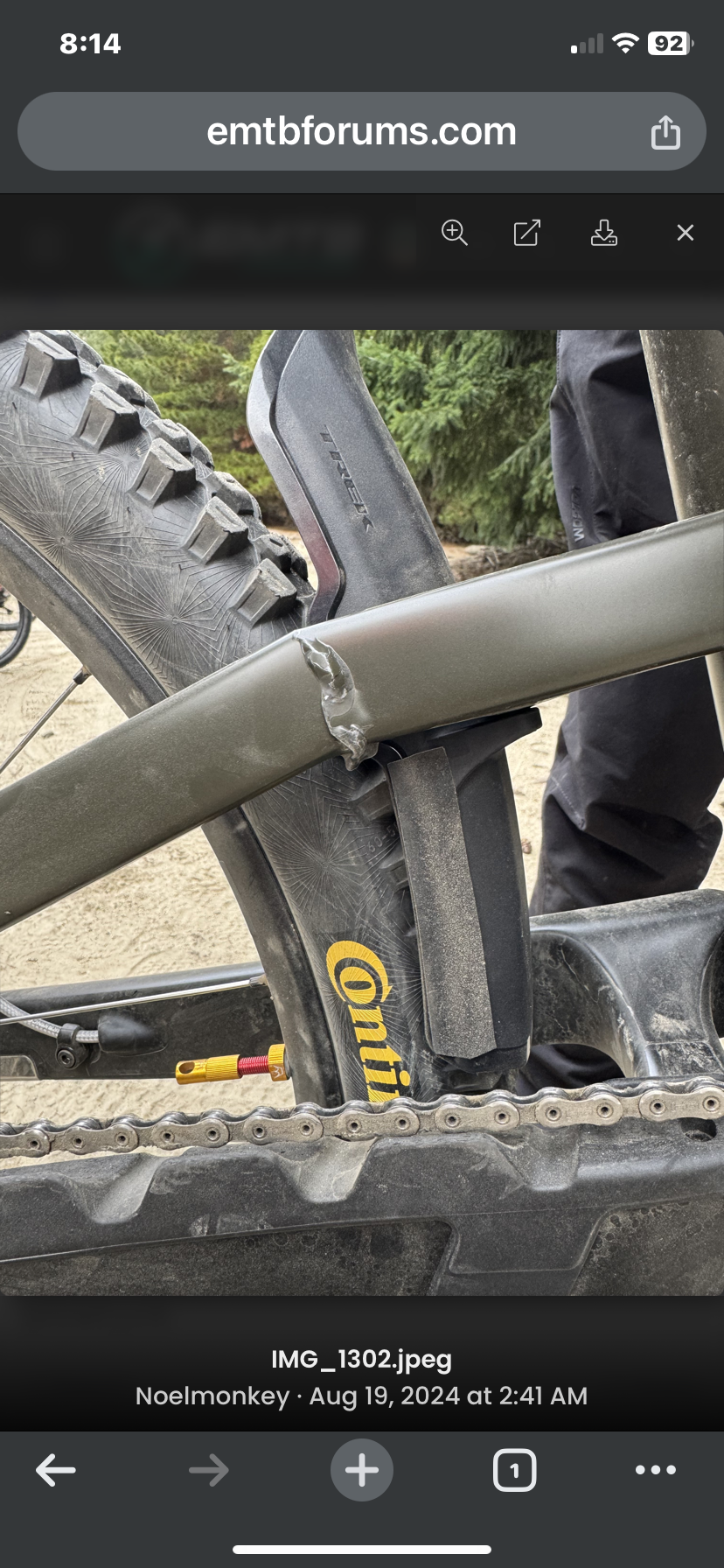

Second ride.
No crash no nothing.
Both sides. Broken right through. Warranty accepted. Will have a new seat stay in 2 weeks. Hope it doesn’t happen again
That's crazy for a new Trek, such a well-established well-built bike brand.
Hope it was a one off.
I’m pretty sure it was a one off. Lovely bike to ride and I come from a full power Rail and an Evil offering v2. Can’t wait to get back on this horse. Such fun !
All bikes have issues. It’s how the manufacturer looks after the purchaser that matters. In this case it has been phenomenal. I have broken a lot more alloy bikes than carbon. I cannot wait to get back on this bike.
If it’s a design flaw then it will be happening again….. sorta like all the evil bikes cracking at the water bottle mounts or Kenevos snapping alloy shaft coil shocks. Buying a bike the first year they are out means you are the beta tester.

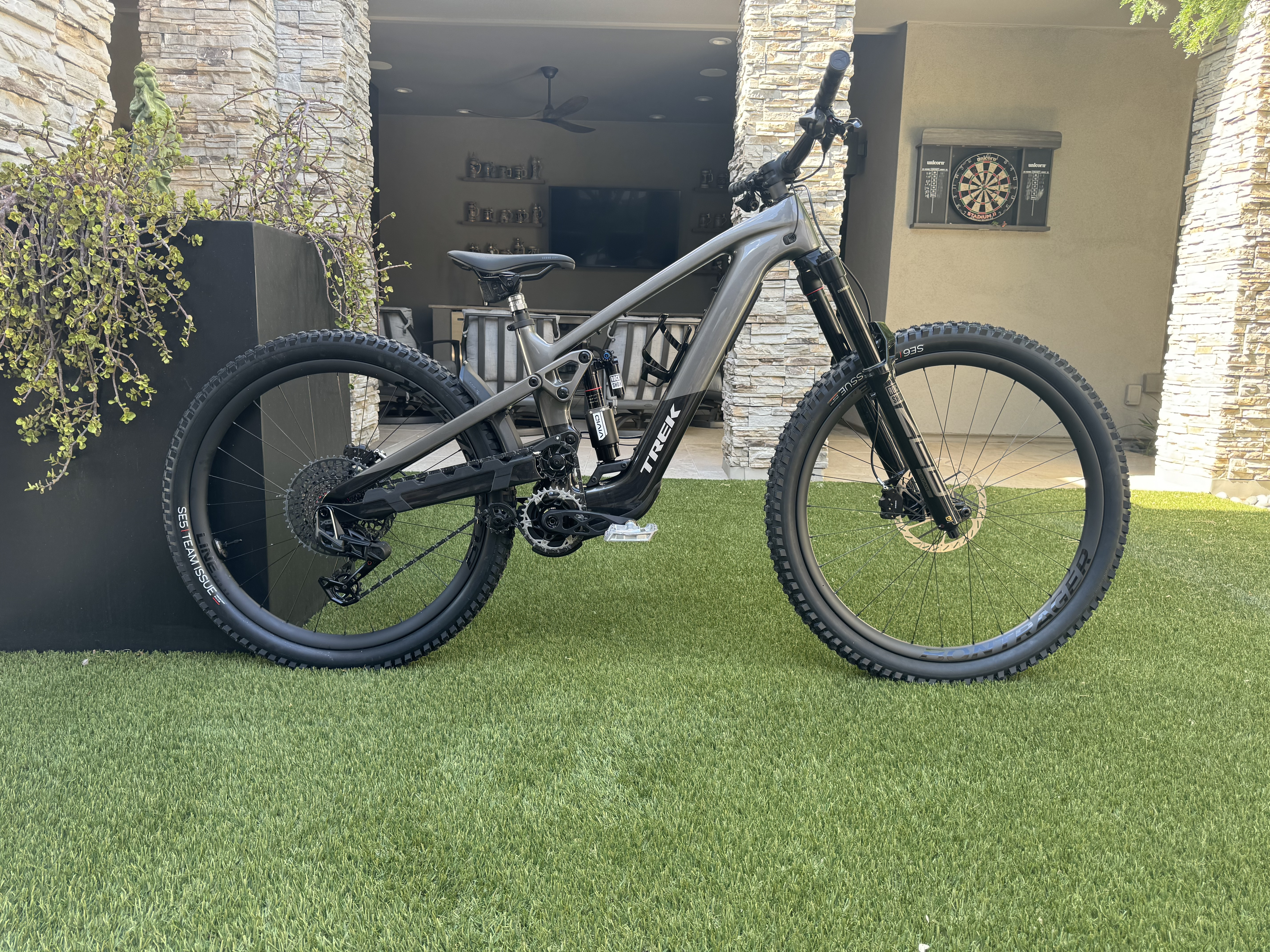

I received mine on Thursday and took it up to Sunrise in Greer, AZ on Friday. I also took my Firebird (non-EMTB) and did 4 runs with the Slash+ and 5 with the Firebird. I was faster on every single run with the Firebird and by a significant margin but I've had that bike for almost 3 years and raced multiple enduro events with it and had it at Sunrise more than a few times so it had a significant advantage going in. It is also way lighter and, honestly, pedal assist at a lift assisted bike park is not particularly useful. I'm not anywhere near a pro or high level amateur but I'm in the top 20% on Strava times on every trail I've ridden up there so I'm not incompetent either (just to give you a skill baseline).
Likes:
Very smooth in eating up bumps, absolutely does what it is supposed to do
TQ motor (still by far my favorite) feels very natural
Overall quality of components is also excellent although I'm not sure I love the handlebars that came stock with the 9.9. I'll likely change them out. Everything else though, top notch
Dislikes:
For that scenario it is just too heavy at 49lbs with pedals. The reason I was faster with my Firebird is simple, I was able to execute switchbacks and hard corners much more easily. May try it with the smaller battery next time.
Aforementioned handlebars
Too hard to get up in the air/not poppy enough but I think I should expect that.
For fun Enduro riding where e-mtbs are allowed I think this is a great bike but I can't see it as a park bike. I can see it as a great training bike for working on enduro type skills or an e-MTB enduro race. Better in every single way than any full power e-MTB I've ridden (I really just don't enjoy them at all).
I'd go 4.5/5 stars for a rating. Behind my Mondraker Neat RR SL which is still best e-MTB I've ridden but serves a different purpose.

I’m still waiting on a seat stay. Hopefully early next week. Haven’t heard from the factory regarding what happened to mine yet. Pretty sure it was a one off. Have purchased a transfer neo 200mm dropper and it can slam to the collar on my large. Whoop

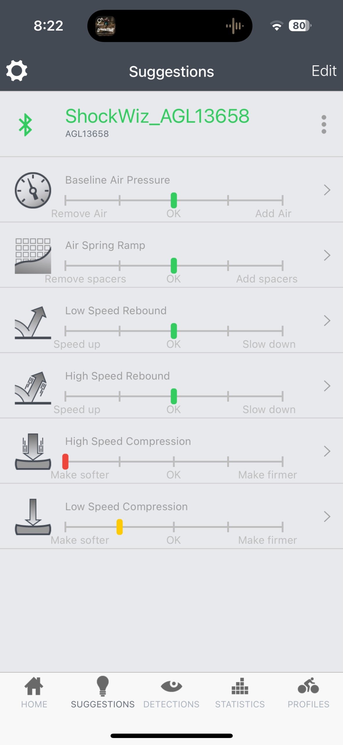

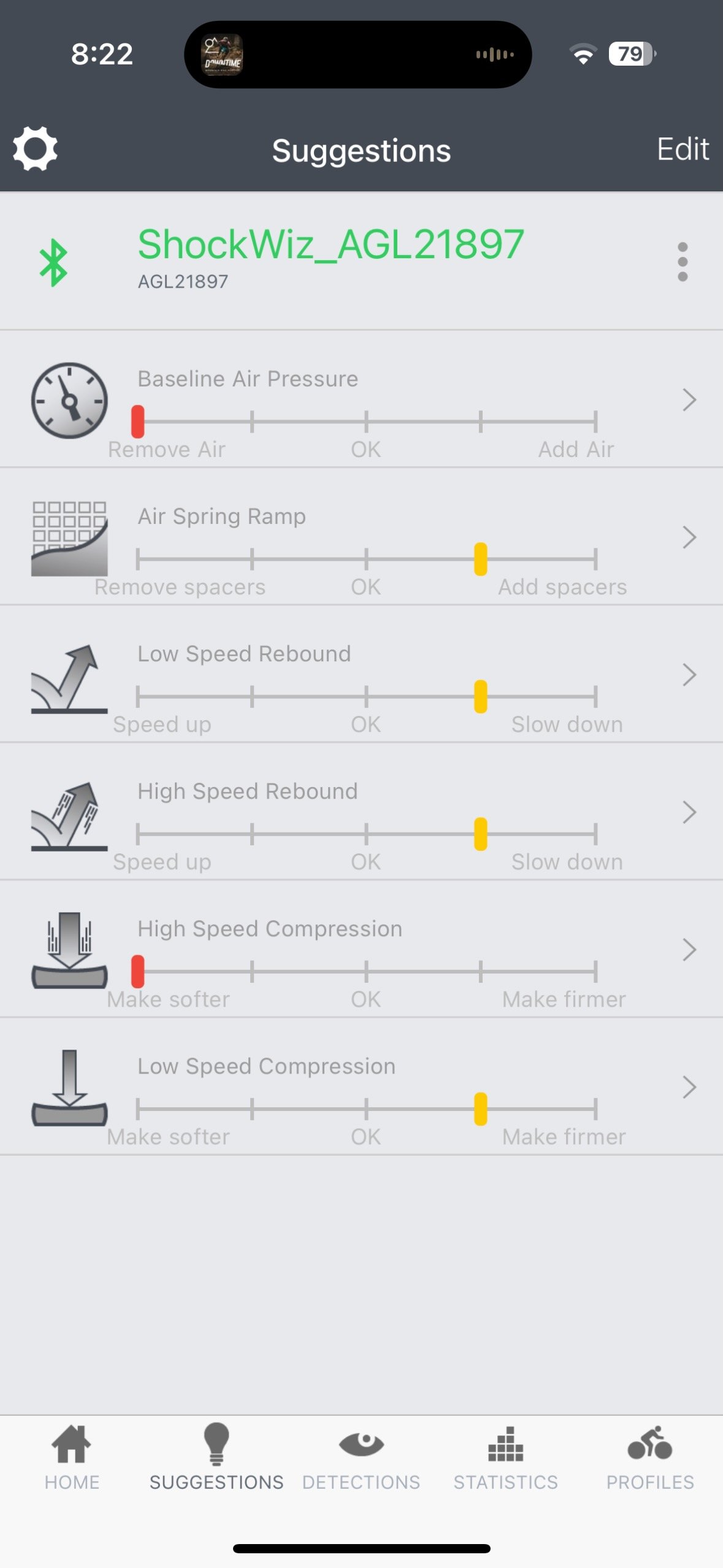

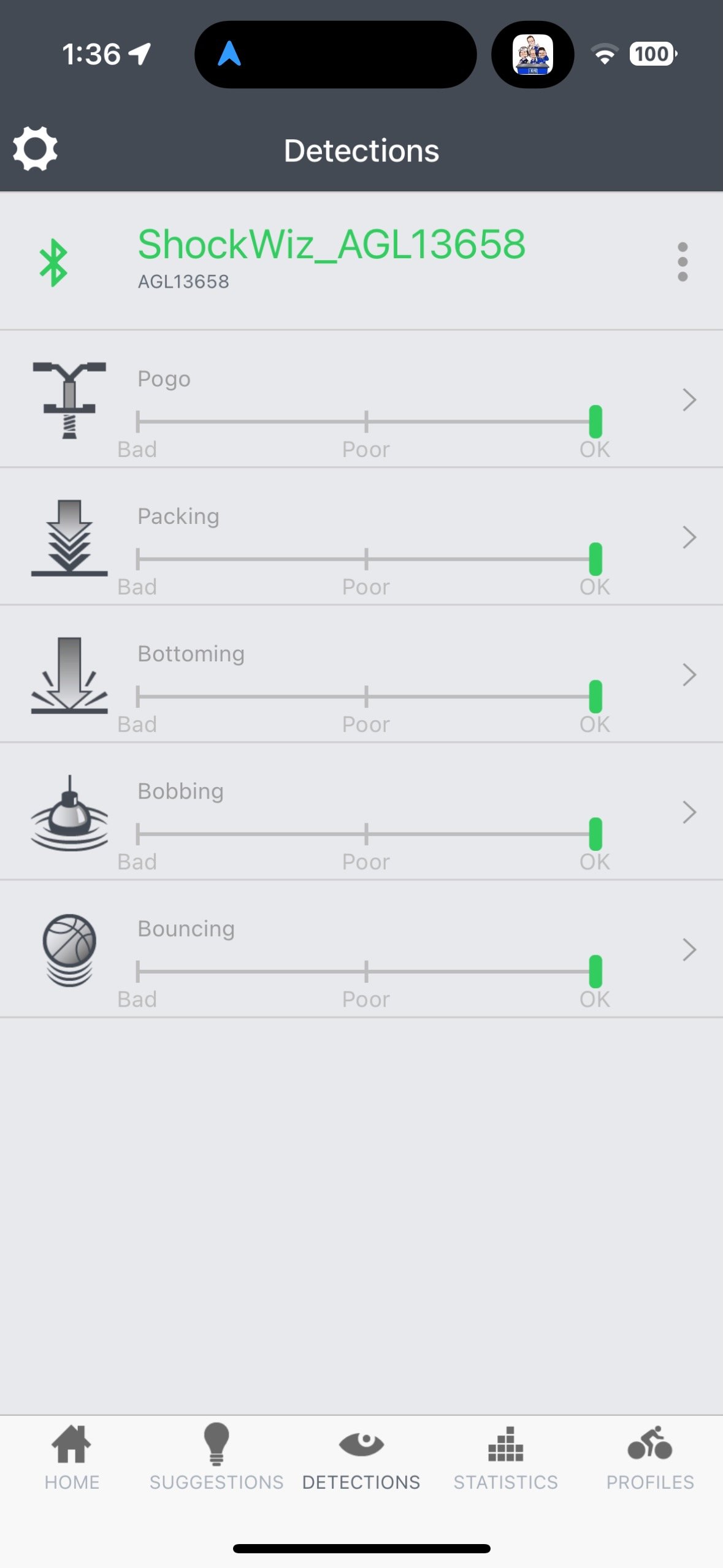

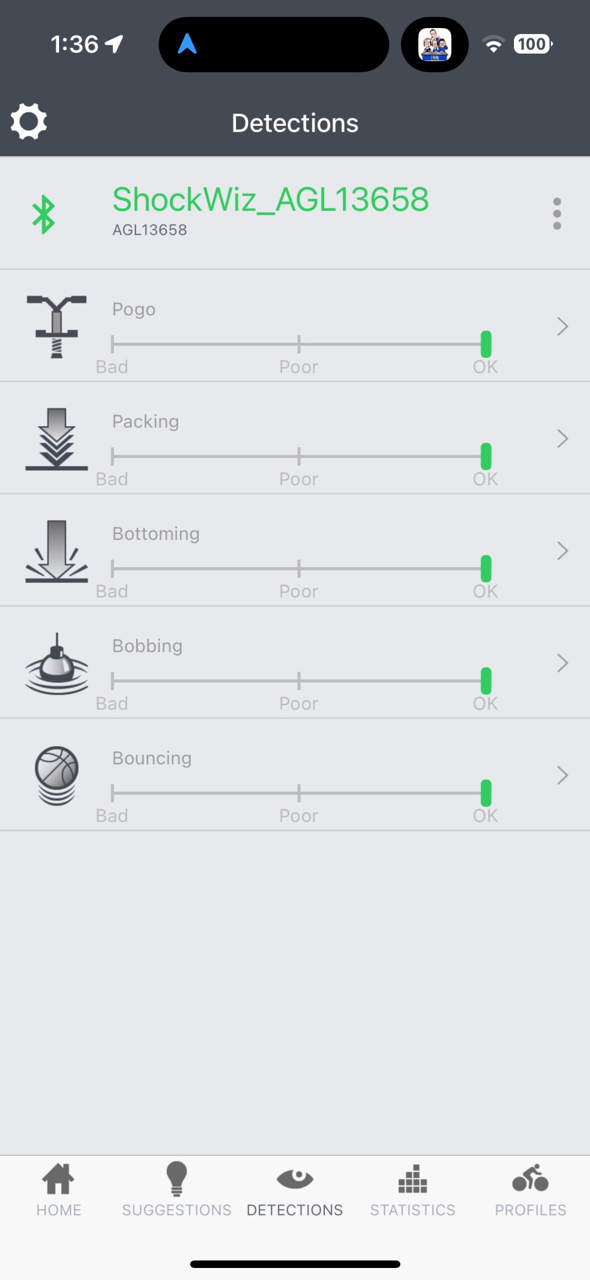

Yep. It is a medium and I've now had the opportunity to dial in the suspension quite a bit and I've already seen a lot of improvement on my ability to ride it fast in corners. I still need to hook up my BYB system up and dial it in further but I can say this for sure, don't trust the recommended settings on the shock. I put my Shockwiz units (my quick way to assess suspension) on the fork and shock and set them to playful. The fork was decently close and I didn't have to adjust many things but here's what I saw on the shock after the downhill and 30 mile ride I listed above (see Standard Settings pic). I then took did 4 runs on my the ~1 mile loop where I normally do my suspension tuning. It has everything I need other than longish rock gardens but that's ok. 4 rides and adjustments later I saw all green (shown in the Shock after fixing... pic). For the Fork, it wasn't too far off but here's what I saw after the original ~45 miles (see Fork pic attached). I forgot to take a screenshot after adjusting but it was all green after making the recommended corrections. I did a quick 18 mile ride last night after work and the difference was noticeable. I moved into the top 10 on multiple Strava e-mtb segments with it in these settings so I think they are pretty close to dead on. I'll still hook up the BYB when I have a chance to do more testing. Probably won't ride it again for a while though. Prepping for a race in the fall that is more on the XC side so it is no help to me.
