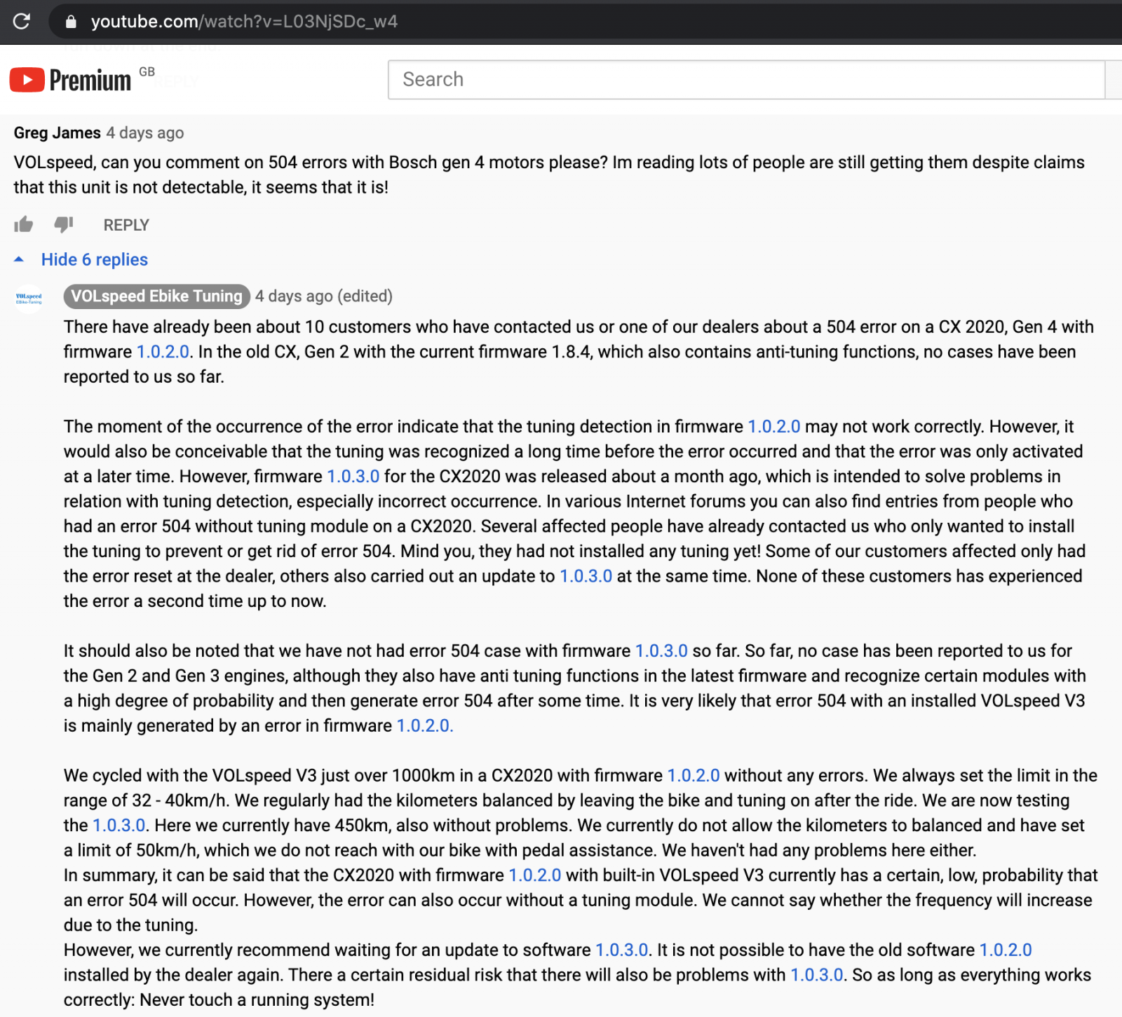

I found this on Youtube from VOLspeed eBike Tuning...
It says here that version 1.0.3.0 is working perfectly with reports of error mildly occurring with 1.0.3.0.
Woow seems this one was posted a couple of days later after I contacted them. Good to know things are running better, I got 1.0.3.0 so might look to buy V3 very soon.
Seems like 1.0.2.0 had more bugs and issues which have been solved on 1.0.3.0 according to manufacturer, thus means more probability V3 will run just fine.
For you mate, maybe take your bike to the dealer to upgrade to 1.0.3.0 so you can also run the V3 sooner and with less stress.
Will keep monitoring but seems like V3 will be ordered sooner than I have expected.. :)
I'm itching to get one myself :) with this lockdown not much shops open for a version upgrade, so might wait it out a bit. Do let me know from where you buy it from.
That was me asking that. Got my v3 sitting here now, really want to put it in, really DONT want to have to pedal the tank for 90 mins unassisted! Will ask them again in a few weeks how theyre getting on with their test bike and wether any customers reported an error on latest fw. Cant believe I was the first to ask! Good of them to write an essay on it though!
