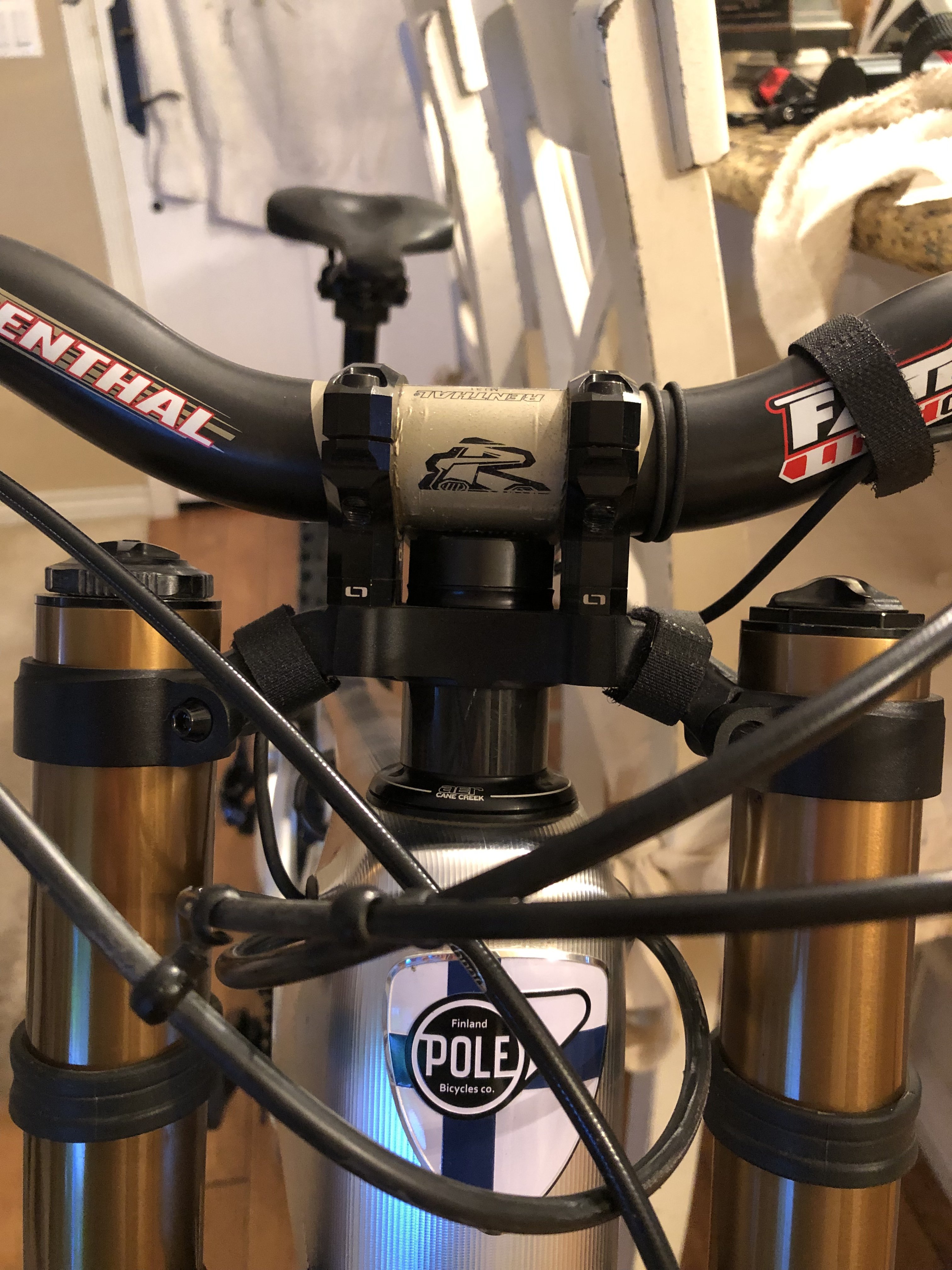

Real nice.
I assume you are running a newish fox40 in 29".
What size frame? I notice the k2 and above have a really long headtube at 140mm which would appear to leave little room to fit a fox40 using their 137mm measurement of top of crown to top of stanchion.
D
Deleted member 9685
Guest
Real nice.
Can use one of these for a total stack height of 145mm. Mojo MORC Crowns

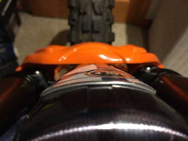

Also it looks like his crown race sits crazy high. @Tankboy is your crow race fully seated or is it the pics. Cane creek has some races and headsets that are super tight to the frame

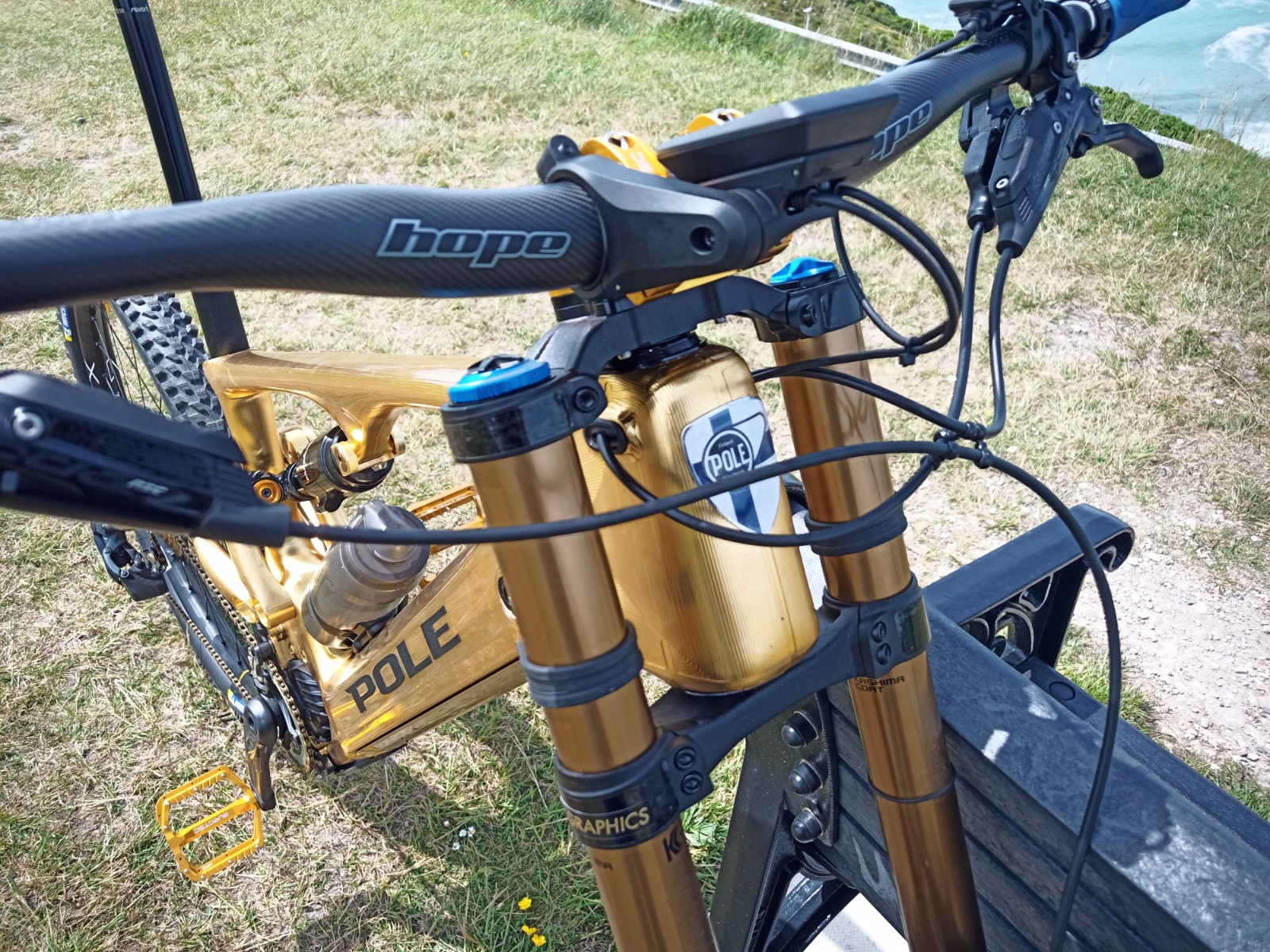

Fox 40's are 2022 and are super tight on the headtube, would be great if Pole reduced the headtube by 10mm to give more leeway? I'm using a hope headset which is fairly low profile and also a 1/5 to 1/8 headtube reducer which adds to the stack height unfortunately? Frame is a K3 with a seat extender to make room for my monkey long arms.
I looked at reducing the travel on the fork from 200 to 190mm but according to Fox's diagrams it takes the extra 10mm of travel off the bottom of the fork rather than the top so no dimensional gains on the top of the fork? The top crown is quite marginal but safe with the top of the sanctions inset into the top crown a bit. I've fitted the fox mudguard which will hit the bottom crown if bottomed out, but have increased a token and pressure slightly to compensate plus not doing anything super narrly ATM so won't be bottoming out.
Was contemplating running a single crown fork on it for now but I've built this a pedal assisted DH bike which I can do both no exercising XC occasionally and smashing out the laps at bike parks so thought Id leave it with the Fox 40's?
Rode the Alps with it this year and was great to be behind a 'proper' fork again, just a pain round those 180 deg switch backs and loading on the chair lifts cus its so long and heavy!! :ROFLMAO: :ROFLMAO:

I have a cane creek headset on my 40 with a reducer and it’s flush on the bottom and doesn’t increase the stack at all. Also, you can get a drop crown from Fox that will give you more room for adjustment.
Edit, never mind, you already have a drop crown. But the cane creek won‘t increase the stack.

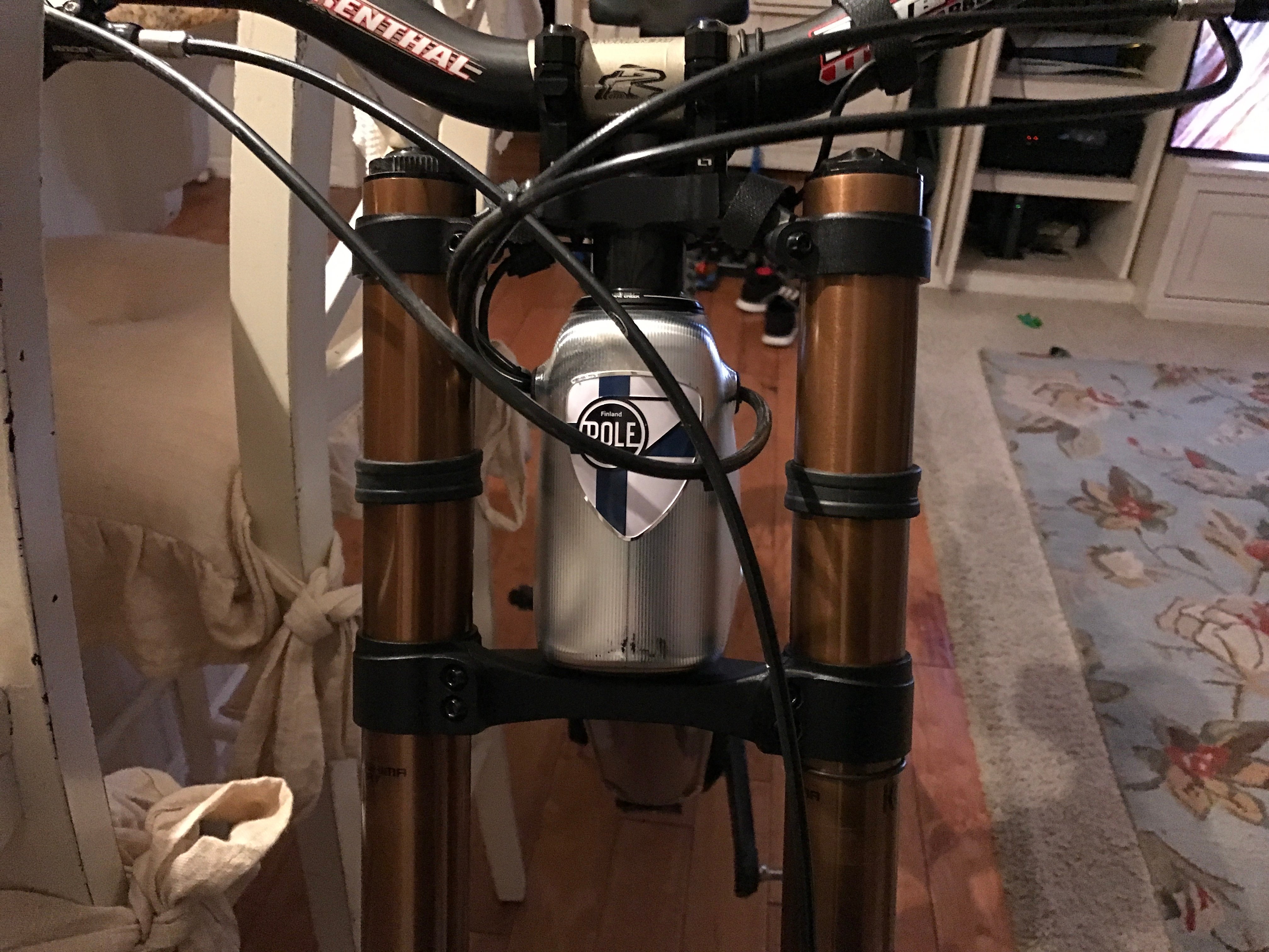

Looking at that pic I assume you must have the smallest frame with a 125mm headtube and/or a pre 21 fox 40 that has 157mm top of lower crown to top of stanchion rather than the 137mm used on the current model?
Onetime
Aug 10, 2022
392
398
Cali
It is a K1, and I bought the reduced offset dropped crown directly from Fox in 21.

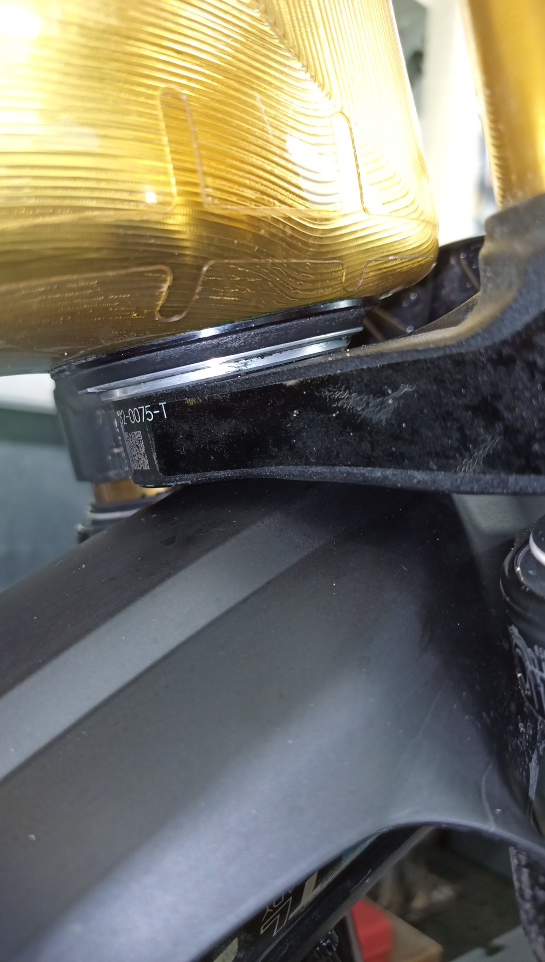

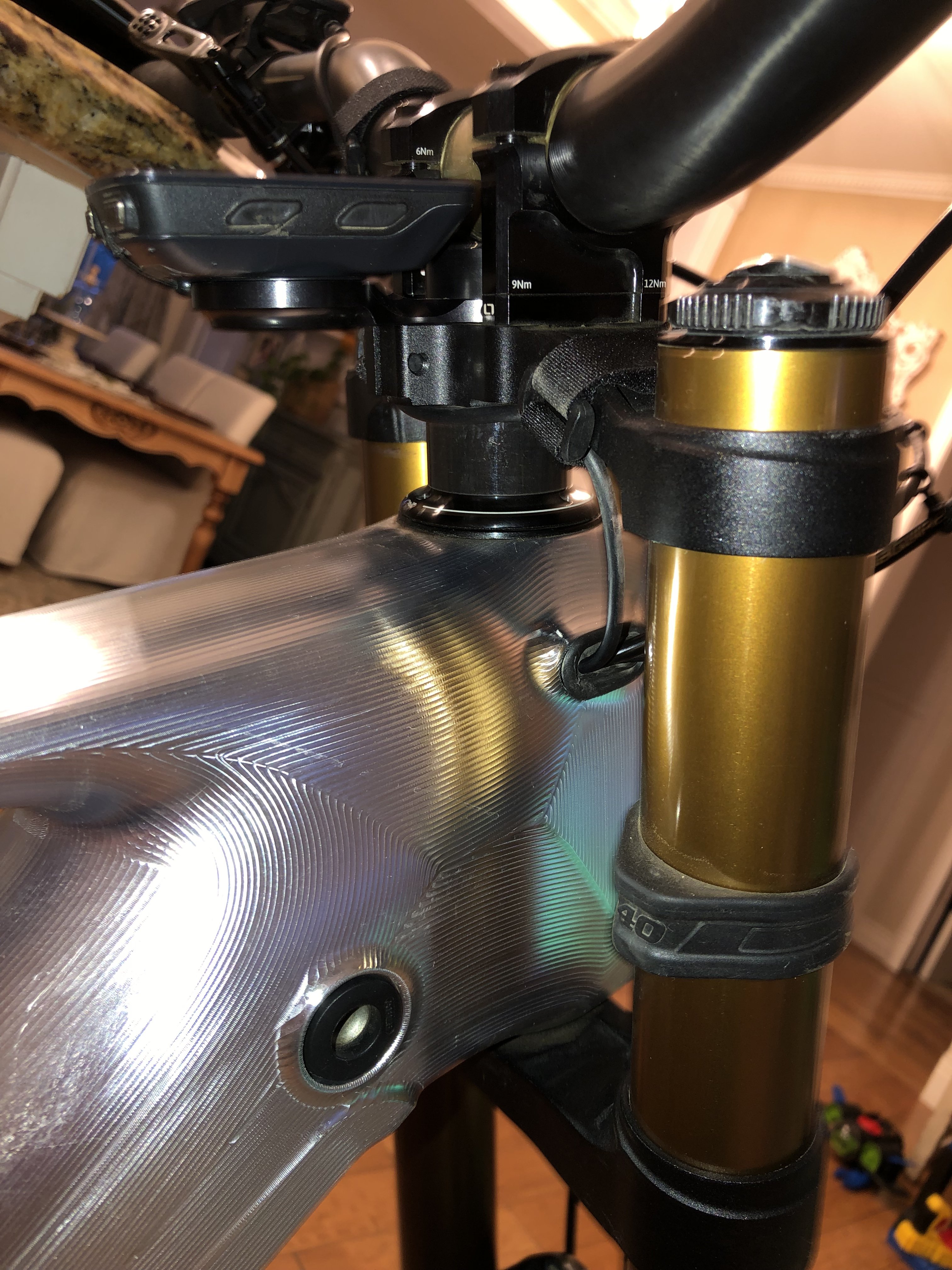

Well, here’s a problem. I'm trying to fit a 2019 Fox 40 to my K4 Voima. Pretty sure it was a 52mm offset fork. Top-of-crown to top-of-uppertube is set at 137mm, can reduce to 127mm. Headset is a Chris King Inset 2 with a Devolution reducer.
FORK- 2017-2020 40mm User Specification Drawings | Bike Help Center | FOX
The stack of the bottom race and reducer is sadly quite deep. I would now need a drop top crown, if such a thing still exists from Fox. I’ll ask Silverfish.
The other problem is that the fork arch hits the head tube under not-even-close-to full compression. Photo shows fork with no air, compressed towards full travel, probably has another 10mm or more to go.
Questions for those with experience fitting a Fox 40 to your Voima:
  1. Exactly which headset make and model did you use?
  2. If you’re using the Mojo Morc, did it move the arch out away from the head tube?
  3. Any other bright ideas?
Please don’t tell me to Dremel the back of my fork arch! 🤠
Also, taking measures to prevent the fork using all its travel is not an option. It will not ride well.
Obviously, I don’t want to have to buy another fork. The intention was to take the parts from my Commencal Supreme 29 and run this as a self-shuttle DH bike.
Maybe a rebuild on a 2022 lower? Would that give the clearance I need?

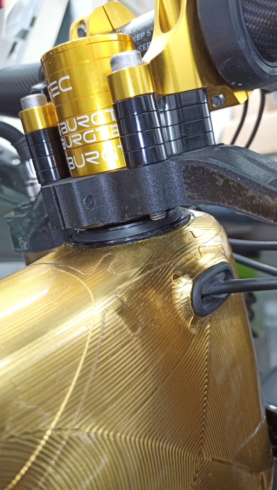

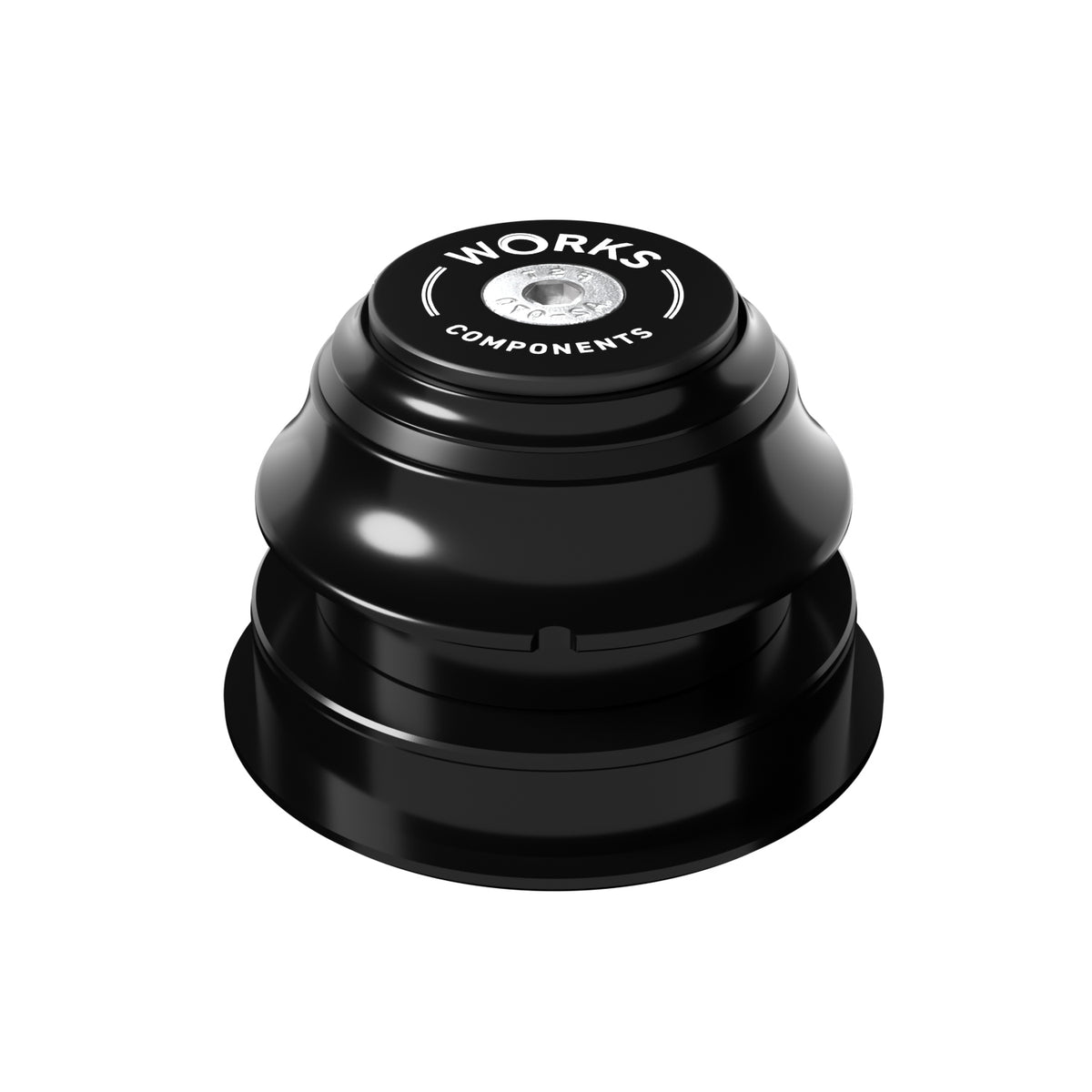

Works components have an 8mm , and now 10mm, reach extender headset
NickyTee
Sep 20, 2022
44
62
Good find, thanks, that might do it.....but I can only see 5mm on their website.
But 5mm is better than 0mm :cool:

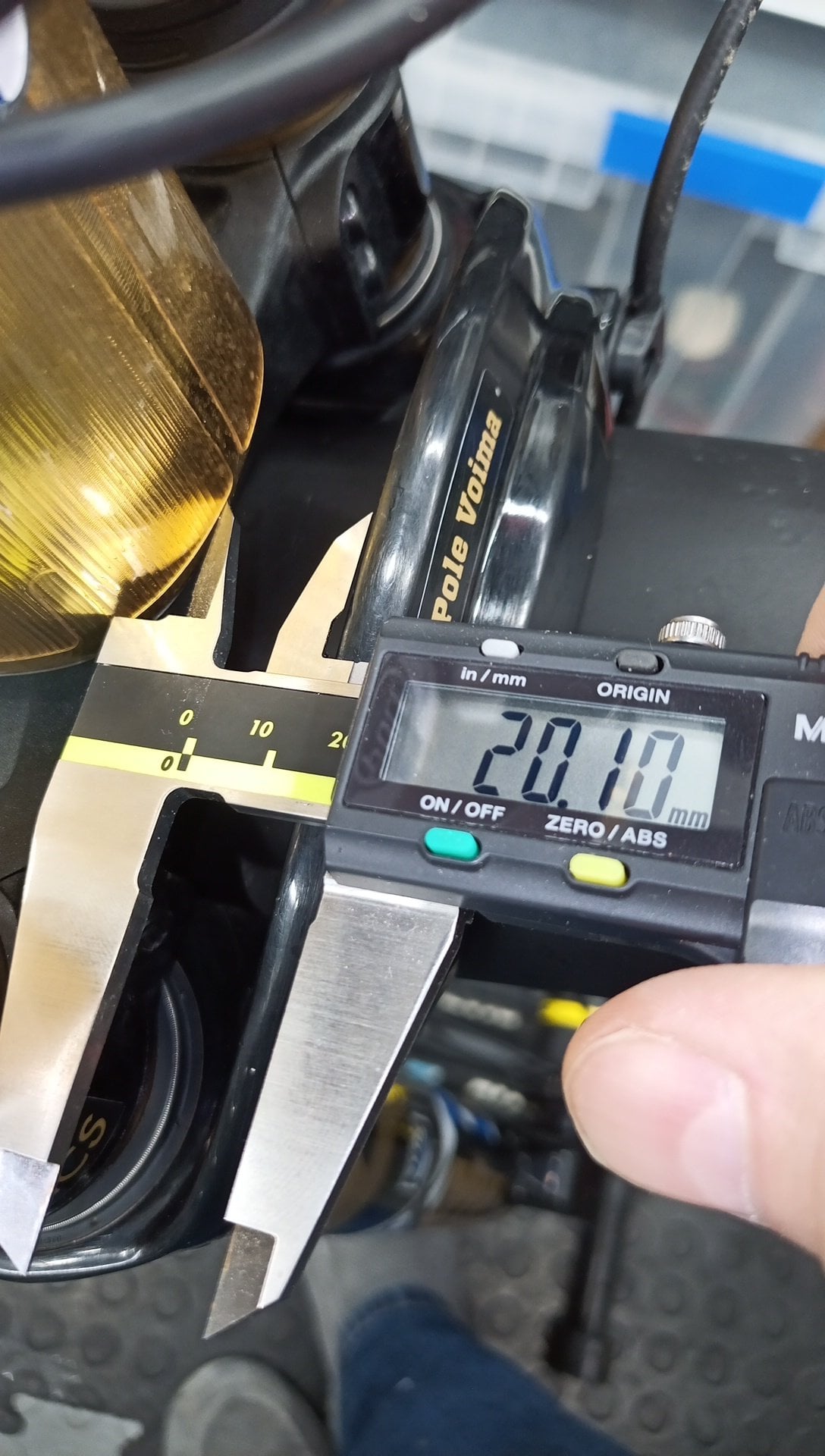

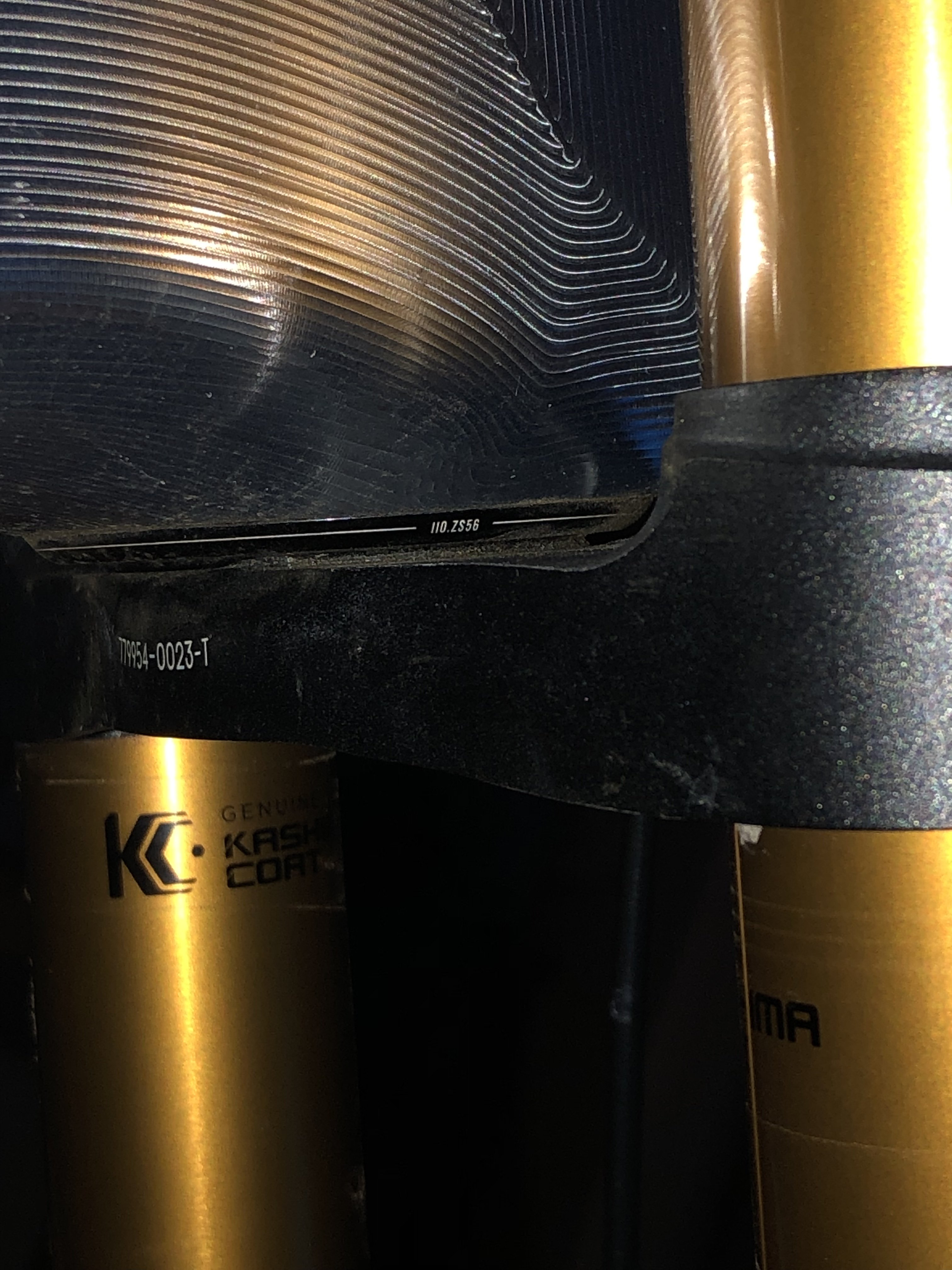

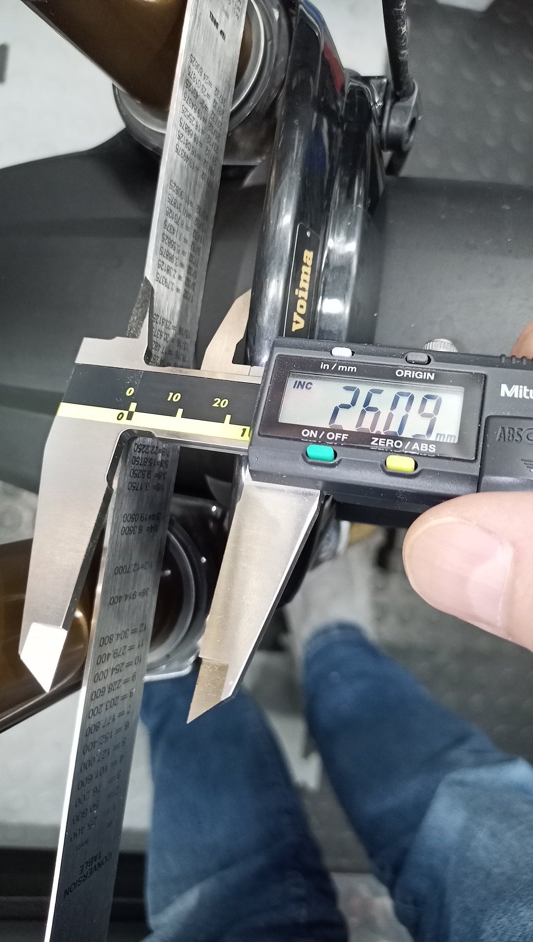

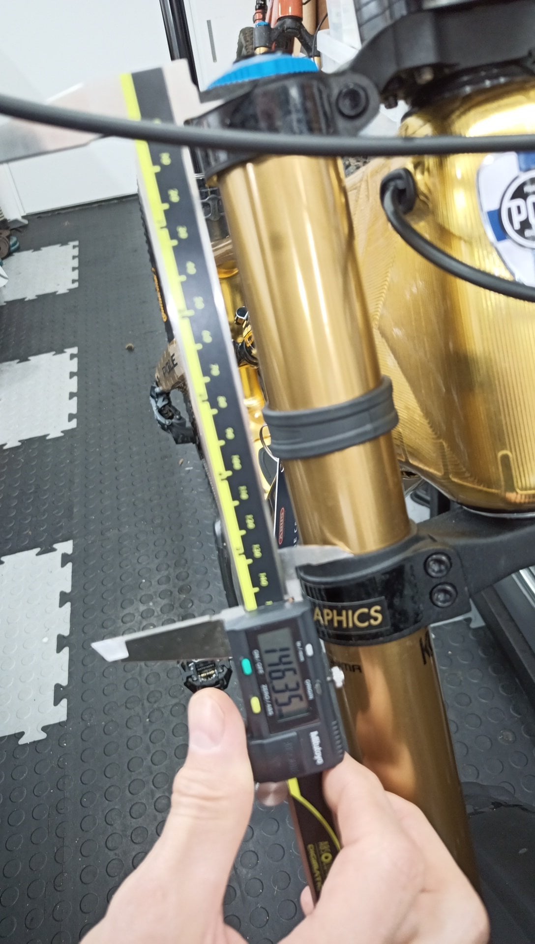

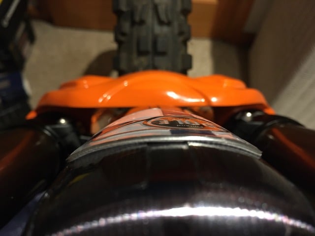

Hey NickyTee, here's some pics of the K3 Voima with 2022 Fox 40, I just fully compressed them as well to check clearance and did a bit measuring for you. I'm using Hope selecta headset 1.1/8", ZS44/28.6 - Type 2 and 1.5", ZS56/40 - Type E with a 1/5 to 1/8 reducer.
Pics below to give you more details and measurements
IMG_20221031_201205.jpg IMG_20221031_201425.jpg IMG_20221031_201504.jpg IMG_20221031_201513.jpg IMG_20221031_201940.jpg IMG_20221031_202505.jpg

Hey @Tankboy - thanks so much for doing all that, I really appreciate the effort :love: I can see now that I have options, even if they're not cheap....but I might even be able to get rid of that orange lower! That's a very valuable 20mm right there, all is not lost 👍
I'll see what I can do in the morning....need to eat now, been trying to work this out all night.
Pizza calls 🍕

Have you tested bottom out? That looks close. Also I know for the fox mudguard you need a minimum of 137mm per fox top of stanchion to top of bottom crown. With a Boxxer you need 163mm +\- 3mm.
For fox it looks like you need the drop crown
@Onetime if you drop your stanchions in their crown flush with the top like @Tankboy you’ll make the seat a little more slack and not need as much stack height. Which will also bring the handlebars forward ~10mm for every 10mm of drop which takes more pressure of your wrists. Maybe even add a +50mm stem but I’m not sure how heavy that’ll make the front end. The stack height is already the highest of ANY bike I know of especially on 29er wheel! so lowering it to where it’s tolerable for flat riding would make for better DH riding…..but being comfortable for day to day riding is the balancing trick.
Yes I figured the the mudguard will fowl the lower crown if I bottom out so I've put in a extra token in and upped the pressure a bit to prevent a bottom out? I'm not allowed medically to do any harsh loads on my body till next year so it's all about mincing around doing easy stuff with no proper knarl ATM :cry:🤙

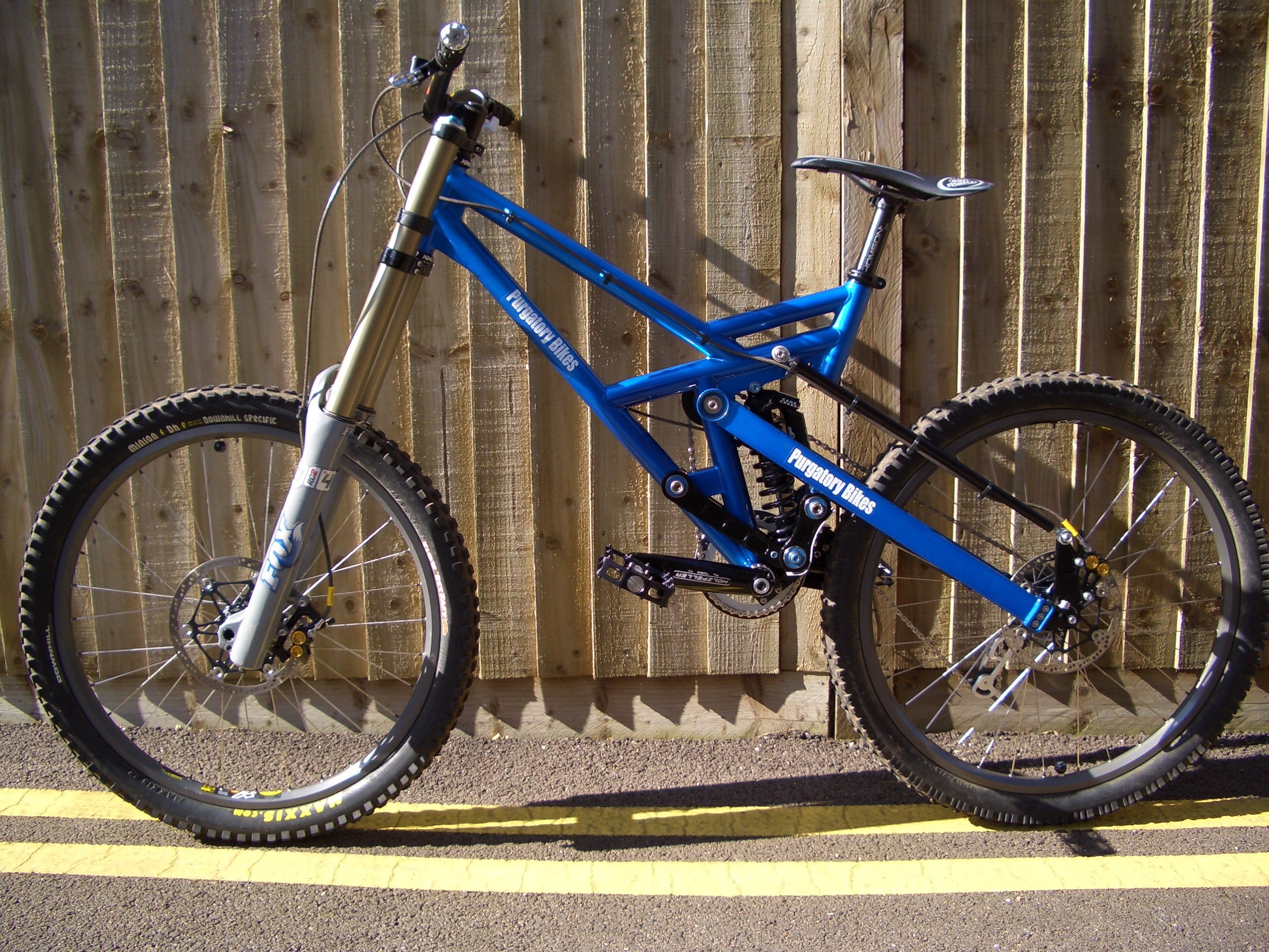

Thanks! It was built of very burly/heavy military grade steel tubing, FEA design such that my femurs would snap before the tubing! It was actually a very fast DH machine, like riding a magic carpet over roots and rocks. It was built in early 2005 and had 10" travel. My favourite bike ever!

I had a Brooklyn Race Link, but they only made one size, and I'm 195cm tall. I also had a Dark Scarab, which was similar again, also with Avalanche fork and shock. That was too small, too 🤣

Owh bet you wish you still had the Brookline, there nuts! A coil for the modern 40's would be great.
Its bonkers just how small DH (and all?) bikes where back only around 10 years ago? The foes 2:1 I've got is large but feels like a small?! I've only ridden DH bikes and trails for years then bought an enduro bike... I've found to my cost that they just don't ride like a full DH rig despite the hype!

You're right, old bikes are tiny! As a larger chap, I'm forever grateful that Pole have led the way with geometry and sizing that works for me.
I'm definitely faster and go bigger on a proper DH bike, with a proper DH fork!

Hey @Tankboy - The plan is to fit the Works Components +5mm headset and a set of Mojo Morc drop crowns. The 49 already has fart ports :ROFLMAO:
If all that doesn't work, I'll sell the 49 and get an EXT Era V2 190mm, when they come out.
Still need a rear wheel rebuild, Onyx 150mm hub needs converting to 148mm, so it'll be a little while yet until I'm riding....
