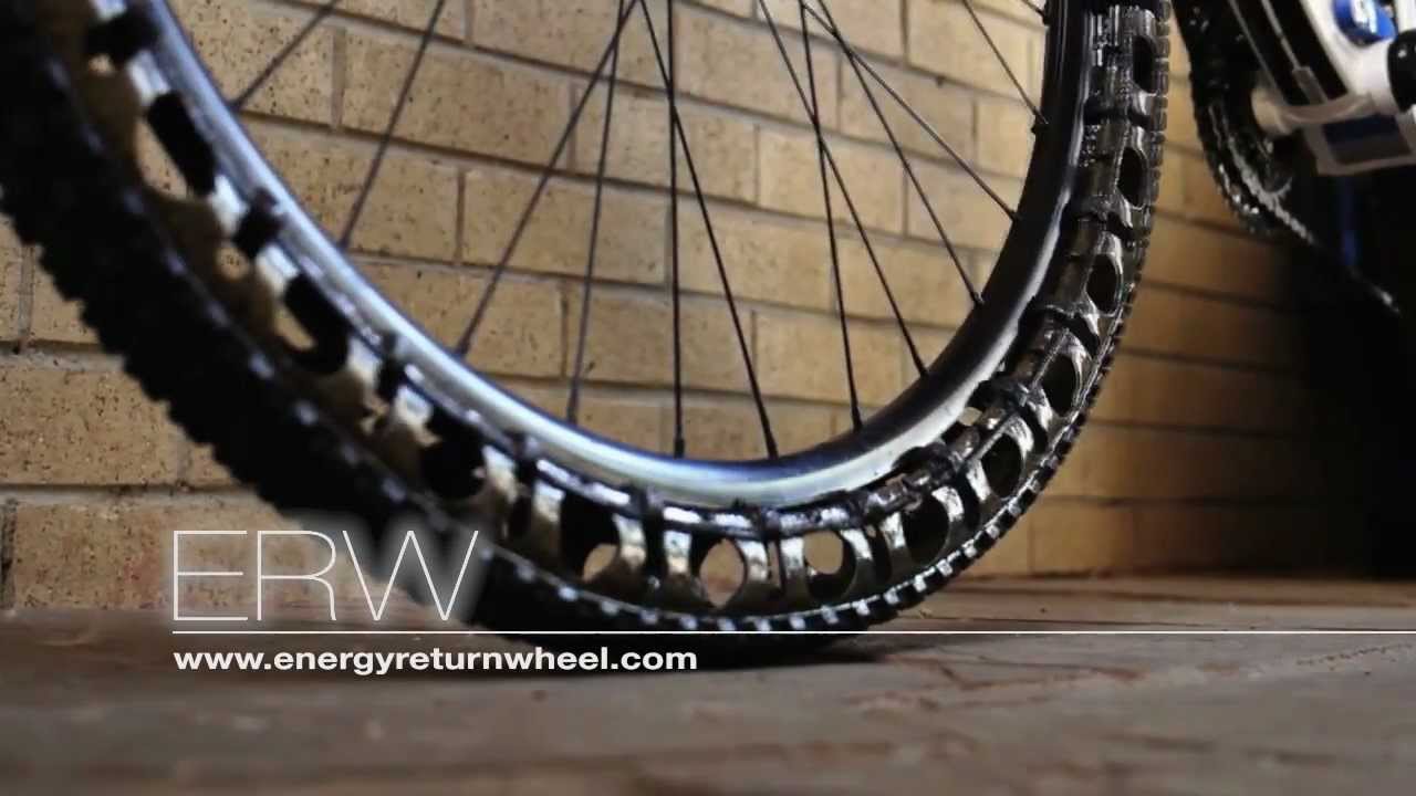

Seriously? I have a REAL mountain bike and I NEVER have to put air in my tires! :rolleyes:
Real men use SPACE! No more flats, no more pumps, saves weight, adds 2" of suspension and has the added benefit of a nice breeze which blows up between your legs on a hot day. NOTE Not suitable for muddy conditions.

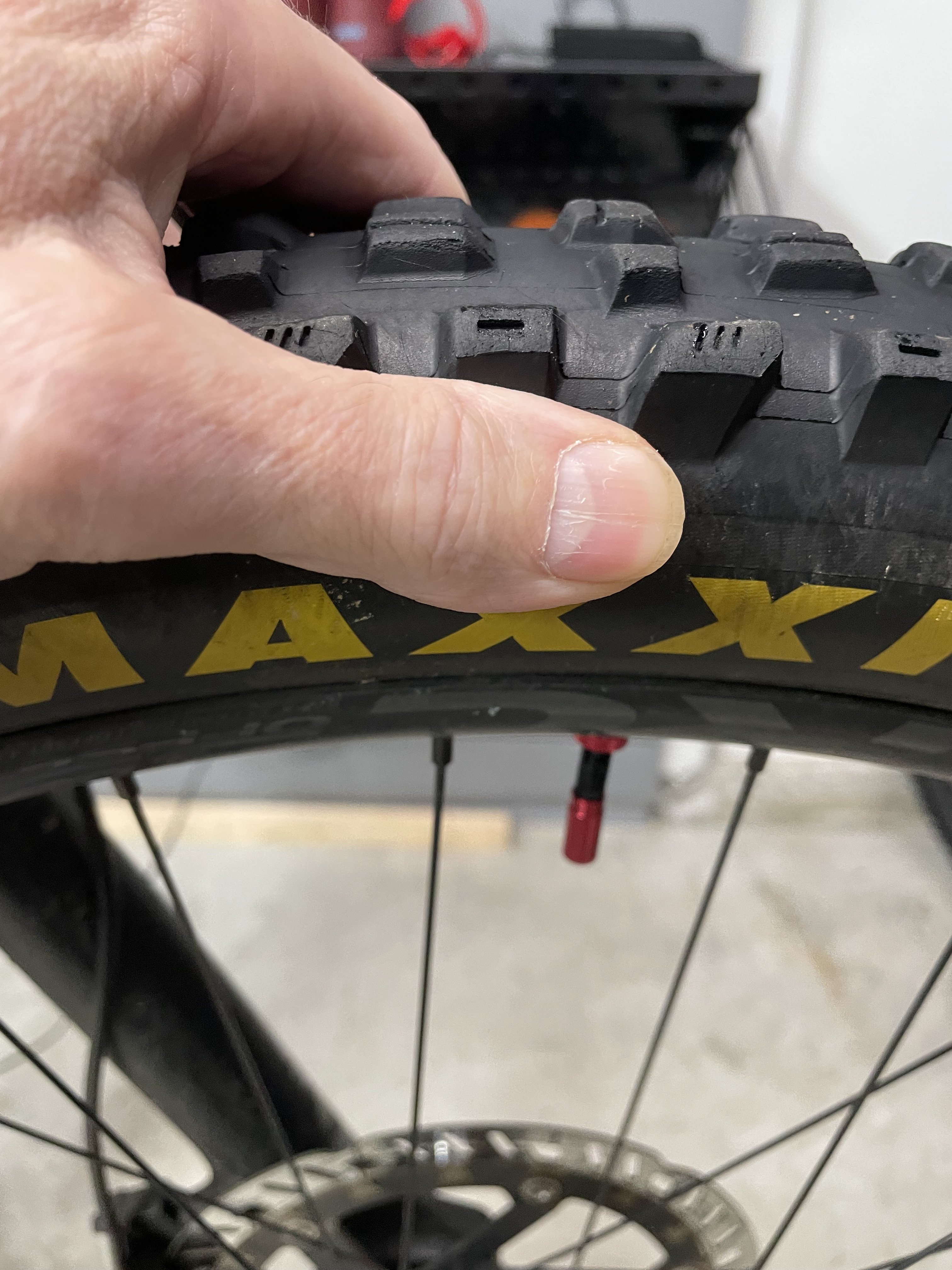

My method for testing psi has changed. I use the pinch n grab method now. I’m usually accurate to within a few psi.
It’s taken a few years to develop a certain sensitivity for this test. Over time I got tired of using a psi gauge and seeing the same pressure readings every time.
I may have punctured my tires a few times but the sealant quickly seals that. I’ve also “burped” the tires on the rocks but a CushCore on the rear has helped me limp home.

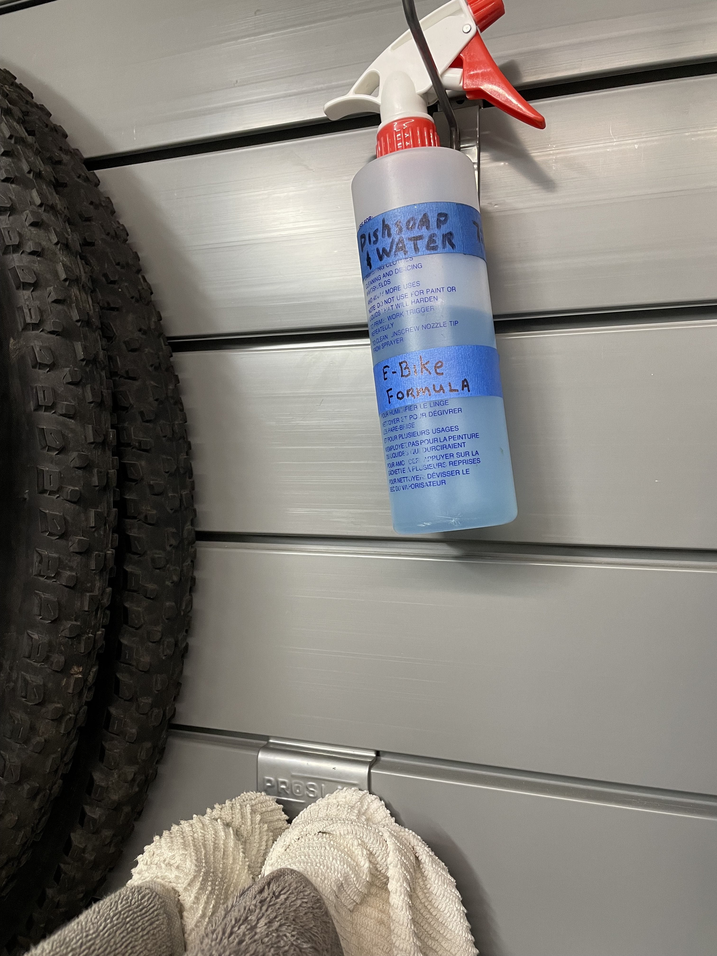

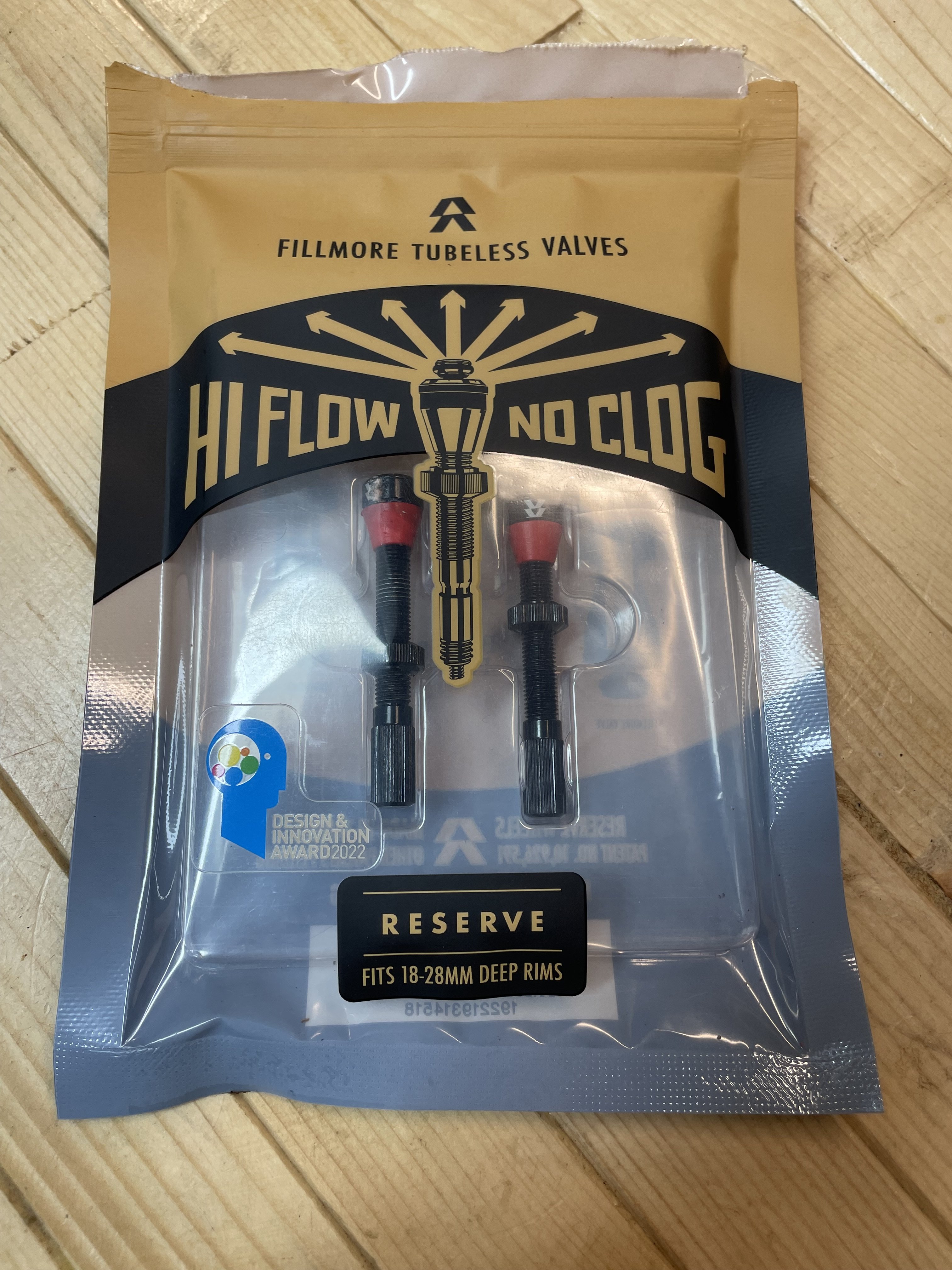

I would knock up some thickish soap water and run it around all the spoke holes and valve and watch a few minutes to see if you get bubbling
If you do I would reck taking the old tape off cleaning the rom and putting putting three rounds of rim tape back on down the centre and one each side tight to the inside edge of the rim it the only thing it could be if the tyre and valve are holding up
The small hole (s) on the side of the rim can be difficult to detect any air escaping. Sometimes, unless you pass your soapy index finger back and forth over the hole, small bubbles will not form.
When I see this I suspect the rim tape. The tape could be installed incorrectly or your finger nail may have accidentally punctured the tape …on any of the inner spoke holes. A small slice at this point is difficult to see and can act as a “duckbill” valve. Almost impossible to seal.
I use a cloth or towel to press the tape into the channel, then press out any trapped air bubbles. I use a heated awl to create a hole for the air valve. I wiggle and rock the valve as I tighten it into place.
Over a 2-3 month period I might lose a few psi. But if the tire leaking …I will find that, or change the tire.
