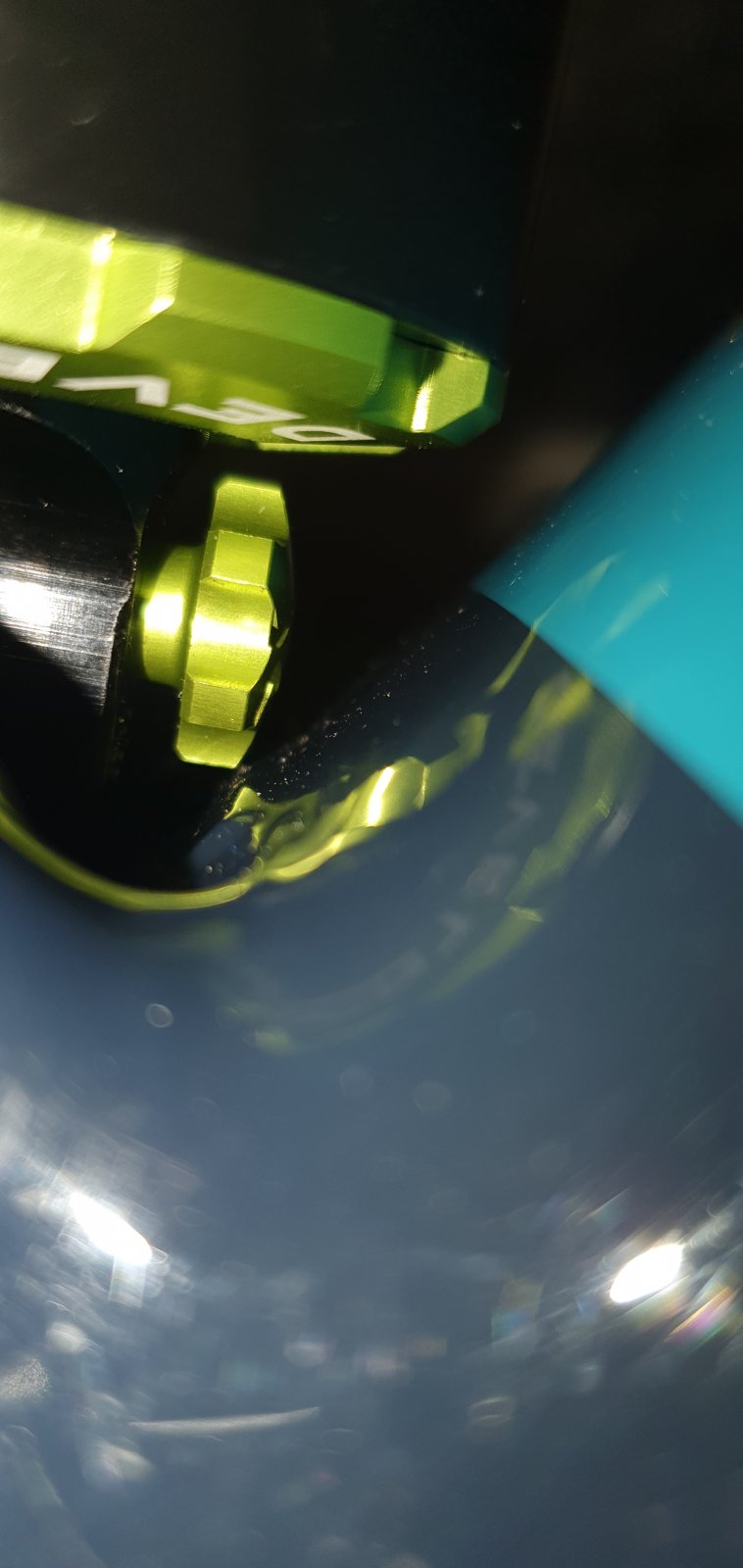

Can you post some pics please, especially of the modification.

I'm going to the bike shop tomorrow morning, I'll report back afterwards.

That is almost full compression, there’s plenty of room. Not sure if I’ll be able to keep the bottle cage though.

Is that a 230x65 you’ve fitted and on a medium frame?
Medium frame, yes.
I requested a 230 * 60, but I hadn't noticed the size printed on the shock body. Too excited I guess. :D
