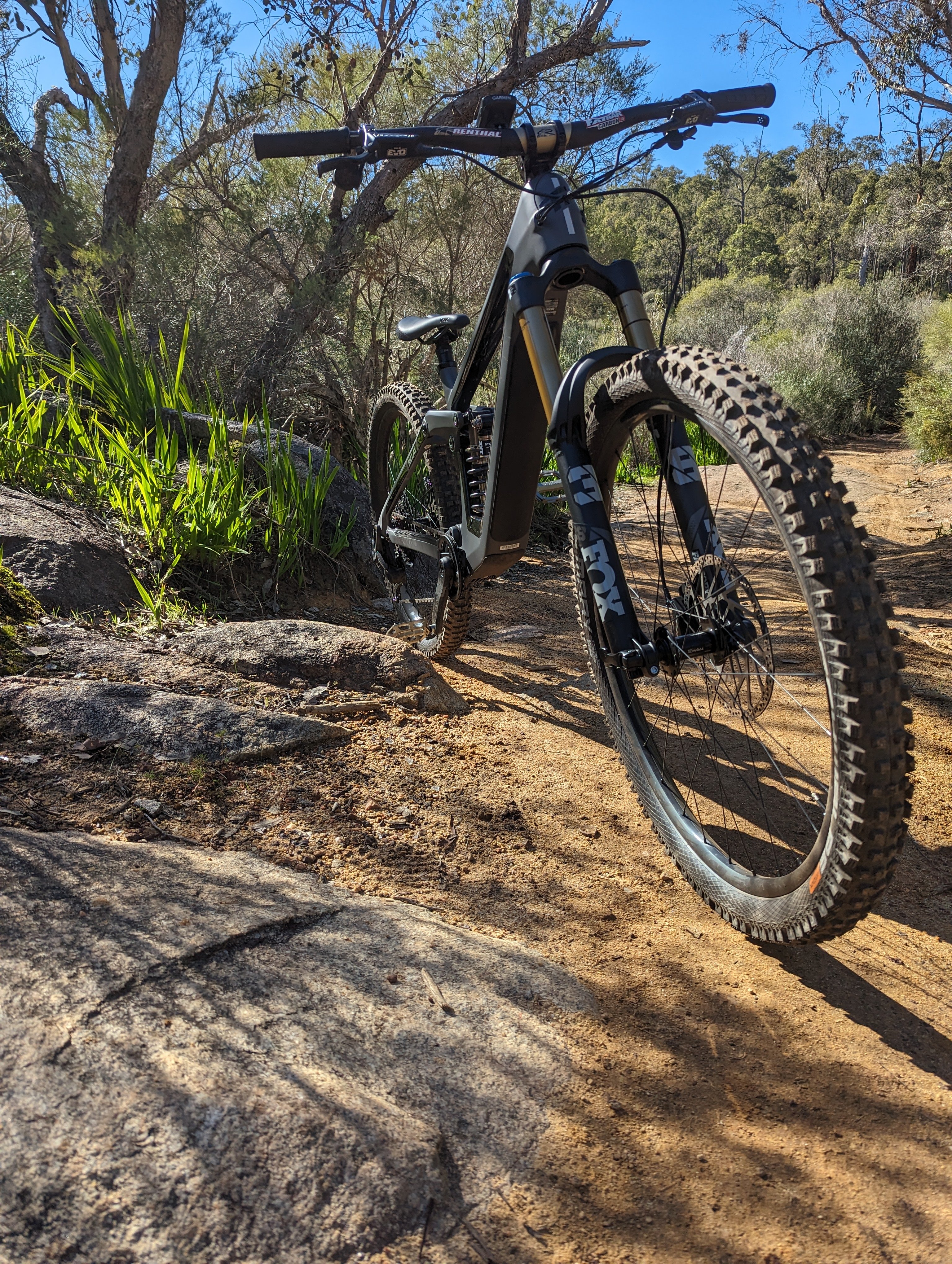

OK 4 rides in loving the relay! I ride almost exclusively with other ebikes and have found keeping up ok despite the fact I am probably the least fit. Will depend how far you ride I guess but our rides are usually around 800-1100m vertical. Don't see anywhere I can get a spare battery here but I see they are available in Europe and apparently through transition in the US.
Range extender may be handy for big point to point rides.
It's my first transition, love how the bike handles and feels, comes alive the steeper and gnarlier the terrain in my experience, even for someone who is as ordinary as me. It gives me the confidence to hit things I didn't hit on my old bike. I am riding a carbon PNW with an EXT Storia V3 in the rear.
I have found it a little more challenging in the tight twisty rolling hill type trails but everything else has been awesome, love the bike. I need to get my carbon wheels on the bike, The Schwalbe tires seem good but might go back to Maxxis for comparison.
