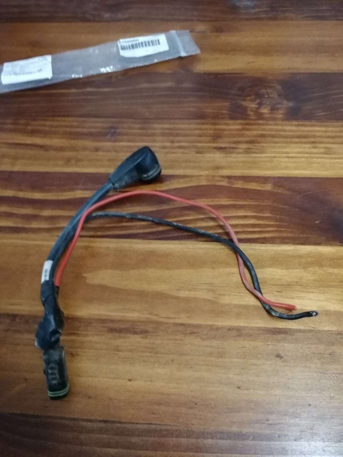

There is lots of factors when load sharing power between systems. Voltage, bms data, size of batteries, type of battery etc
The list is very long and I don’t feel it’s a reliable option if people want their bikes to last and also the claims against someone who supplies a cable then you connect wrongly and cook motor or batteries.
please see attached image of a so called option. Clearly this lead has suffered high temperatures by the condition of the leads. D923B643-60C2-4862-A822-F026994E53C3.jpeg

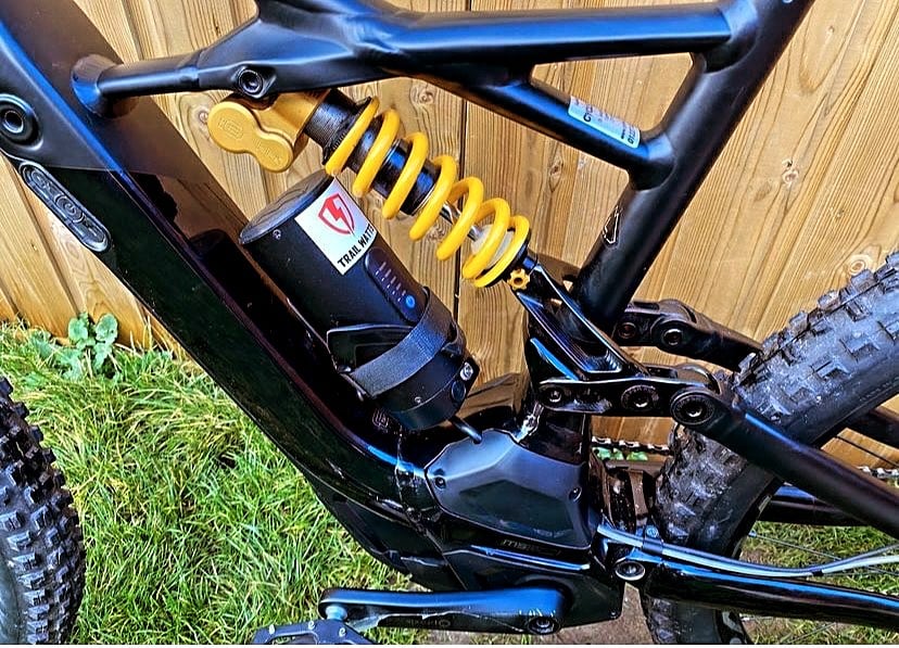

@TrailwattsUK Hi, as my 5 years old Levo battery doesn't have its original 504Wh capacity anymore, I am thinking about TW range extender once again :). Few questions though as I am little bit confused from provided pictures on the website/eshop:
  1. so 252Wh kits for ALU Gen1 LEVO looks like this now (have levo, not kenevo)? All kits has that battery indicator on the side and there is no "bottle" shaped kit with USB on top anymore? I don't see any option to select this on your eshop, so just want to be sure.
  2. Such kit is now automatically provided with additional top motor cover with pre-drilled hole for the cable on the front?
  3. what is the weight of the kit?
  4. Is it necessary to use provided cage or even the standard Specialized Zee cage will securelly hold the battery?
  5. In case I would not want to ride with extender and have that "stealth" installation as seen on that FB image, the connector for disconnecting extender sits also behind that top cover? Nothing else needs to be disassembled (not meaning initial setup)? Does the kit include also some cover for that unplugged connector on side of the bike to be sure it will not get short-circuit when wet finds its way behind that cover?
  6. Is there chance, that if I get newer bike in the future for which you will also sell extenders at that time, that I will just be able to purchase new cable kit and use battery from original kit? (Considering it will fit to bike frame of course).
  7. I don't see field to input discount voucher on the site. This offer is no longer valid?
Thanks!
TrailwattsUK
Trader
Aug 27, 2018
817
685
Kent
  1. so 252Wh kits for ALU Gen1 LEVO looks like this now (have levo, not kenevo)? All kits has that battery indicator on the side and there is no "bottle" shaped kit with USB on top anymore? I don't see any option to select this on your eshop, so just want to be sure. View attachment 130315
Thanks!
We can provide a USB topped battery if requested.
Notched Top cover is supplied with kit.
Booster battery is 1.4kg
You must use cage provided to support the booster battery.
You can disconnect the booster and fit your factory cover if not using the booster.
No harm will come to the connector (sealed with supplied cap)
Gen 2 and 3 bikes can be adapted for at extra cost for harness etc
We have discounted kits without code required for December.
Class 9 hazmat shipping to EU covers 3 kits to single address for £129.99
